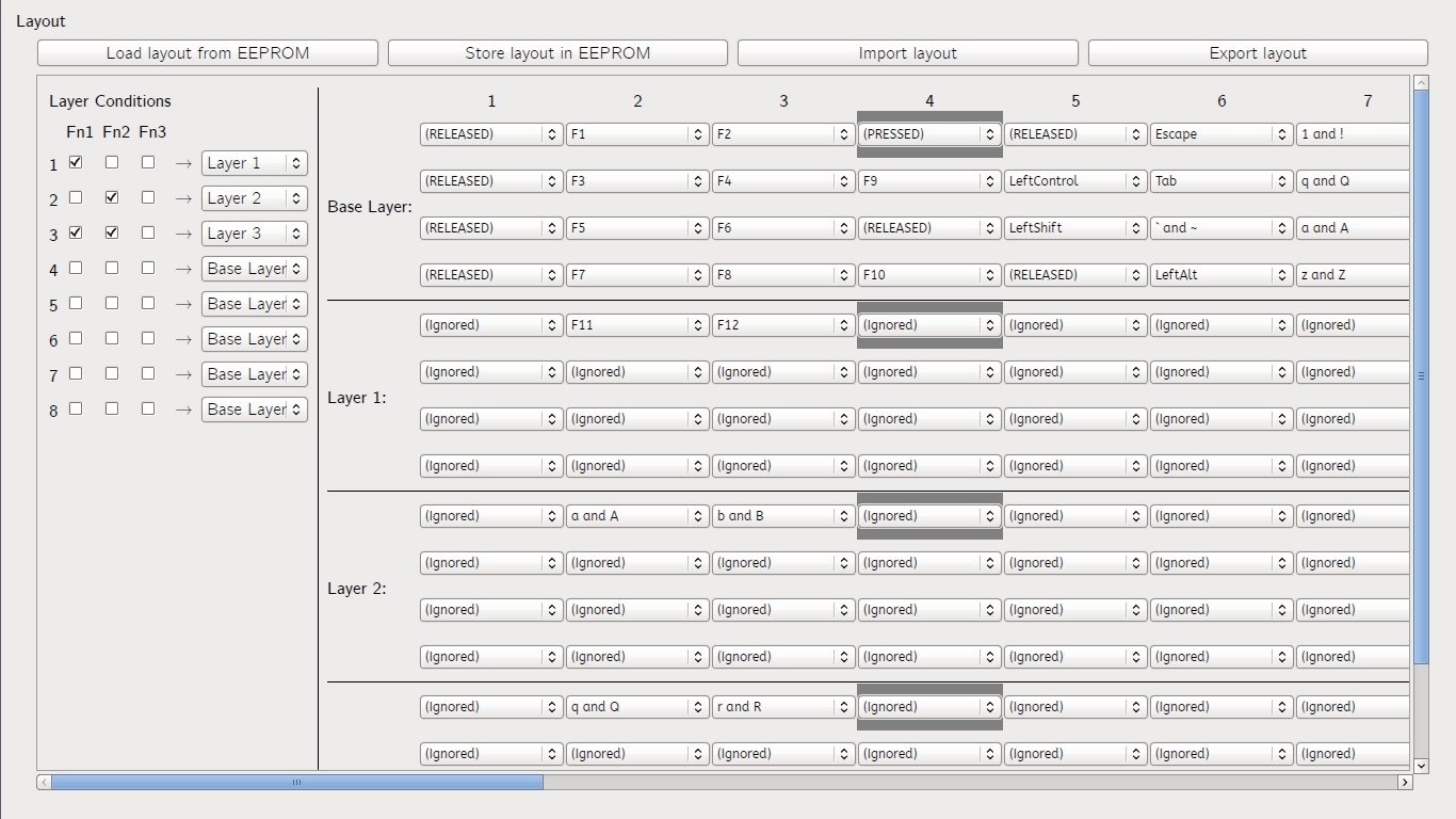

Posted: 18 Sep 2013, 11:51
by xwhatsit
Alright well I have layers working more or less.
Fixed number of 4 layers (including base layer), 3 function keys. 3 function keys means there are 8 possible combinations (for chording), so I've got a fixed list of 8 Fn key to layer mappings.
Fn key combinations are taken from the base layer only. I think this makes sense. Is there a use case for fn keys on additional layers? Would have to be some mad chording thing. Maybe better taken care of with macros.
The GUI is working. I wish there was a more space-efficient manner of cramming 92 combo boxes for each layer into a grid; my laptop's palty 1366x768 12.5" screen doesn't really cut it :P
I'll try to get this released tomorrow.
Posted: 19 Sep 2013, 06:49
by xwhatsit
Righto well here is v0.4.
beamspring-usb_0.4.tar.gz
(343.1 KiB) Downloaded 310 times
New feature is... layers.
I'll get precompiled Windows versions of the util and maybe some firmware builds uploaded when I get a chance.
It's really important that after the firmware in the controller is updated that the GUI util is updated. They won't really communicate properly otherwise.
The layer stuff should be reasonably obvious. If importing an old *.l file with only the base layer in it, the base layer will be copied to the other layers. The only slightly odd thing is that Fn keys can be remapped on layers (new Fn keys can't be introduced on subsequent layers, but the Fn keys themselves can be remapped). In most cases this isn't want you want, so you probably want to set the Fn keys to (IGNORED) on subsequent layers.
In my 3727.l file in the tarball there's a demonstration of a slightly interesting combination—Fn1 goes to layer 1, Fn2 goes to layer 2, Fn1 + Fn2 goes to layer 1 again—and here's the trick—on layer 1, Fn2 is remapped to NumLock. The effect being Fn1 + Fn2 produces a NumLock press.
