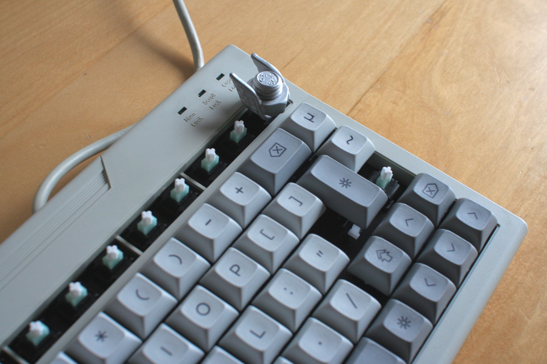

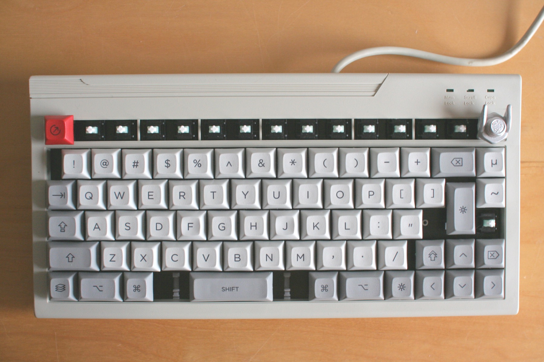

But first, finally!, here's some pictures of them in action. DSA profile has short MX mounts, which really helps with these adapters. So I put PBT Granite DSA caps on my Monterey K110 "MiniTouch" with sweet switch "Monterey" SMK switches. Excuse the Scottish winter's murky light…
Granite MiniTouch Overview.JPG (388.71 KiB) Viewed 16746 times
Granite's Pro Mods came in useful here. But still the K110's oddball layout has a few things I can't match. The L shaped Tab, the plain weird Return, and then there's that pesky offset-stemmed right Shift! Grr. Only two keys have stabs, Return and the 5u space bar. I'm using them both with smaller caps for the time being. More harm in looks than feel.

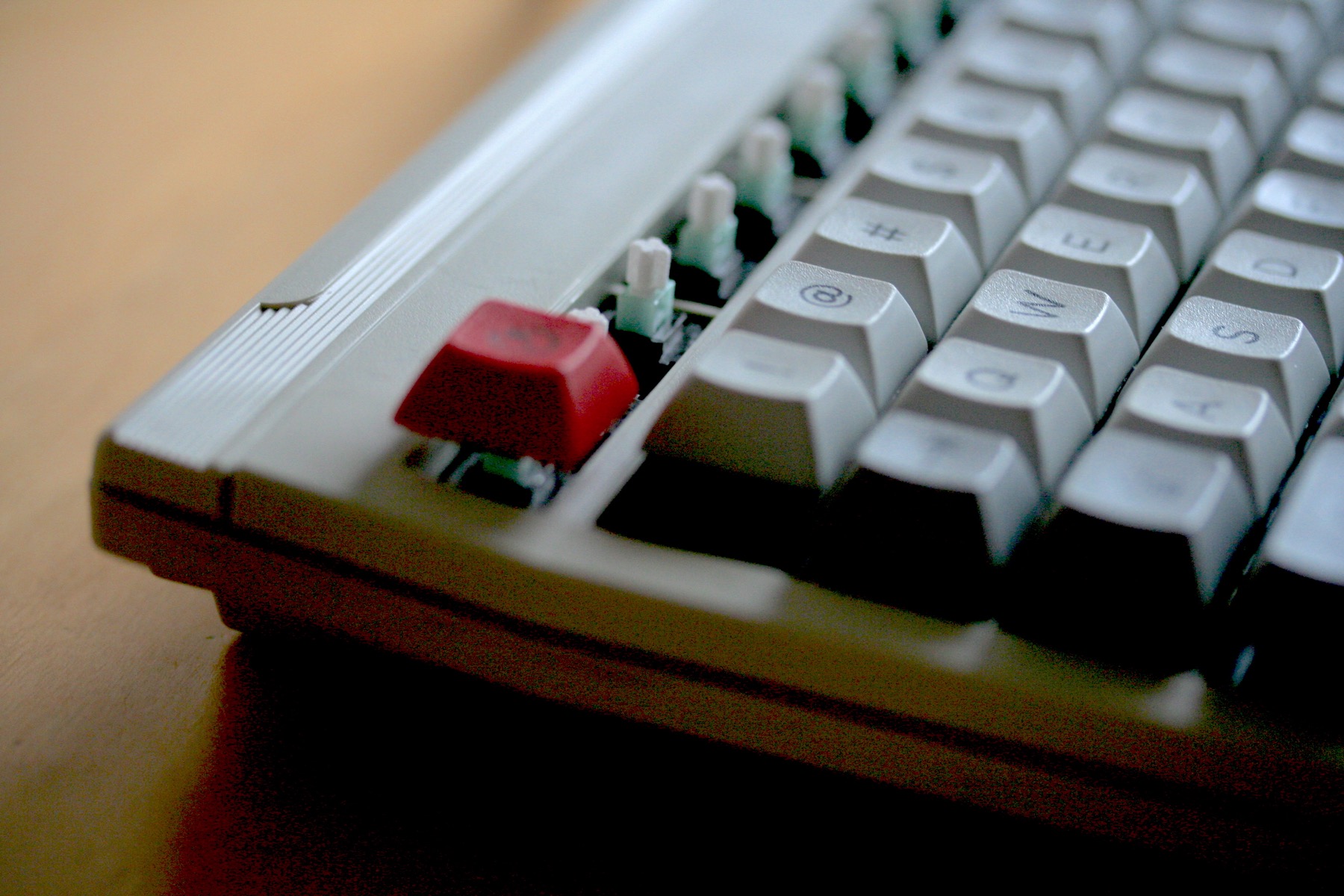

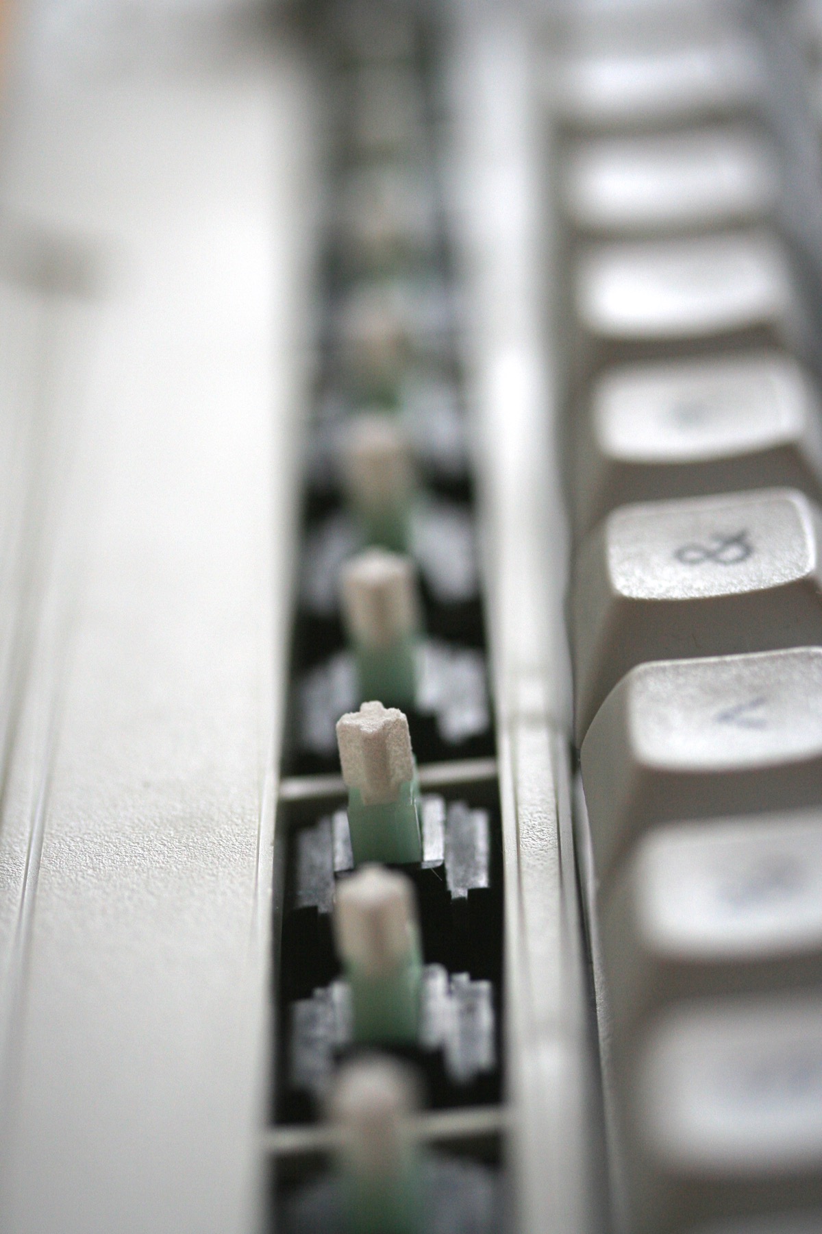

I kept off a row of caps to show the adapters in action. They slot into the Alps mounts just perfectly. That gives you a solid platform for popping the tighter MX caps on top.
Adapter Row.JPG (370.24 KiB) Viewed 16746 times

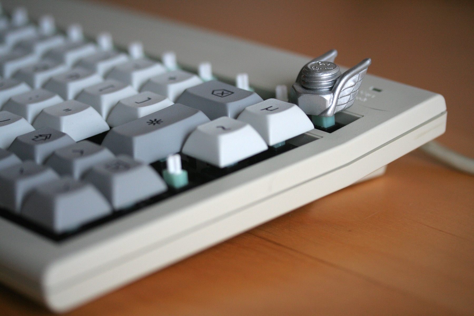

I like these minty ice cream colours! Note this is the narrow Monterey special function row. The adapters add enough extra height that full size MX caps work just great even up there, as they sit above the case plastic, and get full travel!
Left Deep Shadow.JPG (397.06 KiB) Viewed 16746 times
These caps are a nice upgrade over my K110's stock ABS. No need to worry about them yellowing, either. I could see getting more use out of this keyboard with them. They feel great. No obvious wobble to worry about, no NovaTouch-style clattering, I'm impressed with them in action. It's great to have such cosy caps on sweet clicky Montereys!

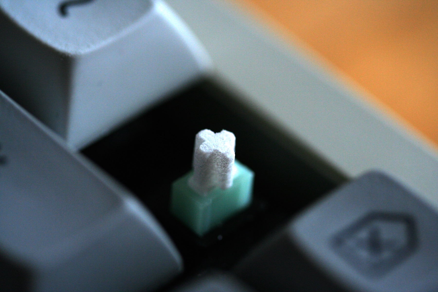

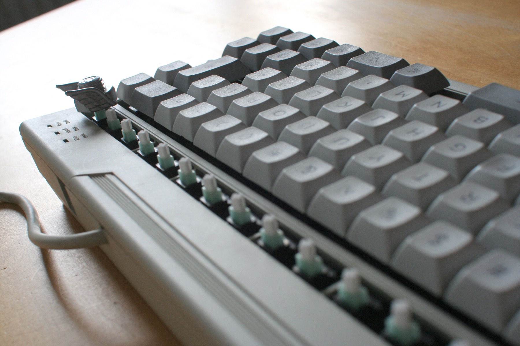

The height is, of course, increased with adapters. Mr. Interface kept this effect to the minimum by having no dead zone in the adapters, they go immediately from one mount shape to the next. But you still get some elevation simply because MX cap mounts don't fit inside Alps mount pegs. Unlike their native switches where caps pop inside the switch slider by some millimetres, here the two mounts stack on top instead.
Adapter Closeup.JPG (414.39 KiB) Viewed 16746 times
This feels fine with DSA caps, but I wonder what SA would be like! I daren't try that quite yet, until we've found a way to make the adapters significantly easier to remove.

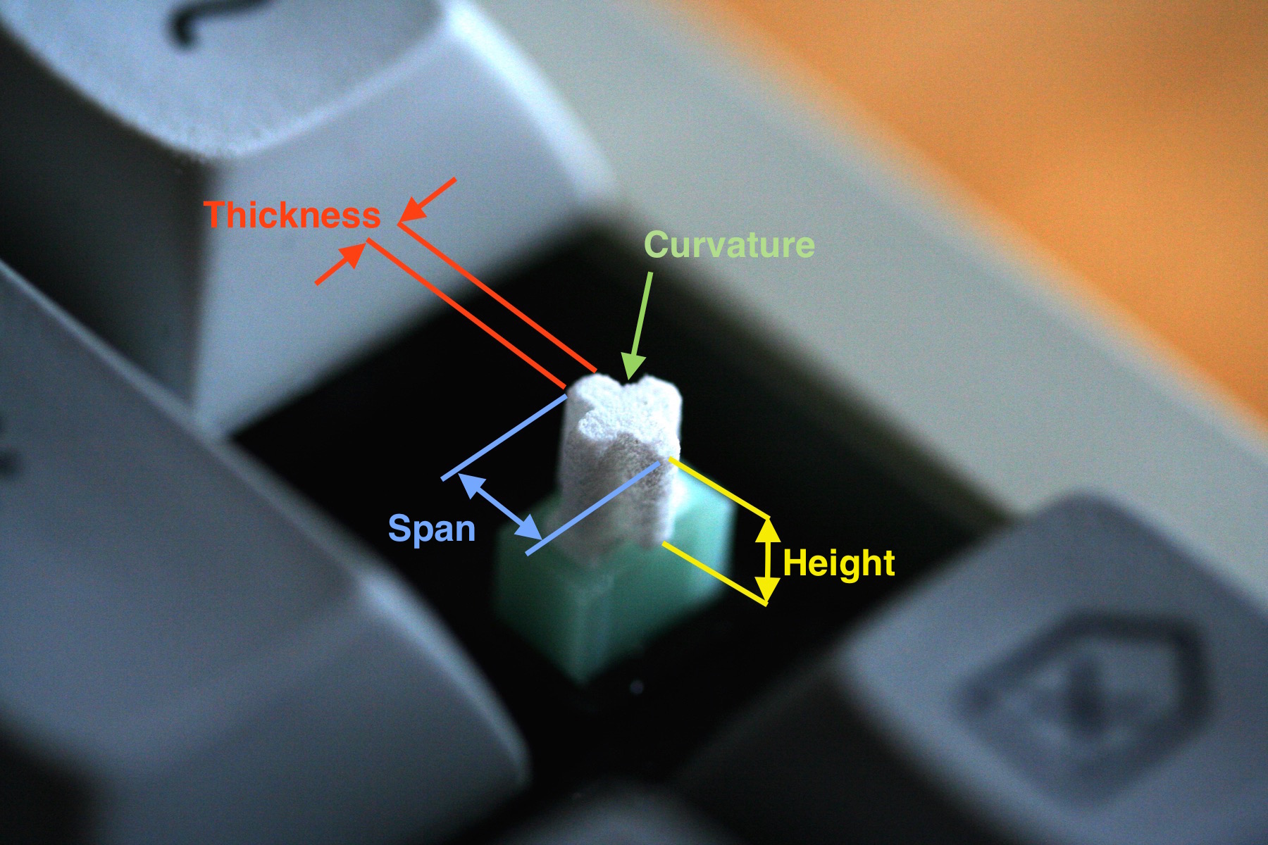

Now, about my theory. Here's a diagram to make it easier to describe:
Adapter Closeup - Annotated.JPG (490.12 KiB) Viewed 16746 times

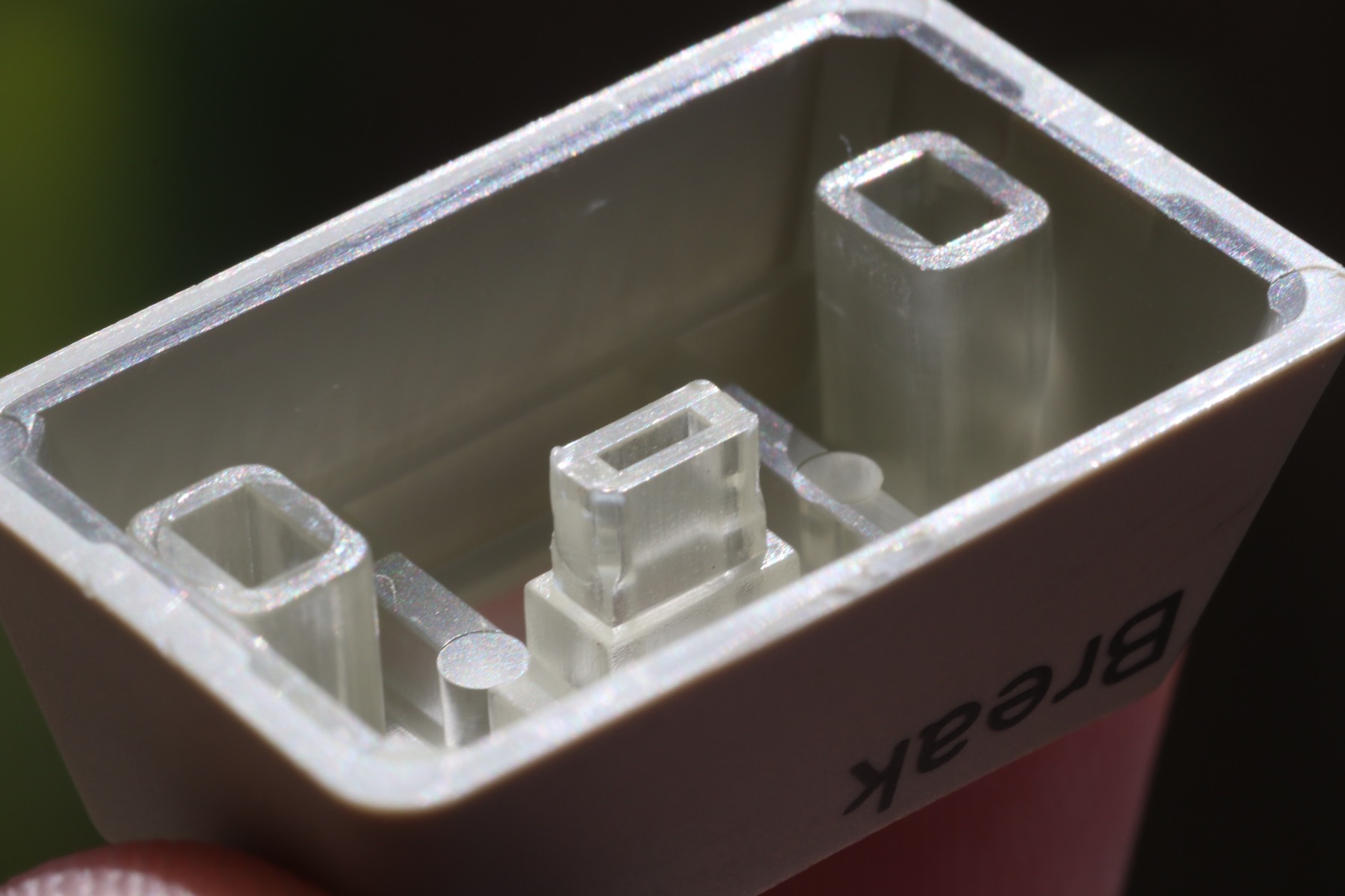

The easiest thing to attack with a file is the span, as I've marked on the diagram. I've been quite intense with that (in both X and Y directions) but even shaving off a whole load of it has zero effect on the mount's tightness. So next I tried filing down the thickness, as I've called it. This is much trickier to do. I'm not sure I've really been effective, but I gave it a few tries, and again zero result.
What I think is really going on is the curvature. When you put these adapters into caps, you can feel the 3D print material crumble a little when you push the cap into place. That's when things get real tight! I think the X shape isn't quite right angled enough at its inside corners (although the picture above makes this look way worse than it really is). I'm betting this is a limitation of 3D printing in general? I tried to carve the shoulder a bit deeper by hand, but it's very fiddly and again my attempts failed to alter the tightness.
But since I'm typing on these adapters right now, I did find a workaround! DSA caps are much better than the others I tried because they are short inside. They sit on about 50-66% of the adapter's MX stem. Less height, as I marked on the diagram, is better! The adapter is much easier to remove because there's simply less friction, and you even get better grip on it with your fingers when you pull.
My suggestion is to reduce the height of the MX side of the adapters. And to experiment with a few different, smaller, thickness dimensions too. I'd gladly help out testing even just a handful of those, to get the best match with my various caps. So far, these here are too tight in every MX cap I've put on them. Too much so for general use, though the concept definitely works and for the adventurous, the current model is useable with DSA and vintage Cherry sphericals.

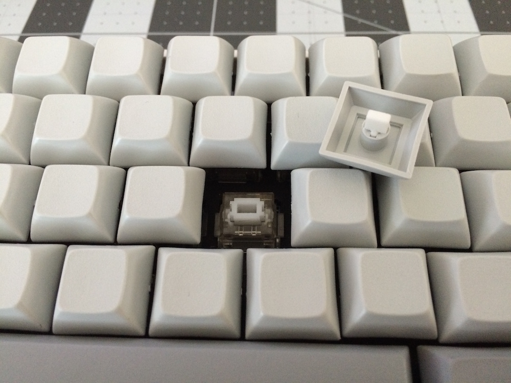

So I promised that I'd provide some pictures, but never got around to it. My photography skills are quite poor (especially in comparison to some of the things that I see posted on the forums daily), and I'm never at home when it's bright outside. Anyway, I bit the bullet and took some pictures of my now defunct FaceU wearing a mixture of Apple Design Keyboard caps and original Cherry WoBs this evening. Sorry about the poor quality!
26 Nov 2014, 21:55
Nice case! Now, about lighting… you've got a lamp you could turn on somewhere, right? Try pointing something towards the ceiling — your flash, if you can — to scatter a nice soft illumination.

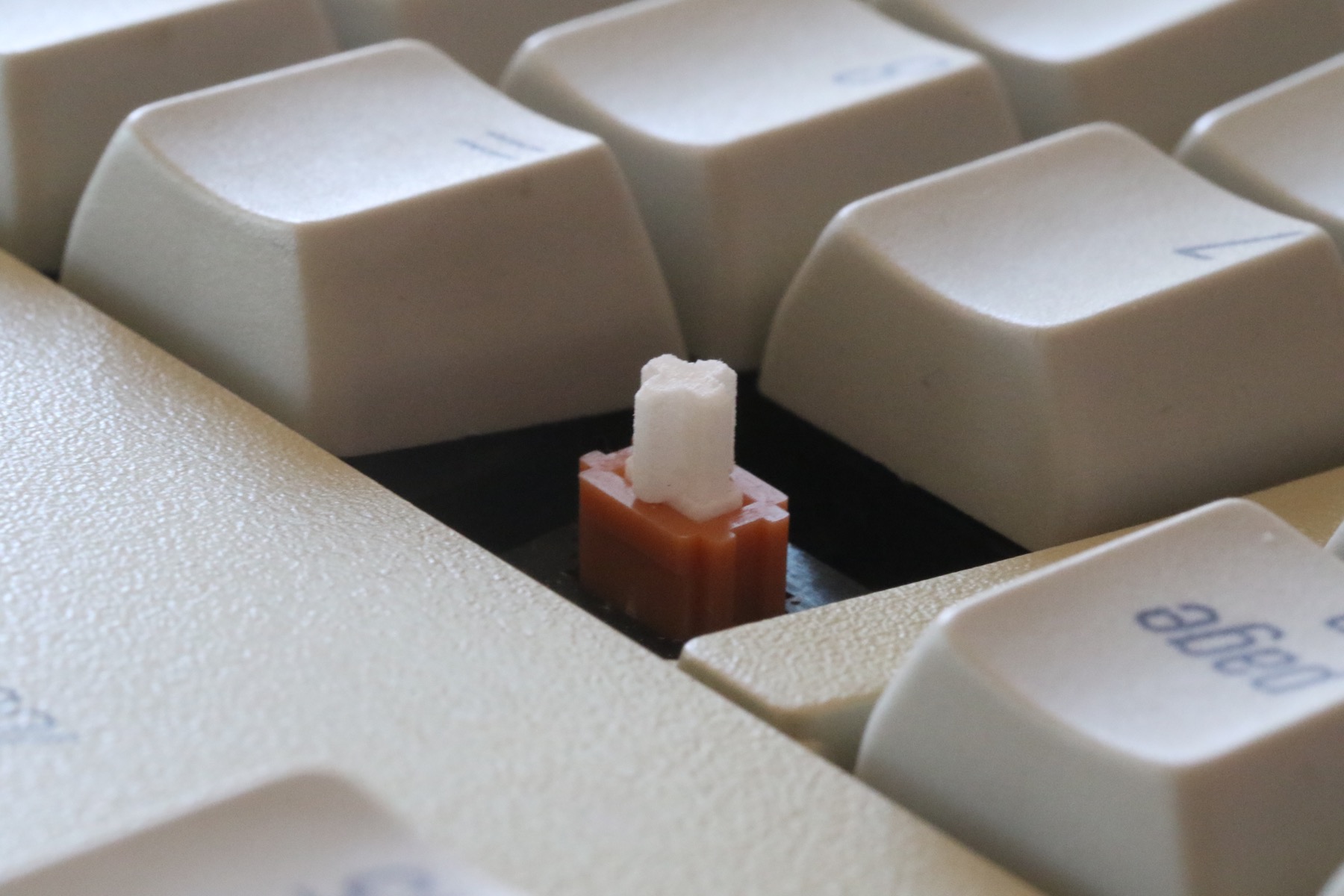

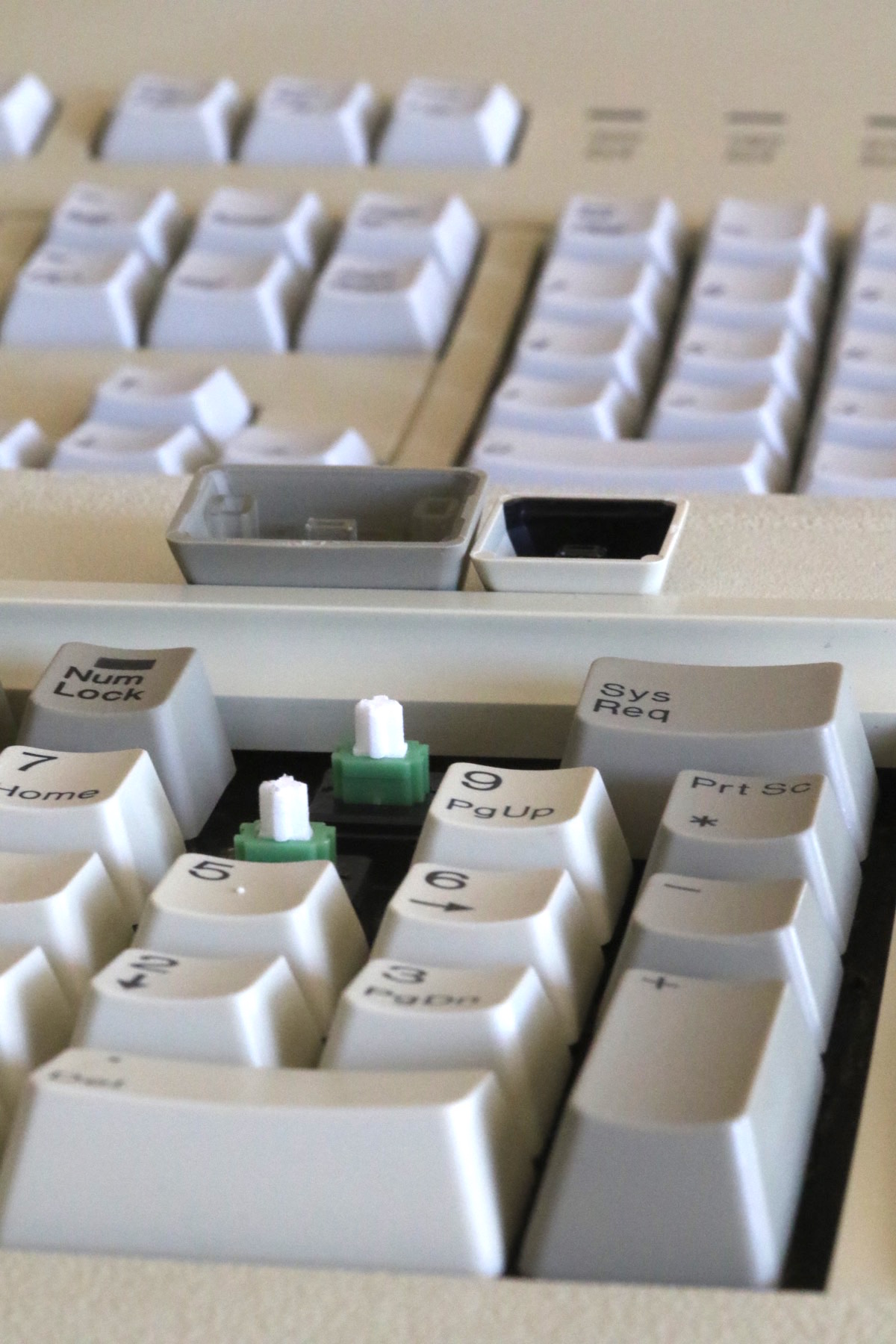

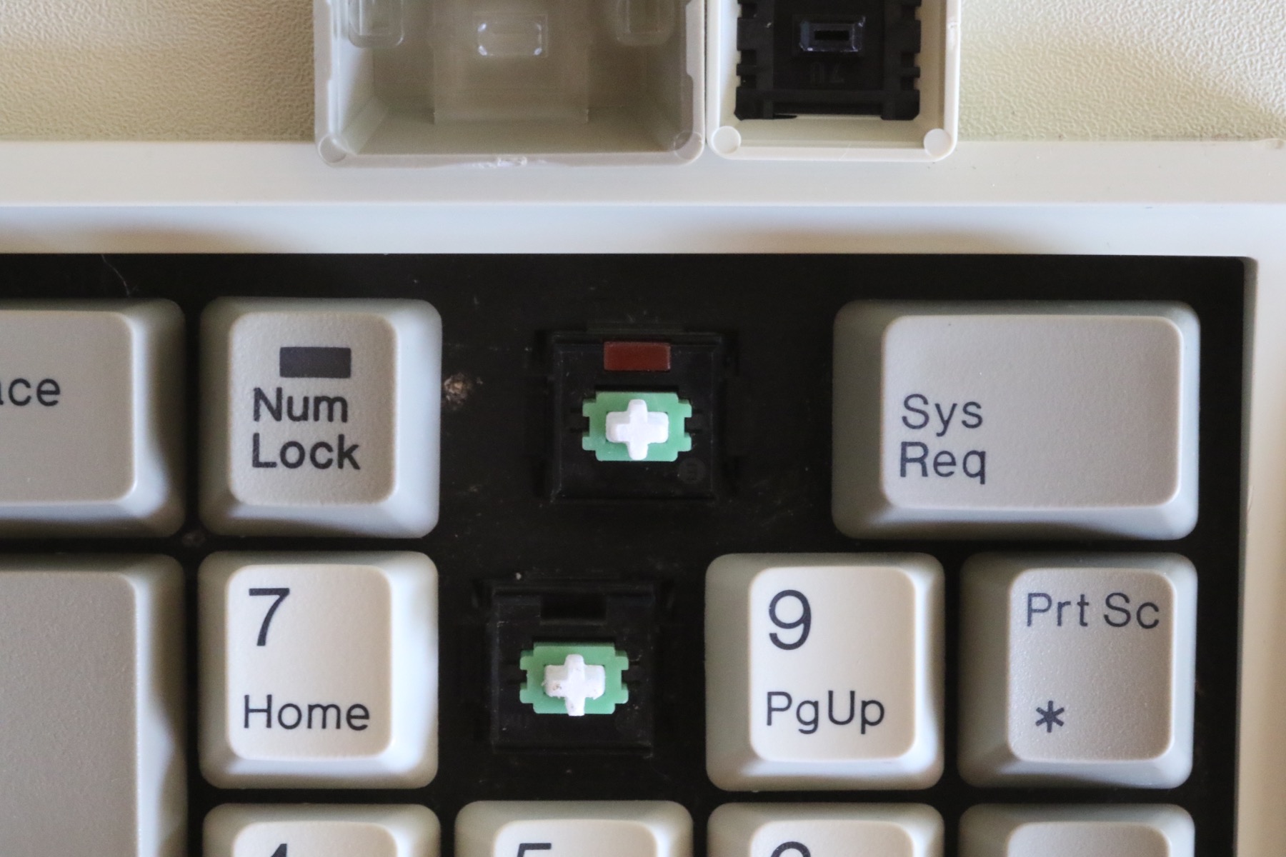

Here's another couple of boards tested successfully (along with my AEK II, SGI Granite and Monterey K110). An original Apple Extended Keyboard with salmon Alps:
And a Zenith (with XT-ish layout, only label says "100-1860 keyboard") with green Alps:
Both are a bit looser than my Monterey with SMKs. Though I don't know if they're a problem, because I don't actually have any MX caps here at all to try them with!
Speaking of the Zenith, it has rather neat clear inside doubleshots on its lock indicators:
Meanwhile, the caps on the AEK are really very nice. Smooth edged, thick PBT dyesubs.

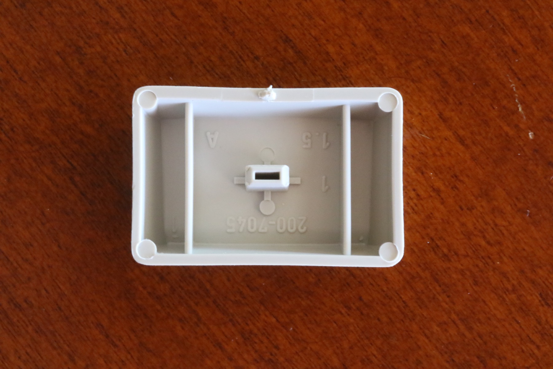

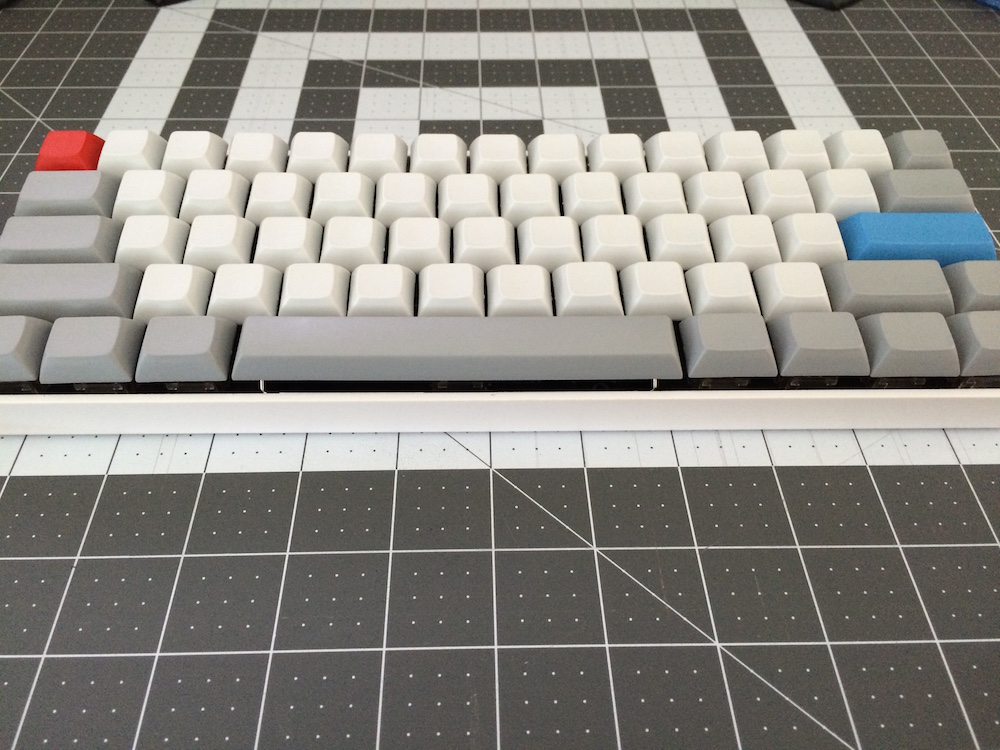

Successfully set up my Infinity with Matias switches with DSA PBT caps.
Infinity with MX caps

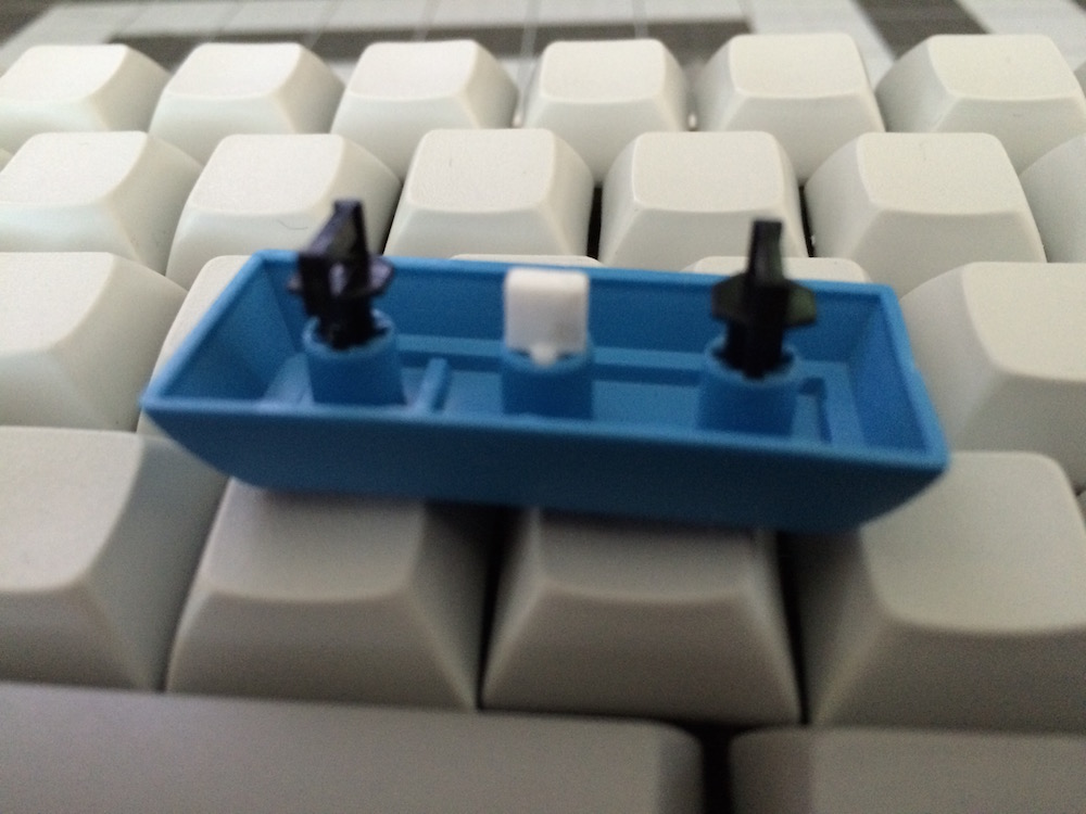

Shot of switch + adapter in keycap
Had to super glue stabs at the right height to match adapters

@Tybenz: Nice work on the stabs. I never did figure out a non permanent way to handle them. How do you find the low profile infinity board with high riding caps like that? How stable does it feel?
tybenz
09 Jun 2015, 20:00
@Muirium: Feels great! Think it would look a little silly with a truly low-profile case. Looks good with the high-profil Poker case and doesn't have a noticeable wobble while typing. This thing is my new daily driver.

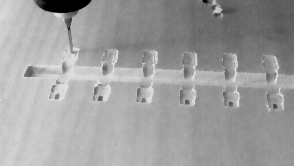

19 Jun 2015, 20:21

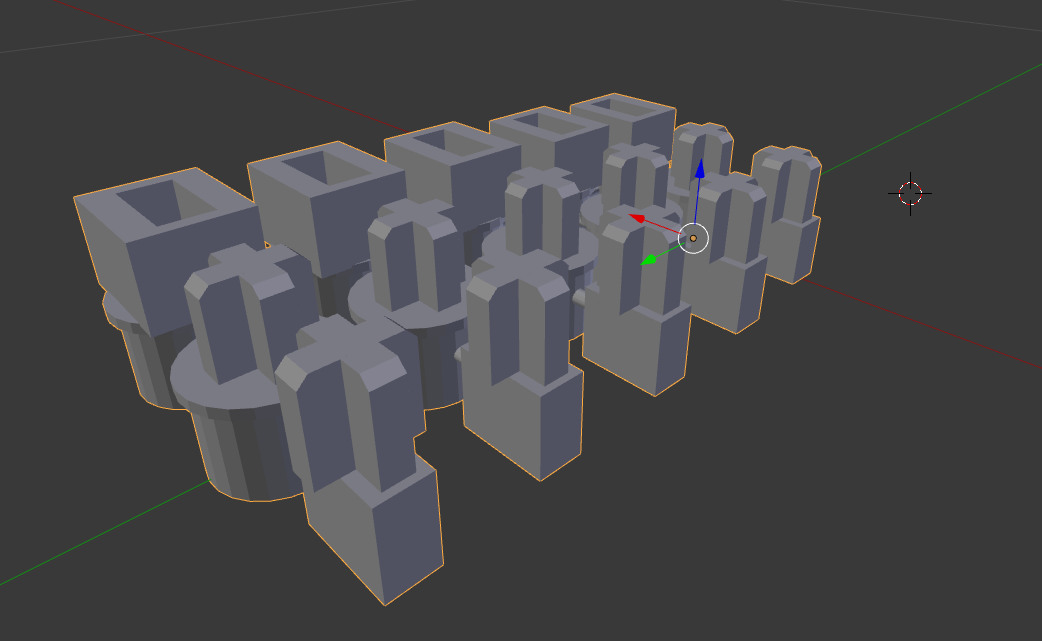

Progress:
That's a mold being prepared for making these adapters in solid plastic!
In a PM:
rsbseb wrote:I know you like pictures. This one is of the adaptor mold. Actually it's just a tool path verification run in poplar with an oversized bit. As you can see its a 12 cavity mold off a central sprue. The tooling run will be done in metal with a very fine profiling bit.
Looks good to me! I asked him about material and when we can expect some prototypes to play with:
rsbseb wrote:They will be abs and should be available in about 2 or 3 weeks
Oh you better believe I have my fingers crossed for these to work nicely with SA! I, uh, may just have a few new caps I want to play with on Alps…
