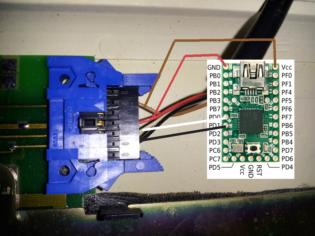

Posted: 10 Aug 2012, 09:03
by JBert
Trent wrote:So the order would be:
1. Flash teensy
2. scas example.sc example.scb
2. scwr example.scb
3. scboot
4. hit button on teensy
5. see if QWERTY keys work?
Trent wrote:*Hit teensy button*
*Try a couple different standard letter keys, no response*
Noooooo!
1. Press button on Teensy
2. Flash Teensy
3. scas ...
4. scwr
5. Unplug / plug Teensy just to be sure
6. Test keyboard
The Teensy's button will only make the controller unusable because it's in "bootloader" aka "programming mode". scboot should do pretty much the same, according to the docs:
Usage:
    scboot
After running this command, the converter should be ready to have new firmware loaded into it. Note that, at this point, the converter will not be working as a keyboard any more! To cancel the bootloader mode, simply disconnect the converter from the computer and reconnect it.
Now get that wiring sorted out and just don't press the Teensy's button, mkay?
Posted: 11 Aug 2012, 05:13
by Trent
Hmm, seems that this board is indeed dead after following your instructions jBert. I'm gonna have to pull out some of the other terminal boards I have and try wiring them up instead. Will post updates when I have completed that task.
