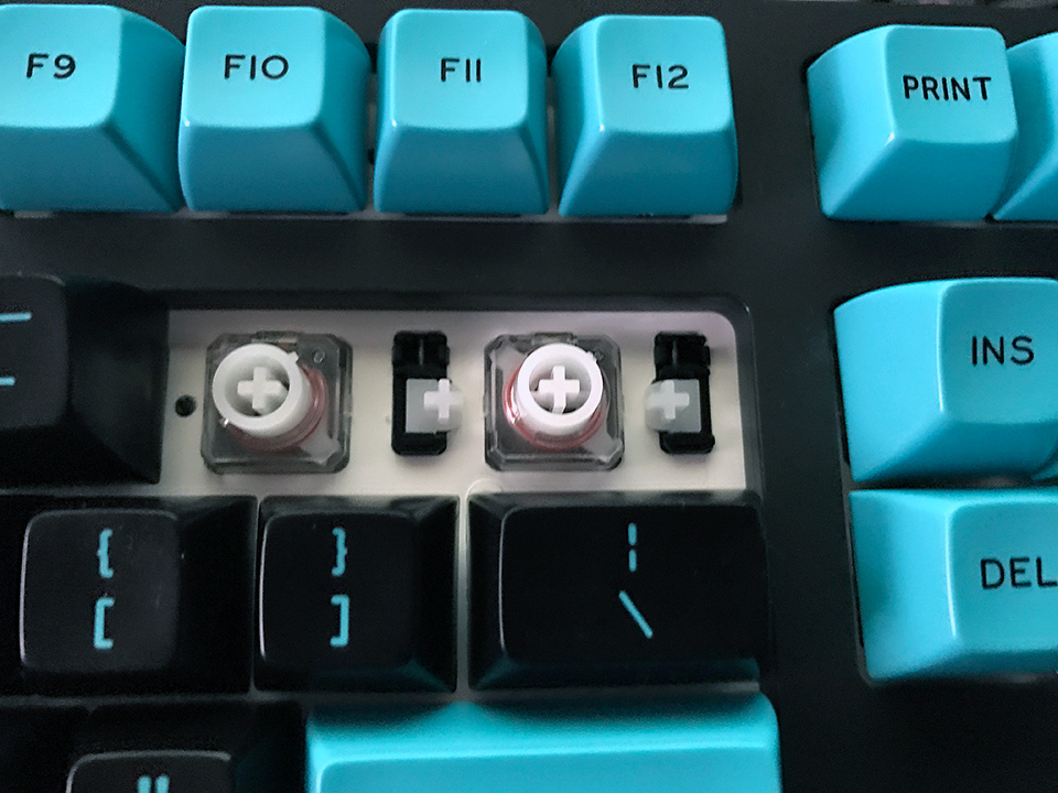

Khers wrote: From your pic, zslane, it looks as if Realforce went for Costar-style stabs on the RGB rather than the more regular Topre-like ones on the Novatouch. Since you have both, would you say that there is a difference in feel between the stabilized keys on the two?
The stabilizers on the RGB are unlike any I've seen before. Completely different from those on the NovaTouch. My RealForce 104UK Hi-Pro doesn't even use stabilizers, so I don't know what a Topre stabilizer is supposed to be like.
RealForce RGB stabilizers

cookie wrote: From what I know the noppos are red little O-Rings, not comparable with silencing rings made of foam.
Yes, they are little red rubber O-rings.
Of course, my problem now is that I might want to get another one of these RGB boards, but I don't know where to get silencing rings.

Yuck. Costar stabs are a pain in the arse. The one good thing they have going for them is a snappy feel compared to (the much more convenient) Cherry stabs. But a Topre board isn't in need of that, the dome feels just fine with Topre's regular stabiliser design. Guess this is cost cutting.

The stabilizers in this RGB are silent, so they have that going for them. They may have been developed to cut costs, I couldn't say, but they feel fine to me. Only time will tell if there are any long-term reliability issues with them.

zslane wrote: My RealForce 104UK Hi-Pro doesn't even use stabilizers, so I don't know what a Topre stabilizer is supposed to be like.
BTW. Normal Realforce and HHKB have stabiliser bars inside the switches themselves. AFAIK they are the same on Novatouch except that there are no sliders to the sides of the main slider - the wide housing is flat except for the slider in the middle. On Realforce (but not on HHKB) even the 1.75 Caps Lock key is stabilised this way.
The Space bar should have stabiliser-sliders though. Novatouch and Realforce use switch housings with a different slider.

Interesting. Yeah, I did notice that on my Hi-Pro. I'm not sure how that helps since the whole point is to stabilize the outer ends of the keycap for when fingers apply pressure there instead of the center. But I don't notice any stabilization issues on the Hi-Pro so obviously it works (somehow).

One bad thing about the Novatouch stabs is that the plastic encircling the mount itself interferes with additional stems on the multi-compatibility spacebars. I had to snip mine off which is no big deal for me as I only planned to use this set on the Novatouch but maybe not so great if you move your caps around to other keyboards I guess.
