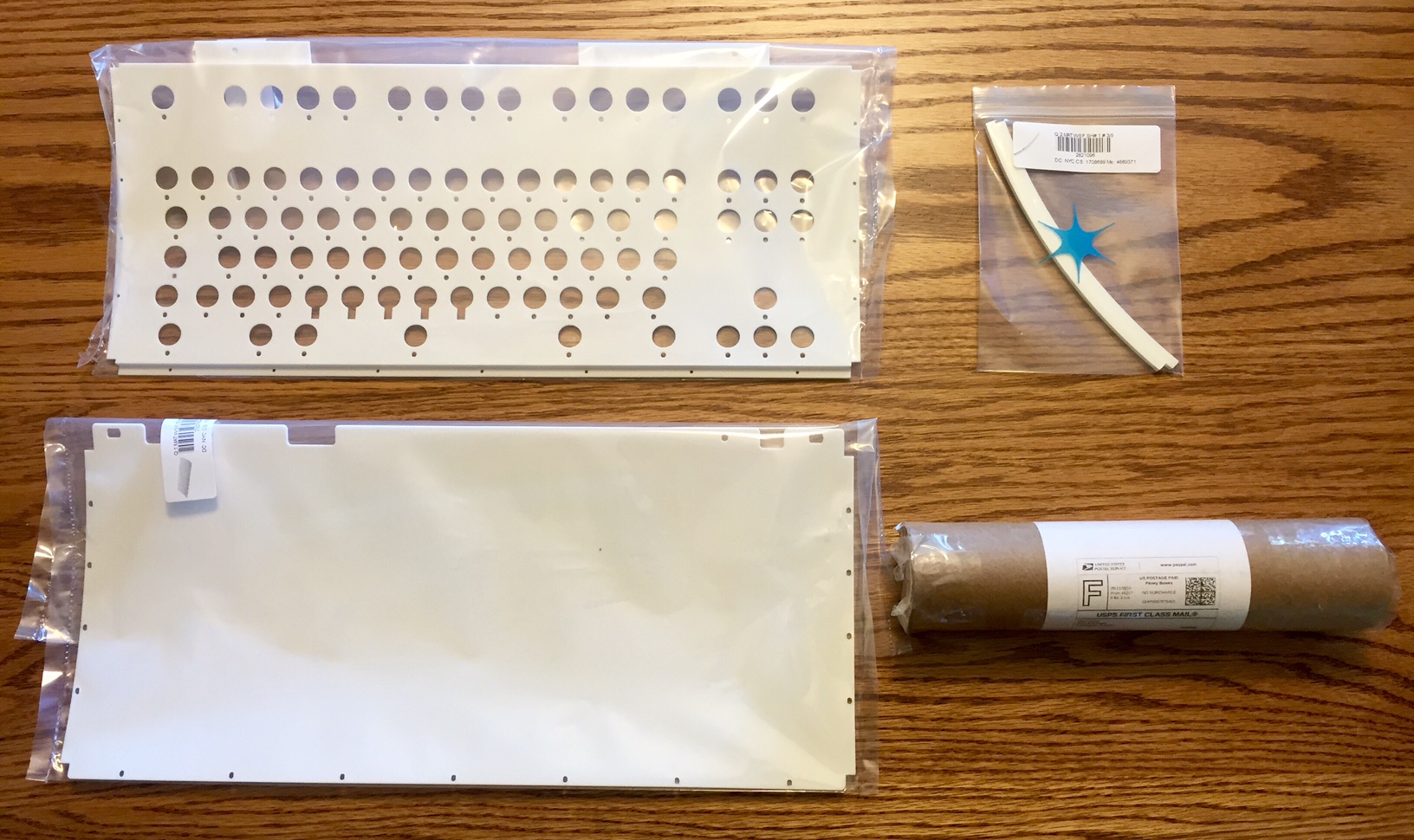

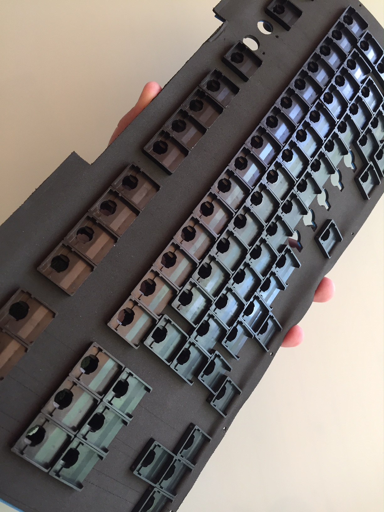

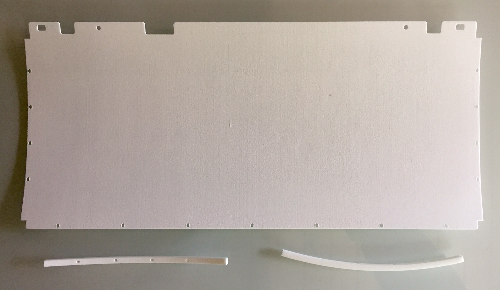

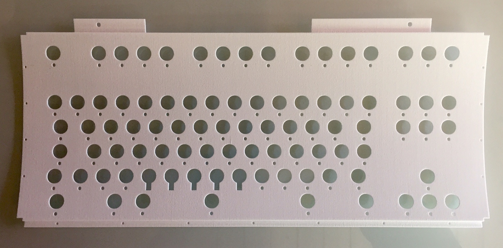

Sorry for the long post, but I have some nice progress to report. When I came home yesterday evening, I had two wonderful little packages waiting on my doorstep. The Shapeways plastic prints had arrived (minus the barrels, flippers, and Cherry keystem adapters), along with the foam that Maxx (Phosphorglow) was awesome enough to die cut for me. AGAIN... the goal of the printing is to test the fit... NOT act as a long term deliverable
My packages...  The plastic parts were from Shapeways, and the little tube is the foam from Phosphorglow

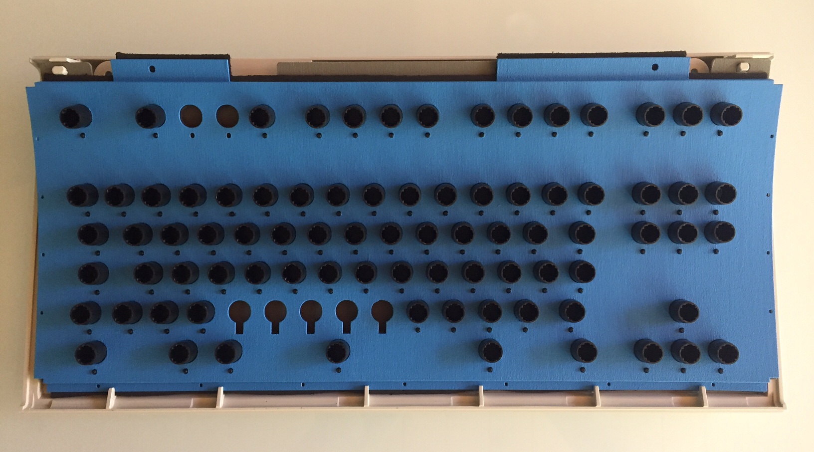

Assembly front plate
Assembly back plate with side spacers

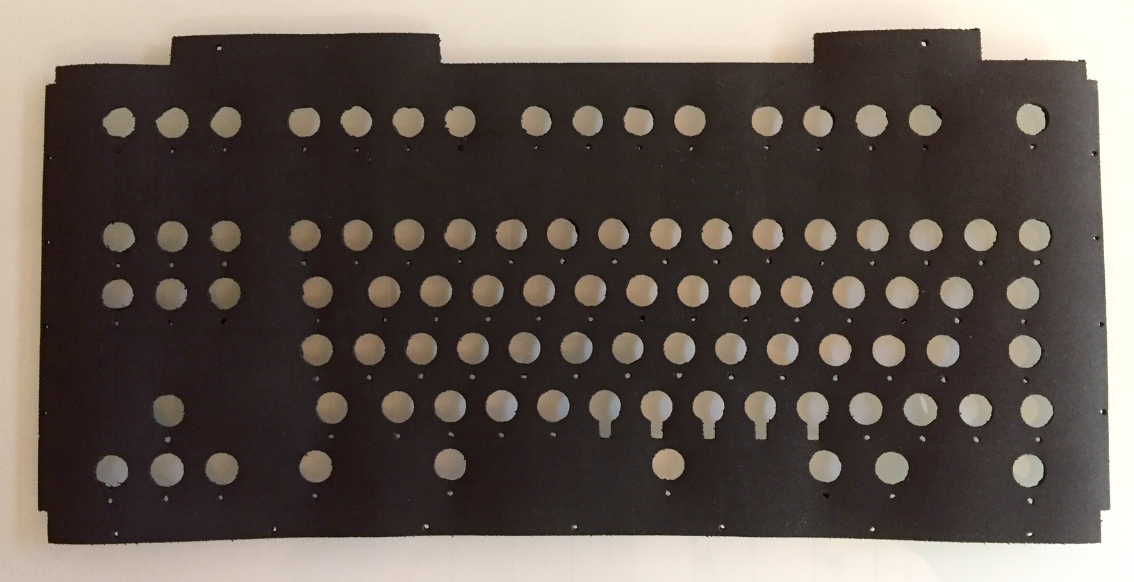

Foam...  THANKS AGAIN MAXX

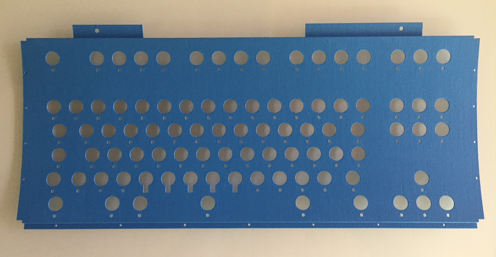

Shapeways strong and flexible takes paint nicely, and thought it would help visualize the stacked plates, so I put one coat on with a high volume low pressure paint gun. I will let you take a guess at what the SSK case the final version will go into at some point ;)... The colors were color matched a couple of weeks ago
Painted top plate
Painted top plate
Painted back plate
Painted back plate

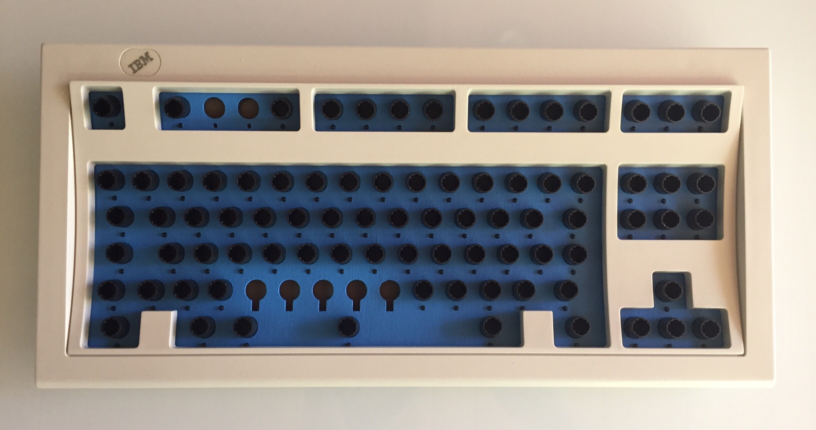

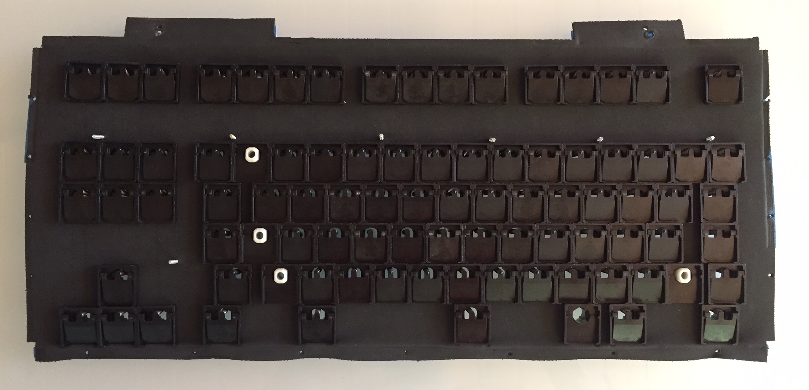

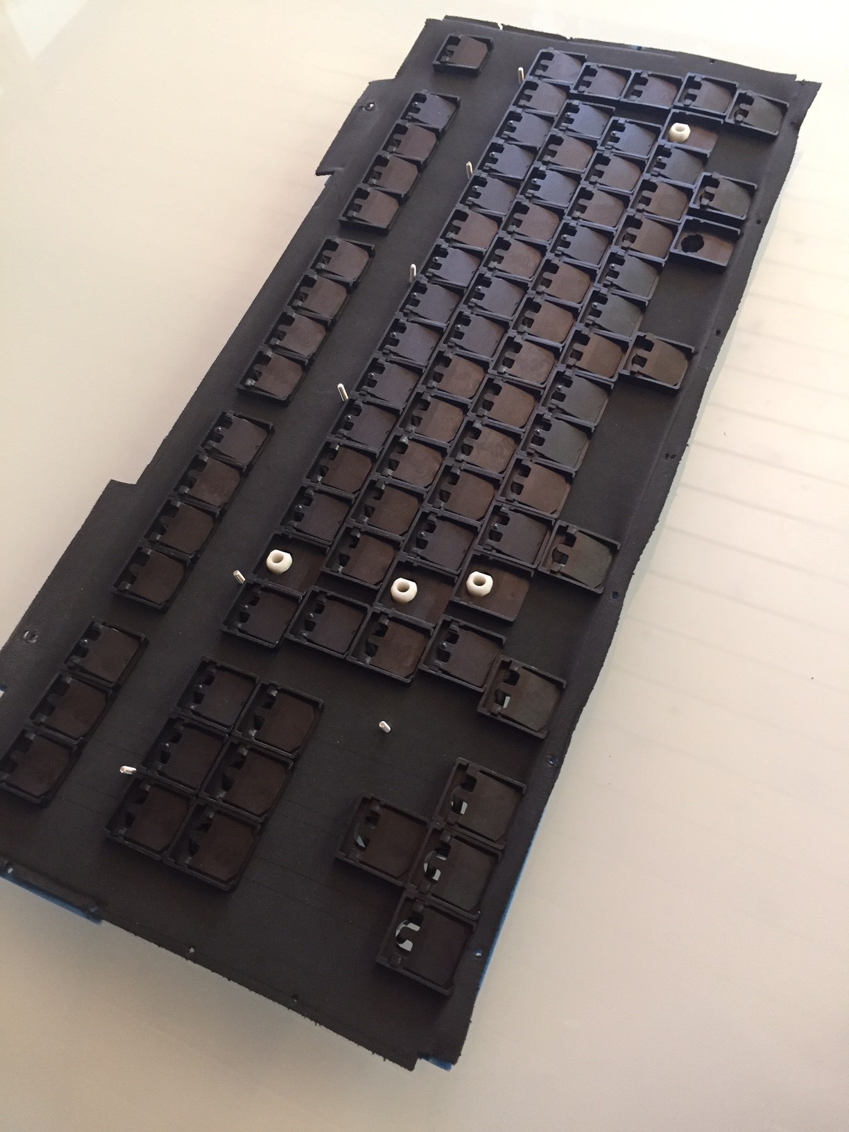

And finally, the assembly plates with barrels and foam. I still need to secure the plates together with screws (will be different for the plastic prototype than the eventual metal version due to the lack of strength of the plastic by comparison... ie... no tapping for a screw). Also, I am not sure if we will design the barrel "locks" differently vs. the round peg used by the XT/Bigfoot, but what I had on hand in bulk for the test.
Assembled unit minus a couple of barrels resting in the lower outer shell (what holds it)
Completely assembled outer shell

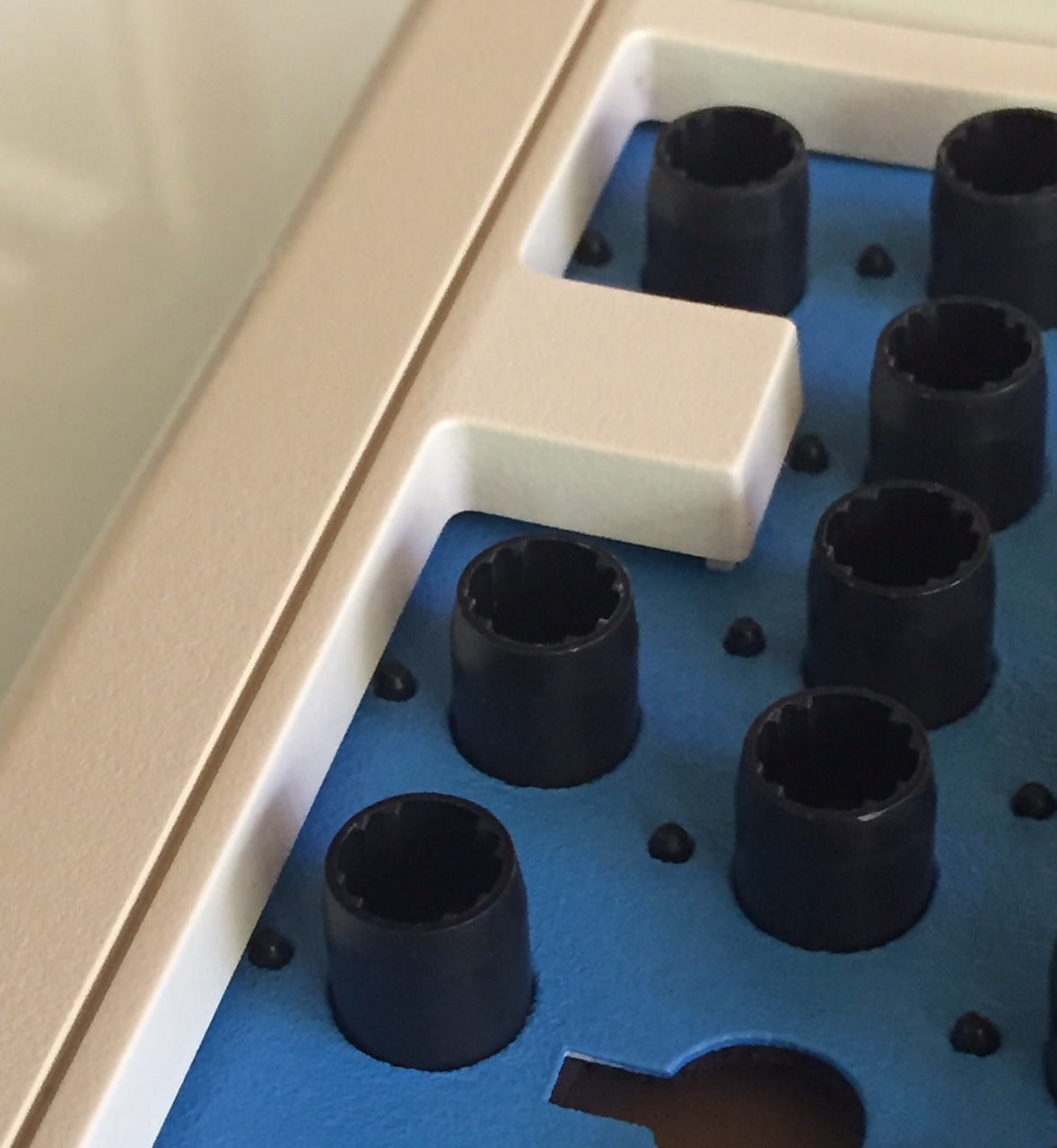

Clearance of the barrel peg from a Bigfoot on the bottom row (the one part that I actually was worried about).  Worked nicely...
EDIT: Added a picture of the barrel fit on the backside of the top plate as I thought it might be interesting
FullSizeRender (7).jpg (597.81 KiB) Viewed 8627 times
All in all... very pleased. I will finish assembling the unit with screws and the PCB, play with it for a couple of weeks as my daily driver (it is rigid enough to be fully functional), and make any tweaks that are discovered along the way.

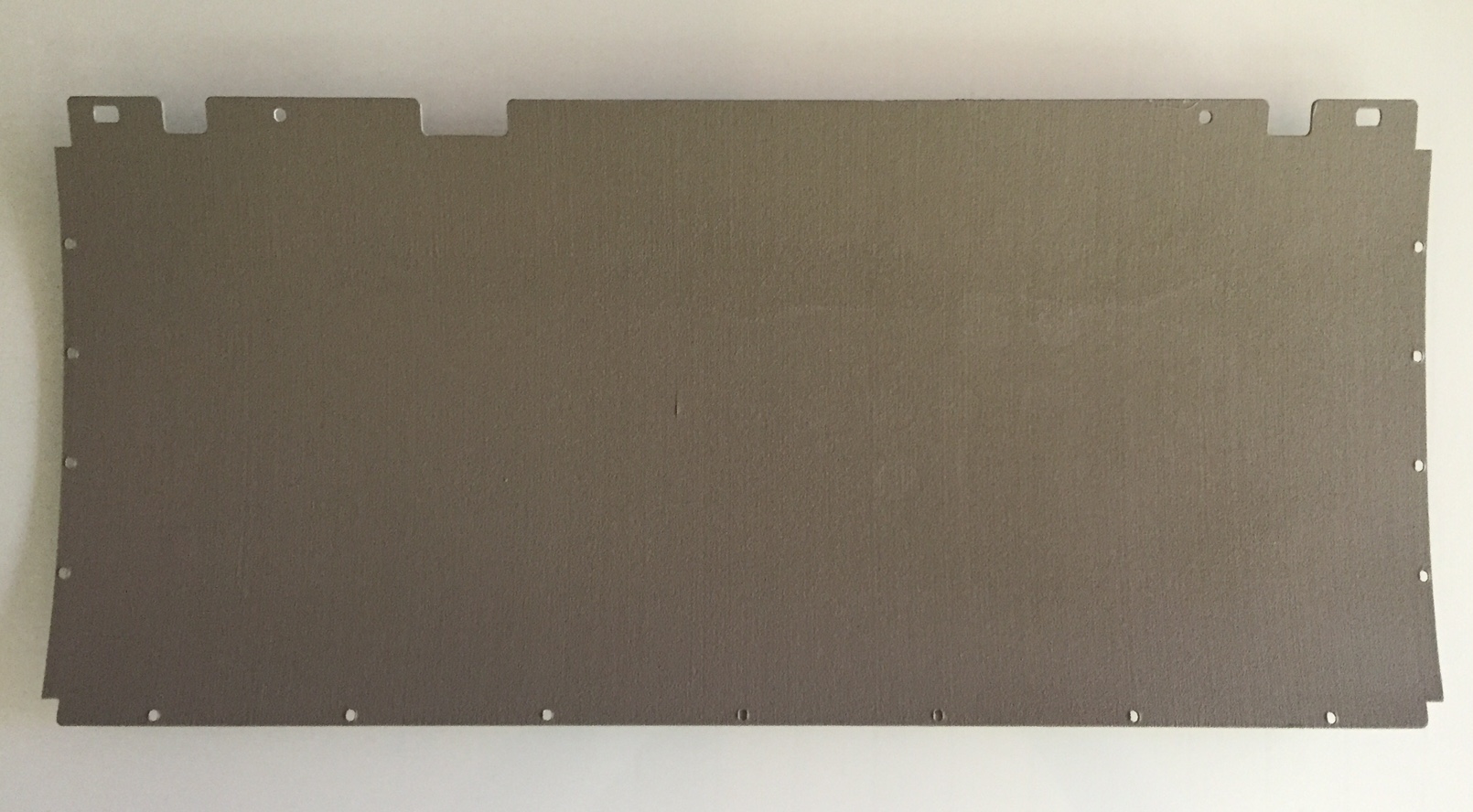

lot_lizard
17 May 2016, 22:56

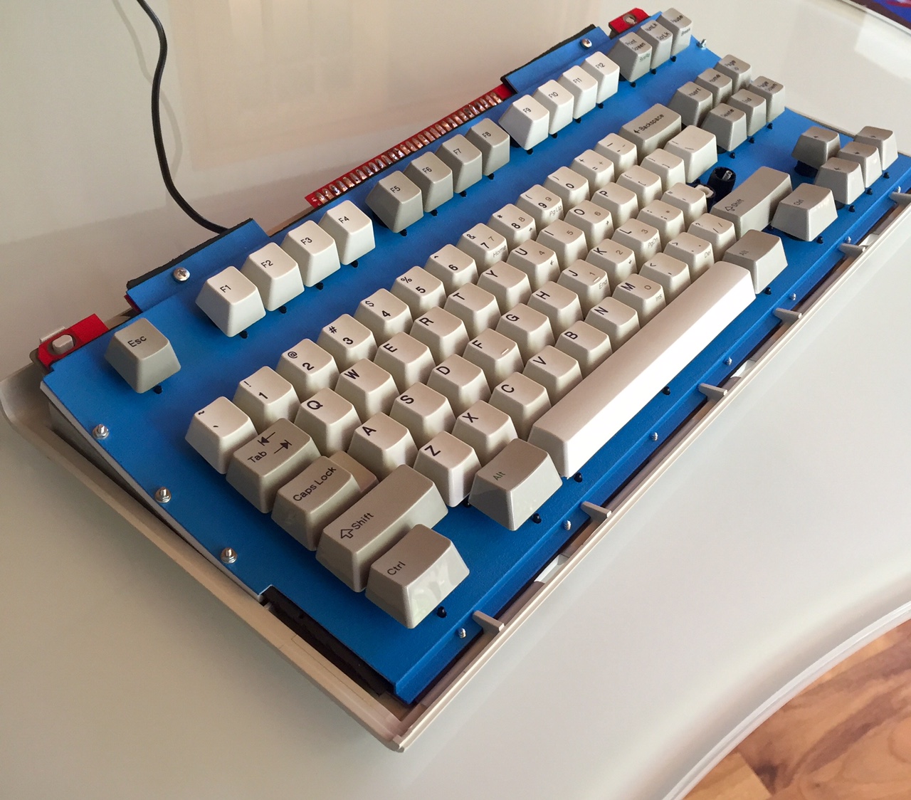

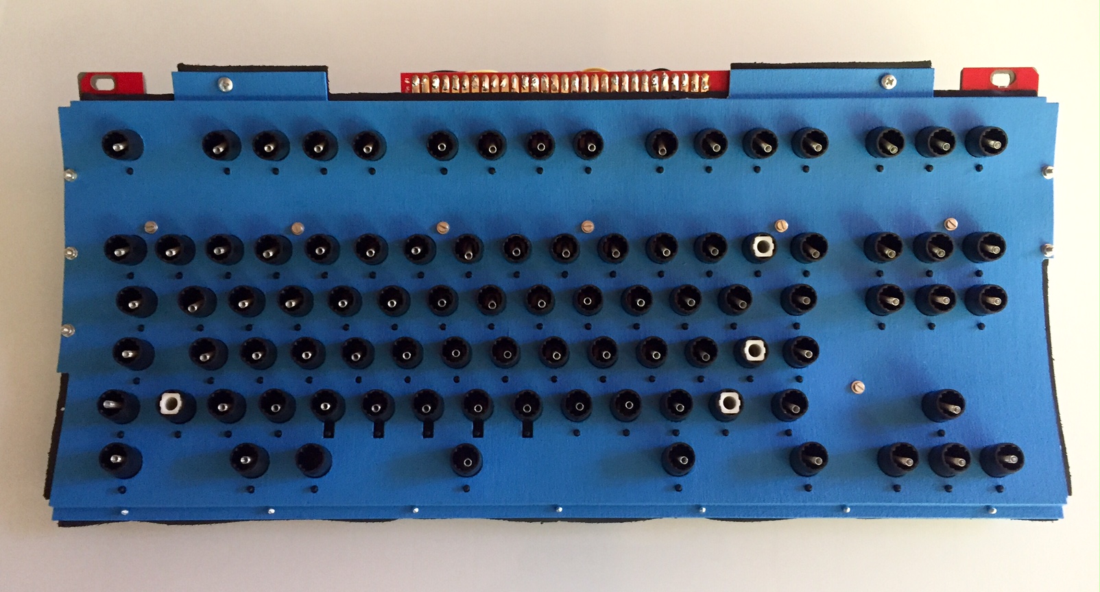

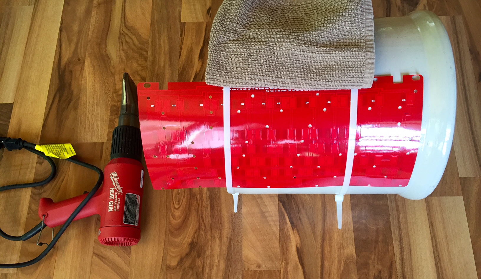

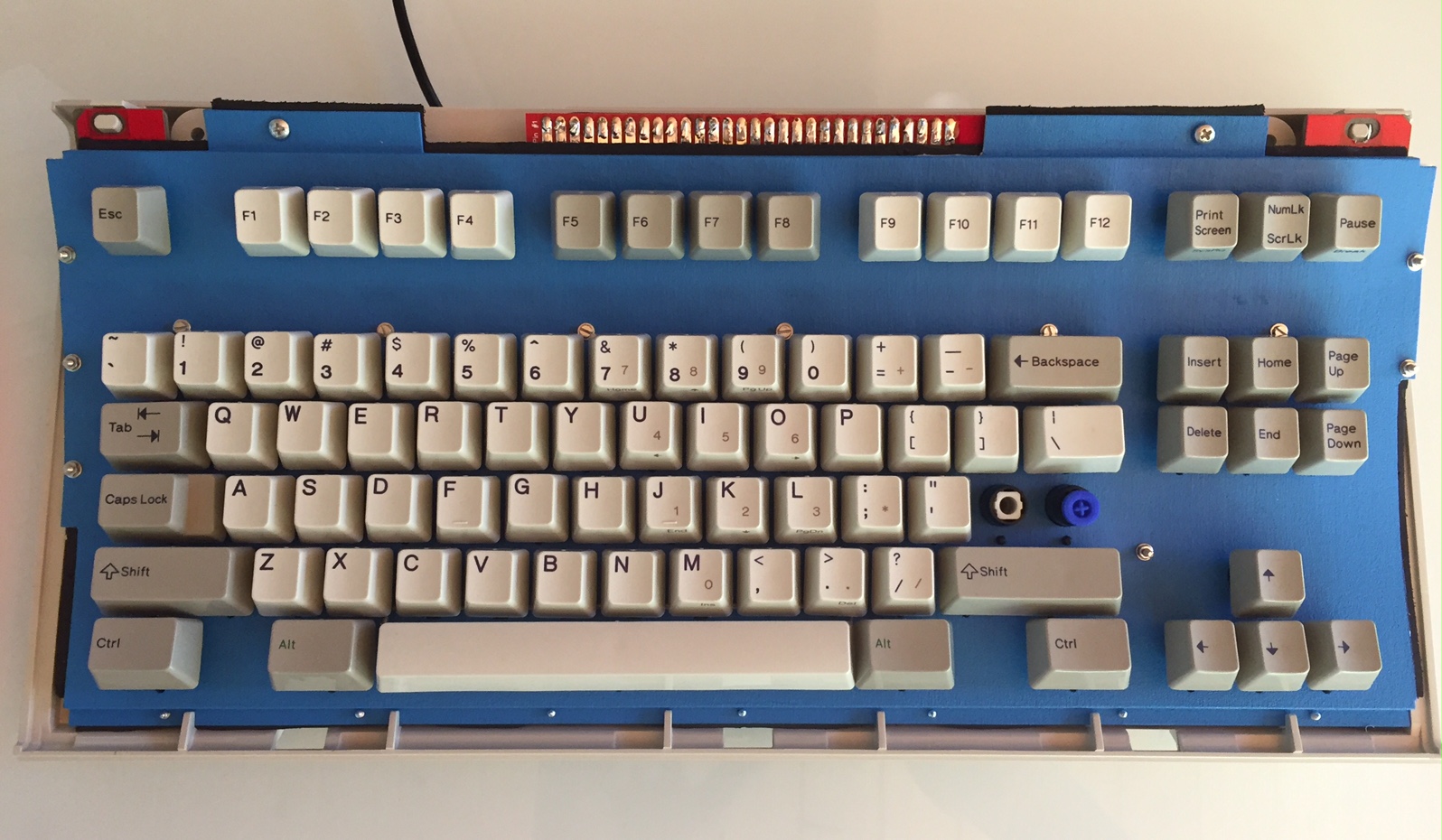

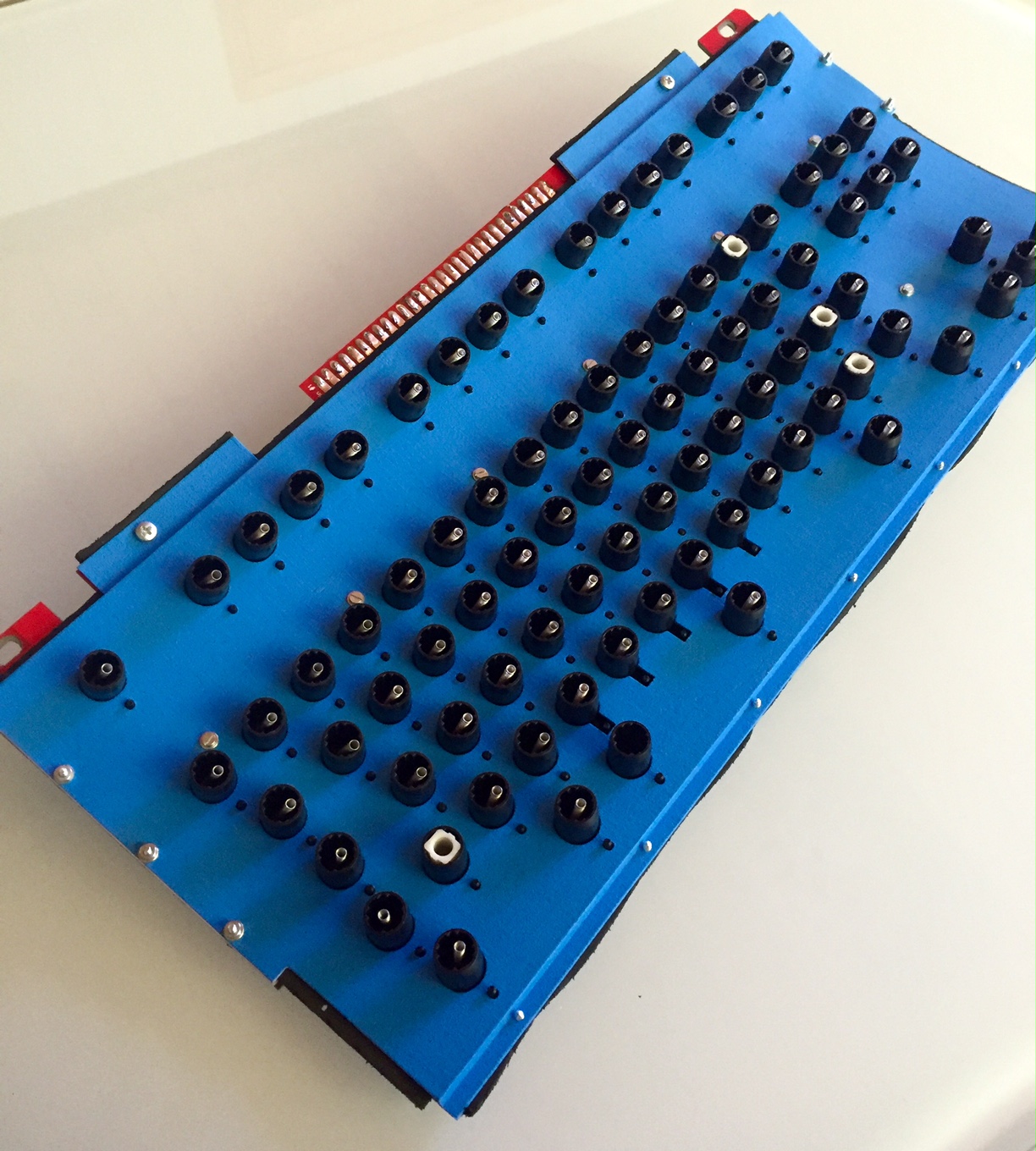

Thanks everyone for the feedback... its been a fun journey. I am happy to report that I am currently typing from it (though the plastic is too wobbly in the middle of the board to be desirable for a long term solution).
Started with bending the PCB (I had a REAL need to do so since any undesirable pitch in the PCB alters the entire assembly since the plastic is so flimsy). I have a heat gun (which makes short work of it), and needed the complete curve to be uniform. I used a 4 gallon ceramic crock to achieve the desired bend. Worked beautifully
PCB bent using heat gun and crock.  NOTE: I took the picture in the office, but did the work in the shop :)
FullSizeRender (14).jpg (604.86 KiB) Viewed 8546 times

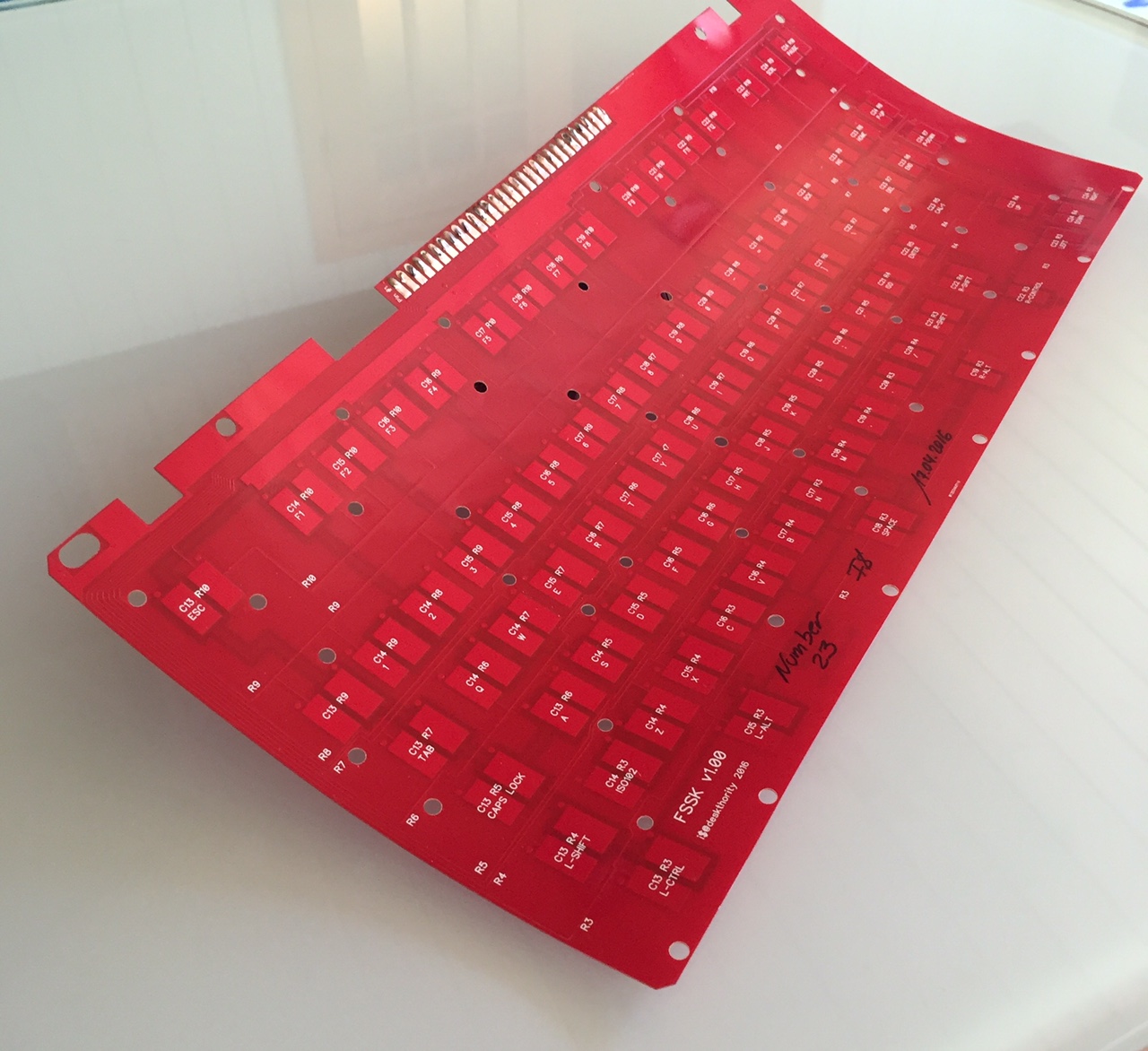

Curved PCB after heating
FullSizeRender (9).jpg (354.46 KiB) Viewed 8546 times
Then the assembled the top plate with flippers and stabilzers. NOTE: I did add a few pass through bolts to the middle of the board knowing ahead of time it would be a flimbsy mess without it. This plastic is SO flexible. Its actual a bit comical to type on
FullSizeRender (8).jpg (322.98 KiB) Viewed 8546 times
The result after assembly
FullSizeRender (10).jpg (412.46 KiB) Viewed 8546 times
FullSizeRender (11).jpg (486.34 KiB) Viewed 8546 times
And finally, with one piece keys from another SSK (1397681). If you were wondering, I used the printed Cherry MX mount adapter stem for the Enter/Return key. The adapter looks tilted in the photo, but it is perfectly vertical
FullSizeRender (13).jpg (424.05 KiB) Viewed 8546 times
FullSizeRender (12).jpg (405.08 KiB) Viewed 8546 times
The action of the keys on the edges are exactly as I had hoped. SUPER light, crisp, and clean. Almost identical to an F, and light years ahead of my M's. I broke the Kishsaver out to compare, and I can't tell the tactile difference (slight audible difference... but remember, I'm on flimsy plastic for a top and bottom plate). The middle is less enjoyable as expected due to the plate flex. If an audio file is interesting to anyone of the M vs this plastic F, let me know, and I will slap something together
I did make three adjustments to the end design. The first was expected. I had to shorten the spacers on the sides for clearance. It was difficult to gauge that before having something physical in hand, and if we ever want to design our own cases, the full length spacer on each side is definitely desirable. The second was the notch in the backplate for the PCB wired connection. I'm not sure what others are doing in that space, but I removed the portion of the plate applying pressure to the wiring. And lastly... I did make one mistake on key layout. The Right Alt needed to be shifted away from the space bar ~1mm (the keys lightly touch). One other thing, the voltage threshold for the xWhatsit needed to be increased from 116 to 122 after bending the PCB. These capacitive circuits are touchy animals. Hats off again i$ for getting this PCB to work in the first place.
All in all... very pleased with the result, and lack of changes needed. I don't think I am going to wait for any "burn-in" before chatting with metal fabricators. The RFQ (request for quote) process takes several days, but I will report back. I plan on having a metal duplicate made for myself first, and will let everyone know the costs involved on larger quantities. Personal opinion, we are VERY close to making this real.

I did just send off for the metal cutouts since I don't have easy access to a water/laser jet cutter. 190 holes for a single top plate is more than my little mind can process on a drill press :). I will roll and break the top plate myself to experiment with the radial bend. I should have something (a fully functional metal prototype) in 2-3 weeks.
i$ and I are starting discussions about a GB. This is basically the equivalent of the the Ellipse F62/77 project (minus the case), so we might need a little bit to work out the dynamics. There are things to consider like shrinking the PCB to its minimum, altering the top plate to match the form factor, using the model M xWhatsit (if available), etc. Patience is appreciated. We are inching closer though
EDIT: This is an absolute horrid rendering from Big Blue Saw, but might be interesting to some. The prototype top and bottom plates will be .048 inch cold rolled carbon steel (18 gauge = 1.2mm). I will blast and paint (matching the color scheme of the plastics) both plates after I roll and break them. Unless we decide to change the barrel "lock" from a peg to something else... this will be the final design
Top plate
Top plate

If we get real interest in this, I would like to see the barrel and flipper prints I put together work out (they deliver around the end of the month from Shapeways in HD print to test dimensions and functionality... along with the Cherry MX conversion key stems).
I am actually the one yahoo on planet earth that truly loves the Bigfoot, and would hate to see potentially dozens of XT's and Bigfeet sacrificed. I am confident in the designs of the barrels/flippers, and will need to work out a conductive plastic to mold them with, but I have checked on pricing... and it is trivial in any real bulk (10+ boards). I did send off a flipper to the local lab to have FTIR tested (link at the base of this post if curious what that is) to see what these things are REALLY made of. We have speculated, and I did ask around, but no one has ever actually tested one that I can find. The F62/77 project is using a conductive ABS (which these might be just that), but I would like to get it right without question. I have tested the resistance myself using nicer equipment, but it is still a crude method compared to the FTIR.
But... having said all of that. It wouldn't be a bad idea to have an XT/Bigfoot (plus one flipper, and two barrels) on hand :)
https://en.wikipedia.org/wiki/Fourier_t ... ectroscopy
EDIT: The springs are nothing special, and very inexpensive to produce in bulk (neighborhood of a dime USD a pop). It is just a matter of diameter of the spring (OD and ID), coil count, length, and material. Keep in mind that literally 2 boards has us in "bulk pricing" because of the number of keys (84). It's goodness...
