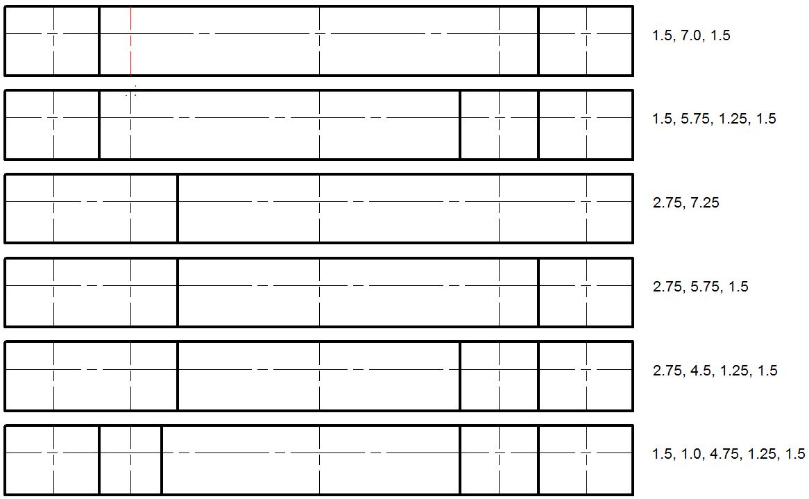

Techno Trousers wrote: Ooh, so exciting!! I think you got all the combos for the bottom row, except for one very special case. In lot_lizard's Model MF project, the plate supports a dual space bar setup. One of the space bars is the Code key layout. The other is, I believe, a 2.75u shift key, which has a different stem location than the code key.
I'm not sure whether it's worth your time to make a 2.75 shift key convex mold, though I have a feeling that those who are planning to use that layout on their MFs would give your their undying love!
In your excitement I think you missed it - the 2.75 "code" key is on the list and will have a modular stem system that will allow for it to install just like the right shift does on lot_lizzard's layout ;)

rsbseb wrote: My question centers around the bottom row. I have five keys modeled with a convex surface 1u, 1.5u, 2.75u (code), 7u, 7.25u
1u, 1.25u, and 1.5u are used on the bottom row, but these are usually concave.
7u and 5.75u are the only common convex caps. 2.75 and 7.25 are rare (take 3 keys and replace them with two!). The 2.75 probably has a future - 7.25, probably does not. You could make 5.75u, 4.75u, and 4.5u to work like the examples below ...

wcass wrote: 2.75 and 7.25 are rare (take 3 keys and replace them with two!)
The 2.75 / 7.25 layout is what's on my Wheelwriter. I don't think I've seen it anywhere else. It's not bad and I personally like bigger space bars but will probably downsize for the sake of symmetry. Thanks for the proposed configuration chart, that helps a lot.

Techno Trousers wrote: I'm liking the thought of an all convex bottom row, evocative of the old beamspring layouts. The nice thing is that by having the molds for both versions, we could choose whether to go convex or concave for the modifiers.
A couple of years ago I had a few people begging me to do a convex bottom row for SCM so I'm thinking I will try to make it available with this project. :)

Master key list for SBS, am I missing anything?
Standard Spherical Keys-
1u - 1.25u - 1.5u - 1.75u
2u - 2.25u - 2.5u - 2.75u
Special Shape Shperical Keys-
2u vertical Enter
ISO Enter
Convex Spacebar Profile Keys-
1u - 1.25u - 1.5u
2u - 2.75u
4.5u - 4.75u
5.75u
6u
7u
7.25u
That's a total of 20 key profiles :shock:
*edit - added 2u convex for F/XT layouts

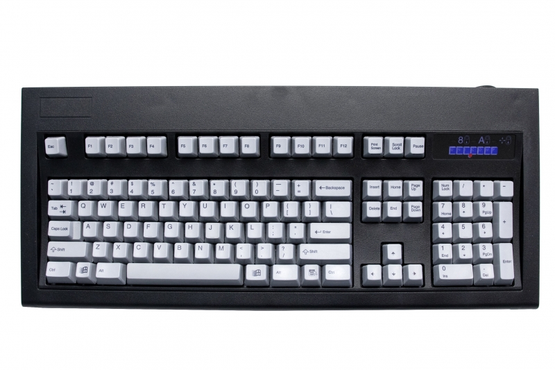

So, for completeness, I wanted to link lot_lizards picture of the Model MF mockup with dual 2.75 spacebars. In terms of wcass's theoretical layouts, this is 1.5/2.75/2.75/1.5/1.5. Of course it also requires extra plate holes, so it would only be usable by Model MF owners. I hope this will be a growing market in the future, though, since lot_lizard plans to continue development on the MF concept.
rsbseb, before you dive into making ALL of the oddball sizes that wcass proposed, you might want to take some polls to figure out if anyone will want to use them. I do think a 5.75 space bar is important, because the 1.5/5.75/1.25/1.5 layout matches Unicomp's 104-key models, right? Owners of those keyboards (and maybe even Unicomp themselves) could potentially be a good source of cap buyers.
Unicomp 104 layout
Unicomp 104 layout
I thought of one other thing too-don't you have to mold the space bar keys special because of the necessary wire stabilizer points? Or does your modular system take care of that too? I can't wait to see how that works. The code key and shift keys have stem positions that are shifted by a pretty small amount...
Again from lot_lizard. Right shift is on top, Code on the bottom.
Posted: 07 Apr 2017, 22:54
by rsbseb
The wire stabilizers mount to tabs at the ends of the keys and will be integral to each one and not related to the stems. stem alignments on the code key will be optional for both configurations.
As for the special sizes I am open to conversation on the issue. I'm pretty sure the 2.5u and 6u keys will drop from the lineup before it's all said and done. Perhaps others as well if there is no interest.
