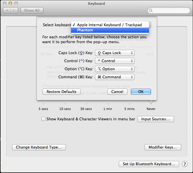

Is there an updated firmware that needs to be checked into the Git repository (https://github.com/BathroomEpiphanies/Phantom-Keyboard)? The one I pulled down tonight has a rather peculiar quirk. When I short the holes for a switch, it will register that switch the first time, but as it repeats itself, it switches to the key in the column to the right. For example, if I short out the pins for the letter "J", then the first key press will be registered as a "J" but then it will immediately switch to repeating "K".
If there's no update ready right now, then I'll start tinkering with the firmware to try and fix the issues. Are there any processes we should be following for check-ins other than "test before check-in"? :)

by gimpster

Yup, using OS X. I don't know enough about the hardware yet to completely rule out something I might have done during soldering, however both of my boards exhibit the same behavior, so I'd guess not. Thanks for taking a look though, if you have the time to write up a quick primer to help people get up to speed on the code, that would be wicked cool :mrgreen:, otherwise I'll just take some time to dig into it, there's not too much code there to read through (been a LONG time since I wrote C, though ;) ). I've forked the repository into my own branch, so for now I'll work on OS X support in there. Anybody interested in following that branch can find it here:
https://github.com/gimpster/Phantom-Keyboard

Yah, so OS X has a "feature" that changes the standard behavior when you are holding down a key. In this situation on OS X Lion (maybe back as far as Snow Leopard) it doesn't repeat the character like it will in Windows or Unix, instead it pops up an on-screen character picker so you can pick variants of that letter. For example, I could type "e", but if I hold it down, I can also type è, é, ê, ë, ē, ė, or ę. My suspicion is that it has something to do with this, because when I type on my Filco, I get those options, but not when I type on the Phantom, there it just repeats the character.
