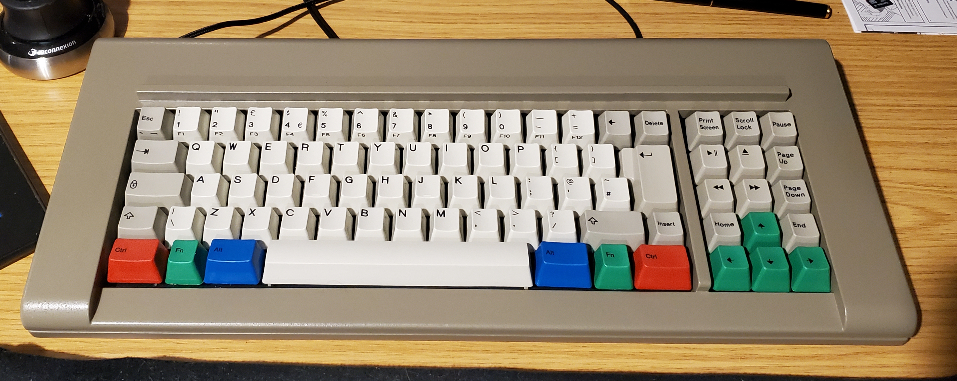

03 Nov 2022, 21:02
Finally *almost* settled on a layout I'm happy with on my UK layout.
I fancied a little splash of colour variety on my keyboard so I've gone with some Unicomp coloured caps.
I found my hand kept wanting to go up to the top to find delete for some reason so I've gone with a split backspace now which is working well.

Obin
04 Nov 2022, 03:43
ivor_h wrote: 03 Nov 2022, 21:02 Finally *almost* settled on a layout I'm happy with on my UK layout.
Interesting... and uncannily similar to my own layout. We seem to have come to some of the same conclusions.
I'm still a bit bothered by the differently shaded ISO-Enter. I still don't get why the pebble colour couldn't be matched with IBM and Unicomp's...

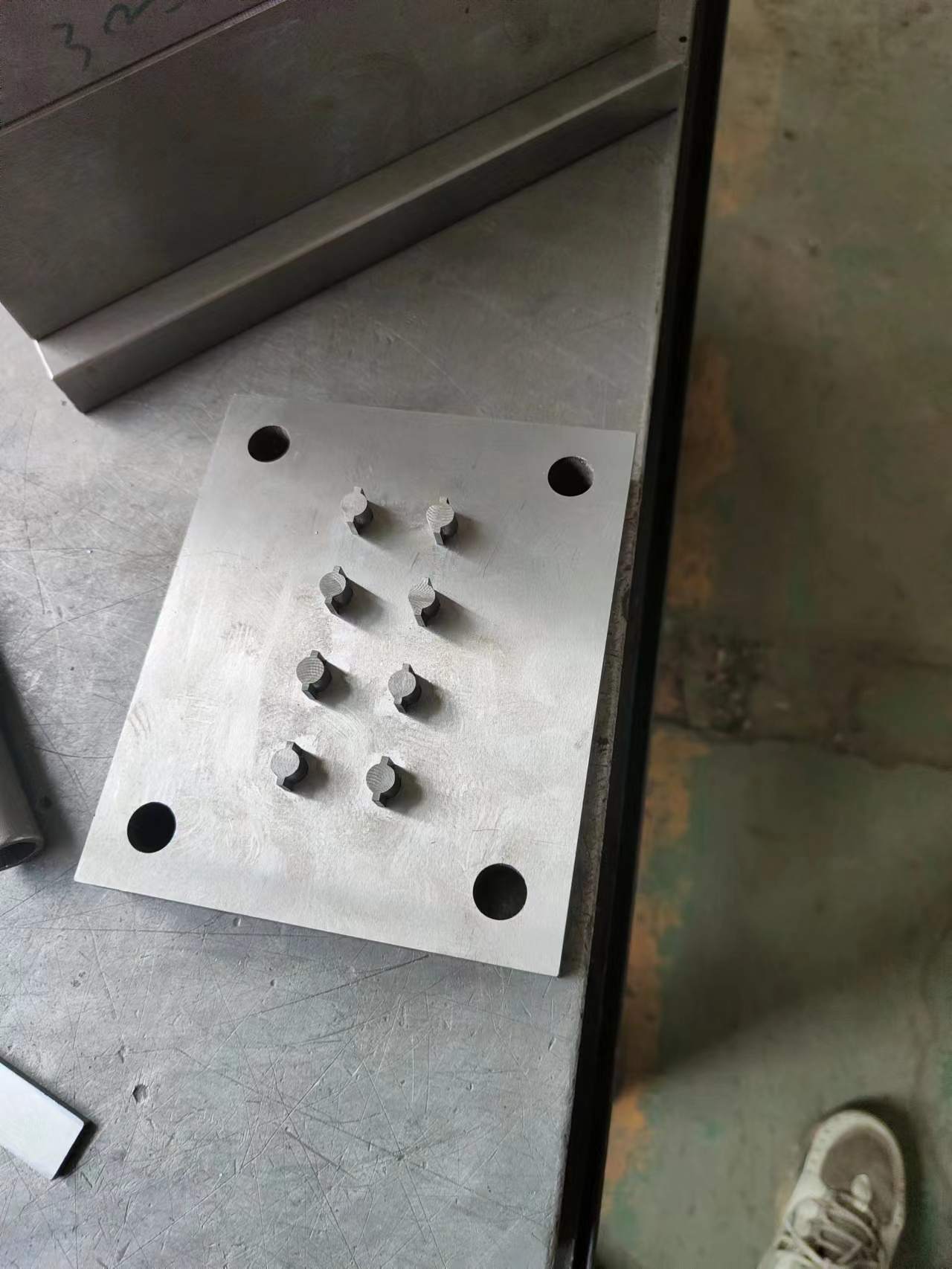

Ellipse
12 Nov 2022, 20:03

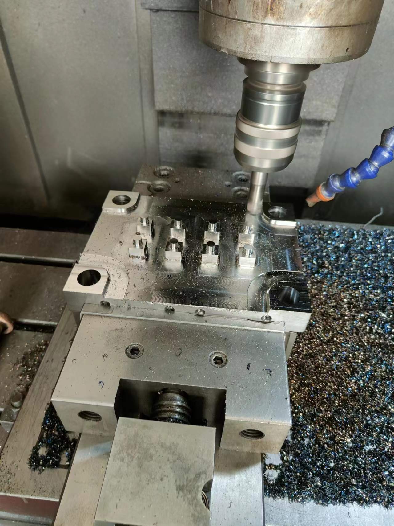

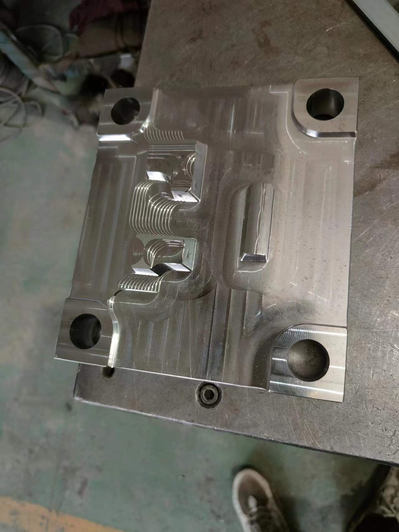

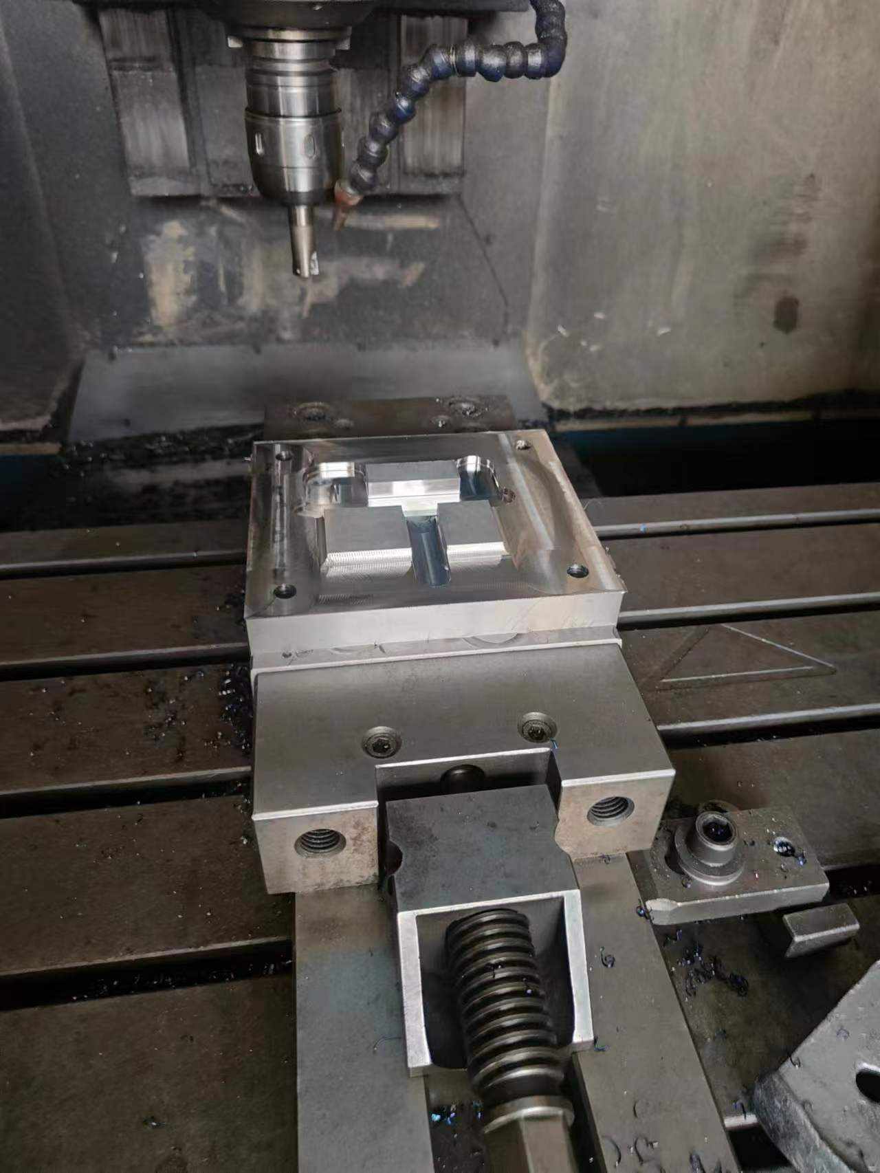

In addition to my request above for some Model F video clips from 10-20 folks and feedback on the draft script for the video, below are some photos showing the new key and beam spring module molds currently being made at the factory, as well as some customer images I am posting with permission. One image shows a custom right side block, while the other shows the F77 with Industrial SSK 12 key set and the F1-F12 front printed keys. Glad to share both of these images as I have not seen too many photos of these customized layouts.
Also please do send in the feedback on the draft manual posted earlier this month, by PM, email or replying here on the thread.
As noted in some earlier posts, we are currently in the final round. A new change for the project is that there is no more made to order - the various keyboards and extras are in stock so I have a lot of keyboards ready to go out. I think a video will help get the word out about these great old style keyboards.

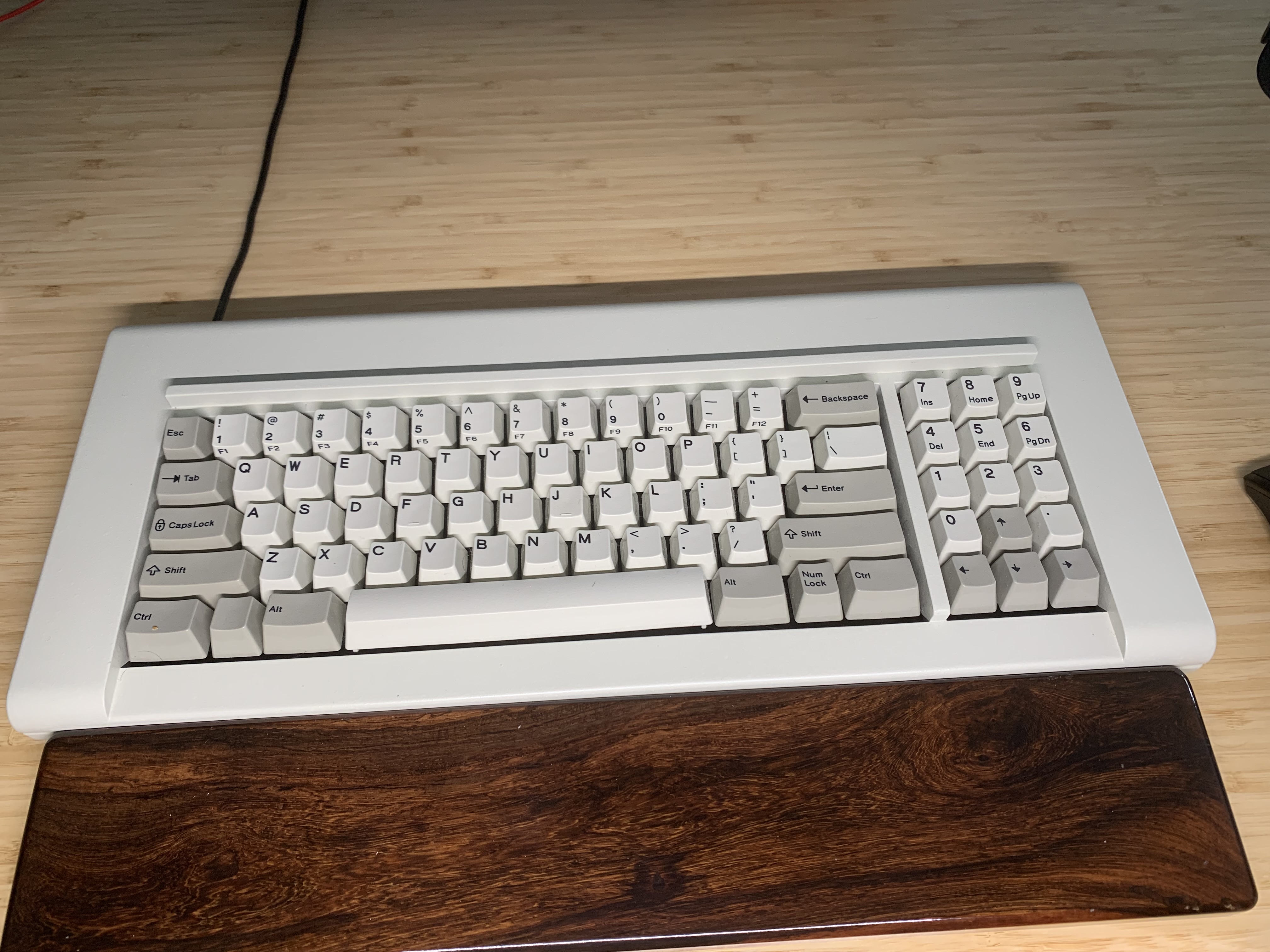

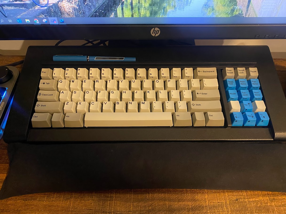

lucwilride
14 Nov 2022, 16:54
I finished my F77 this weekend, very happy with the result! The key feel is spectacular and puts my mx style boards to shame. The build process was generally straightforward, I had to swap around a few springs but the methods in the manual explained this process well. So far no buzzing springs that I can hear. I also used QMK/Atmel Flip to remap the board for my layout which went smoothly. I had to read the manual a few times and jump around a bit but the instructions are all there. Admittedly previous experience with QMK helped with this. One comment about the Firmware section of the manual. I thought the section labelled "For those flashing firmware for the first time on a computer:" would be better placed at the start of that section or made more obvious.
My left shift is still binding somewhat, I've tried the methods noted in the manual to fix this but I can't seem to get it to actuate smoothly. The two arms that clip into the barrel on this keycap are visibly narrower than the other keys as moulded. I've used as much force as I'm comfortable with to bend them outward but they won't stay and I'm reluctant to use heat. It sounds like the spring coils are moving against another surface as I compress the key. The spring was in the 12 o clock position and the board was held upright while installing that key. I'm wondering what other options I can try to resolve this aside from ordering another Shift keycap?
Ellipse
14 Nov 2022, 18:44
lucwilride nice photo! Please try the wiggle method as described in the manual - works for me for extra wide keys.

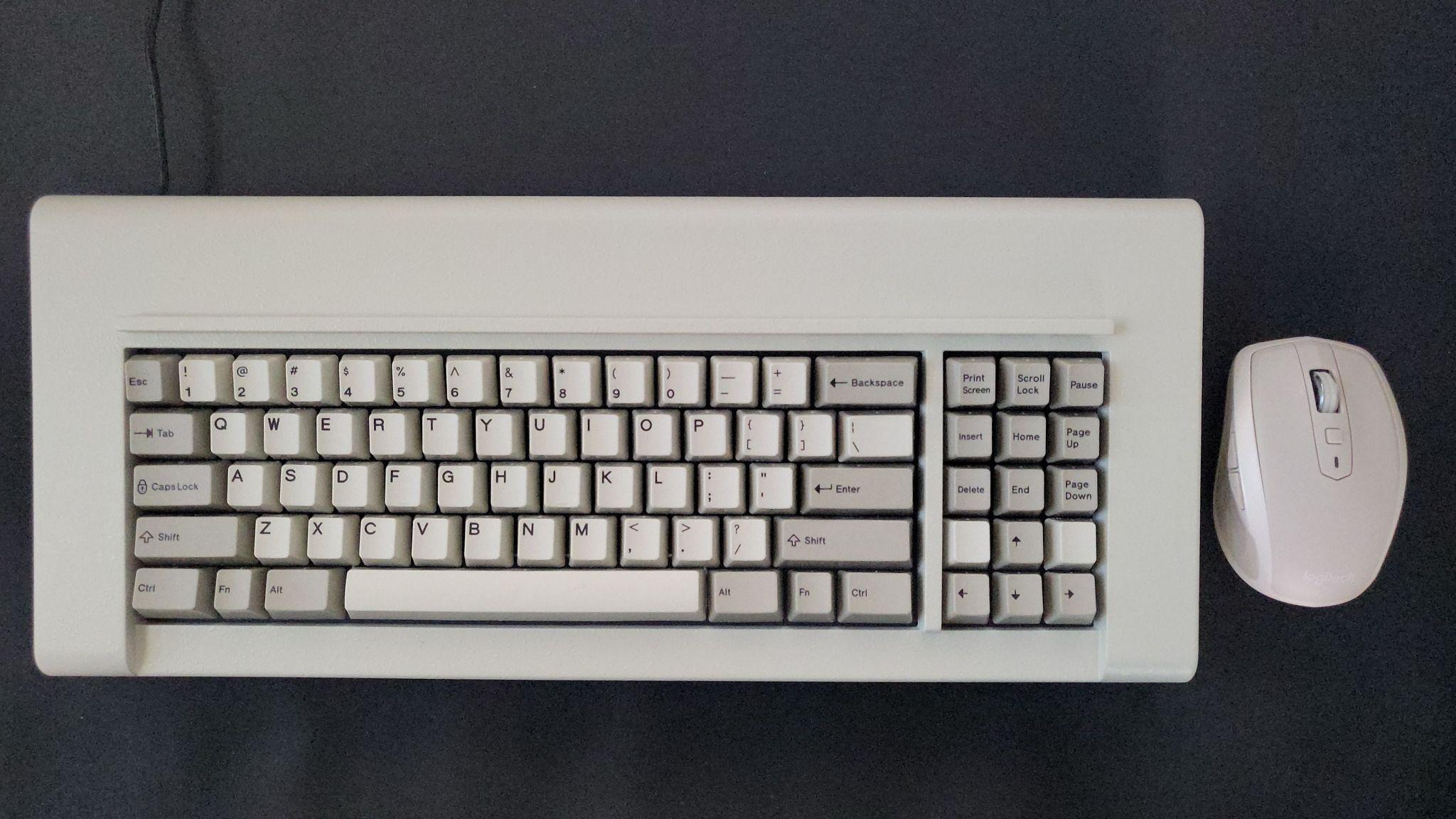

Hello,
I ordered a pre-installed solenoid and driver package for my new Model F77, and it works without issues. I am not a very technical person, so I used the provided video and I was able to customize my layout to my satisfaction with QMK.
However, I haven’t been able to find is how to enable the solenoid for my Ctrl, Shift, Alt, and Fn keys. The solenoid is disabled by default only for those keys.
In the manual page, a patch that was applied to exclude certain keys from using the solenoid is mentioned once, but there was no mention on how to enable these keys.
I would like to know how to enable the solenoid for my Ctrl, Shift, Alt, and Fn keys so that all of my keys utilize the pre-installed solenoid.
I am using Windows 10.
Here is my F77 keyboard, going for the classic beige color scheme, with Volume+ and Volume- pearl colors ordered for the right side block:
Ellipse
15 Nov 2022, 03:54
I believe it may have something to do with commenting out the line of code as noted in the manual:
#define HAPTIC_EXCLUSION_KEYS 1
Commented out:
//#define HAPTIC_EXCLUSION_KEYS 1

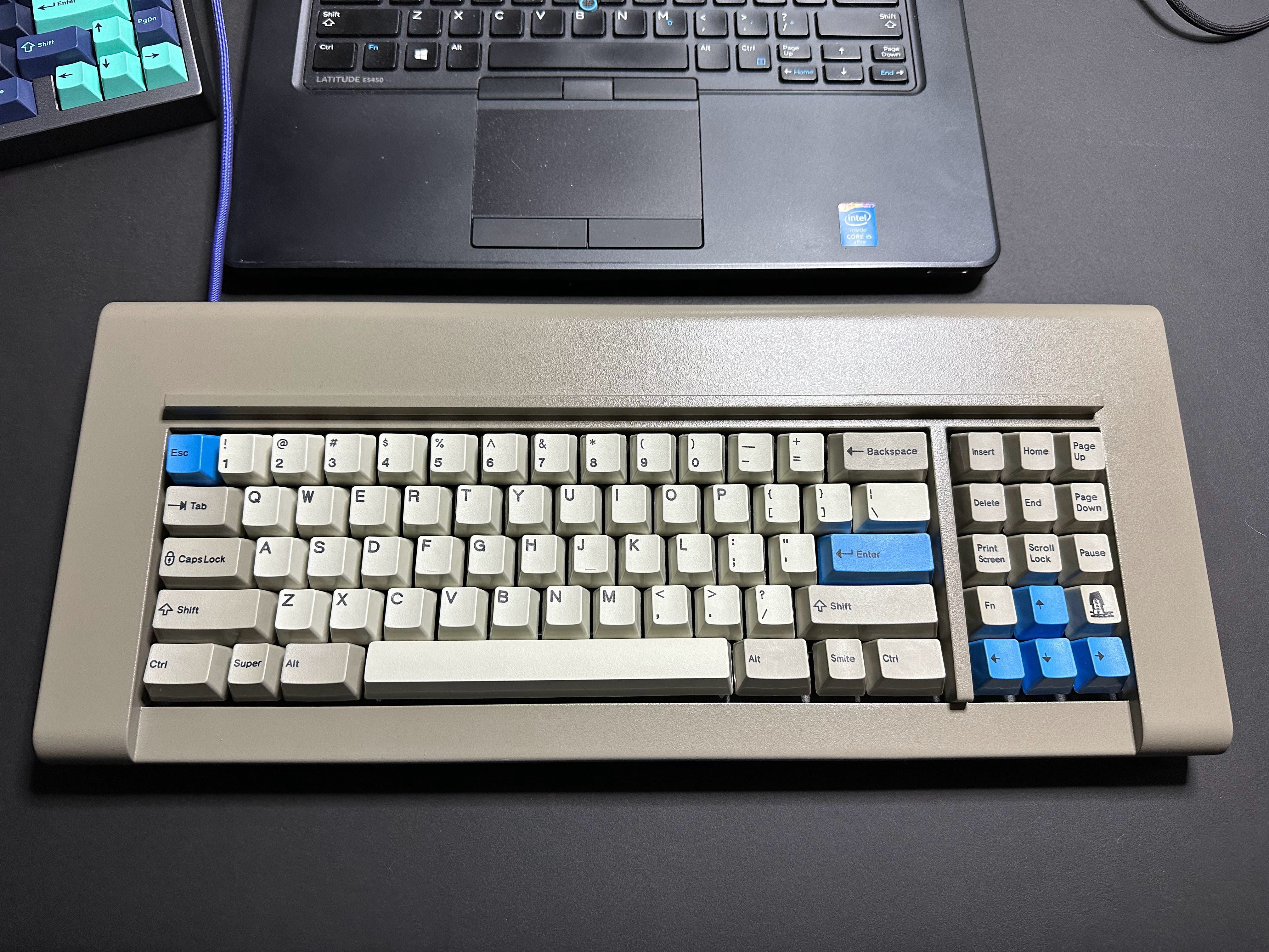

Ellipse

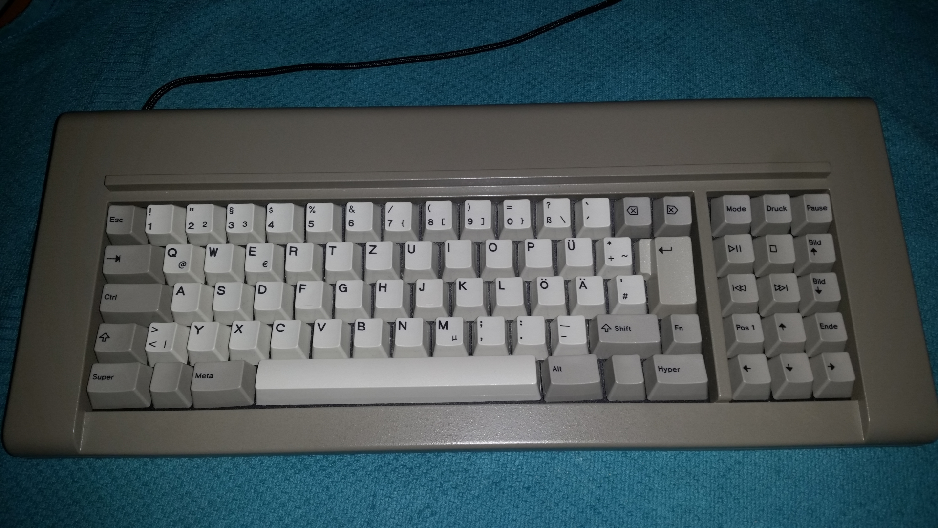

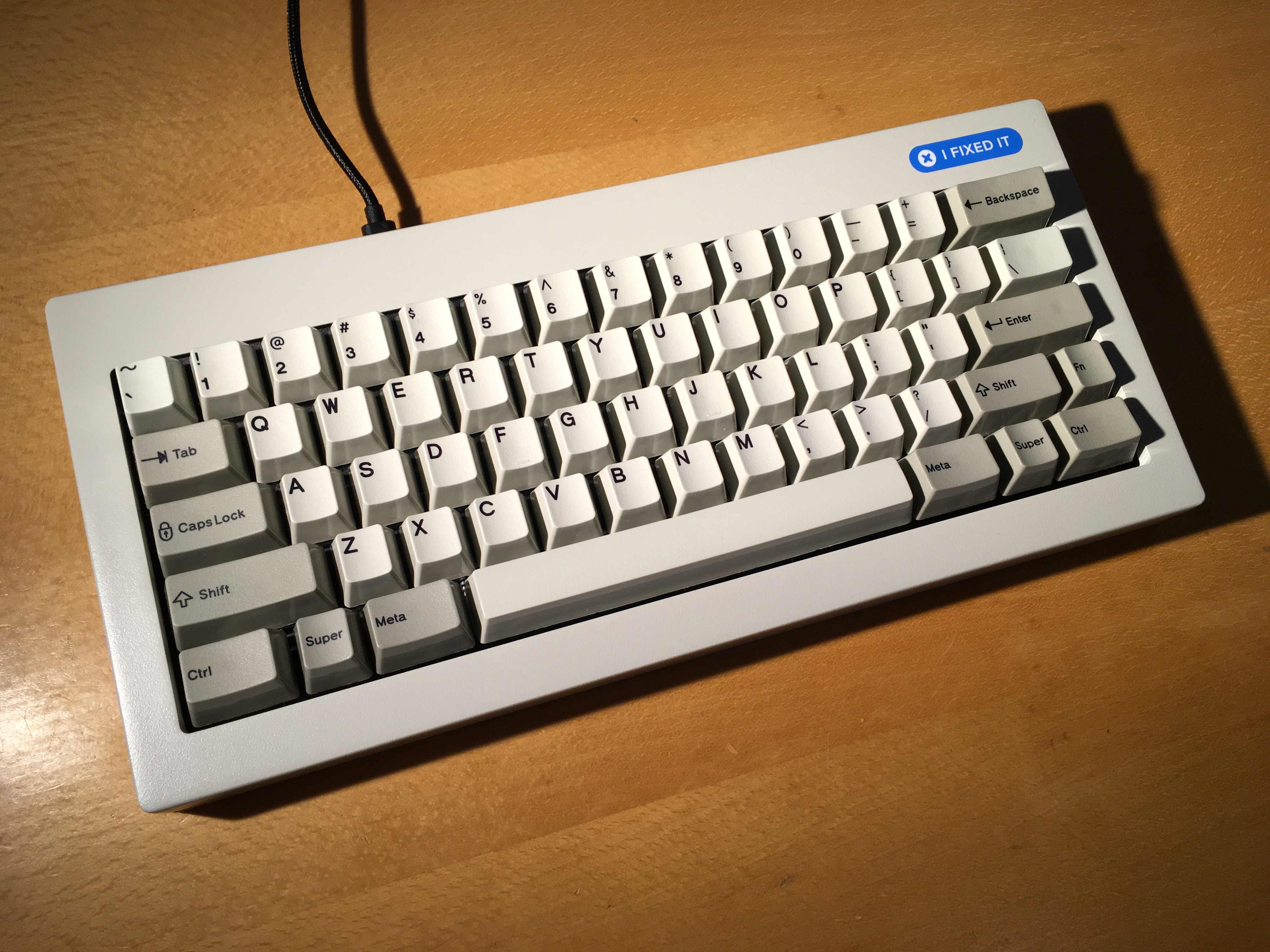

18 Nov 2022, 22:27
Posting (with permission) one of the newer ultra compact case colors - Off-White/Beige, a color more common to the classic style cases.
This keyboard features Meta and Super keys, which along with the Hyper key, are often used with Linux and Lisp / Space Cadet according to the link below.
https://askubuntu.com/questions/19558/w ... hyper-keys
beige compact F62 - Copy.jpg (2.44 MiB) Viewed 22042 times
Guppy
19 Nov 2022, 01:14
Ellipse wrote: 18 Nov 2022, 22:27 Posting (with permission) one of the newer ultra compact case colors - Off-White/Beige, a color more common to the classic style cases.
that's a really nice, very striking keyboard design. I would want to build one of those myself if I wasn't already saving up for the beamspring project

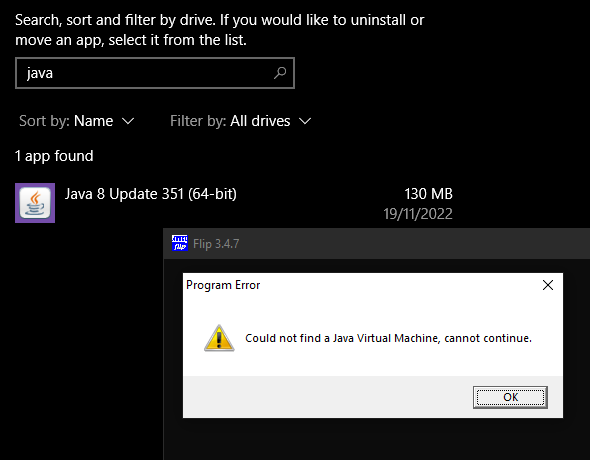

Nootz
20 Nov 2022, 01:08
I'm having trouble using Atmel Flip for first-time reprogramming - I've put the keyboard into Bootloader mode and I'm at Step 8/9 on https://www.modelfkeyboards.com/manual/, except when I try to launch Atmel Flip, I get the error "Could not find a Java Virtual Machine, cannot continue." What do I need to solve this?
I'm now worried that if I unplug the keyboard or turn off my PC at this stage the keyboard might be stuck in some half-bootloader mode and I'd have to reset it by opening the case and shorting the pins, could this happen?
Ellipse
20 Nov 2022, 02:10
Nootz you need to install Java I believe, if it is not installed already. Not to worry, the keyboard will move back to regular mode automatically after it is unplugged.
Nootz
20 Nov 2022, 12:55
Ellipse wrote: 20 Nov 2022, 02:10 Nootz you need to install Java I believe, if it is not installed already. Not to worry, the keyboard will move back to regular mode automatically after it is unplugged.
I have the latest Java installed but I'm still getting this error.
Java Installed.PNG (18.51 KiB) Viewed 21800 times
Good to know it will go to regular mode though.
20 Nov 2022, 13:02
You’re just looking to flash a new hex file, right?
https://github.com/qmk/qmk_toolbox
Works for everything: QMK, TMK, Soarer’s…
Nootz
20 Nov 2022, 13:04
Muirium wrote: 20 Nov 2022, 13:02 You’re just looking to flash a new hex file, right?
Yes, but I'm doing it for the first time so I need to use Flip to do the first time setup stuff right? Or is that section of the guide deprecated?
20 Nov 2022, 13:06
Give it a shot. I don’t have an Ellipse made keyboard but this tidy little app works with all my controllers.
The main window tells you current state: it will show new USB devices showing up and when they are in writeable aka. bootloader aka. DFU mode.
The little selector at the top right should either be set to ATmega32u2 or ATmega32u4 for these boards. Don’t be afraid to change it, the app is smart enough to fail harmlessly.
