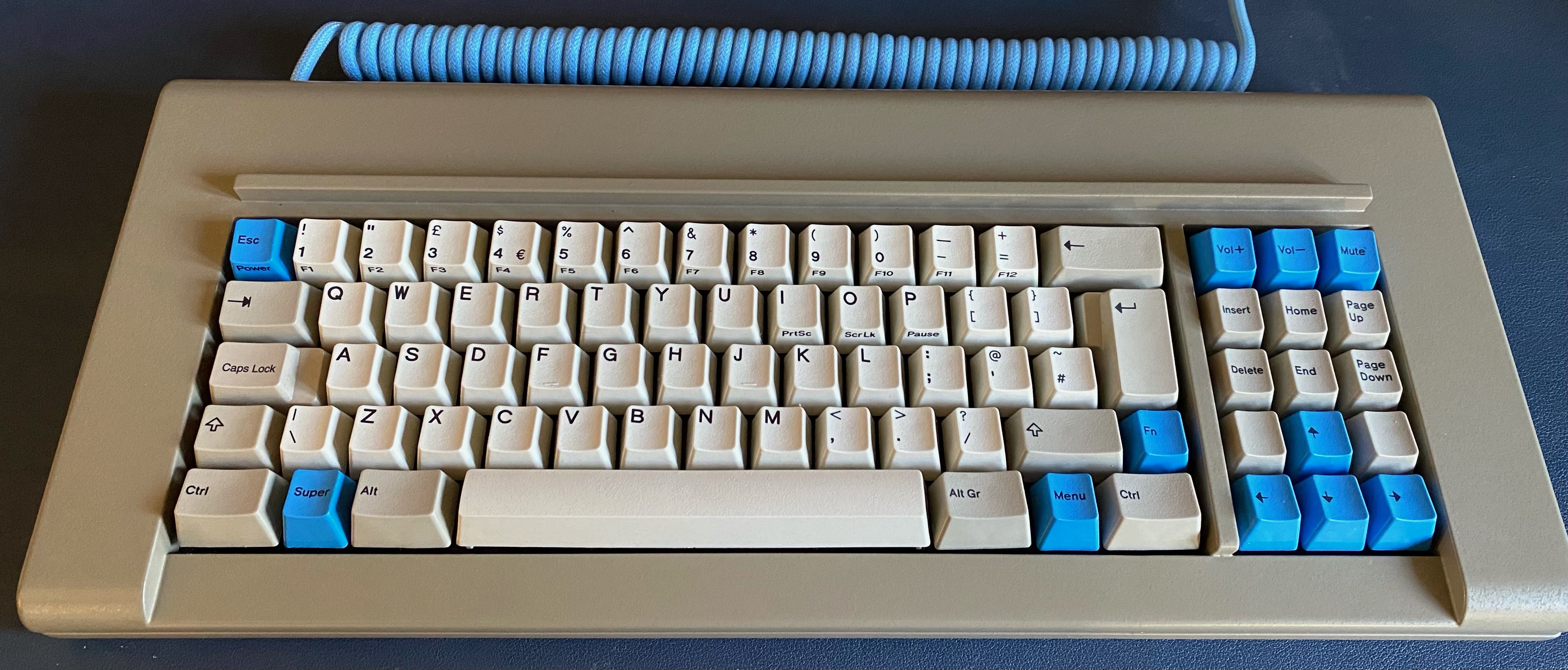

My F77 arrived yesterday!
Ellipse Model F.jpg (897.18 KiB) Viewed 17824 times
(Note that the yellowed space bar is not from Ellipse. I'm currently using one from an old Model M.)
Setup was smooth, apart from me having to hammer the top plate back in place, since it shifted during shipping. I put VIA on it and programming it that way was super easy.
In terms of key feel the springs are noticeably lighter than the ones in my AT Model F and the "switches" are more scratchy. The lighter springs might be preferable to some people, I'm currently undecided. Not sure if the scratchiness gets better over time. The springs also seem to be a bit "whiney" since they slide across the seemingly not-so-smooth barrels. You don't notice it that much during typing, though.
The quality of the keycaps seems really good, at least on par with the keycaps from my AT Model F. I also highly appreciate, that the German keyset also uses German text for the mods and nav keys. Now I'm only wishing front printed F1-F12 for the German keycaps and a blue ISO enter.
I'm planning to use this little cable to adapt it to removable mini USB, since that is what my other keyboards use: https://www.amazon.de/dp/B071L99VPQ

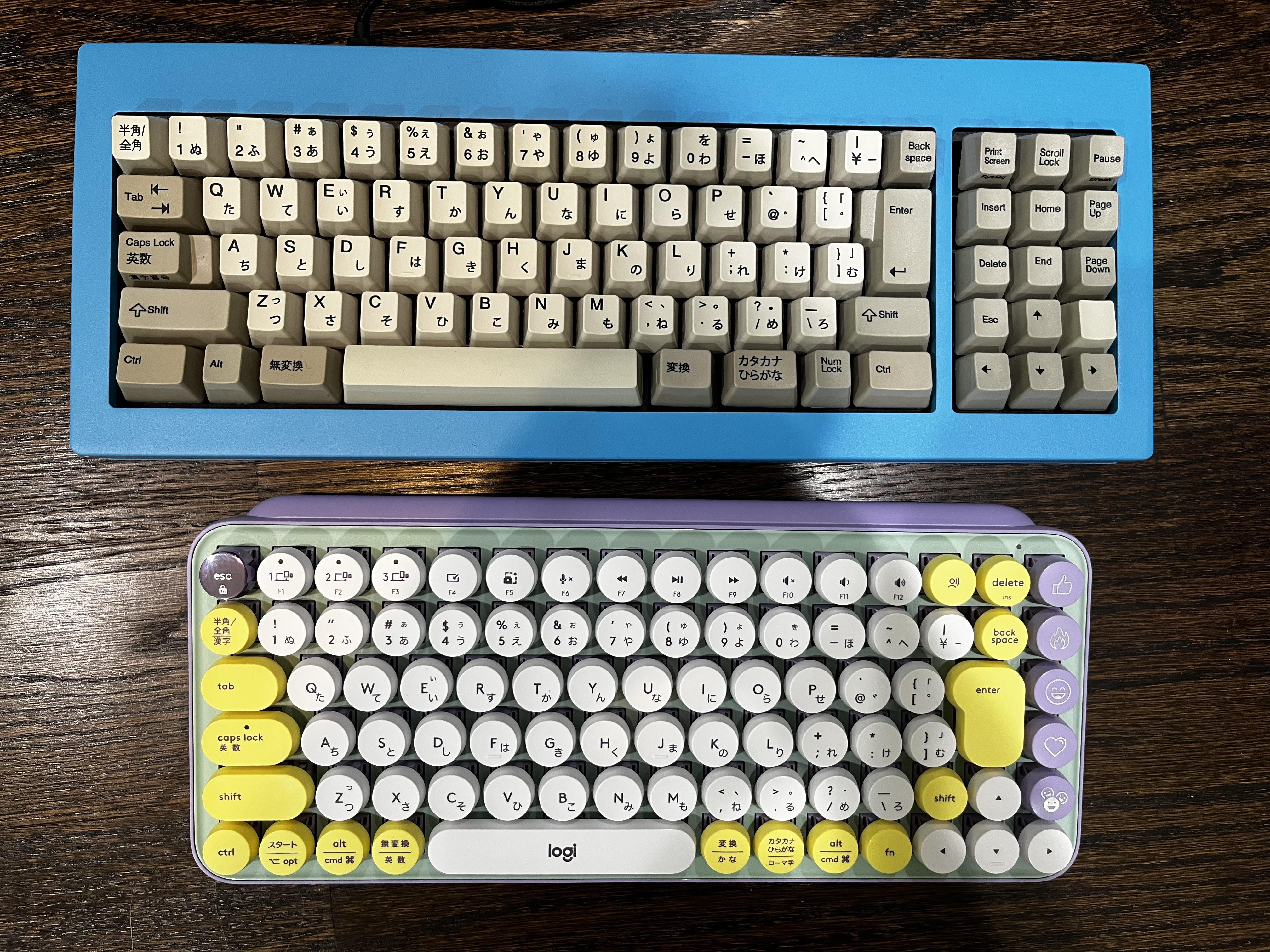

Here are two nice photos, reposting with permission:
First up is an Ultra Compact F77 with JIS keycaps from Unicomp (the top keyboard in the photo):
https://www.reddit.com/r/MechanicalKeyb ... rds_ultra/

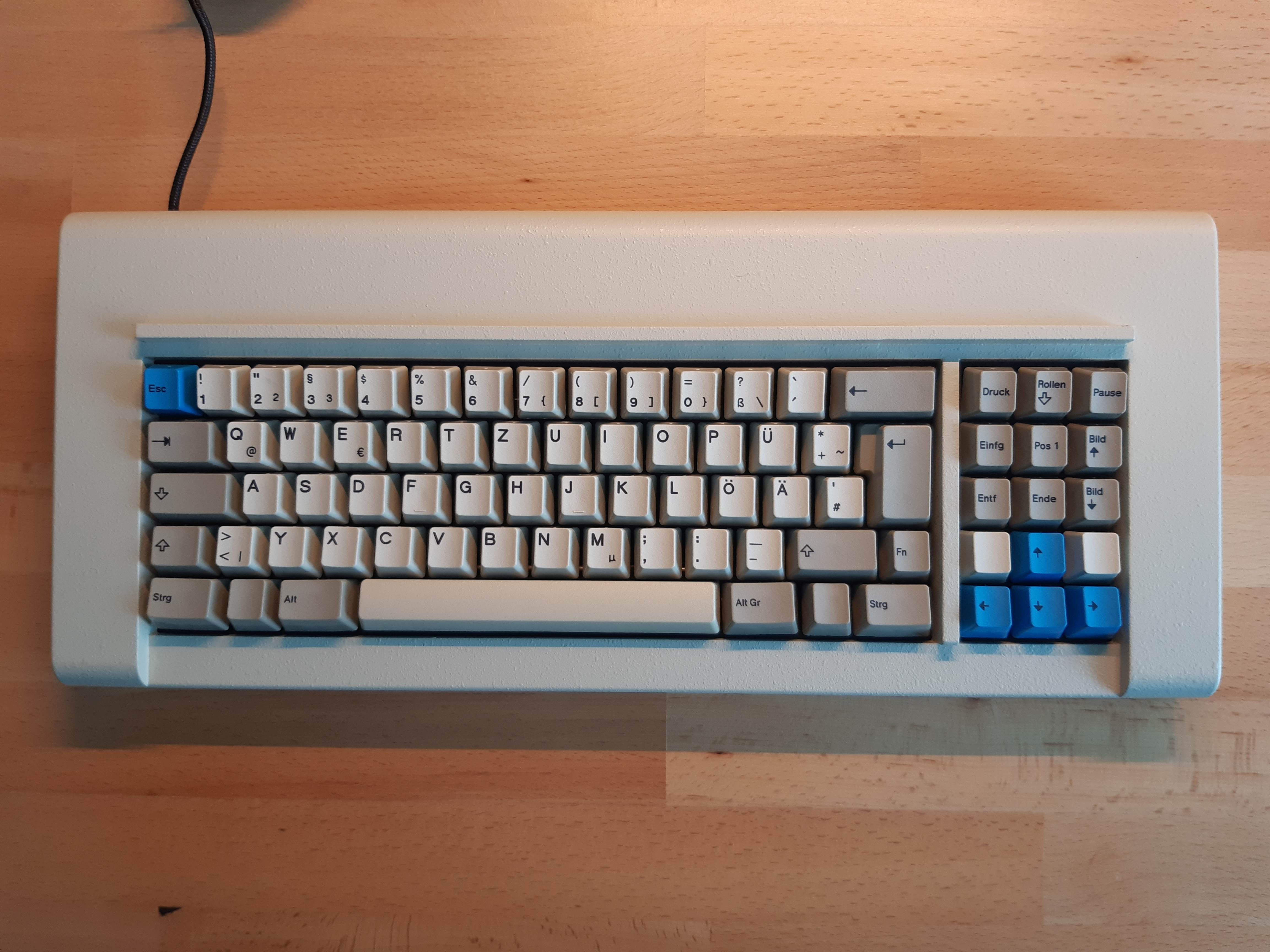

And next up is an updated version of a keyboard posted last month with this description: "Posting with permission a nice F77 Industrial Gray photo sent to me. The UK layout customizations include HHKB style split right shift, UK front printed keys and some blue Esc and cursor keys."
updated - Copy.jpeg (1.63 MiB) Viewed 17581 times
Meowmaritus your experience is definitely not one I have seen too often, if at all, from others. I have shipped out thousands of these keyboards, including to many folks with original Model F keyboards. My guess is that your original Model F is not a typical one and that the relationship of barrel length to spring+flipper length is different from other examples (I believe this affects the actuation point). I have restored and collected dozens of Model F keyboards and am very aware that the sample to sample variation among original Model F keyboards is far greater than that of the new production Model F keyboards. If your keys were getting stuck at the bottom you should have reported to that to me when you received the keyboard, so I could investigate. The wiggle method has proven 100% effective in fixing stuck keys in my own experience, and I have not seen many issues where 1U keys are all getting stuck. All space bars are warped noticeably, even those of the original Model F keyboards. The reason is that they are made of PBT, as are the originals; PBT has a far higher uneven shrinkage rate compared to other plastics, so the larger keys will have more noticeable shrinkage.

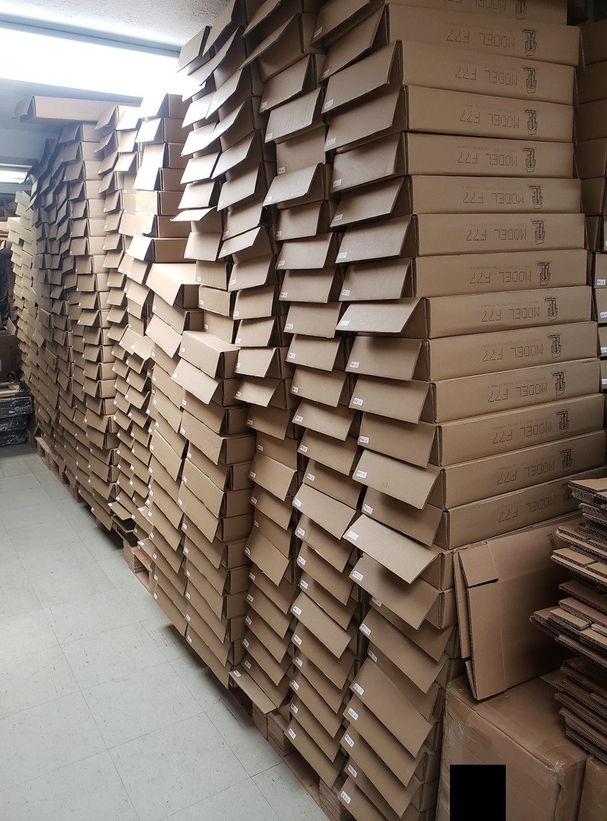

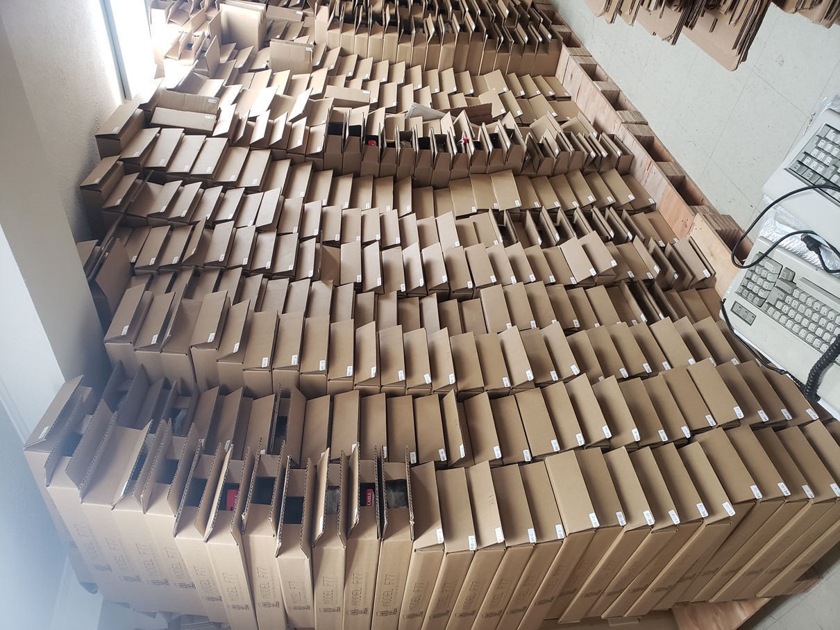

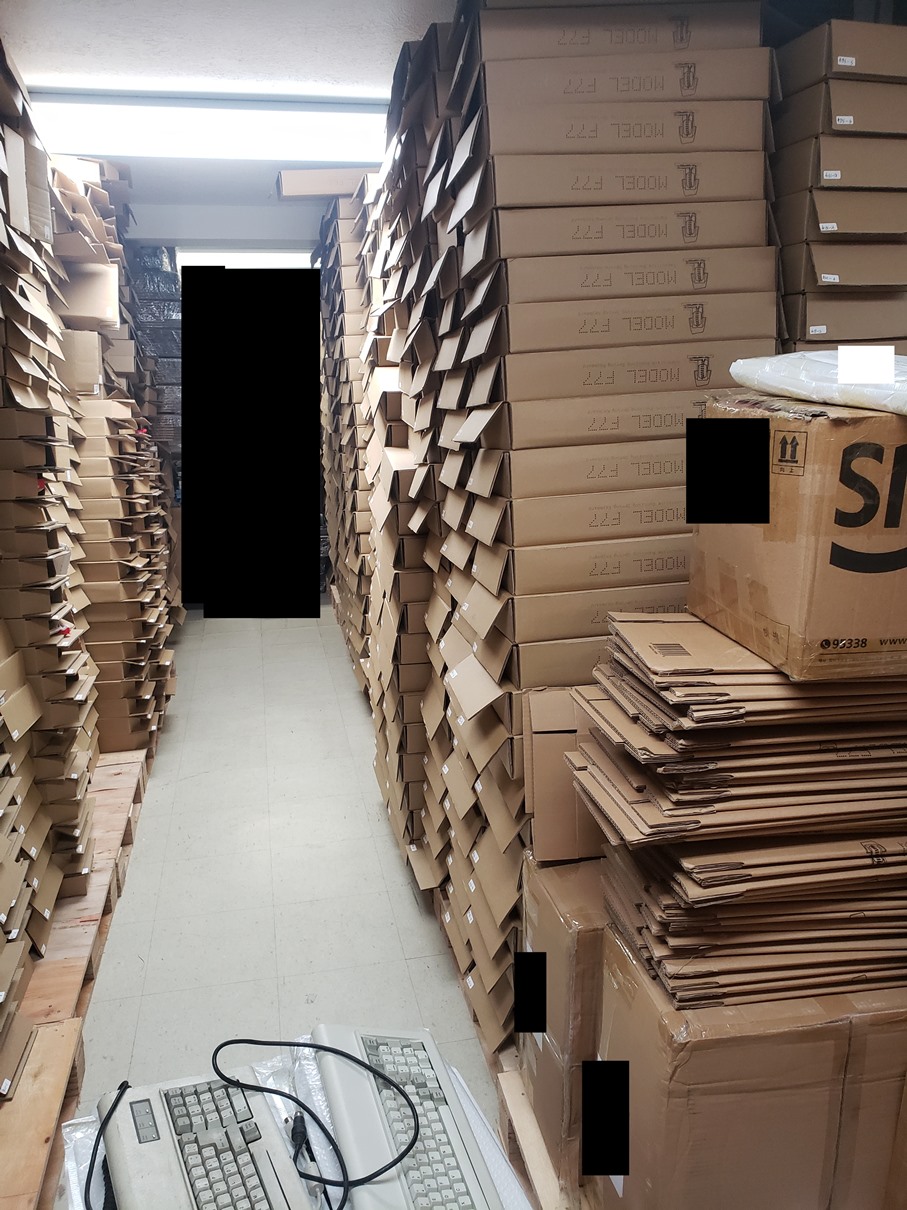

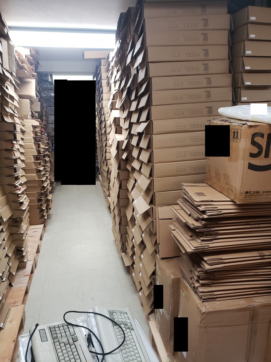

The fourth container shipment arrived this week. Now all variations and extras are in stock and the wait times should be 1-2 months for each order as opposed to the "made to order" nature of prior rounds.
Also, the second half of the round 1 batch with the factory repaired beam springs arrived. I will be replacing the other 150 or so keyboards' springs that arrived a while back, before the spring issue was discovered. Of course if anyone wants to skip the line and replace the springs themselves that will also be an option (I expect to post a video).
You may see that the new classic style zinc case F77s are in the smaller packaging, removing the styrofoam and saving about 40% of box volume, allowing many more keyboards to fit in the same space. The styrofoam is still present on the F62 zinc case boards from this batch, while supplies last, as they made extras of these.

Re: F62+F77 orders now open! New Kishsaver+Industrial Model F Keyboards
Posted: 22 Oct 2022, 12:31
by Muirium
I see stacks 28 boxes high. I hope those are empty, besides the cables. 27 × 3 = 81 kilos of keyboards squashing the bottom boxes, otherwise!
Posted: 22 Oct 2022, 18:19
by Ellipse
Each keyboard box weighs 5 to 11 pounds or so, depending on the model.
The boxes are always stacked as shown. Not to worry, this is the fourth container shipment with stacked boxes. All the boxes are double walled and good quality, though not perfectly rectangular as you can see with the stacks leaning.
Some boxes do get damaged at some point so I have lots of extras to replace them.
If the boxes were single walled they might not support the weight.
Posted: 22 Oct 2022, 19:10
by Muirium
Wow. Those boxes are weightlifters! Glad to hear you have spares.

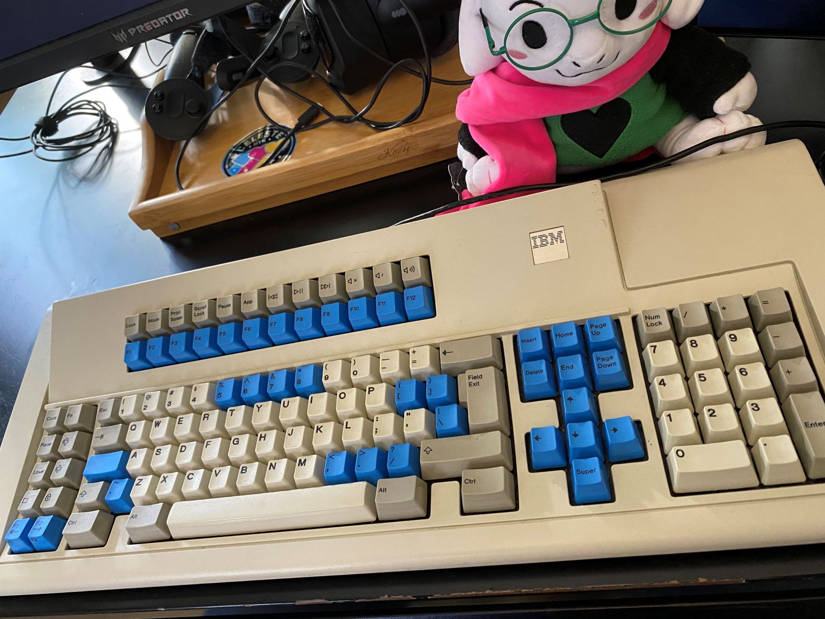

Here's a nice photo (posted with permission) of an F122 with custom legend keycaps:
