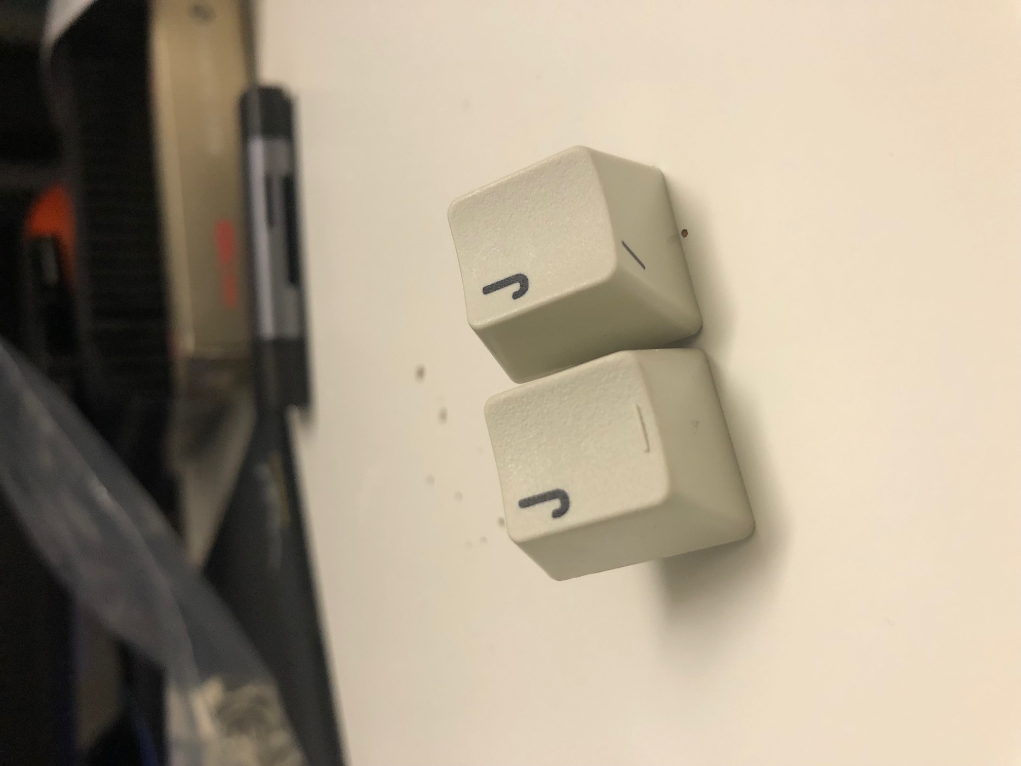

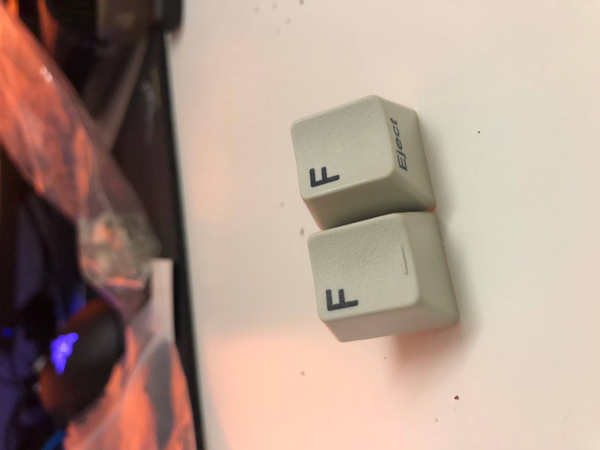

Just got my F62 this week. Almost got lost by my local courier because they decided to leave it in a different apartment without me signing off on it.
Got Colemak keymap set via QMK on Linux, which required me to use LSHIFT+RSHIFT+B to enter bootloader as the compiled pandrew utility didn't detect the keyboard, and dfu-programmer to erase and flash the new firmware.
One of my shift keys kept getting stuck even after squeezing and adjusting the keycap stems, but good thing I bought extra keycaps to replace it with.
Question for those who bought the HHKB front print key set, are your F and J keys missing the tactile bump as well, or did I just get a bad batch or something?
10 Sep 2022, 11:46
Ouch!
I’m not in this group buy—it just rumbles on, a perennial storm in Deskthority—so I’ve no idea if those homeless home keys are a defect or design. But I’d use whichever variant feels best to your fingers in use. If the HHKB-less ones, then I’d also substitute out the now overhanging front legended H, N and M keys, if you have regular ones to spare.
I’m assuming Ellipse copied the HHKB’s front legends, down to those numpad operators all the way down there. I never used them for numerics, myself, and wound up taking their Fn+spots for layer keys. But for sure, the nub-less F and J are a mistake.
Ellipse
10 Sep 2022, 18:08
riverstyx did you follow the instructions in the firmware section regarding installing the drivers? You have to scroll down a bit in that section. Usually this affects those flashing firmware for the first time on a particular computer. That may fix your issue - please keep us posted!
The HHKB Front Print keys did not have nubs by design, though I recently ordered some nubbed HHKB Front Print keys if anyone is interested - there would be no charge to replace the key (or substitute the key, if it has not yet shipped), outside of shipping costs, if you ordered this key before and prefer the nubbed variation (please PM or email me for details). For many layouts it might be preferable to be nubbed (probably most of them), though for some layouts Colemak, Dvorak, etc. these keys are not nubbed.
Also one more free replacement offer (besides the cost of shipping): please note that the ". Del" key should technically be a ", Del" key for the following sets, to be more authentic to these layouts: Brazil, Swedish-Finnish, Dutch, Dutch Modern
