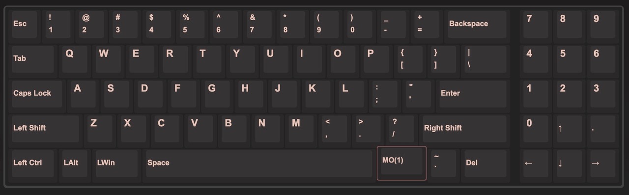

Hey! While trying to figure out why my computer doesn't like the keyboard from time to time i did a firmware write using Atmel Flip with the file "Via F77 - ANSI-ISO - PrintScr.hex". Now I can't in any way manage to get the keyboard to get into bootloader mode, so I can't reprogram it. I should note that I didn't use the pandrew utility to do a EEPROM erase before I loaded the above file using ATMEL FLIP, maybe that screwed something up?
I remember the FN key default being bound to the lower right CTRL, though if I press lower-right CTRL+SPACEBAR+R, it doesn't enter boot loader mode. Tested leftshift+rightshift+b as well, to no avail.
Any ideas what I can do? Is there any other way to enter boot loader mode so that I can just do a clean eeprom-flash?

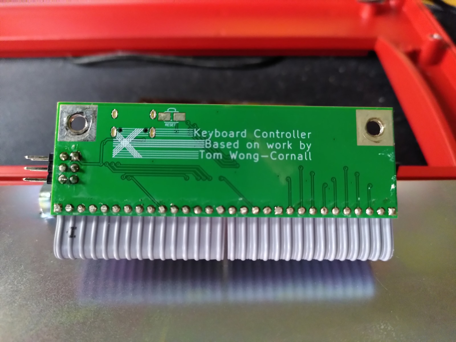

Wrt. the keyboard not working at startup: I’m using multiple Macs connected through a USB switcher and a dock, and I have two keyboards connected to the dock: an F77 and a Realforce TKL, and I never have issues on startup or waking from sleep with the F77, whereas the Realforce will almost 100% be unresponsive if I touch it before the Mac is awake; the F77 is so reliable that even if the Realforce is the designated driver of the day, I’ll reach around it to tap the spacebar on the F77 to wake up my Mac
it’s muscle memory at this point. I think I’ve had the F77 be unresponsive like that maybe three or four times in what, two years?
I strongly suspect some flipper or spring placement to confuse the calibration process in Takashi's case. Thus the above suggestion to try the xwhatsit or AAKBD firmwares, which calibrate differently.
In my case, the left Ctrl key didn't work reliably when the keyboard was plugged in the dock (Thinkpad T430). I suspected USB, and plugged the keyboard in the laptop itself. Left Ctrl apparently worked a bit better there, until I finally removed the spring and turned it between the 12 and 1 o'clock position (it was just 12, or a bit to the 11 o'clock). Left Ctrl worked reliably from then, and I moved the USB back to the dock: it now works reliably; not related to USB...
The difference between the dock USB and the laptop USB, is that the dock is apparently not powered when the laptop is sleeping. The keyboard thus cannot wake up the laptop (not a problem), and is itself powered up when waking the laptop. I guess this means that a new calibration occurs at that time, and may fix detection level variance...
In Takashi's setup, the keyboard may never recalibrate if the USB ports are always powered. Calibration levels may become invalid with time/weather/static buildup/whatever...

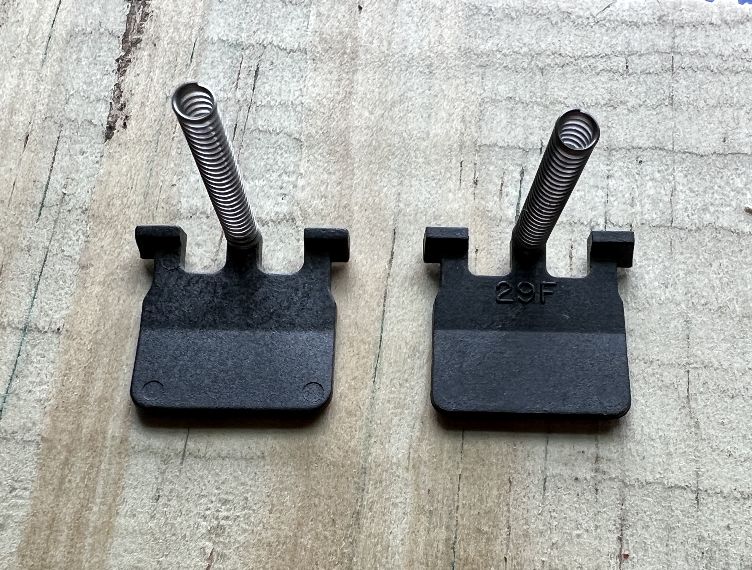

Someone sent me the following regarding "multiple keys registering when one key is pressed.
I've had a look at the troubleshooting guide which suggested it was maybe a problem with the flippers/springs. I've tried reseating the caps for the keys I'm having issues with, but that doesn't seem to affect the problem at all.
Any idea what the solution might be?
The keys that are registering together are:
D & C
G & B
K & N
L & .
Z & X
/ & left ctrl & right alt
Numpad:
Left arrow and 0
Up arrow and ."
The user has cleared the EEPROM and reflashed the firmware, to no avail.
D & C
G & B
K & N
L & .
Z & X
Numpad:
Left arrow and 0
Up arrow and ."
- thefarside

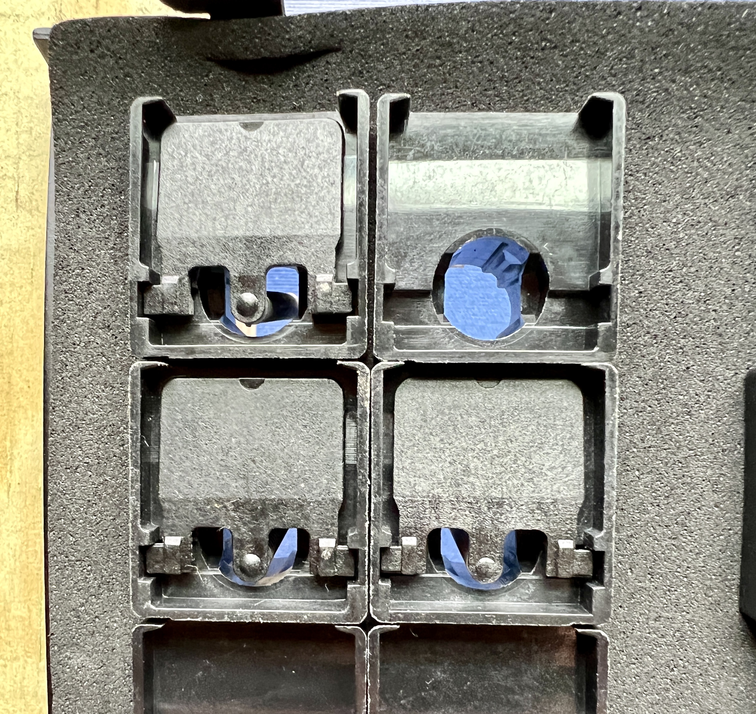

Yes they are. In the picture below the bottom right flipper is a reproduction and the two on the left are original IBM. On this picture the one on the left is a reproduction and the right is original IBM: Hope this helps!Arkku wrote: 23 Aug 2022, 21:27 Random question, but are the springs and/or flippers compatible between these new Model F keyboards and the vintage ones, e.g., XT and AT?
Also, I heard there are some flippers (XT maybe?) that have angled edges and might not be compatible with AT and 4704 style flippers. I can’t speak from experience and maybe someone who knows better can chime in. I know the reproductions are AT and 4704 style.
It is my understanding that all Model F flippers are compatible with all Model F keyboards. Nice photo comparison!

Note that you can remap keys as you prefer. Personally I have the ~` key in the top left corner, and to get Esc I can press Fn together with that key. My Fn key is done using the split right shift. Of course you can also do the same the other way around, so that it is Esc normally but Fn + Esc is ~`, whichever you use more.Miky2147 wrote: 24 Aug 2022, 21:21 - I am Italian but for some years now I have not used the ITA layout anymore, I only use the US layout. I have a question: to write in Italian I need to use accents (and the apostrophe) that on the US keyboard for the grave accent I have to press first ~ `(top left under esc) then the letter concerned and it will come out for example the accented letter "è". This keyboard doesn't have that key but it has the esc key in its place, how am I going to type?
Another thing you can do to get an Esc is to configure a key like Ctrl as a combo key that works as Ctrl when you hold it and press another key, but sends Esc if you only tap it. (I do this with the "caps lock" key, i.e., the key that is above left shift.)
Splitting the backspace is of course a viable option, which I have also tried but I seem to have a reflex to press the left side of backspace when I correct a typo I just made and the right side of backspace when I'm deleting something that was there before… So it may take a bit of getting used to. (I converted one of my F77s to a split backspace first but reverted it back to a normal backspace a week later. I'm still trying the split backspace on my F62, though.)
Anyway, my point is: these keyboards are very customisable: you can do custom mappings in firmware, including one or more "Fn" keys and layers that you can toggle between, and if you get a few extra keycaps you can split or unsplit keys later.
