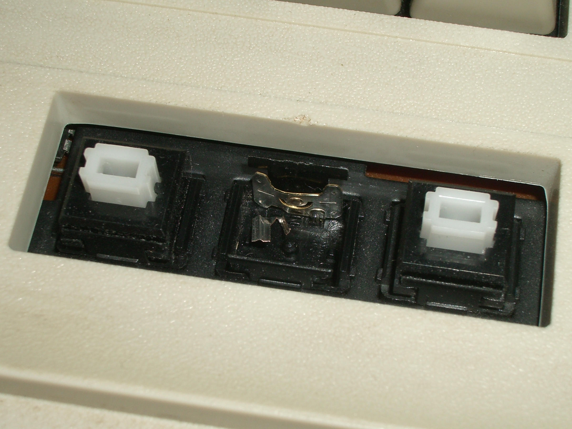

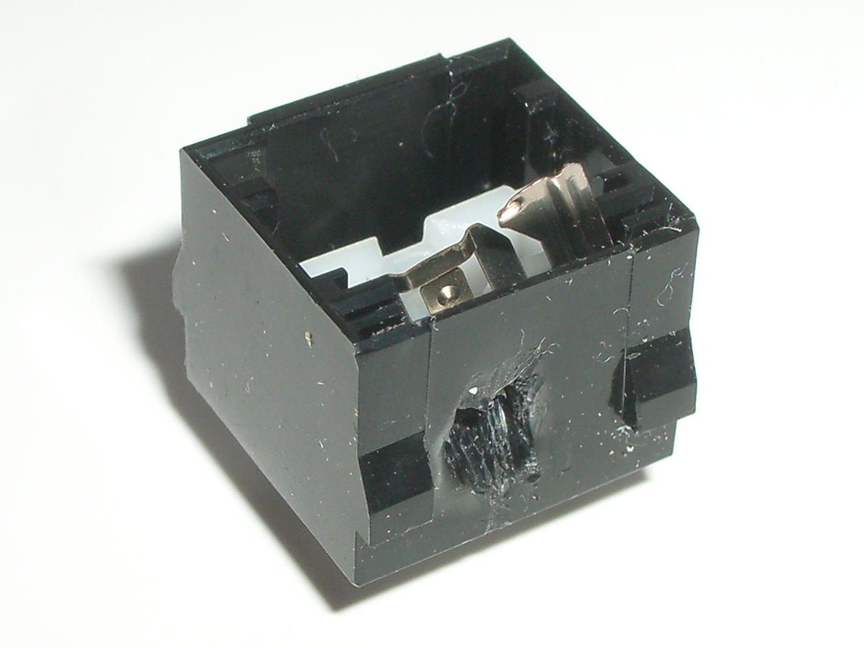

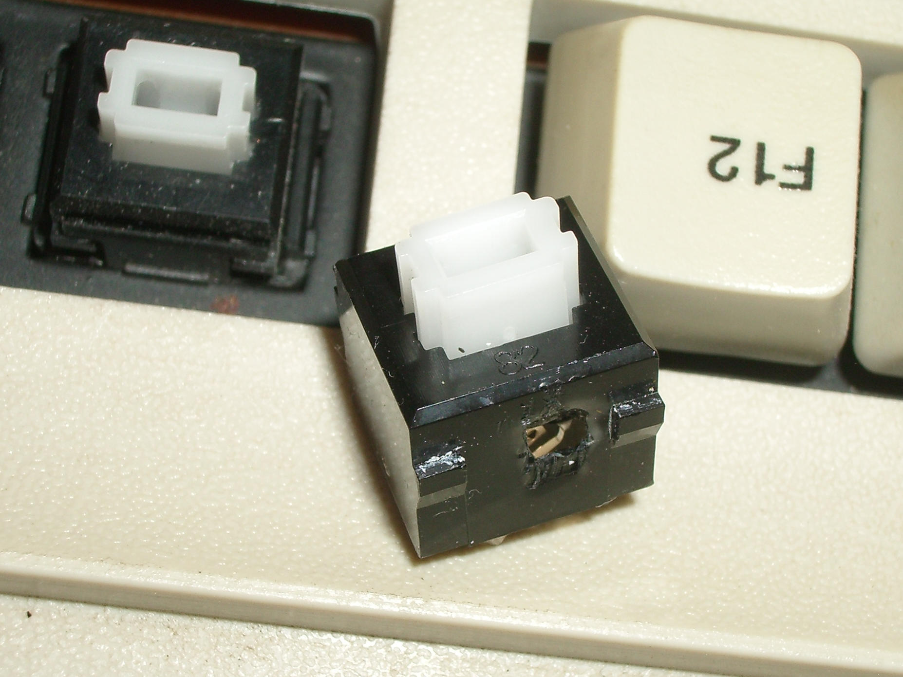

I'm also curious about my Nan Tan board — the switch internals are almost Type IV (the click leaf has angled corners, which is strange), but the numbering is plain numeric.
WTF switch 3.jpg (245.14 KiB) Viewed 9078 times
I also managed to destroy the contact mechanism and tear a hole right through the shell trying to get it apart!
WTF switch 1.jpg (87.89 KiB) Viewed 9078 times
WTF switch 2.jpg (330.98 KiB) Viewed 9078 times
I also severed the end off my old plastic letter opener in the process, which is a nuisance, as it was an ideal tool for opening switches, especially Cherry MX, KPT and Omron.
I suspect I have another clone from someone else, and one that's incredibly hard to get back together (the support grooves in the shell are too tight).
(I did manage to open and reassemble one before, twice IIRC, but this switch wouldn't play fair. I suspect they're all clones of APC, and APC switches are a doddle to work on.)

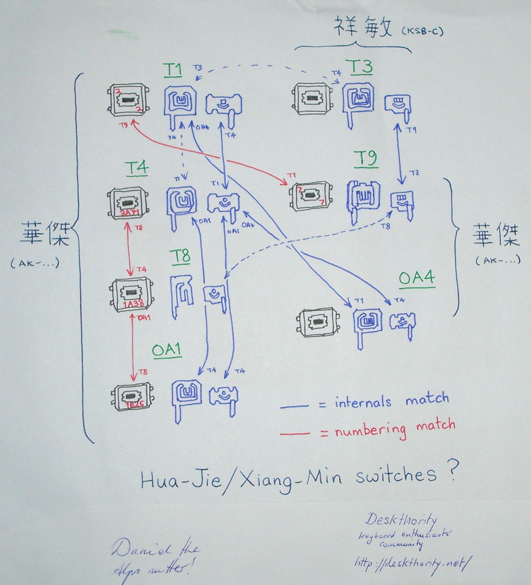

Hm.
Alps.tw type OA4 has an "83" shell, exactly the same numbering scheme as my 82 above.
T9 (a weirdo switch) has the same numbering as T1, and a Xiang Min rear contact plate.
T8 is a yellow switch with the same numbering as T4 and OA4.
There's a huge amount of crossover between a number of these designs. It almost seems as though Himake (Hua-Jie's switch factory) was burning through design ideas.
I'll see if Channing knows.
Posted: 11 Feb 2013, 23:00
by Daniel Beardsmore
Here's my badly-drawn diagram. Going to send this to Channing along with Alps.tw's photos:
Hua-Jie and Xiang Min switches.jpg (345.88 KiB) Viewed 9037 times
Nothing is conclusive, but every one of those switches has a very visible tie to at least one other.

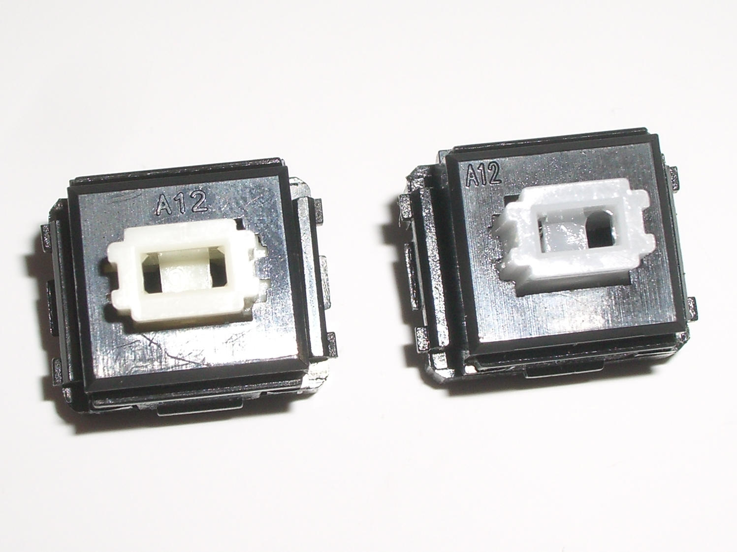

Shit Daniel I think I lead you astray this morning on IRC. I believe that I said the Monterey I was typing on had the same number format as webwit's. What I meant to say is the *minitouch* I was typing on had that number format...sorry
In any case, here is a picture with a few keycaps popped off. This morning I randomly chose the Num Lock and the hyphen keys which happened to have the 4 digit numbering. Seems the neighbouring keys aren't quite the same...
Posted: 19 Feb 2013, 14:48
Pretty sure I knew you meant MiniTouch (which is of course a Monterey board), as you confirmed to me that yours, unlike webwit's, doesn't have the yellow top row switches.
Your photo is really interesting — you have the #A## numbering, and the ## numbering side by side. Again, this means that either Hua-Jie did both types, or that Monterey used two vendors (which, if we have reason to suspect this, I'll just ask them).
Do the two types have the same internals?

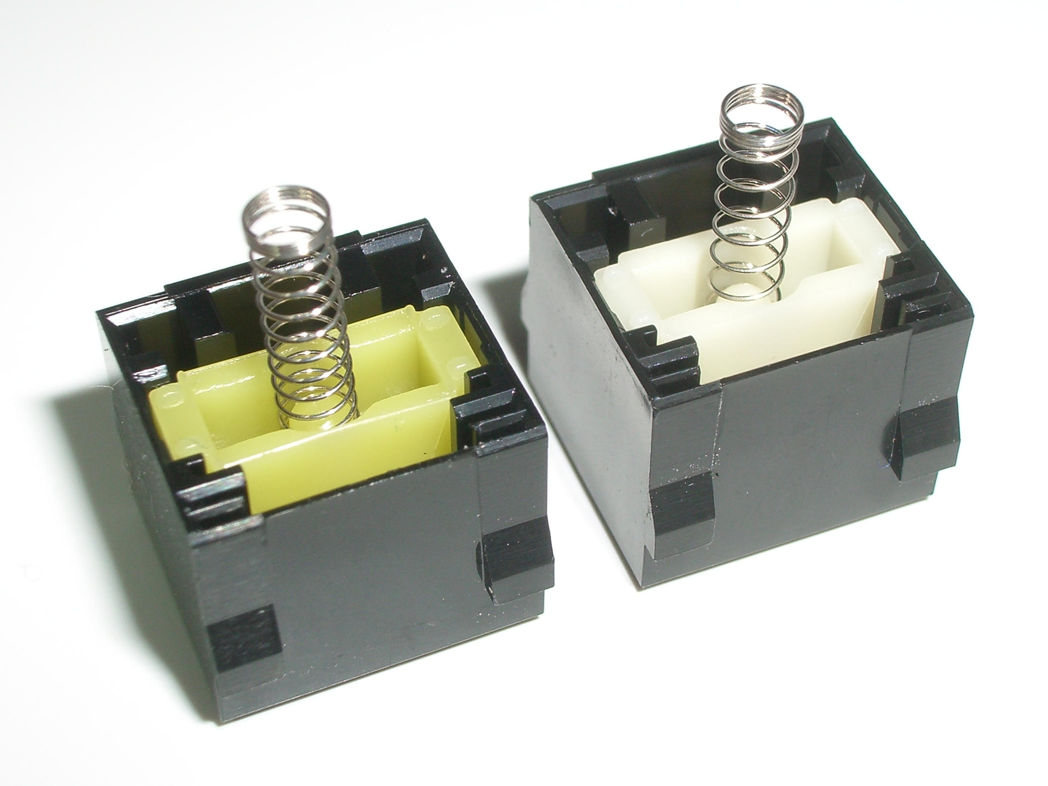

As for white vs yellow — the springs are different. The yellow switches have far more turns in the springs. I can't gauge the difference by feel.
Springs in the two types of switch
Hua-Jie spring comparison in the SIIG MiniTouch.jpg (217.99 KiB) Viewed 8809 times

Yellow vs ivory:
Ivory switches in the MiniTouch are around 4 mm travel.
Yellow switches are around 3 mm travel.
There are small protrusions in the base that stop the slider; in the yellow switch, these are 1 mm taller, to shorten the throw. One of the springs is also longer. I just noticed this reduced travel when I tried to reassemble two of the switches (which is really hard!) I thought the switch wasn't assembled right, but I compared it with the others and found that none of the yellow ones would fully depress, by design.
As to why — don't know. Maybe it will become clear when I finally reassemble it.
