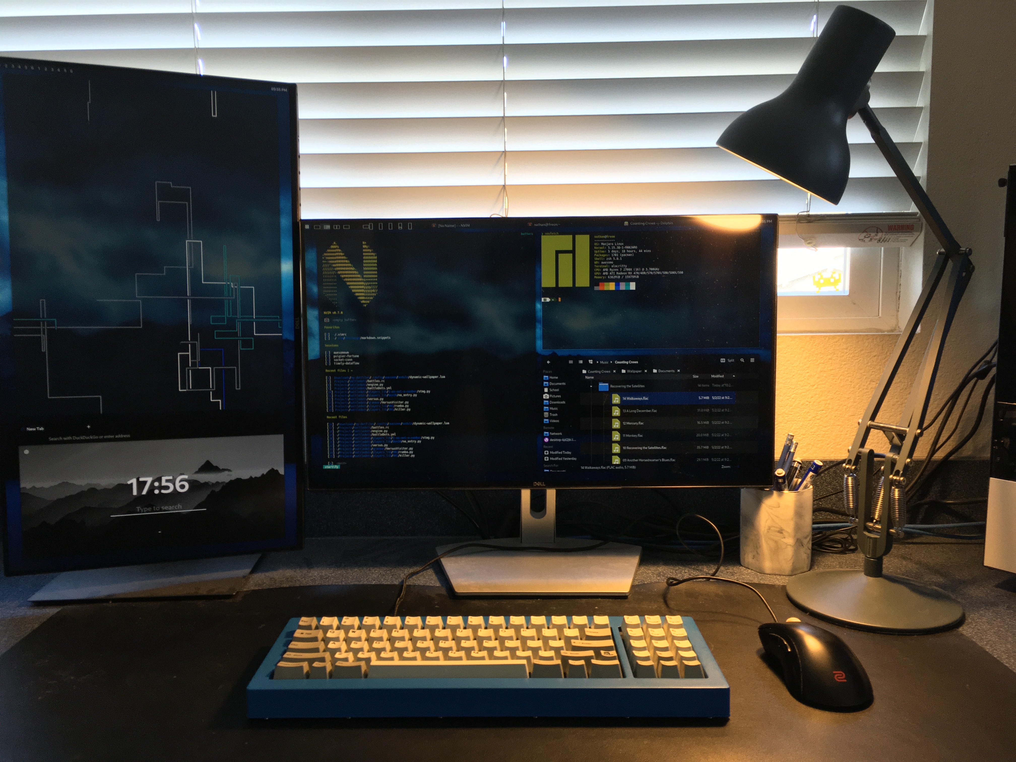

NathanA wrote: 14 May 2022, 02:31
HatefulLight wrote: 14 May 2022, 00:25Haha, I had no idea this was going to be Non-Trivial.
So making the first option work (simulated Num Lock using QMK layers) turned out to be easier than I thought. :lol:
Of course, I did it within Vial. Should also be possible to do in VIA, too, if you prefer. I'm attaching my Vial layout file in case you want to give it a go. To use it, you will first need to download my Vial hex files (first flash eeprom_erase.hex, wait 5 seconds after it's finished, unplug/replug keyboard, then flash the F77 hex file), then download the Vial app, and finally run Vial and then File (menu) > Load Saved Layout... and load in the attached "vil" file (linked at the end of this post).
Default state is Num Lock is off & keypad functions match right block option #4 nav commands. If keyboard gets unplugged/replugged while Num Lock is on, it won't remember that and will default back to nav commands. Since this doesn't rely on the PC's Num Lock status, it will now be impossible for software to either toggle Num Lock or for you to trust what it claims the actual status of Num Lock is on your keyboard (it won't have any way of knowing), so if you forget what state it's in, you won't know whether it's On or Off until you try hitting a key.
This solution should also be reproducible in the web QMK Configurator, too, with the one exception of double-zero: this turned out to be easy to do using VIA/Vial macros, but QMK Configurator doesn't let you define simple macros. If you wanted to do a double-zero key with pure QMK, you'd have to set up a working build environment first and then edit your keymap.c file directly to define said macro before compiling your hex.
Implementation is simple: layer 0 is default layer with all key functions and with the right block set up to transmit the nav command keys. "Num Lock" key is set to TG(1) to toggle layer 1. Layer 1 has all keys fall through to layer 0 (including Num Lock...don't set that to TG(0)...I tried that & it doesn't work) except for the keys in the keypad that should transmit numbers instead, which you need to set to the top-row-above-alpha numbers, not to the numpad numbers (otherwise "real" Num Lock would have to be on for them to transmit numbers!). Everything that was *previously* on layer 1 is moved to layer 2, and whatever key you want to use as Fn on layer 0 has to be changed from MO(1) to MO(2). (Also, set Spacebar on layer 2 to blank instead of MO(2) which is now nonsensical.)
Since while running Vial with all features there isn't enough memory in the controller for more than 3 layers, the few kinda "QMK-meta" keys (like restart in bootloader mode, etc.) can no longer exist on their own layer. So you will have to find some spare keys on the 3rd layer (actually called layer 2, since layer numbers start at 0) to put those on. Previously bootloader mode was set to 'R' for Reset, but you probably don't want to risk accidentally tripping that while trying to engage your Fn layer for everyday tasks. In the layout file that I attached, I chose to put bootloader mode and NKRO toggle on the keypad - and + keys respectively, which should be well out of harm's way. So with this layout, you would now hit Fn and keypad - to get to bootloader mode instead of Fn + Spacebar + R.
Also, since Num Lock is now occupying the space it is assigned in right block option #4 (upper-left key of keypad), the right blank key between right Alt and right Ctrl is now free. So in this layout, that key is now Fn and right Ctrl is an actual Ctrl key.
Getting this working helped me out, too, since now using this keyboard while plugged into a Mac is not nearly so painful...
Hope this helps & have fun!
I finally worked up the courage to flash the keyboard, and now everything works wonderfully. Thank you so much for your help!

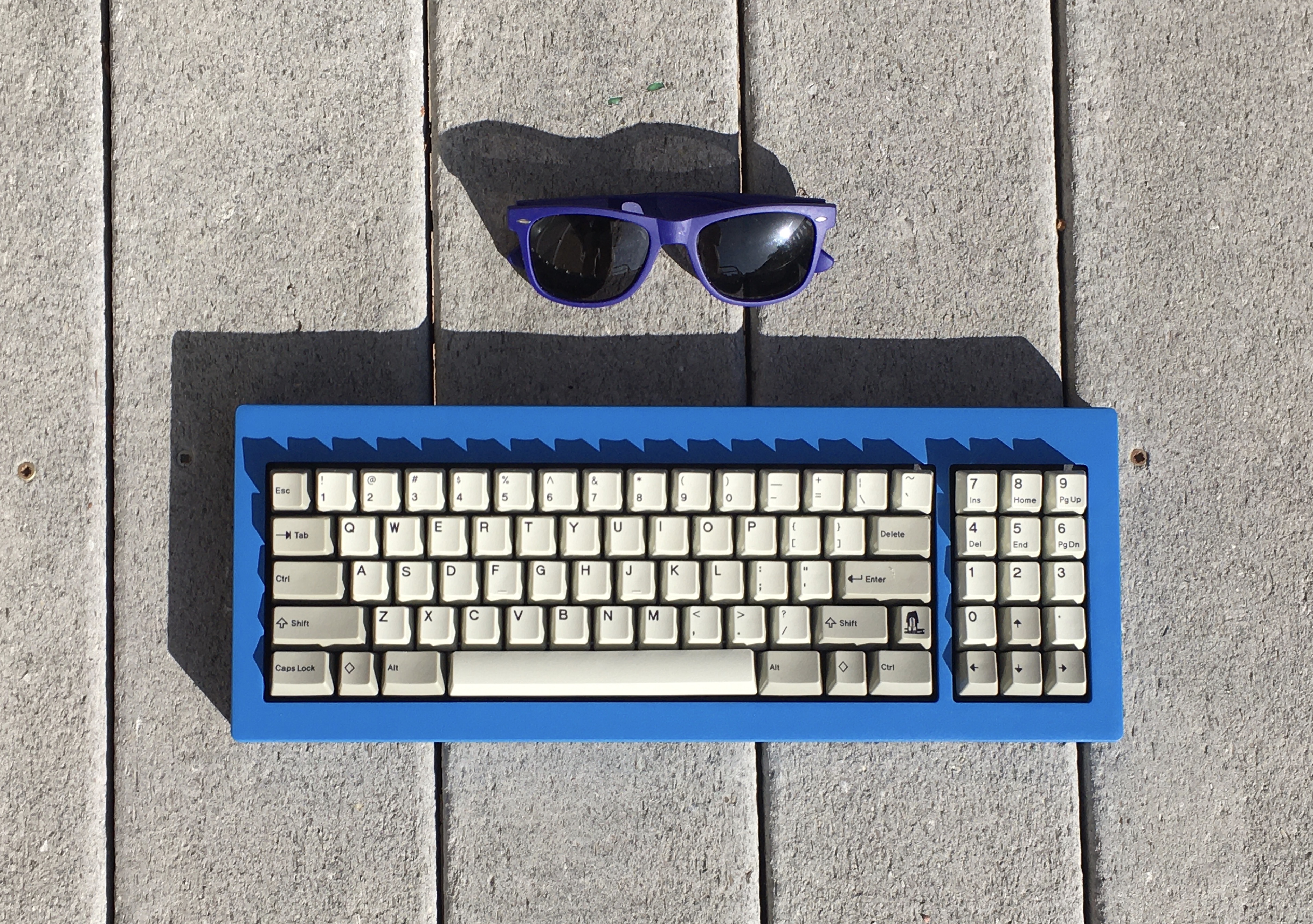

I got my F77 in the mail a few weeks ago, and it has successfully helped me survive finals week. The experience has been incredible so far. Thank you to Ellipse, the firmware hackers, and everyone else making this project possible!
I switched to the dark blue case for the summer, so here's a few photos of what that looks like.
Out on the deck. The dark blue is a fittingly summery atmospheric blue.
A snippet of my setup. On the off chance anyone is curious, the mouse is a BenQ Zowie EC1-A; the lamp is an Anglepoise Type 75 Mini, another classic spring mechanism in its own right.

Nice looking photos and setup Neightro! Thanks for sharing these photos. I believe this is one of the first Dark Blue powdercoated keyboard photos that has been shared! I like the use of the buckling spring logo key as perhaps the function key - makes for a nice custom touch for the layout.
