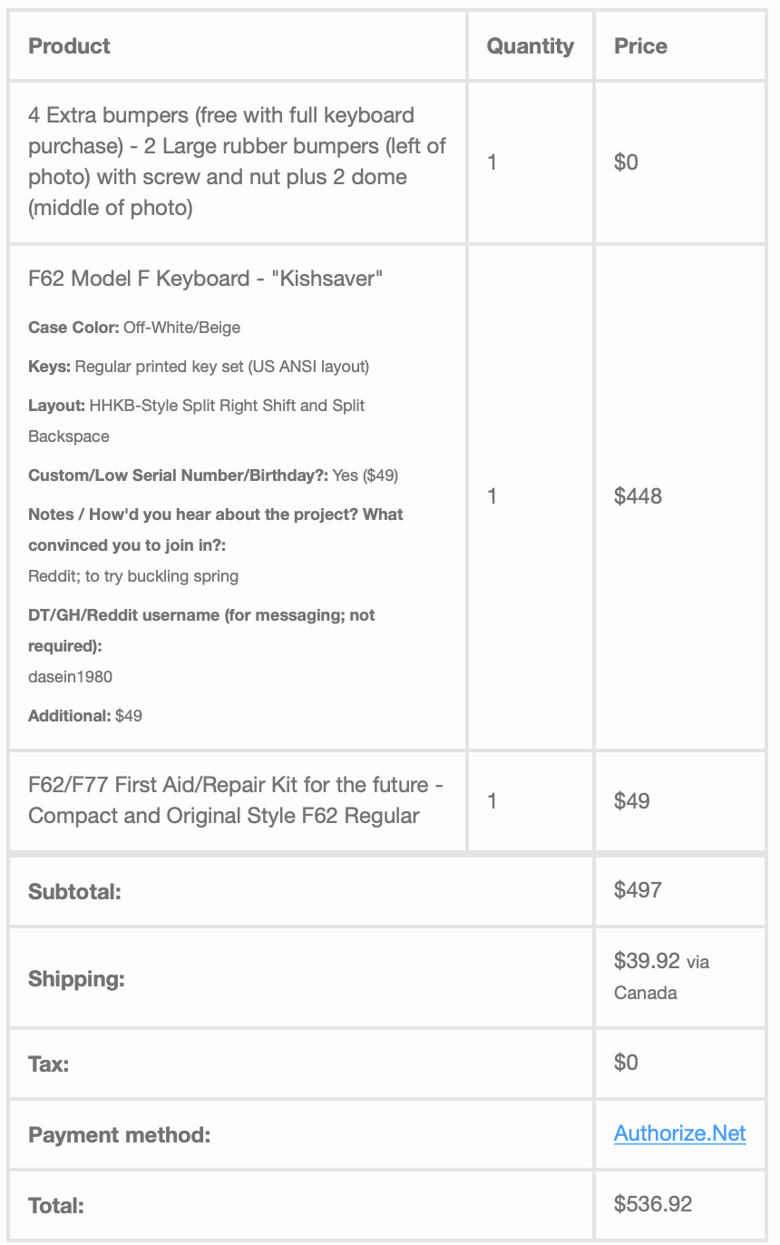

I accidentally ordered a Kishsaver instead of an Ultra Compact but didn't realize it till I opened my order up a couple weeks ago. I put the keycaps on my Kishsaver just to try it out, but haven't used it for more than a few minutes.
Emailed Ellipse, but he unfortunately doesn't do exchanges. I'm going to sell this one so I can buy the Ultra Compact model. It comes with the first aid kit (see item list below).
Is anyone here interested in this HHKB, low-serial, Beige Kishsaver? I'm selling it for the same price I bought it (including shipping), $536USD (assuming you are in Canada or the Northern US—may need to increase shipping price depending on your location).
If you want to pay through consumer PayPal, I'll have to increase the price to cover fees.
If anyone's interested, I can send you pics and/or vids to confirm its working.
You can also message me on reddit: Dasein1980 if you like.
