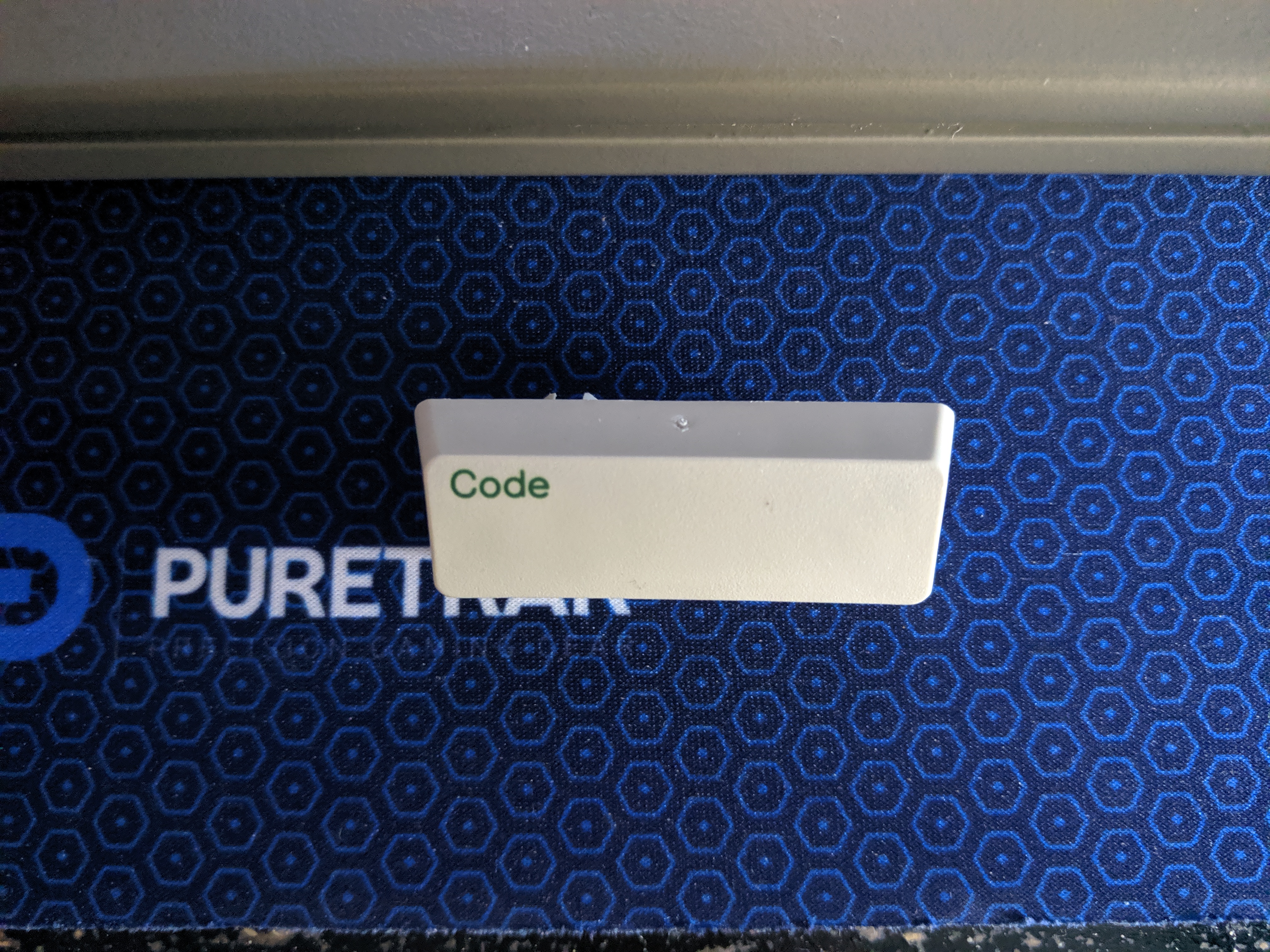

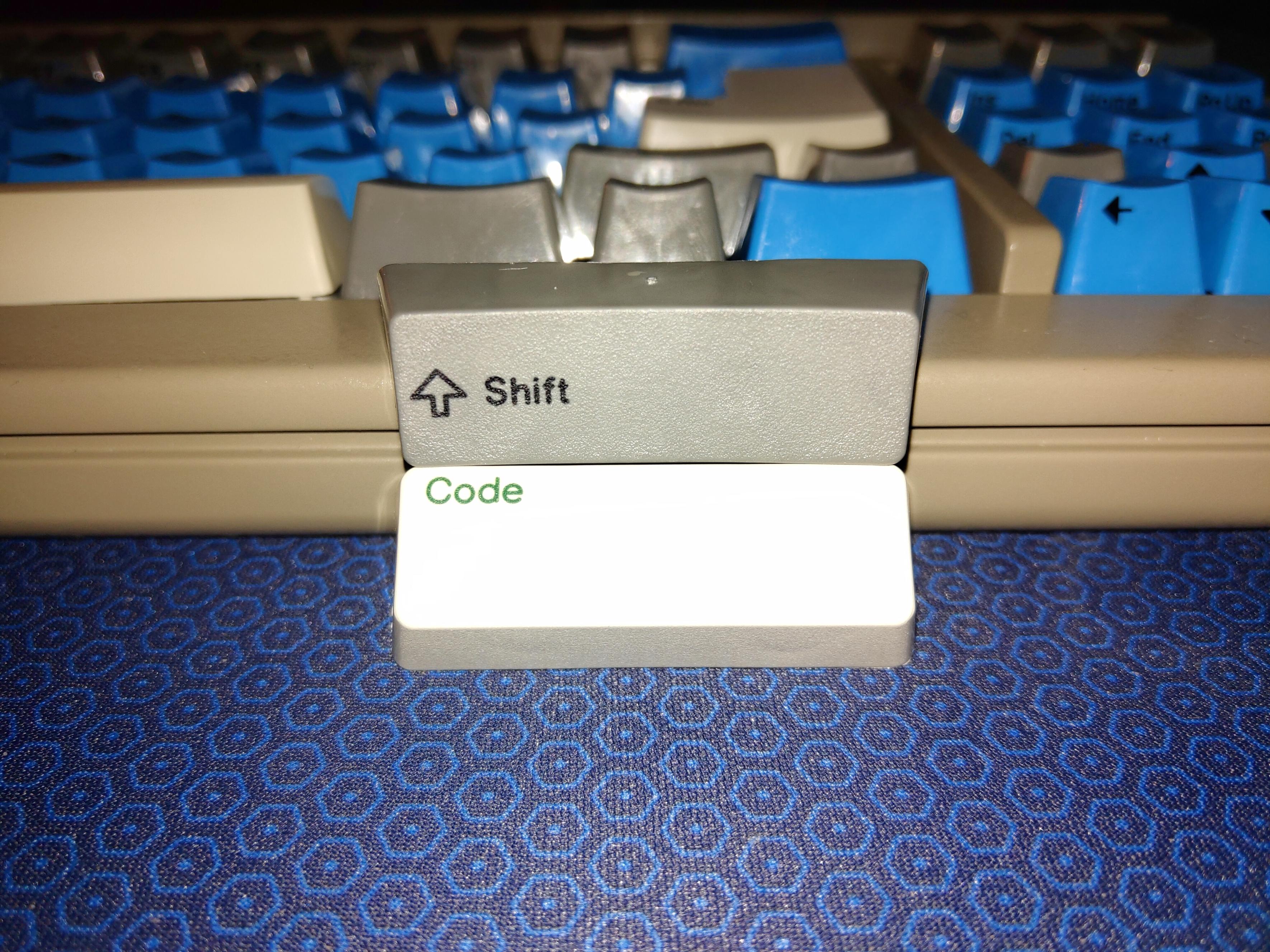

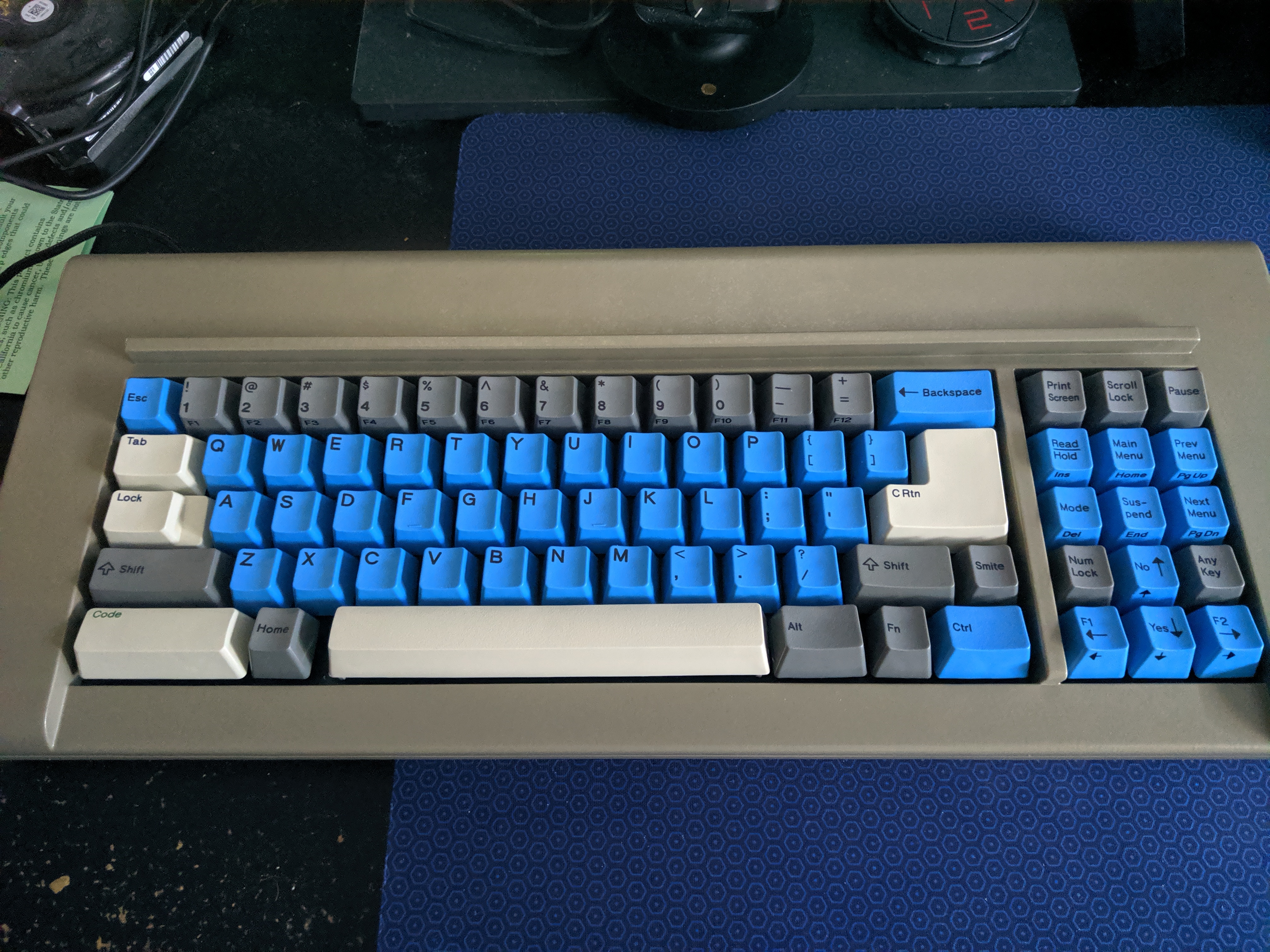

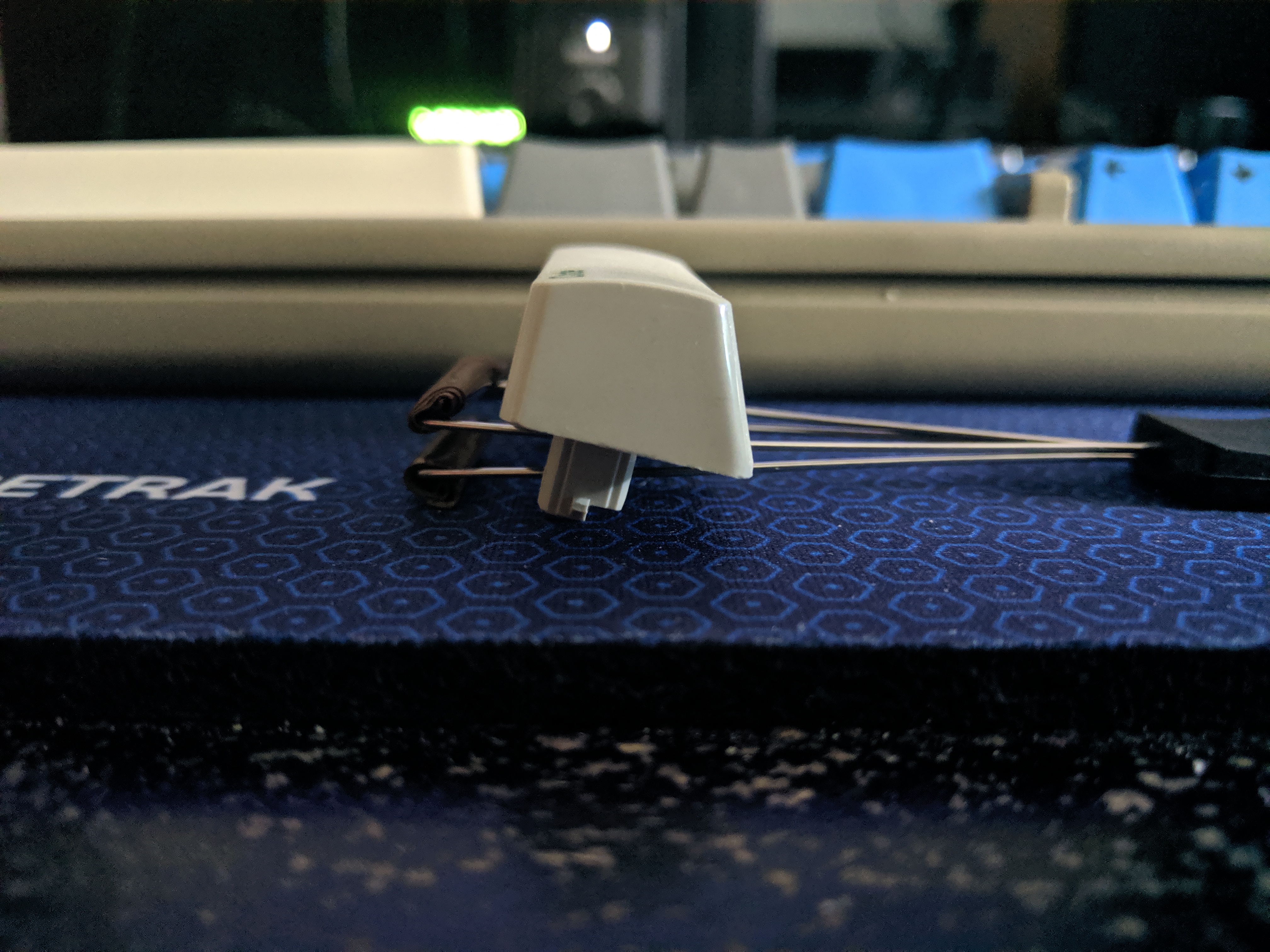

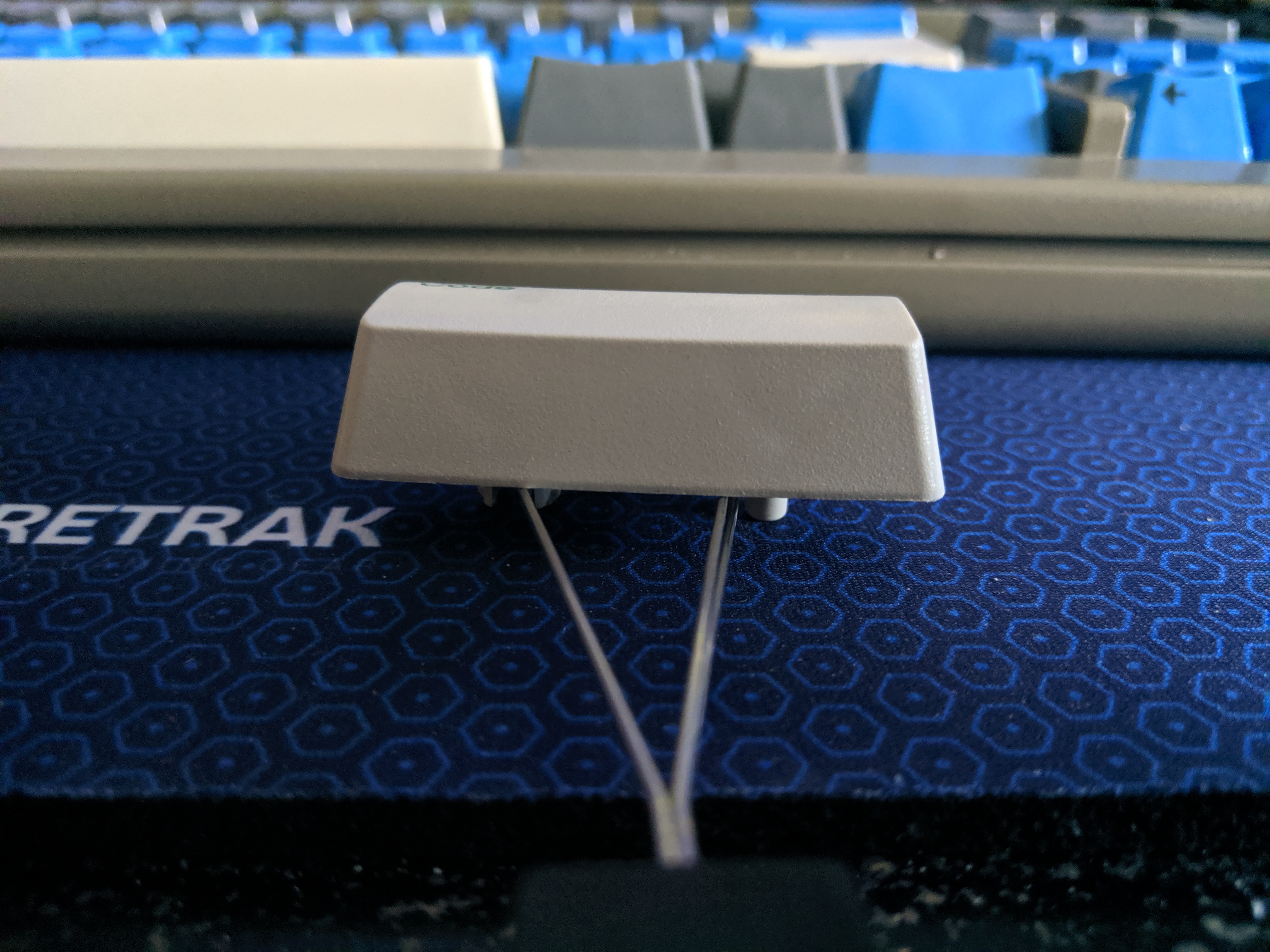

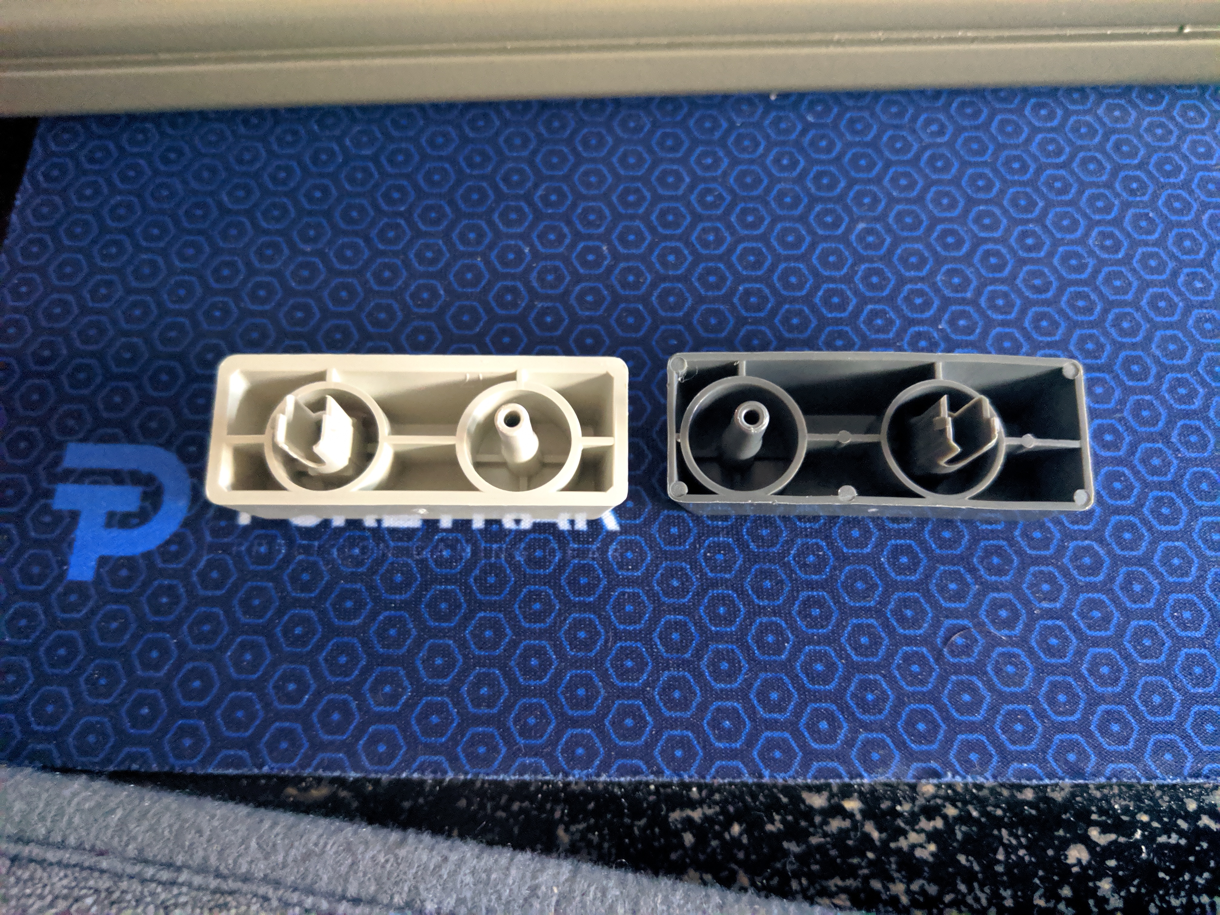

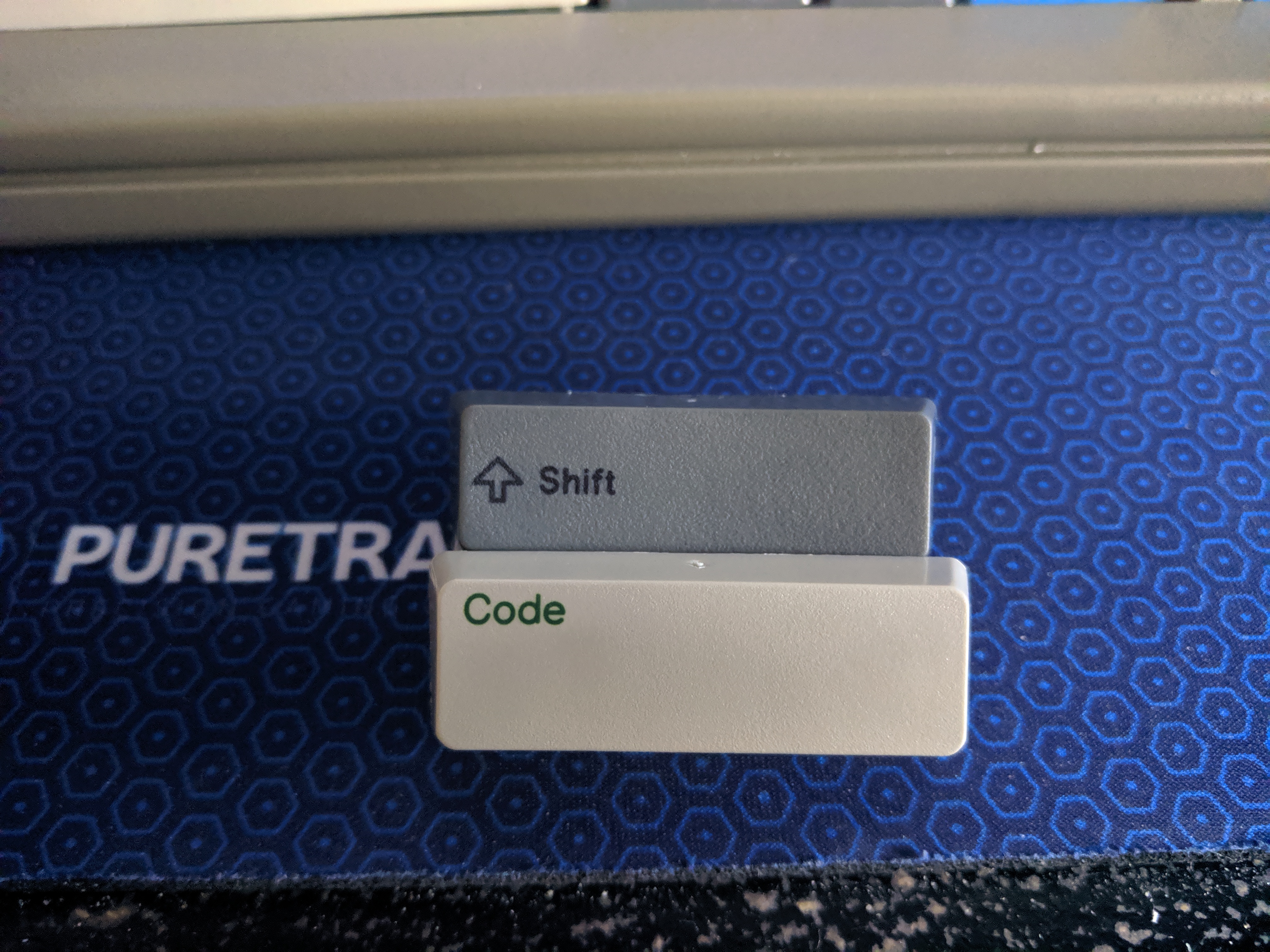

I recently received some photos and interesting details on the IBM Code key, a rare buckling spring spacebar-type key found on wheelwriters and am sharing them, with permission:
"I ordered a whole set of the IBM Wheelwriter 3 keys, and I started putting some of them on the Model F.
The Code key is the size of a regular right shift key; it is 2" long. It does not fit where the right shift goes however, as the bottom stems are in different locations compared to a shift key.
I put mine where it was originally intended to be; the bottom left of the keyboard next to the spacebar. I think it will be my new Ctrl key.
The Code key is the exact same size as Right Shift is 2.75U with different stem and post locations." [stem and post are switched]
Seems like the code key requires a part of the keyboard arranged in a 1.5U+1.25U location. With the new Model F's it seems that this example is 1.5U+1U+fitting a 1U key where the 1.5U key would go.

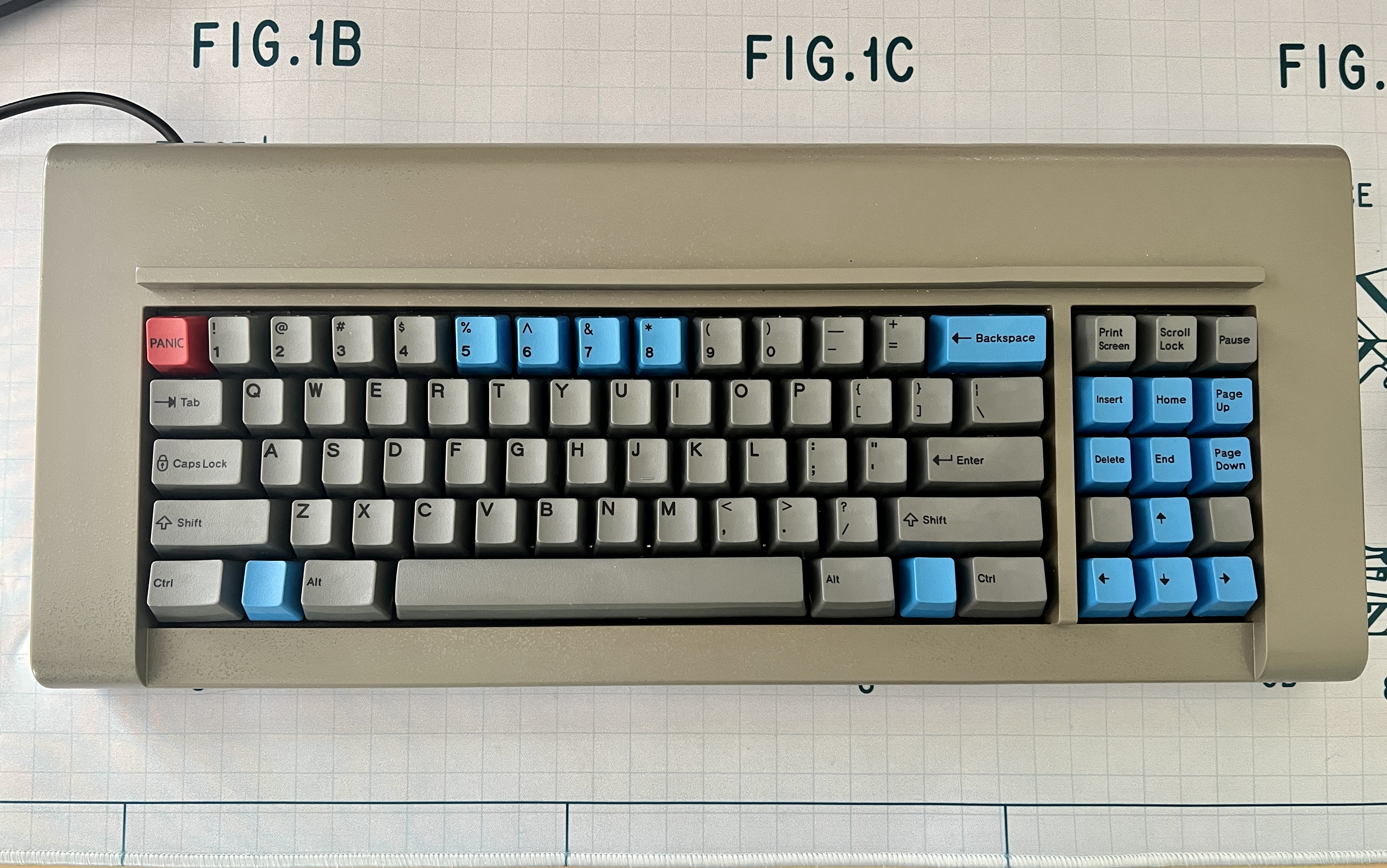

I ordered my board in June 2017, and Monday my F77 came in the mail. A hair shy of five years haha :) It took a bit of fiddling to get all keys moving smoothly, but now it's working perfectly. I'm absolutely loving it, thanks Joe for all the work you put into this!
One thing I noticed is that there is a bit of a 'smear' in the paintwork on top of the case, where the red basecoat shines through (I have a grey one), did others also experience this?
Also, I seem to recall there is a key combo you can do to choose between different layouts for the numpad, but I didn't find anything about this in the manual. Is this true?
