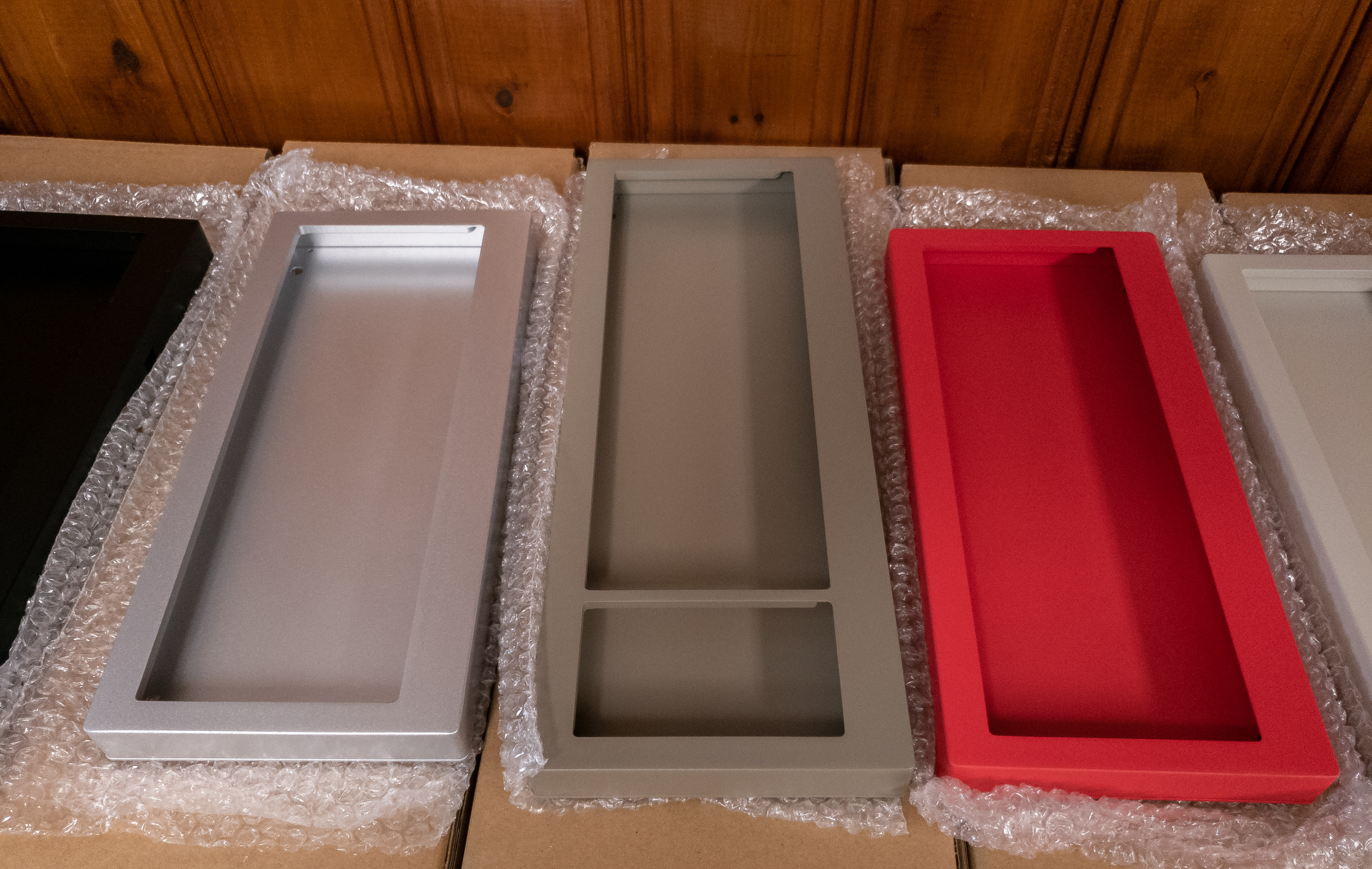

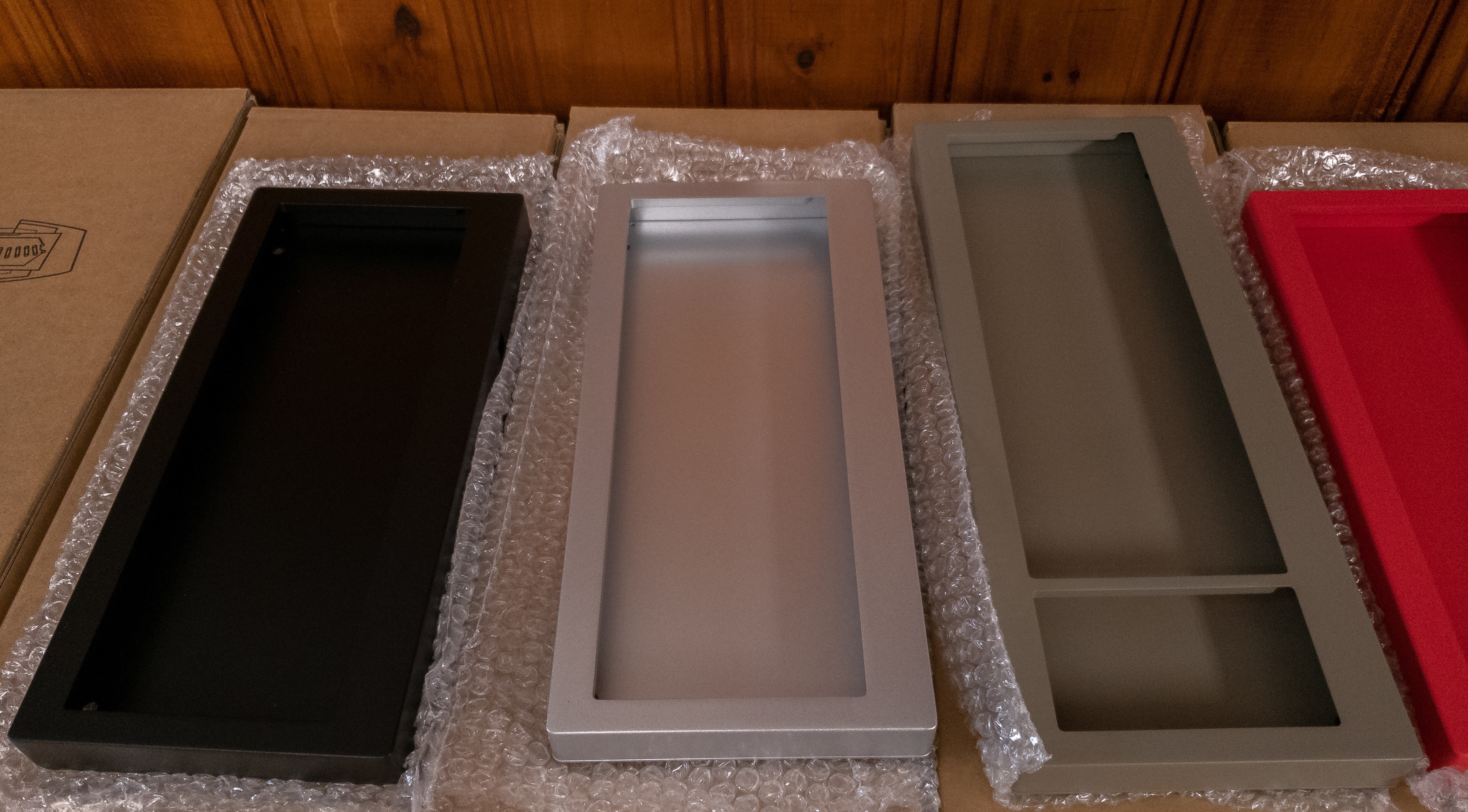

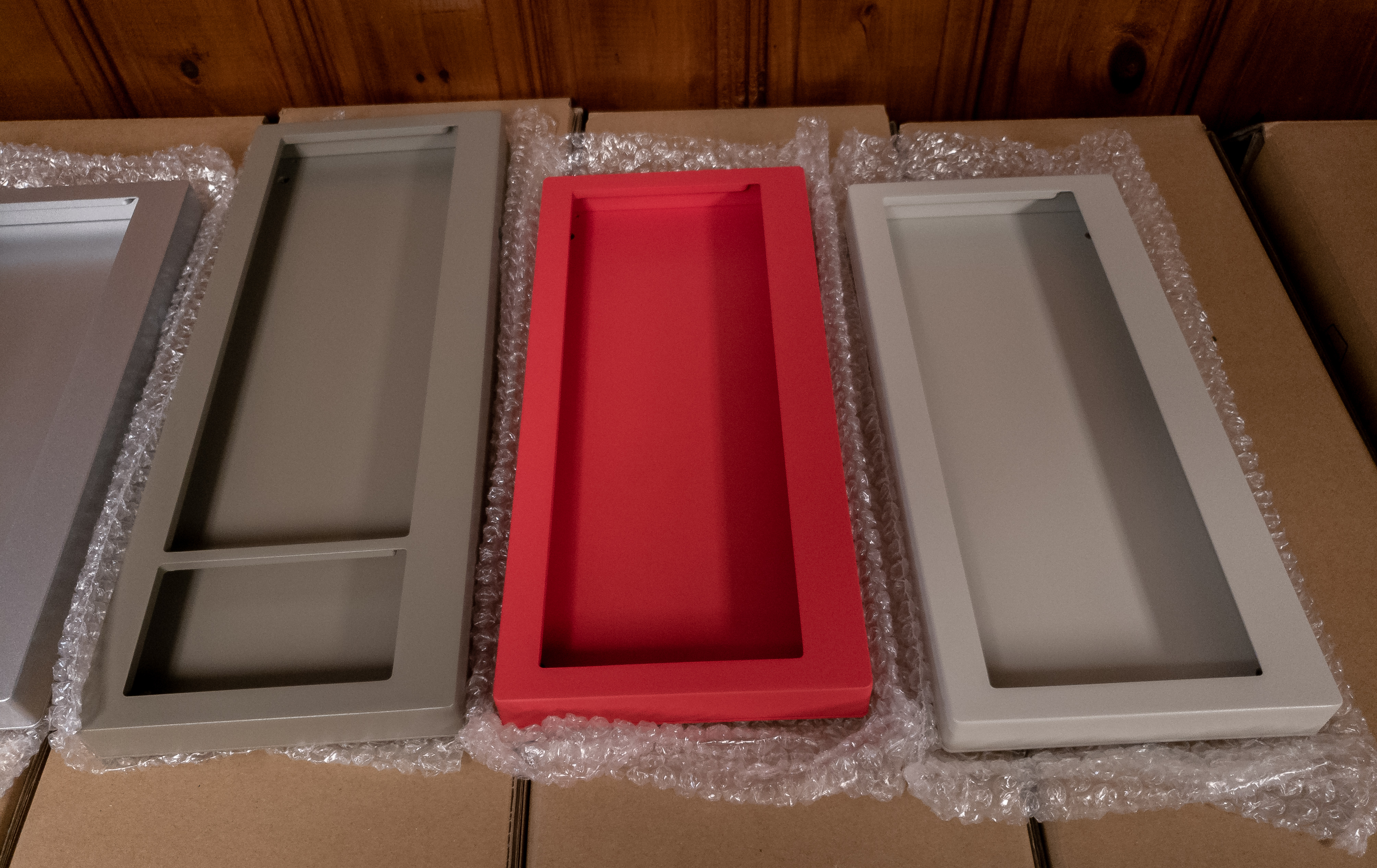

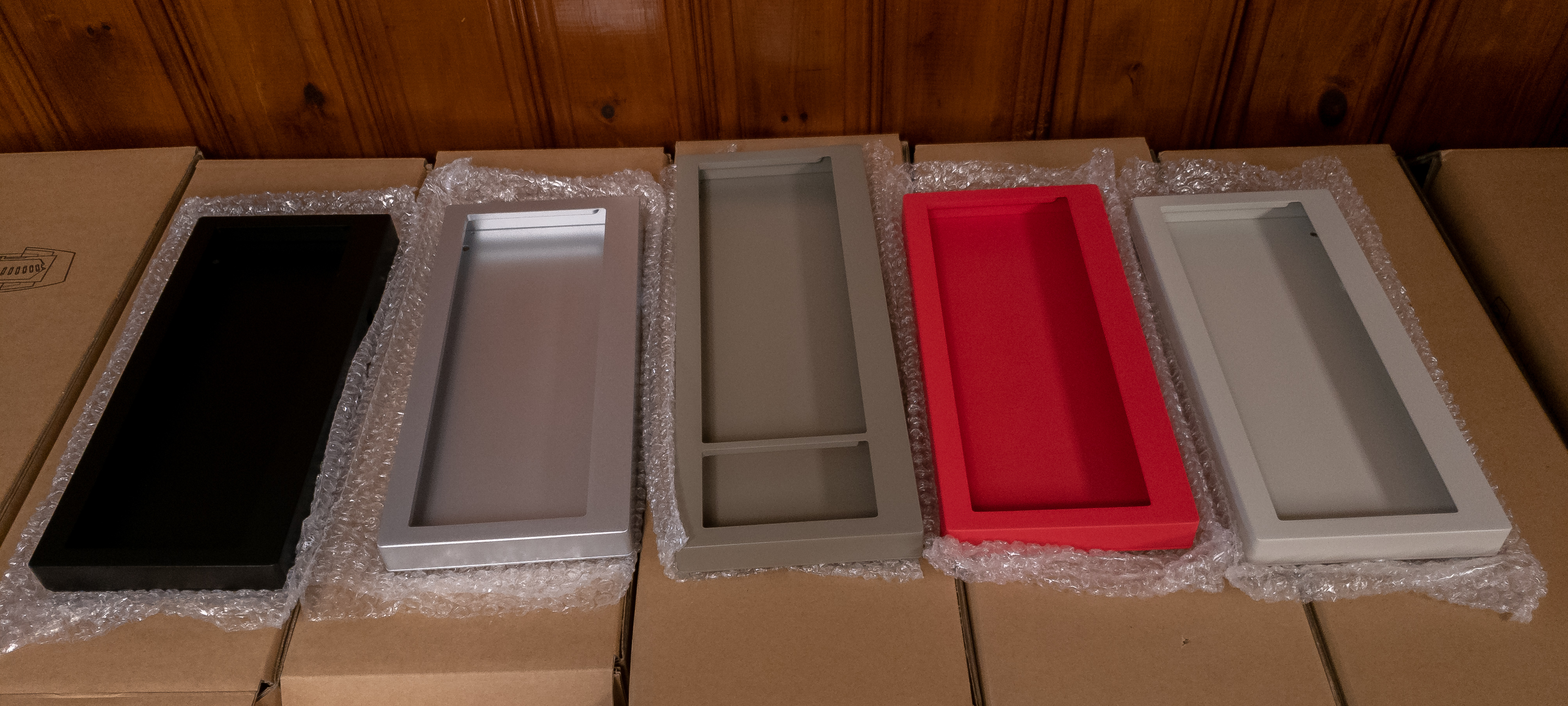

Ellipse
28 Apr 2022, 03:50
Here are some additional photos of the various compact case colors, including the new color options. All feature the new, more durable powdercoating instead of the old anodizing from the earlier batch.
