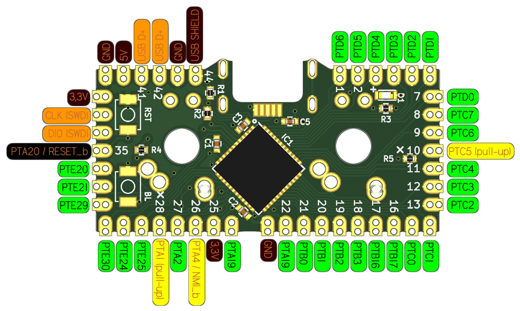

Can we design the teensy alternative for keyboards?
nissarup
24 Jan 2017, 09:30
As this board is targeted at people hand wiring the entire keyboard, I would argue that hand wiring two more wires is not an insurmountable ordeal :)
It would also allow us to pick a better spot for a real reset-button instead of having to make a hole in the case at the exact point of the board.
-[°_°]-
24 Jan 2017, 09:45
while I agree with nissarup I also want to make the board newbie friendly.
Sythe
24 Jan 2017, 10:57
Thats fair enough.
I think 1 button is OK then. 2 isn't necessary.
Since its USB powered, just unplug the cable for reset. :D
Edit:
For the reset though, just leave the pads as is(and don't load) or change to through hole to allow anyone to add a button or w/e if they wish to.
-[°_°]-
24 Jan 2017, 11:13
Sythe wrote: I think 1 button is OK then. 2 isn't necessary.
agreed!
MrBishop
24 Jan 2017, 17:57
yeah one button to throw it into bootloader mode is probably plenty.

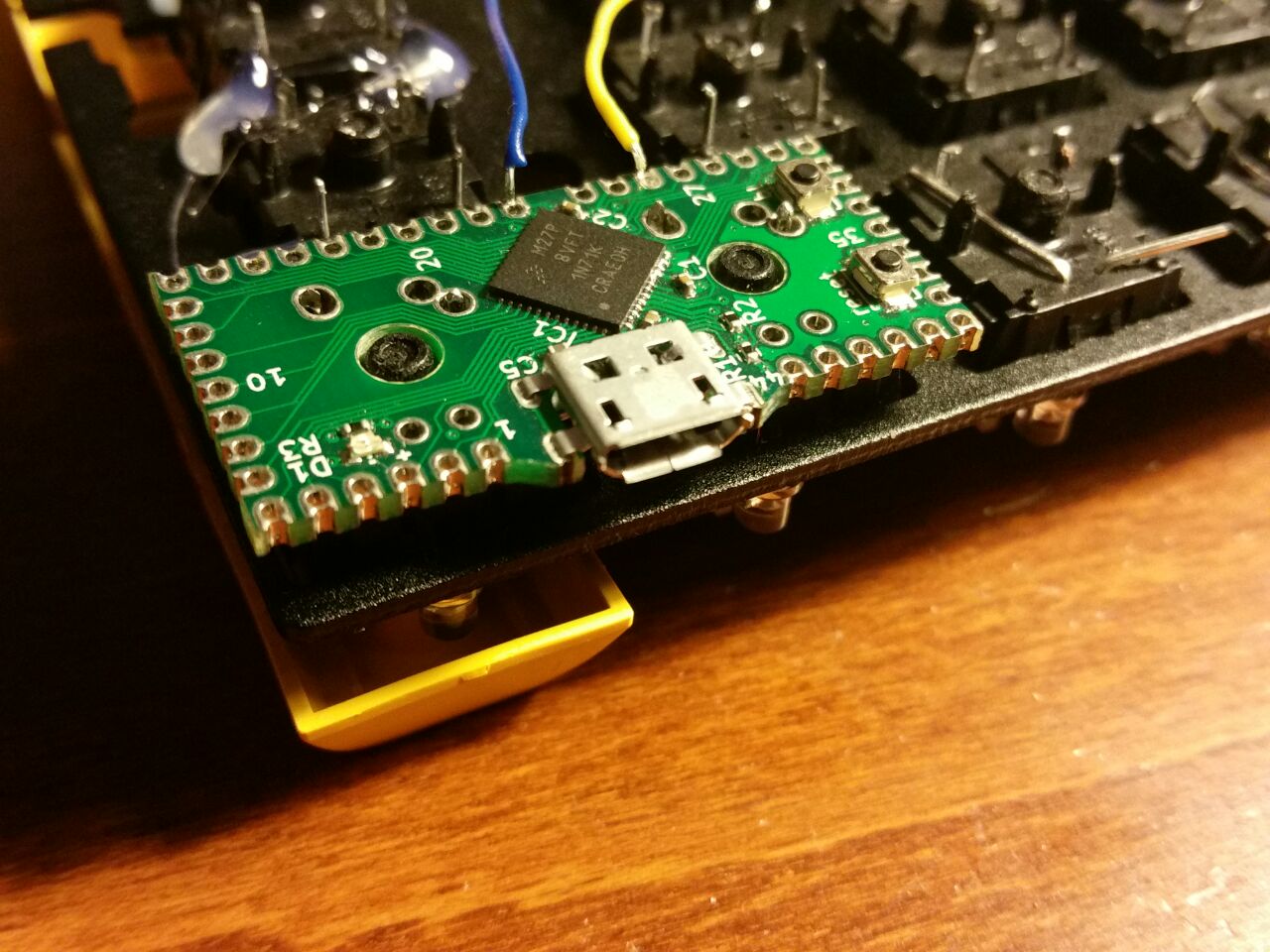

tentator
25 Jan 2017, 23:48
sorry guyz for the delay but I was out of town so far..
now I tried to apply the last patch mentioned up there since the rest should be already there, right?
anyway it seems not to change anything to me:

about the button I would also agree on putting just one of the two and using a cheaper panasonic one..
about physical dimentions it looks quite good to me also with "exotic" 60%-cases:
tent:wq

25 Jan 2017, 23:53
tentator, did you patch both chibios and tmk?
tlt
26 Jan 2017, 00:08
I want to try one of these when they are done. Looks promising!
tentator
26 Jan 2017, 00:19
matt3o wrote: tentator, did you patch both chibios and tmk?
I only did what he mentioned in the last post when he says: "Still this pathc is needed to compile tmk."...
reason is that for instance the other file seems to me already patched:
in a/os/hal/src/hal_usb_hid.c I read:
  obqObjectInit(&uhdp->obqueue, true, uhdp->ob,
                USB_HID_BUFFERS_SIZE, USB_HID_BUFFERS_NUMBER,
                obnotify, uhdp);
tentator
26 Jan 2017, 00:25
edit: oh fukc you are right the other one in tmk for some reason was not patched?! so I manually added the additional true argument.. now it works.. sorry.. will let you know how it works.. ;)
well just a couple of warnings.. hope they are harmless.. ahaha:

tentator
26 Jan 2017, 00:32
yes I confirm, it shows "a" when I press the key :)
and bytheway no problems in flashing from my lenovo laptop running on powered dockingstation here.. instead if I try to do it when connecting it to a usbhub (really cheap chinese one) then it won't.. but I should really throw that hub away actually..

-[°_°]-
26 Jan 2017, 07:42
yay! success! :)
I'll post a full tutorial soon! Also, the new boards won't have issues with any usb.

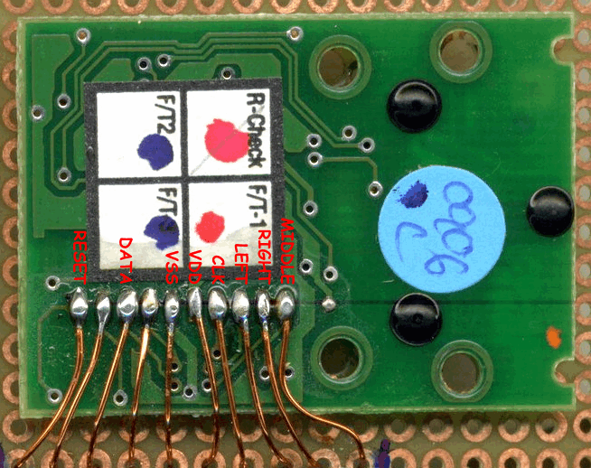

tentator
26 Jan 2017, 23:40
also consider that I now always do hand-wired keyboards using only insulated copper wire which I would suggest to anybody doing them since you really dramatically reduce and avoid shorts, maybe you can get different colored enameled copper wire if it would confuse too much if all wires are the same color then :)
like this down here:

Drew a graphical pinout diagram for the board. :)
Just need to swap the 3d model with a photo of the final production board.

pomk, the diagram looks really nice and very useful.

The pin 41 is USB- instead of + I think.. also I'd prefer a font that makes the number 1 character evidently different from a capital I or so what do you think?
