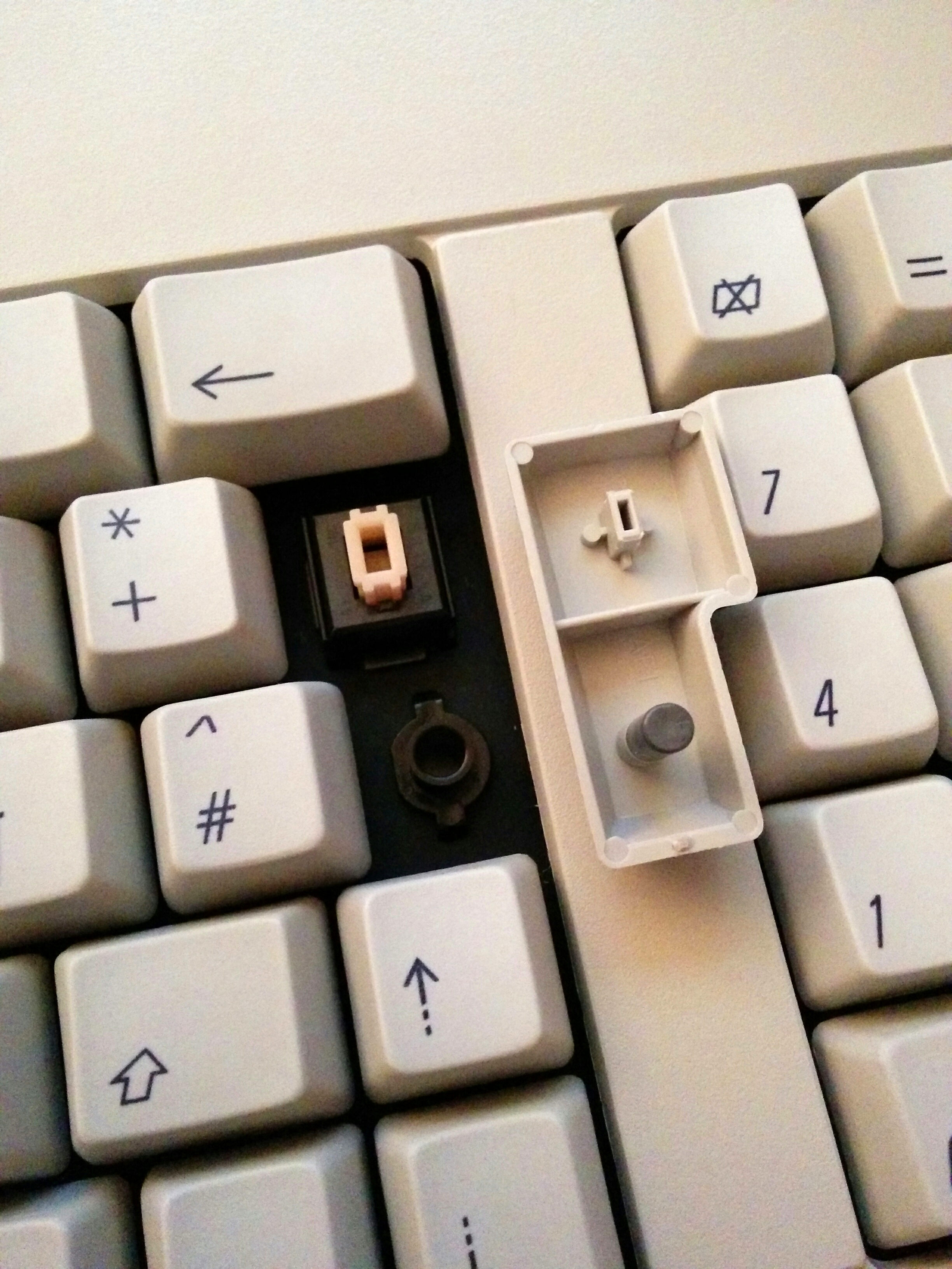

by Hypersphere
@Chyros and emdude: Thanks for the Acme humor! This brought back fond memories of the classic Road Runner cartoons.
Posted: 10 Jun 2016, 22:15

Stiff spacebar? My Apple M0116 uses Orange Alps for every single key except Caps Lock, which uses Alps SKCL Lock. Maybe it feels stiff because of the very odd placement for the spacebar switch. It's moved all the way to the right for some reason, which makes it feel awkward when you're pressing the spacebar on the far left side (although I use the spacebar strictly with my right thumb so it's not an issue for me)
Yes the placement of the spacebar switch is strange, it feels fine on mine here regardless of where I hit the spacebar. I do have the same problem on the tiny ISO return key when I hit it at the bottom of the keycap. The ISO return key is as ridiculous on the M0118 as it is on my M0110. Great keyboard otherwise.

by jacobolus
Some (most? all?) of the salmon Alps Apple keyboards use a stiffer spring (still a salmon colored slider though) in the spacebar switch.

Perhaps a quick cleaning of the space bar might help, if you haven't already tried it. My M0116 with SKCM Salmons also had a gummy space bar (if you pressed it on the far right it would sometimes just stick), but cleaning it fixed the issue.

keycap wrote: Perhaps a quick cleaning of the space bar might help, if you haven't already tried it. My M0116 with SKCM Salmons also had a gummy space bar (if you pressed it on the far right it would sometimes just stick), but cleaning it fixed the issue.
Yes, it's those round "insert" stabilizers that collect filth over time IMO.
