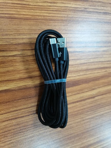

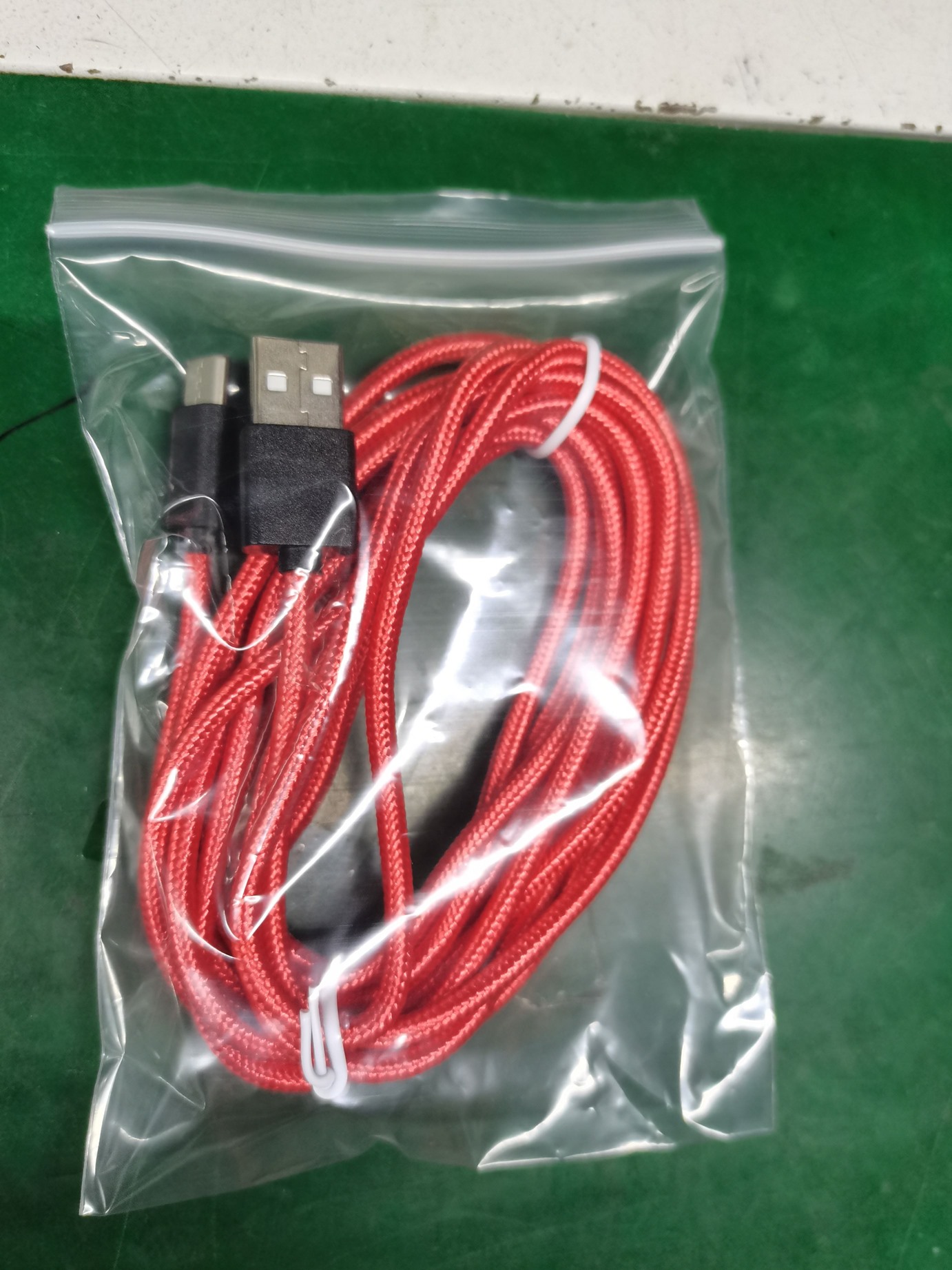

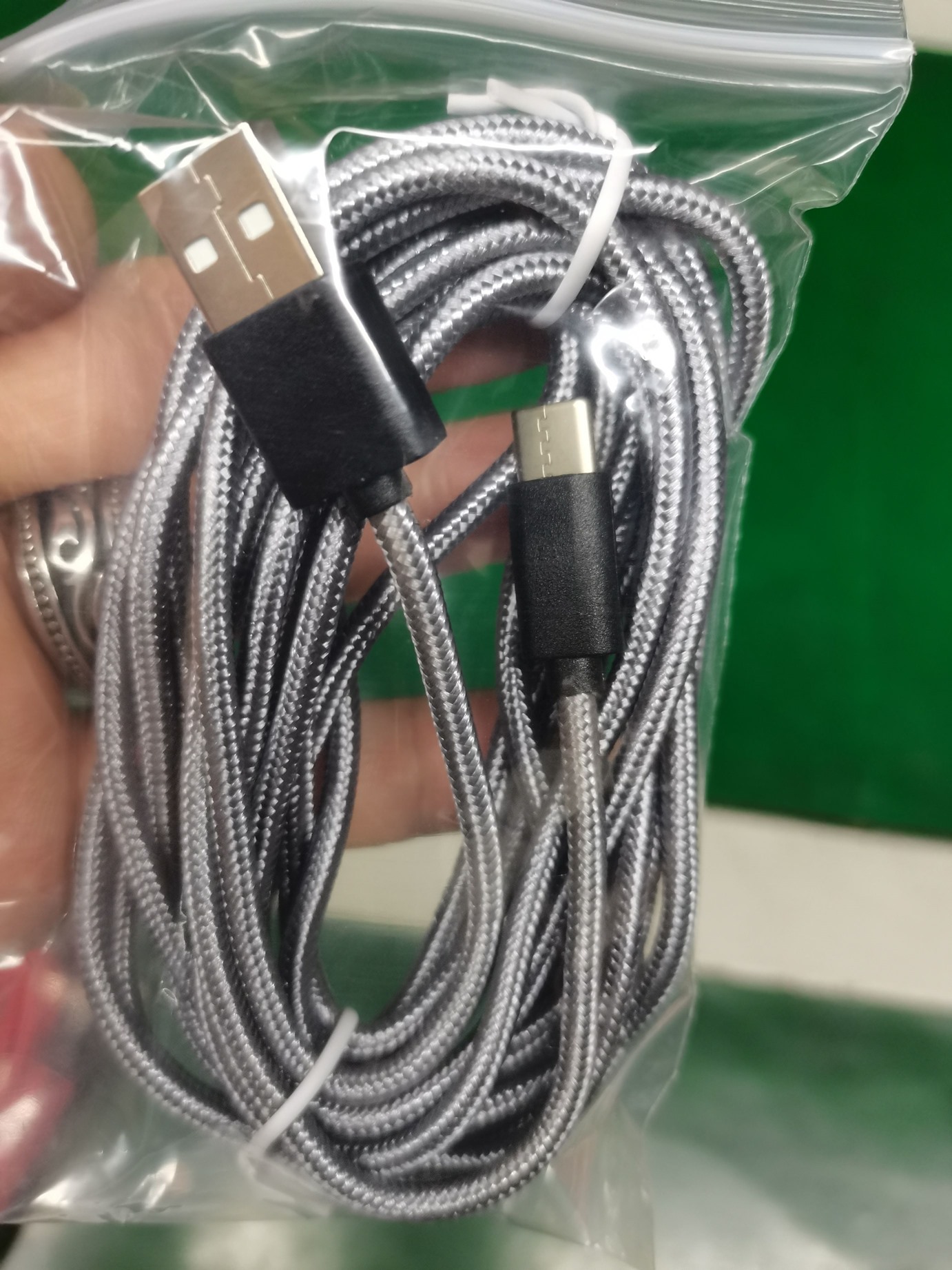

As a small update - as part of the current batch of keyboard parts in the container ship I ordered some USB-C braided cables in red and gray - now available in the store. These are only available as additional cables, not as replacement cables for the ones included with the keyboard (the included ones are all black; all cables are 3 meters in length). https://www.modelfkeyboards.com/product ... ard-cable/
- usb cables (1).jpg (432.2 KiB) Viewed 9444 times
- usb cables (3).jpg (402.69 KiB) Viewed 9444 times
- usb cables (2).jpg (77.21 KiB) Viewed 9444 times

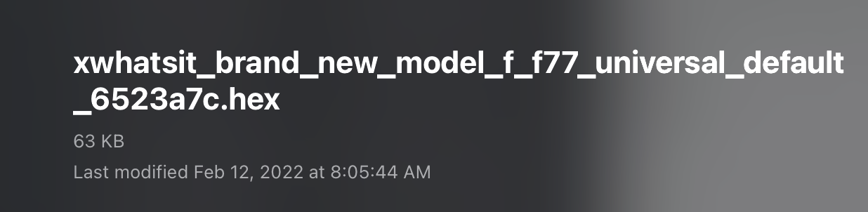

I really hope I didn't ruin my board.. I was trying to flash the default layout back onto the board and I used the [qmk configurator](http://35.164.28.200:5000/) site to compile and download the hex. I used the "universal" file rather than the "wcass" recommended in the manual (damnittttt). After flashing with that firmware, the keyboard doesn't work at all and isn't recognized by pandrew or qmk toolbox.
Is the best course of action to follow this guide?? https://imgur.com/a/kth6dHt#O0IArSE
I'm really shocked flashing that firmware completely took this board offline...
- Screen Shot 2022-02-13 at 10.46.36 AM.png (134.84 KiB) Viewed 9119 times
That post is out of date - I just removed it. Please follow the manual on the project web site. The easy fix is to short the prog pads with the procedure shown in the manual if the utility does not work. Check what the device name is in Device Manager when it is plugged in to the computer - if it says ATMEGA32 DFU then it is in bootloader mode and you can load new firmware with Atmel Flip.

I continually tried shorting the connection between the pads, plugging in the USB cable, and immediately/very shortly after removing the short. Not seeing the device in the Device Manager (not 100% where to look in here), but also Atmel Flip doesn't seem to see a controller. I'm getting slightly worried over heree!
- Location: Romania
Don't worry. If all you did is flash the wrong firmware, then you didn't destroy anything. You need to short the PROG pads while plugging the device in. You need to find something low resistance to short the PROG pads with. You might think that a screwdriver is gonna be enough, but due to surface oxidation it is likely not gonna be good enough. I like to use sharp metal tweezers, because they can dig into the pad a little bit, breaking up the surface oxidation, and I can actually be sure it's shorting. Apply constant strong pressure on the pads while plugging in the keyboard to make sure they're perfectly shorted. If you hear the windows USB plug-in sound (assuming the sound effect is enabled), then you know you have succeeded.
I've even seen people tell me they tried everything to short the pads with, and then I asked them to solder the pads together and it suddenly works. There's something about the size of those pads, or about the fact that they need to be shorted in the perfect moment when the chip leaves reset, that make people think they are perfectly shorted and yet they aren't. This affects me too, sometimes it takes me up to 3 tries to get it into bootloader mode.
Another thing to double check that you are indeed shorting the PROG pad and not the reset pad. I believe in some versions of the wcass controller there is a reset pad on the opposite side of the board. So don't be like 'I see some pads, those must be it', make sure to be shorting the correct ones. (I lost a couple of debugging hours in the past to someone shorting the wrong pads, that's why I'm accentuating this point too.)
When flashing beware that I think atmel and qmk toolbox drivers might not be compatible (not 100% sure about this, since I don't use windows, but often it's like that, the open source tool often needs its custom driver), so depending on which one is picked up by windows, only one of the two tools will work, and you might need to update the driver in device manager to switch to the other tool. So if you used atmel flip to flash the last time, and since then you have not newly installed qmk toolbox, (giving it a chance to overwrite the driver), then keep using atmel flip.

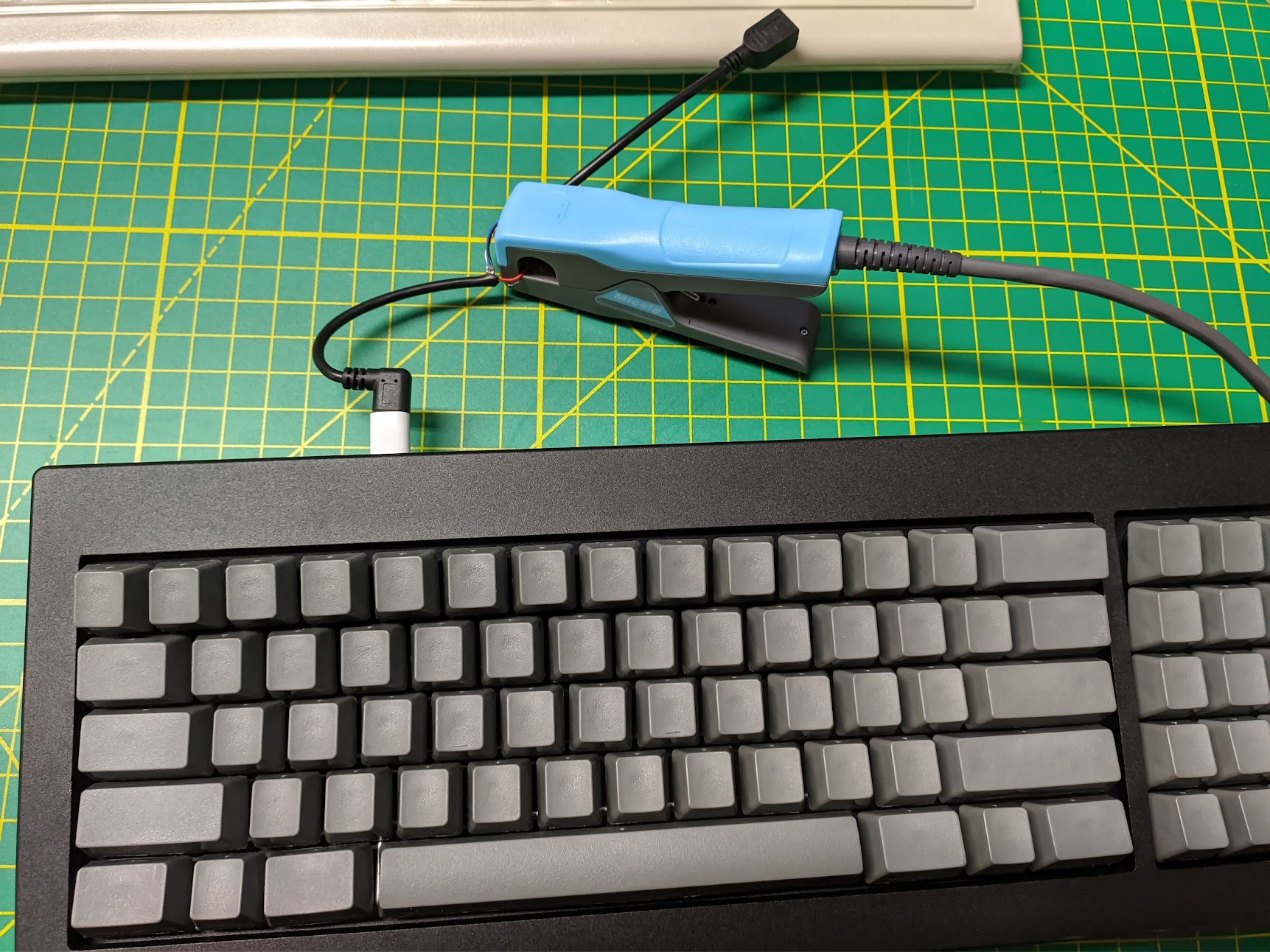

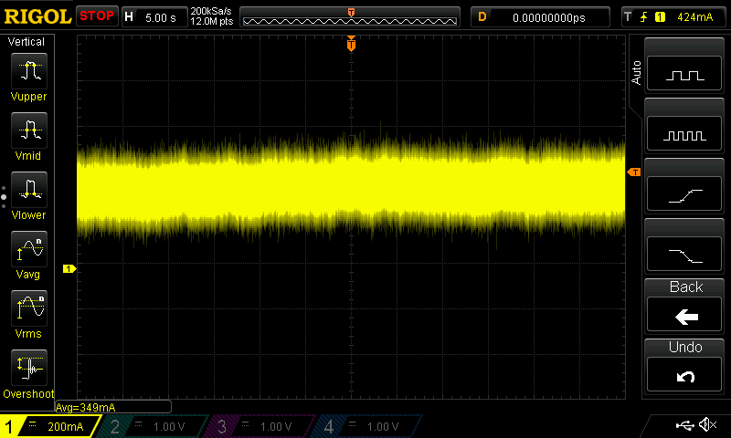

Out of curiosity I broke out a current probe and recorded 60 seconds worth of typing.
- Main mouse: Vertical & (AAA)Wireless
- Favorite switch: Alps SKCM Salmon
Thanks!jsheradin wrote: 26 Feb 2022, 04:38Out of curiosity I broke out a current probe and recorded 60 seconds worth of typing.
Looks to be about 1.75W with no real difference between idle or use. My measurement gear's not really good for the mA range so not sure how accurate this is.Spoiler:
