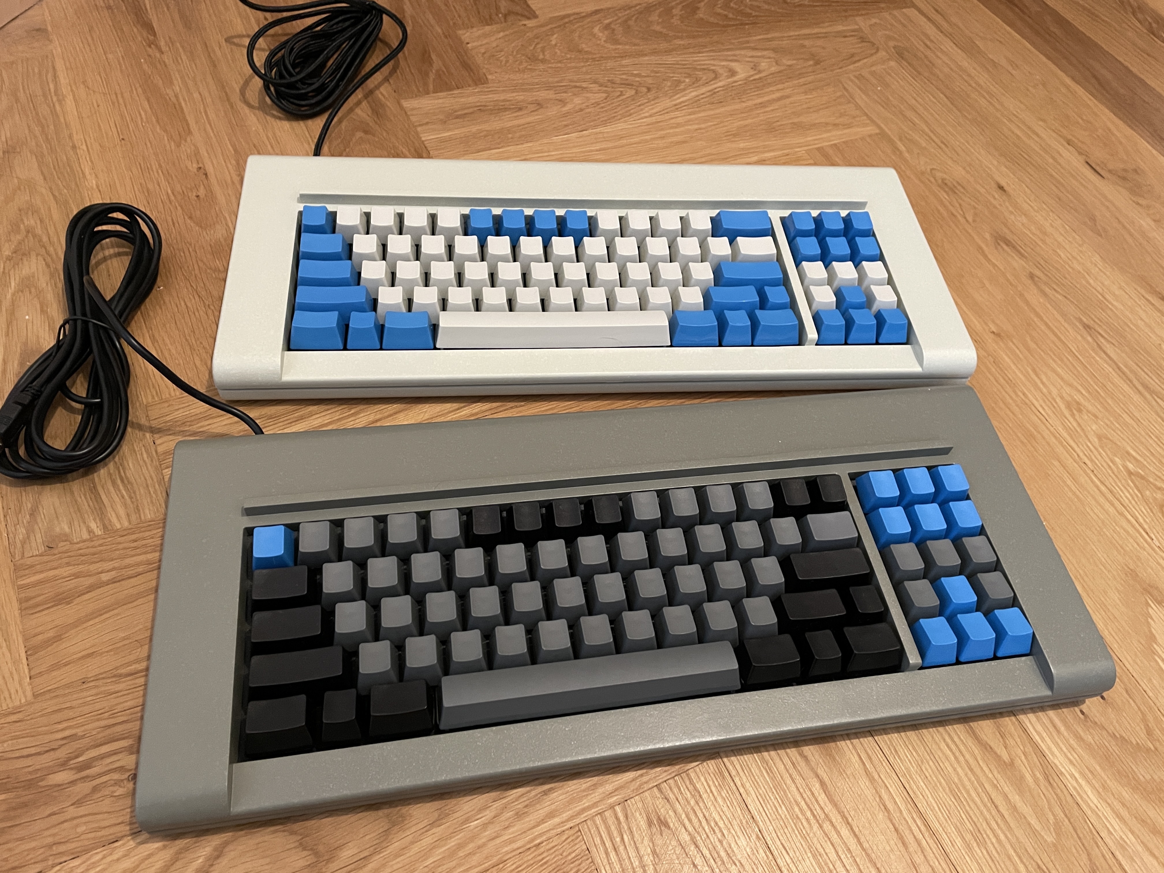

darkcruix wrote: 27 Sep 2021, 17:31 I played around with the keycap colors a bit on the light blue keyboard.
I think the comments earlier convinced me to change around things.
I am still not confident with this combination, but wanted to share it (overall the blue is so amazing looking on its own).
Not feeling the modifier colour, the grey looks great though.
Palatino
27 Sep 2021, 22:53
I prefer it to before. But don’t take too much notice of me: I’m thinking “how could that be improved?” and my answer is along the lines of “lighter grey for the alphas, darker for the modifiers, maybe something less striking for the case - beige should do it”. The Platonic ideal of an IBM keyboard keeps forcing its way into my head: Internalised Beige Machine.

wobbled wrote: 27 Sep 2021, 21:21
:) funny - this is what I did last night:

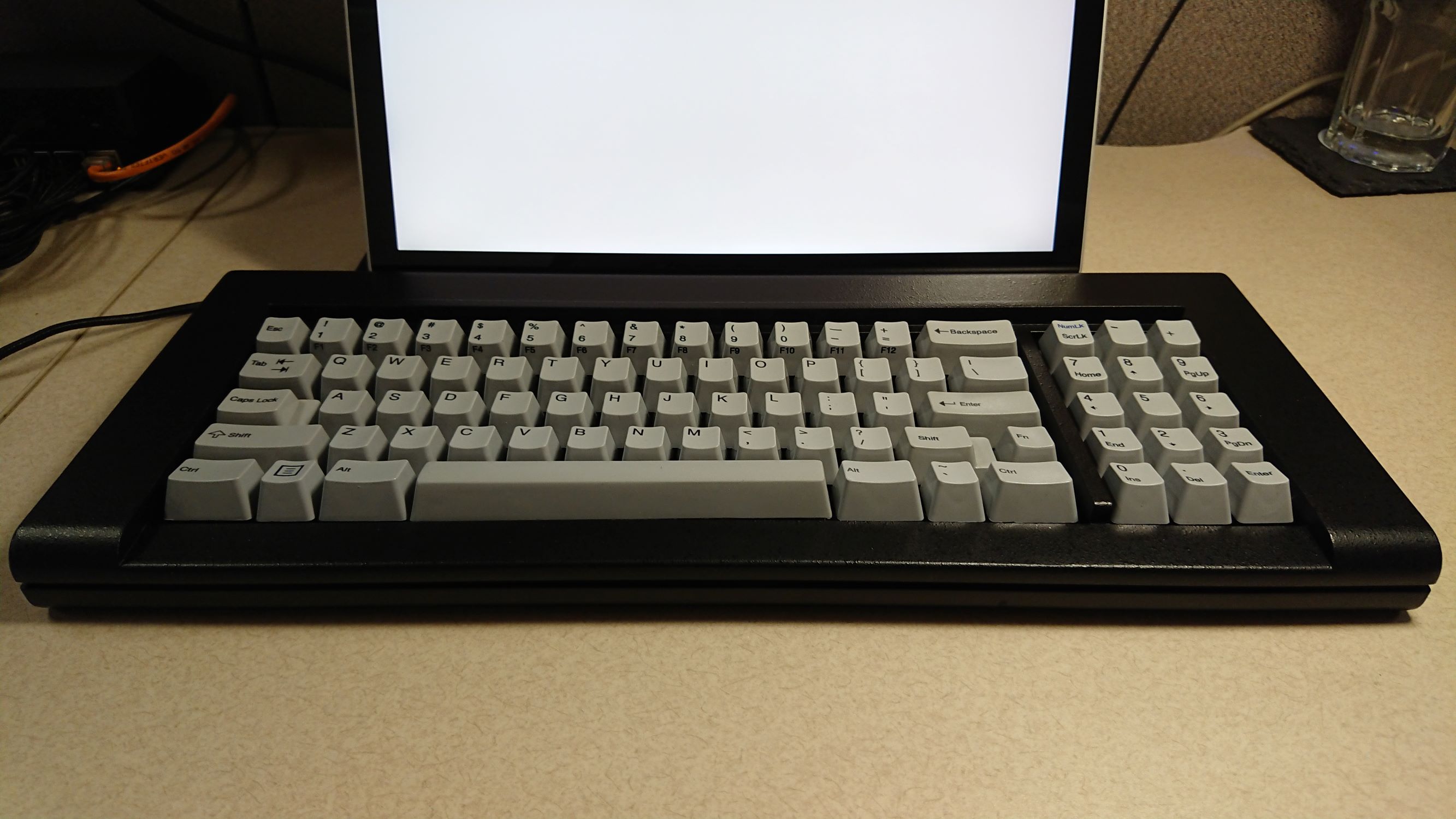

I would like to share (with permission) another nice customer image of the Off-White/Beige and Industrial Gray F77 keyboards with the key color combinations blue/pearl and 60% Dark Gray / Blue / Black.
KB - Copy.jpg (3.44 MiB) Viewed 11044 times

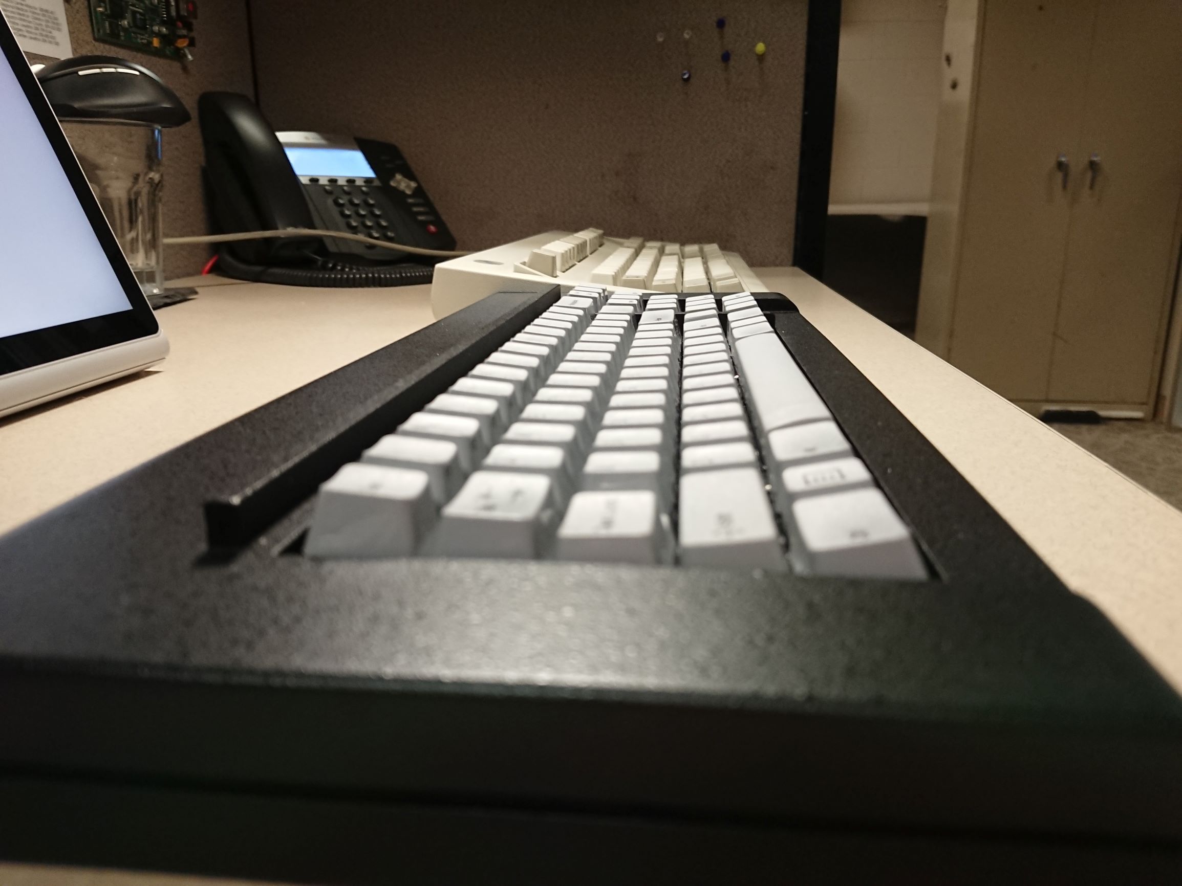

I had ordered the regular pearl/pebble caps from Ellipse for my boards, but here's my black board sporting some gray caps I had from Unicomp. I think I rather like the gray on black look, and it's making me think I should buy a set of 60% grays from Ellipse... 8-)
Here it is with the main rows lined up with a Model M (my daily driver for many years)...perfection!
Ellipse wrote: 26 Sep 2021, 18:34NathanA the angle of the interior plate should be nearly identical between the zinc and ultra compact cases - that's how it was designed - to be close to the Model M and original Model F angles.
To be clear, I'm not talking about the angle of the plate, but how far the distance is between the top of the keycaps on the bottom row, and the surface of the desk that the keyboard sits on.
The stated height dimensions of the ultra compact vs. classic cases are 25mm and 30mm (though tomshardware says 29mm, and that's actually what I get when I measure myself). But the "notch" cut out of the bottom of the classic case (below the bottom row of keys) sits at about 22mm high when I measure it, so it's a good 6-7mm lower than the top of the case.
So if the ultra compact case is universally 25mm high on all sides, but the bottom of the classic case is only 22mm high, then it sure seems like either one of two things has to be true: 1) the ultra compact as a whole sits 3mm higher than the classic, or 2) the bottom lip of the ultra compact sits 3mm higher than the bottom lip of the classic, but the height of the keys themselves when mounted inside is identical between the two. 3mm isn't a lot, but it's also not nothing...
...or maybe 3) I'm all wet? :lol:
Anyway, that's why I'm curious to see a classic and an ultra compact lined up horizontally, similar to how I lined up my F77 classic with the M.
