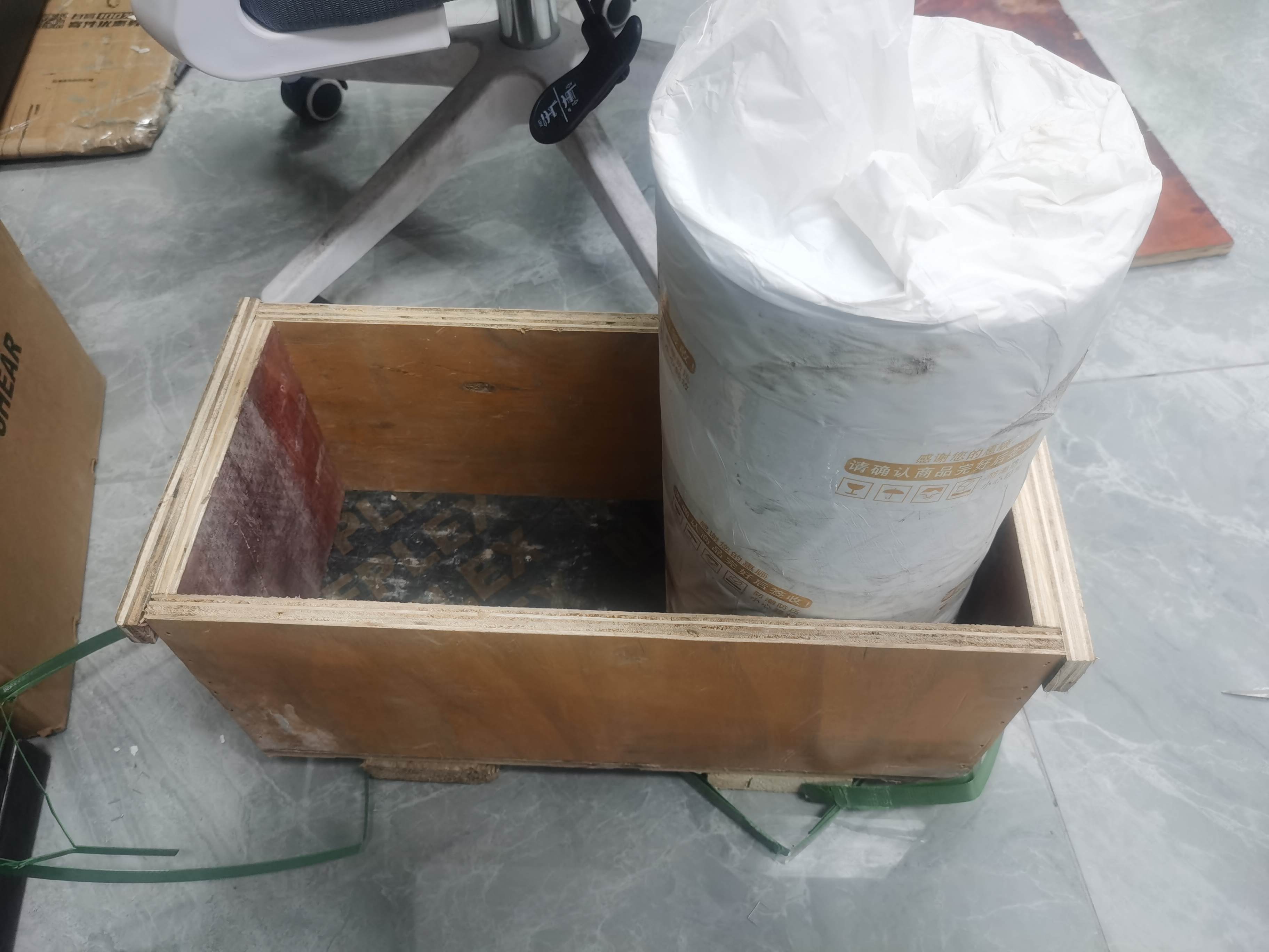

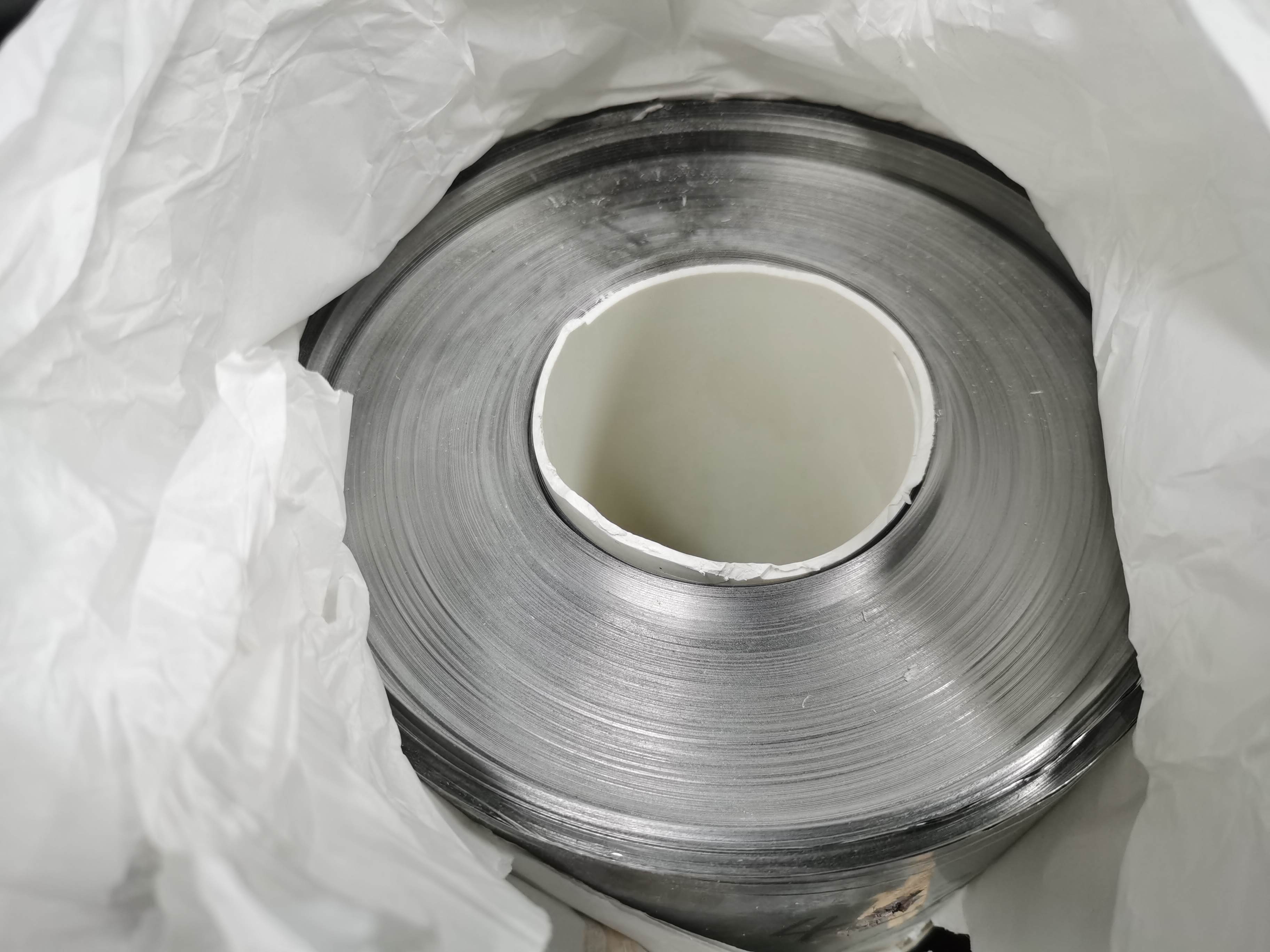

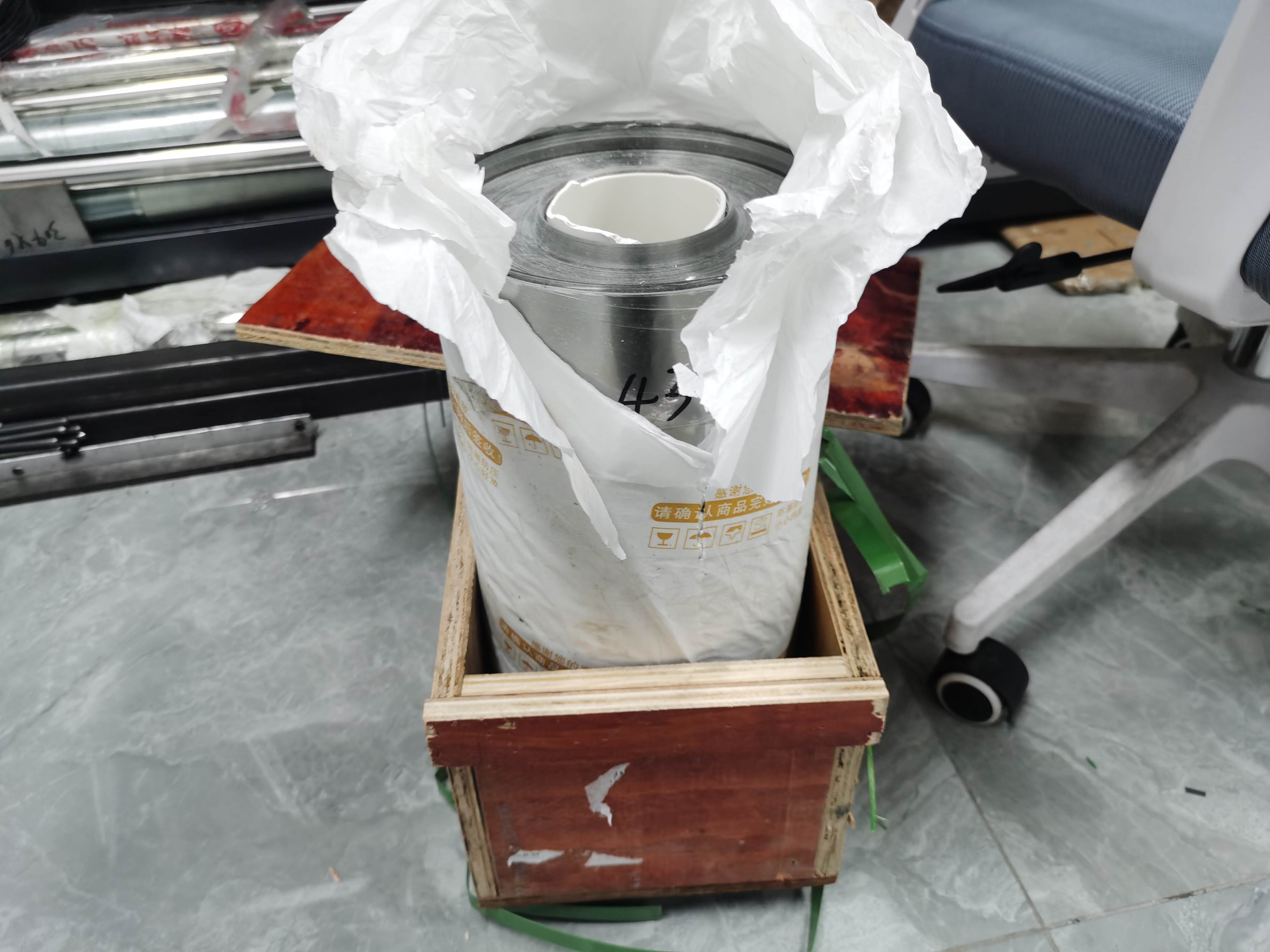

The S45500 thin material for the beam spring modules has shipped to the stamping factory. This "small" amount of material is enough to supply several hundred thousand modules. Finding the material was not too difficult but finding a supplier willing and able to produce such a "small" quantity of the material (i.e. less than one metric ton!) was challenging.
The material is a super-thin sheet that is supplied on a roll. Each sheet is a fraction of a mm in thickness.
2023 08 02 S45500 material (1).jpg (361.07 KiB) Viewed 185218 times
2023 08 02 S45500 material (2).jpg (513.97 KiB) Viewed 185218 times
2023 08 02 S45500 material (3).jpg (394.87 KiB) Viewed 185218 times

Ellipse wrote: 03 Aug 2023, 02:36 S45500
How was this material chosen? I assume real IBM modules would have been made from spring steel of some sort. I'm not a metallurgist but the composition of S45500 seems a bit different from any of the commonly available spring steel varieties. The datasheet doesn't list springs as one of its typical applications.
Was there any consideration or testing in regards to work hardening of the thin area around the center melt rivet? Of the few failed beamspring modules I've come across they always broke right in the same spot. If IBM was using actual spring steel and still seeing failures, I'd be very curious how these modules hold up after a year or two of use.
I think the final physical properties are also greatly influenced by the processing the raw material undergoes. Cold rolling it this thin might make it brittle but tempering it too much might make it too soft for this application. I think stamping typically hardens the material near the shear line making crack inception easier. There might need to be a tempering process after stamping to remedy this. I've run into issues on work projects where laser cut, wire EDM, and stamped components all behave wildly differently under certain circumstances.
Ellipse
04 Aug 2023, 20:06
jsheradin the team over at the Silo project posted an elemental material analysis of the IBM beam spring metal, so we know what it was. I reposted this analysis along with the S45500 composition earlier in this thread to do an element-for-element comparison, and I also posted a brief history of this relatively-new material (at the time IBM was developing the beam spring keyboard).
I have found that the plastic rivet around the metal should be ideally the same dimensions as what IBM did (not too big or too small; to minimize issues), and that the bigger issue of failure I have noticed is due to over-bending the material during assembly at the factory, as happened with a number of the Round 1 modules installed in the keyboards (one reason for including replacement modules with each board). This was fixed with the updated Round 1 modules included in the current first aid kits and for the Round 2 modules, though I will still include replacement modules with each Round 2 board to account for damage sustained in shipping.
Yes there were some processes done after cold rolling to reduce potential brittleness in the material.
The springs themselves are made from more standard spring steel, not from this S45500 material.
