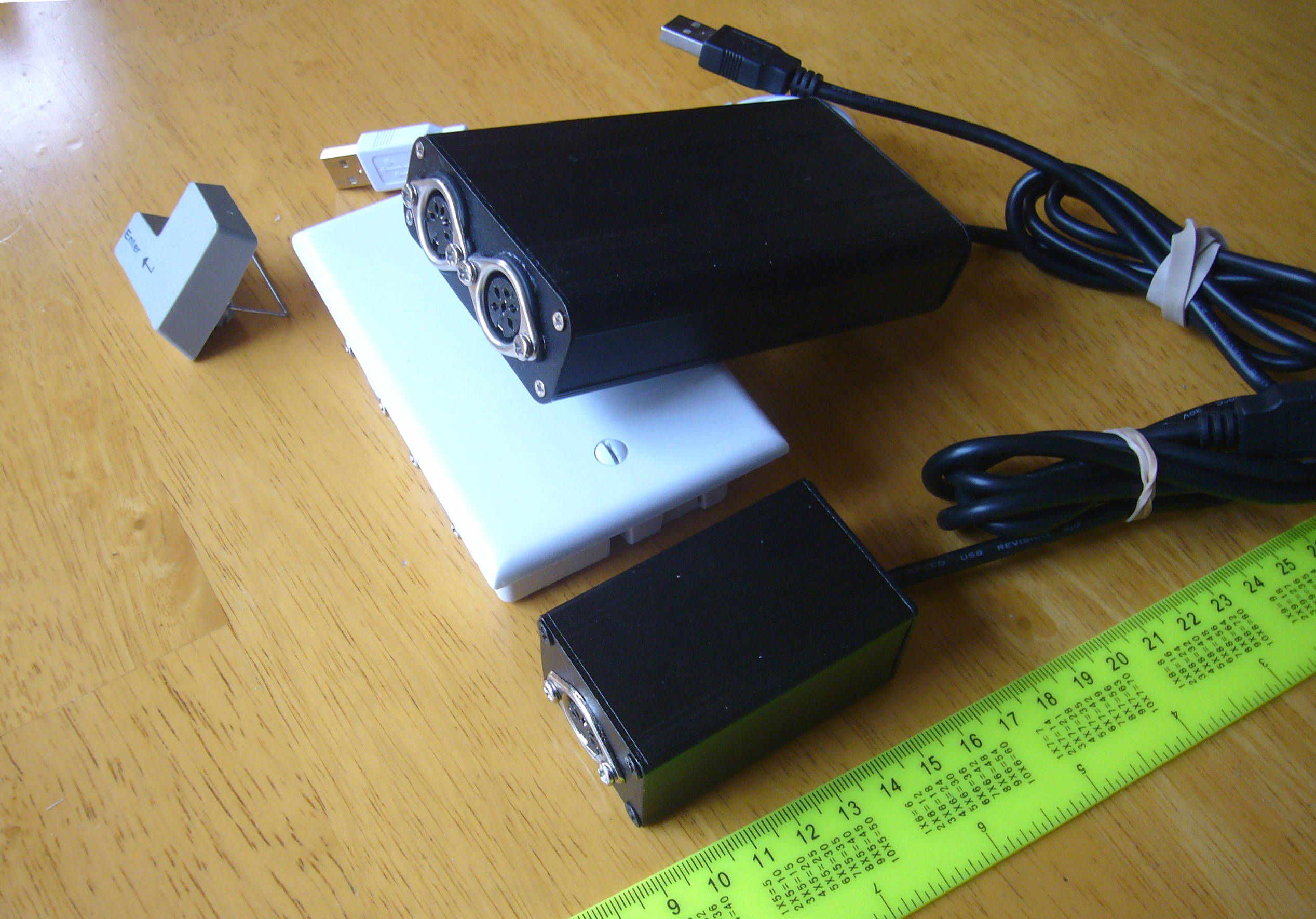

After almost 5 years of exposed circuitry I finaly got around to print myself a case for my adapter (No more accidental short circuits Yey!). The slot for the Teensy ended up being slightly too small so it has to be mounted at an angle, doesn't move though
. On the other hand the 5 pol 240 deg female press fits just right
G80-1800 and AT->PS/2 adapter for scale.

That looks super clean. I've been thinking of picking up a 3d printer for exactly this type of project. I must confess though, I'd really like to be able to print a 60% case in one pass and I'm having trouble finding a decent printer for it b/c i live in a small apartment and it's not really practical to have.Mikelittoris wrote: After almost 5 years of exposed circuitry I finaly got around to print myself a case for my adapter (No more accidental short circuits Yey!). The slot for the Teensy ended up being slightly too small so it has to be mounted at an angle, doesn't move though. On the other hand the 5 pol 240 deg female press fits just right

Nice, that's what I need to do also. I keep on failing by not finding the right container though.Mikelittoris wrote: After almost 5 years of exposed circuitry I finaly got around to print myself a case for my adapter (No more accidental short circuits Yey!). The slot for the Teensy ended up being slightly too small so it has to be mounted at an angle, doesn't move though. On the other hand the 5 pol 240 deg female press fits just right

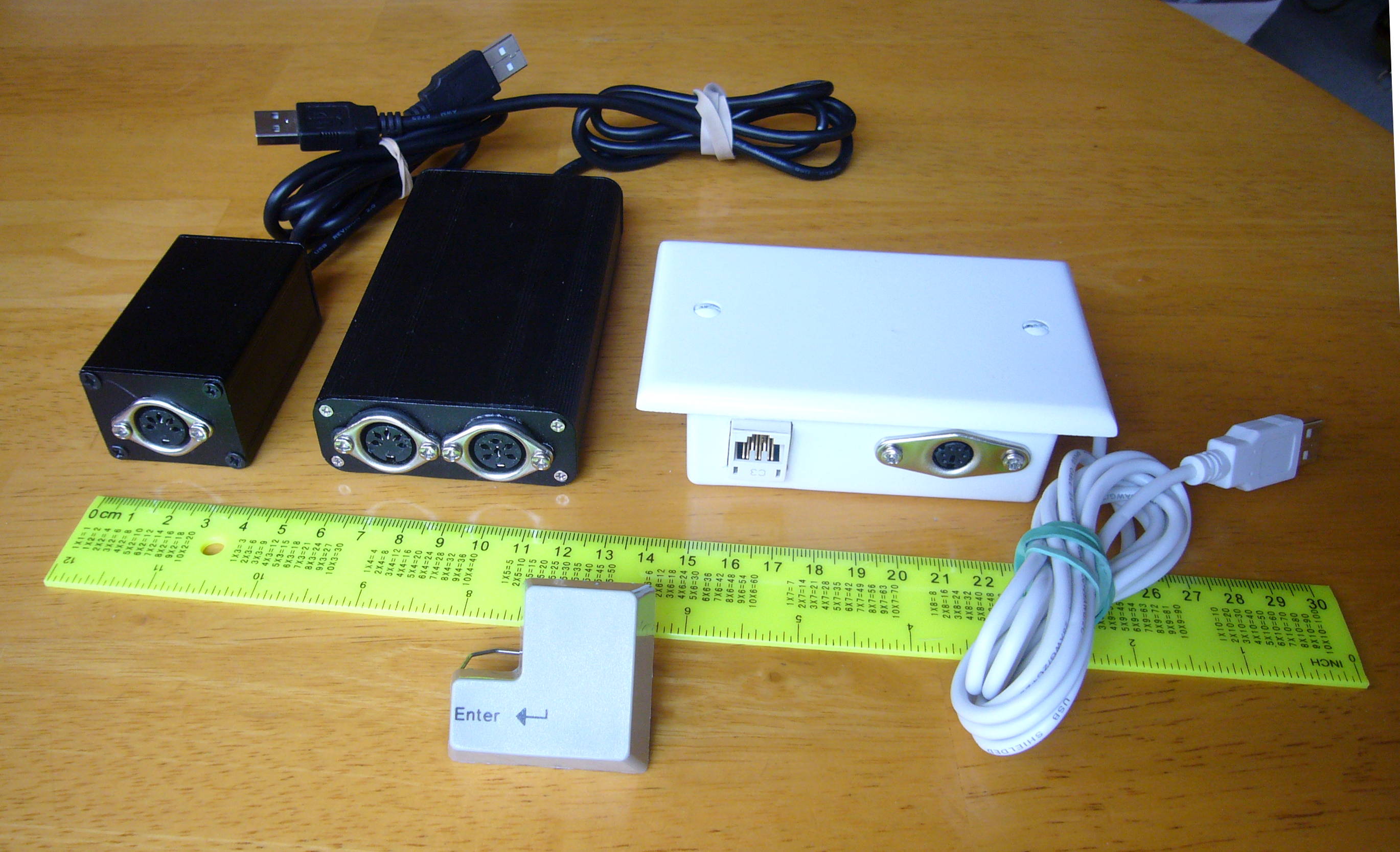

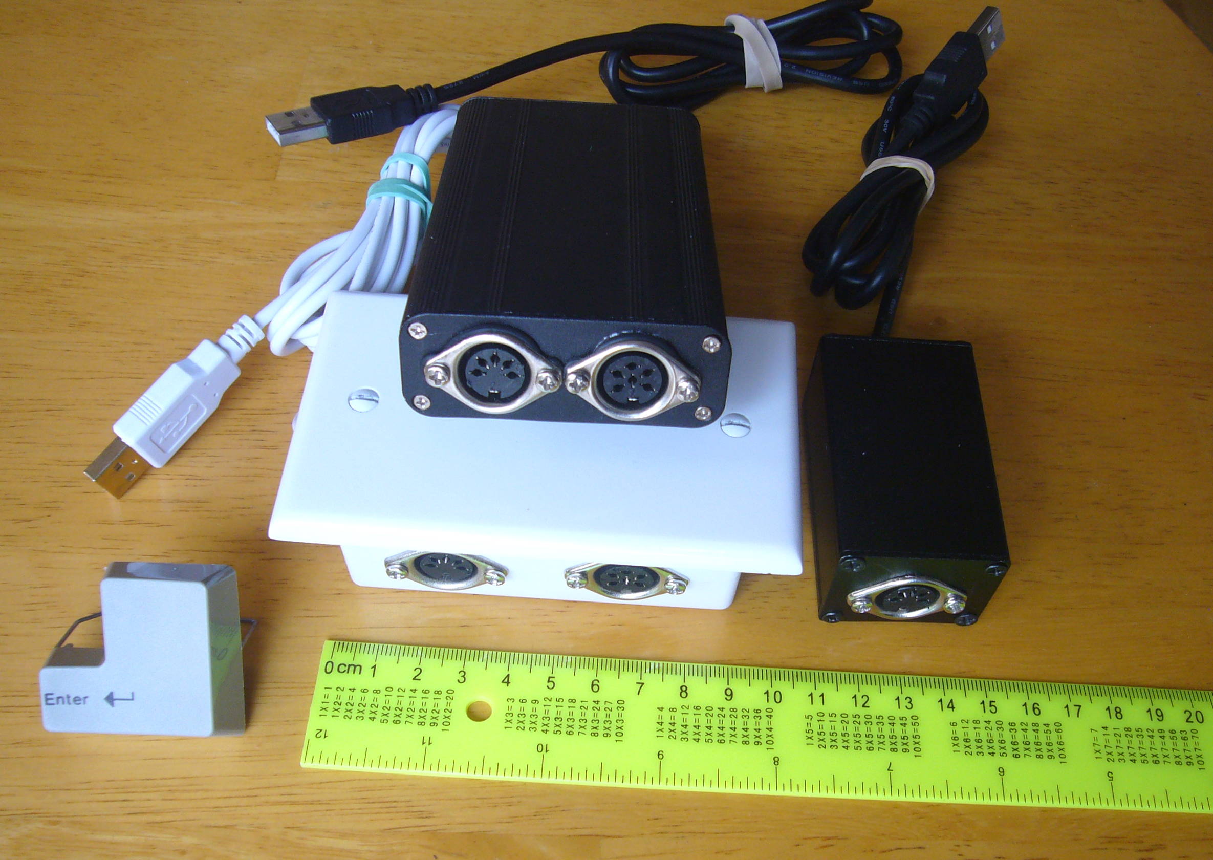

I have built several enclosures. First, I used plastic project boxes that were usually unsuccessful due to cracking when I drilled relatively large holes in relatively small areas.
Now, I have a current "testing" box with 4 connection types built in a residential wiring box, and 2 aluminum project boxes. The one with both larger DIN sizes is comfortable to work in but rather large and heavy.
The small one, which I consider perfect, is about as small as you can go with a standard Teensy.
http://www.ebay.com/itm/Aluminum-Box-PC ... SwQoFWOazM

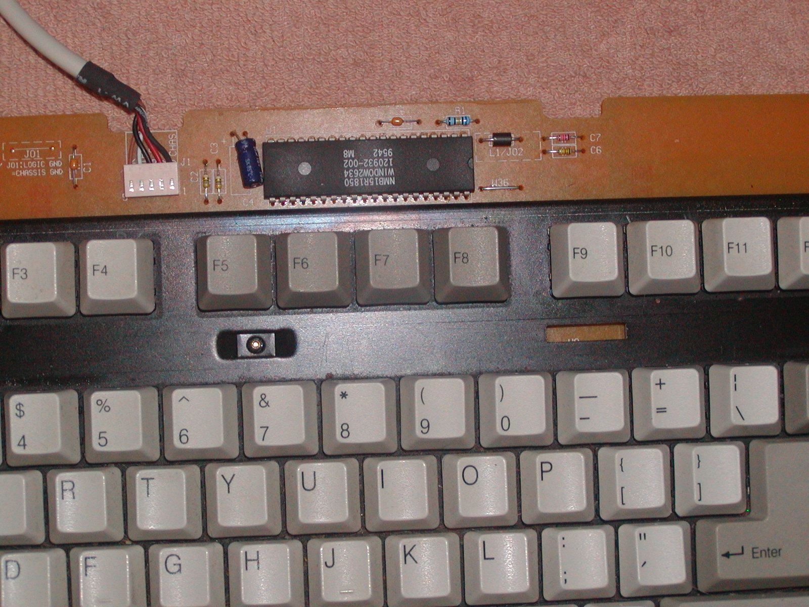

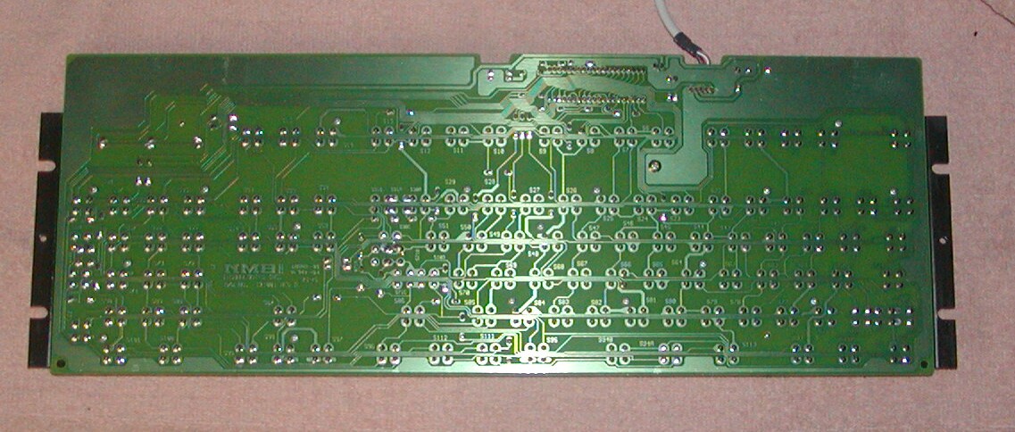

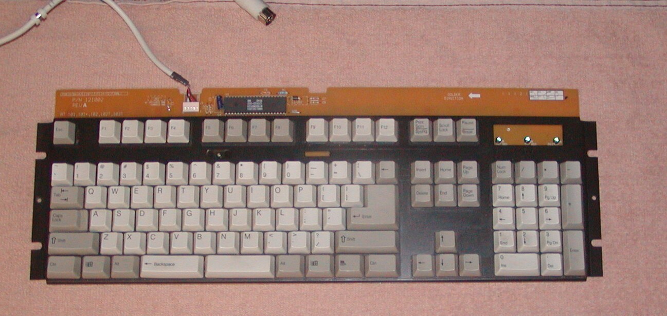

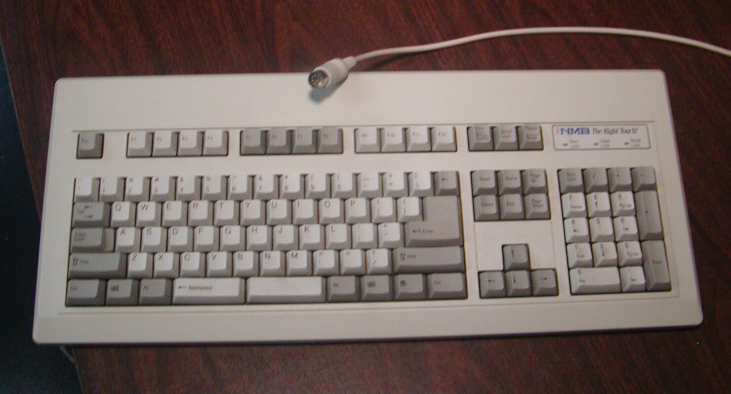

I only just found this site so I'm a newbee. I have 2 wonderful NMB keyboards, AT style, that I would like to convert to USB using this method with the teensy. I'm hoping I can get some further instructions, perhaps with images so I know I'm doing this correctly. If that is already on this site please direct me to it. I've attached some images so you can see what I'm working with. The keyboard is NMB RT8255CWE+R with the clicky "Space Invaders" switches. The keyboard is VERY close to standard except for the split spacebar as you can see. Any help would be appreciated. Thanks, Jim

I will sell you a replacement switch for $1 + postage in the US if it is a switch problem.
NMB Hi-Teks are notoriously fussy and hard to work with. Pulling a key cap without also getting the under-skirt is not easy, and putting it back together without bending the tiny "fingers" of the leaf assembly is also a trick. Lastly, de-soldering is a problem because instead of "pins" there are 4 wires without any real strain relief.
