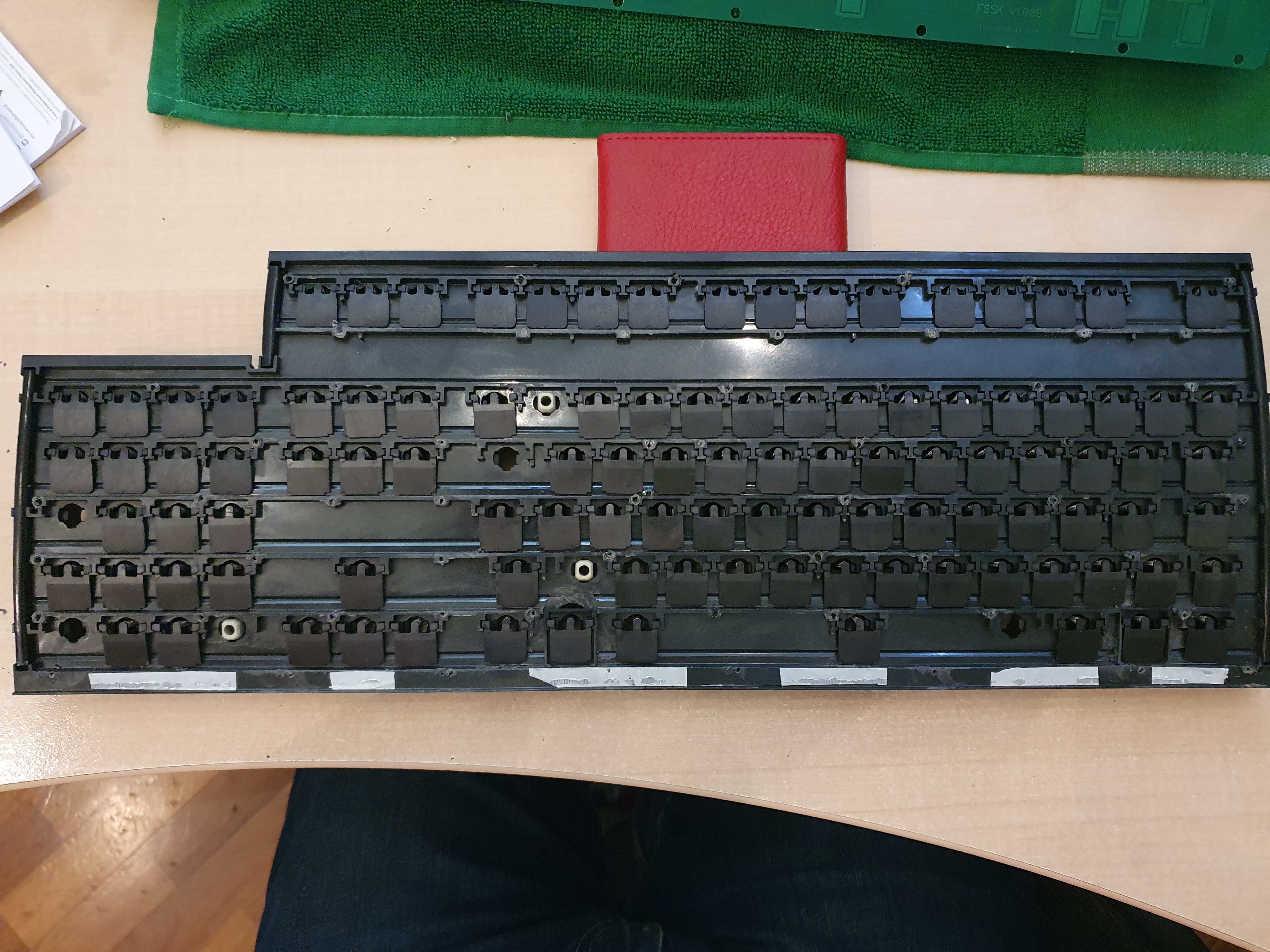

1. curved plates
2. top plastic plate
3. back metal plate
I've never seen one live, let alone handled it, so I don't know the feel of these plates, their thickness and so on, so I will let someone else chime in on this.
Now, I realize that FSSK only requires PCB and controller (and as I'm in the middle of getting stuff for the XTant, I sometimes get these two kind of mixed up in my head), but still, just as a thought experiment, would it be possible to convert non-F unsavers to F a-la XTant? Would anything else be needed except top plate and PCB? Could a M122 top plate be adapted for use here?
True. They were not even built by IBM. However, and forgive me if I'm talking out of my a$$ here, but they seem to share the same broad build-style:wcass wrote: IIRC, the non-F unsavers are NOT Model M unsavers.
Trying to convert it to an F would be like trying to convert a Logitech to an F.
https://geekhack.org/index.php?topic=7377.0
1. curved plates
3. back metal plate

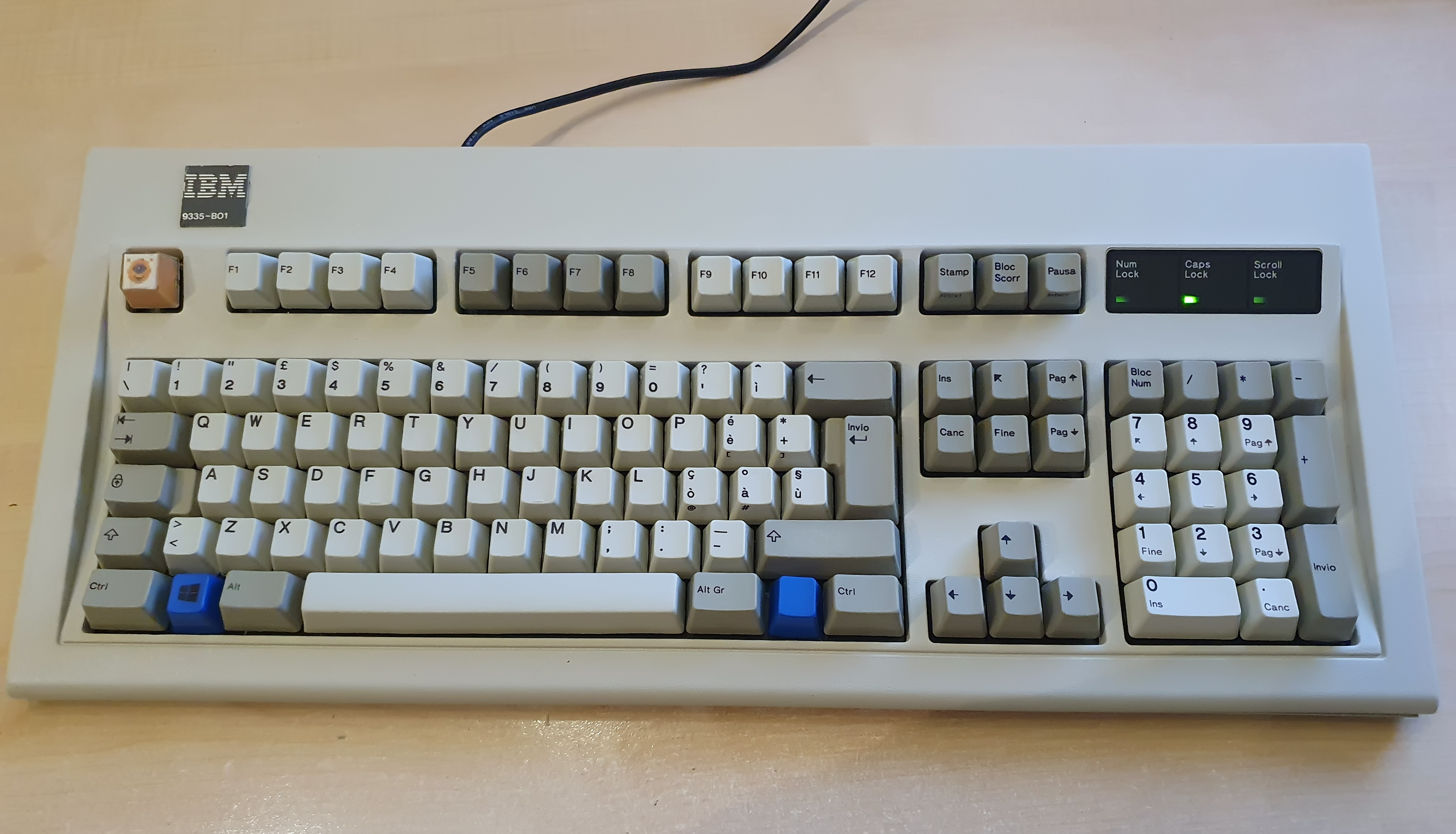

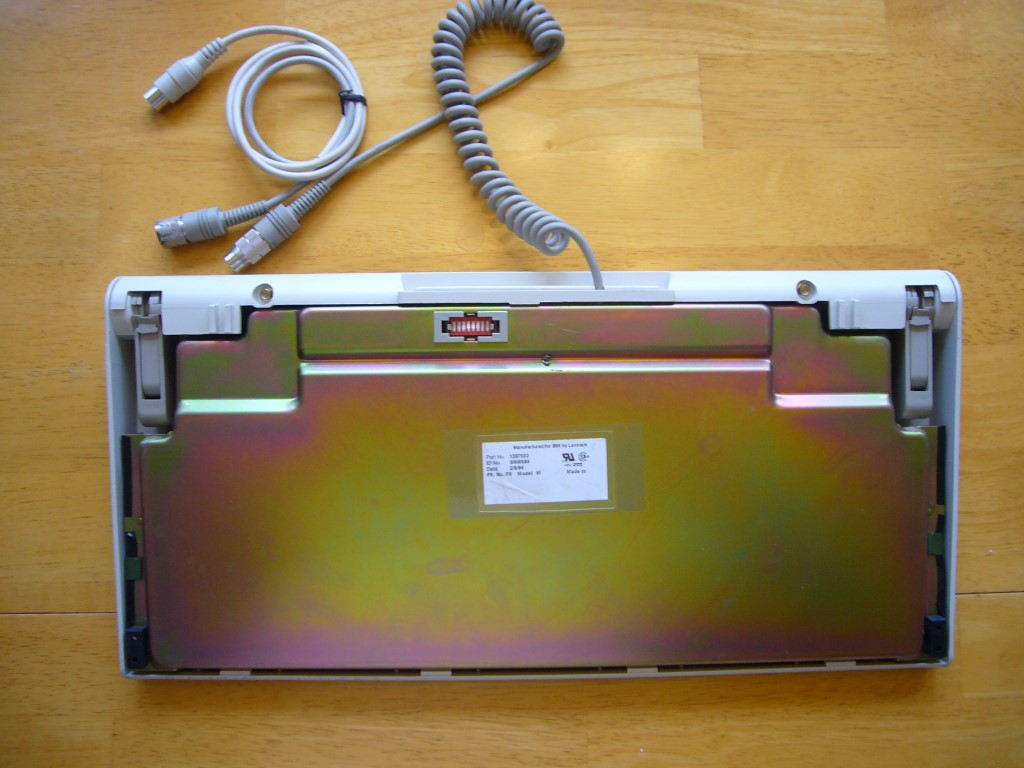

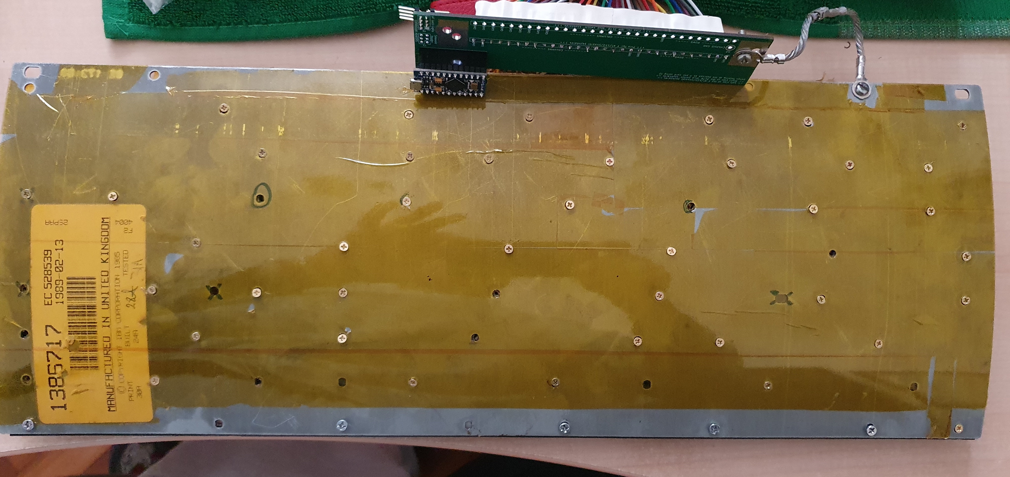

- fohat
- Elder Messenger
- DT Pro Member: 0158

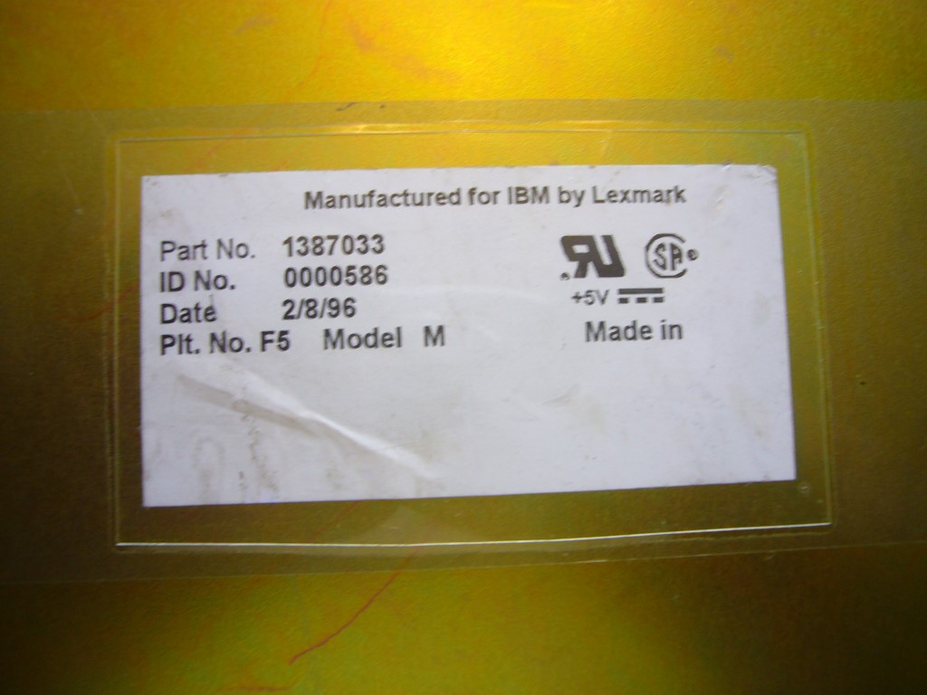

I have a Model F "Unsaver" but the sticker on the back says "Model M" and it is dated 1996.
My guess is that it was serviced or refurbished at that time, stickered with a "for-IBM-by-Lexmark" sticker, and resold or sent back to its regular owner.
- F-unsaver-2016-label (Medium).JPG (119.64 KiB) Viewed 29770 times
- F-unsaver-2016-rear (Medium).JPG (143.22 KiB) Viewed 29770 times

These 3 would help:
Thickness of the plate assembly (bottom plate - top plate inclusive)
height of switch + cap (bottom plate - top of cap inclusive)
front "lip" of switch (distance from front edge of spacebar cap to front edge of top plate)

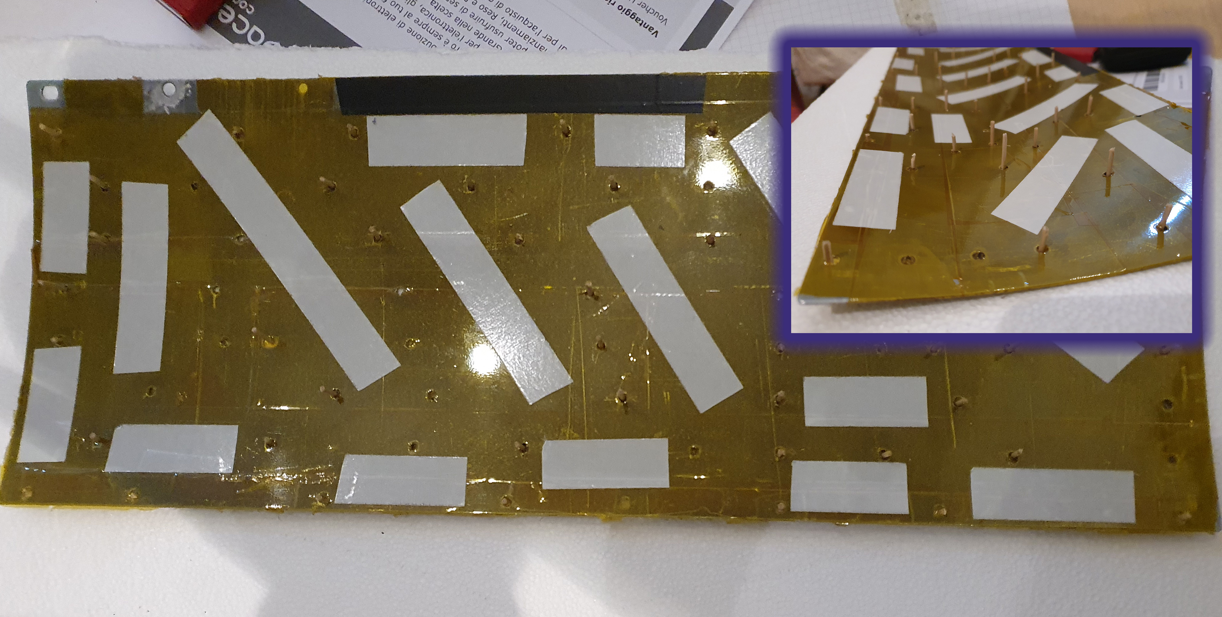

I have decided to open the FSSK v1.00 users manual: FSSK v1.00 - Installation & Users Manual
- Hypersphere
- Location: USA
- Main keyboard: Silenced & Lubed HHKB (Black)
- Main mouse: Logitech G403
- Favorite switch: Topre 45/55g Silenced; Various Alps; IBM Model F
- DT Pro Member: 0038
Thanks for posting the FSSK v 1.00 User's Manual! This is greatly appreciated! Nice work.
For now, a couple of things occurred to me:

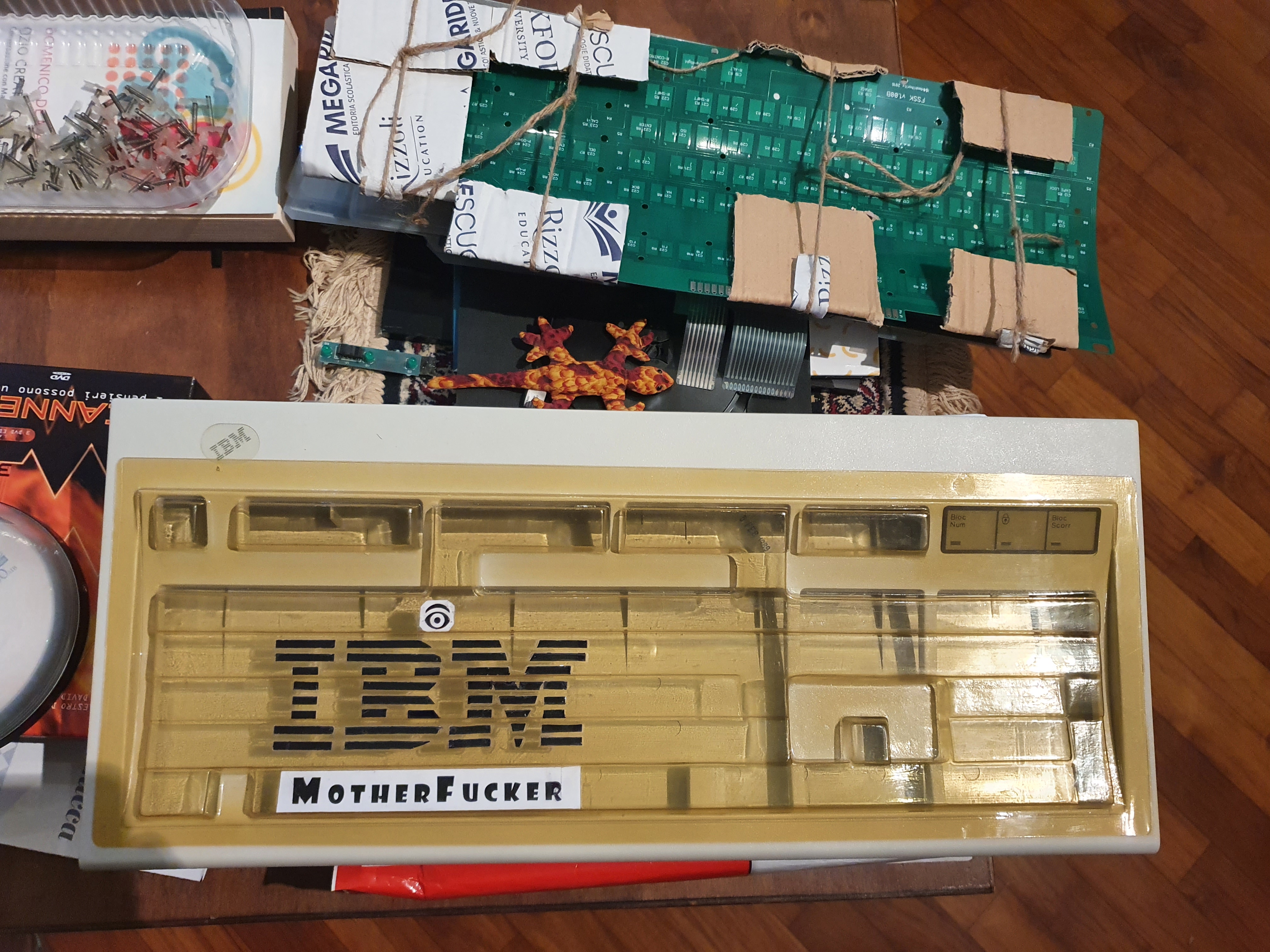

1. It seems like there ought to be a way to get a rubber mat to work in the FSSK, but I have not tried this yet.
2. Is it necessary to heat-bend the PCB, or could it be installed onto the curved plate without pre-bending?

My experience is that with the rubber mat between the flippers and the PCB one will get problems in registering the keys.
This is due to the uneven distribution of pressure across the board
I have not tried to mount an FSSK without bending the PCB.
The force that the PCB would do, would be to high for the plastic barrel plate. I would not recommend to test the FSSK if the PCB is not curved first.

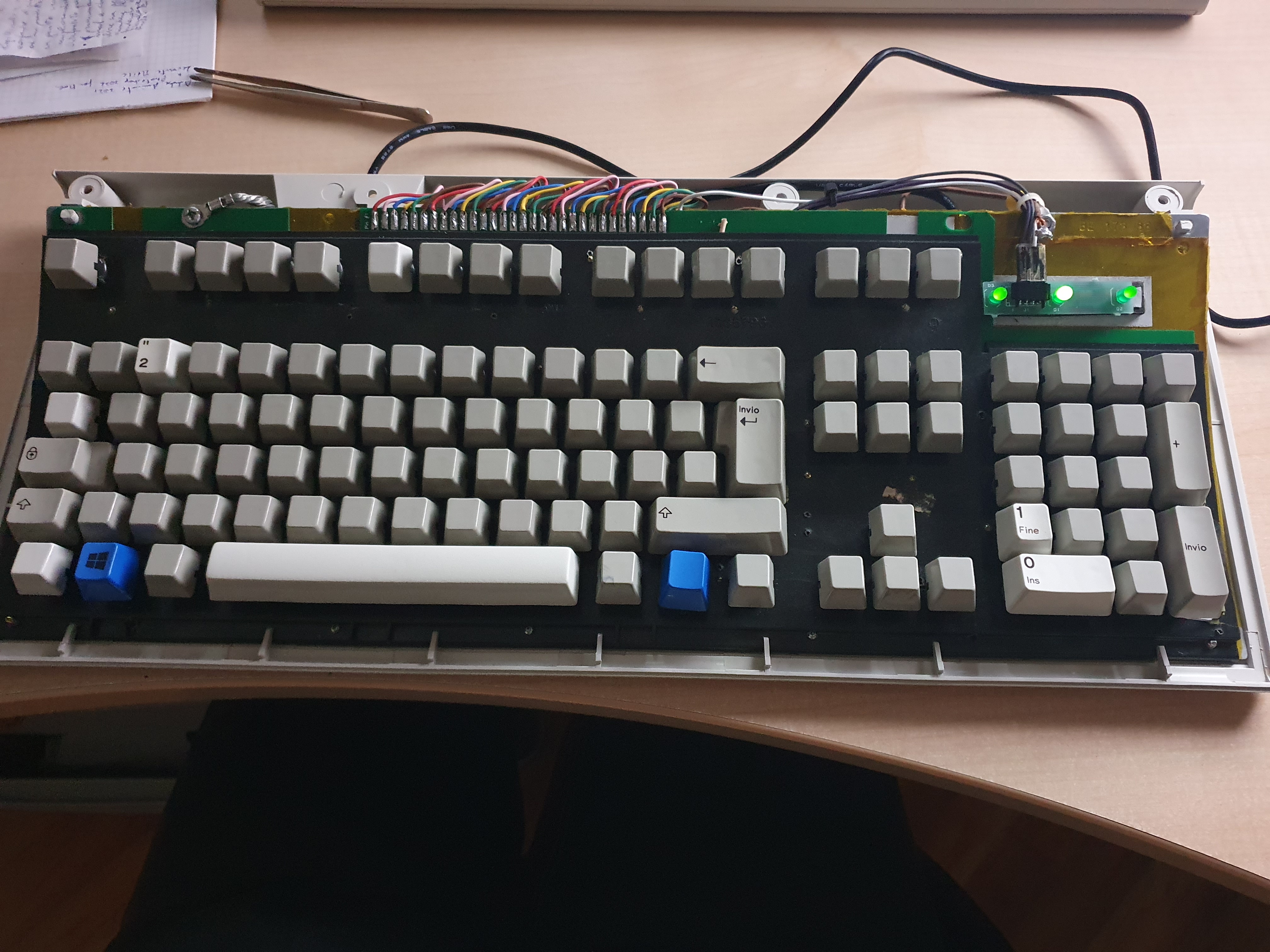

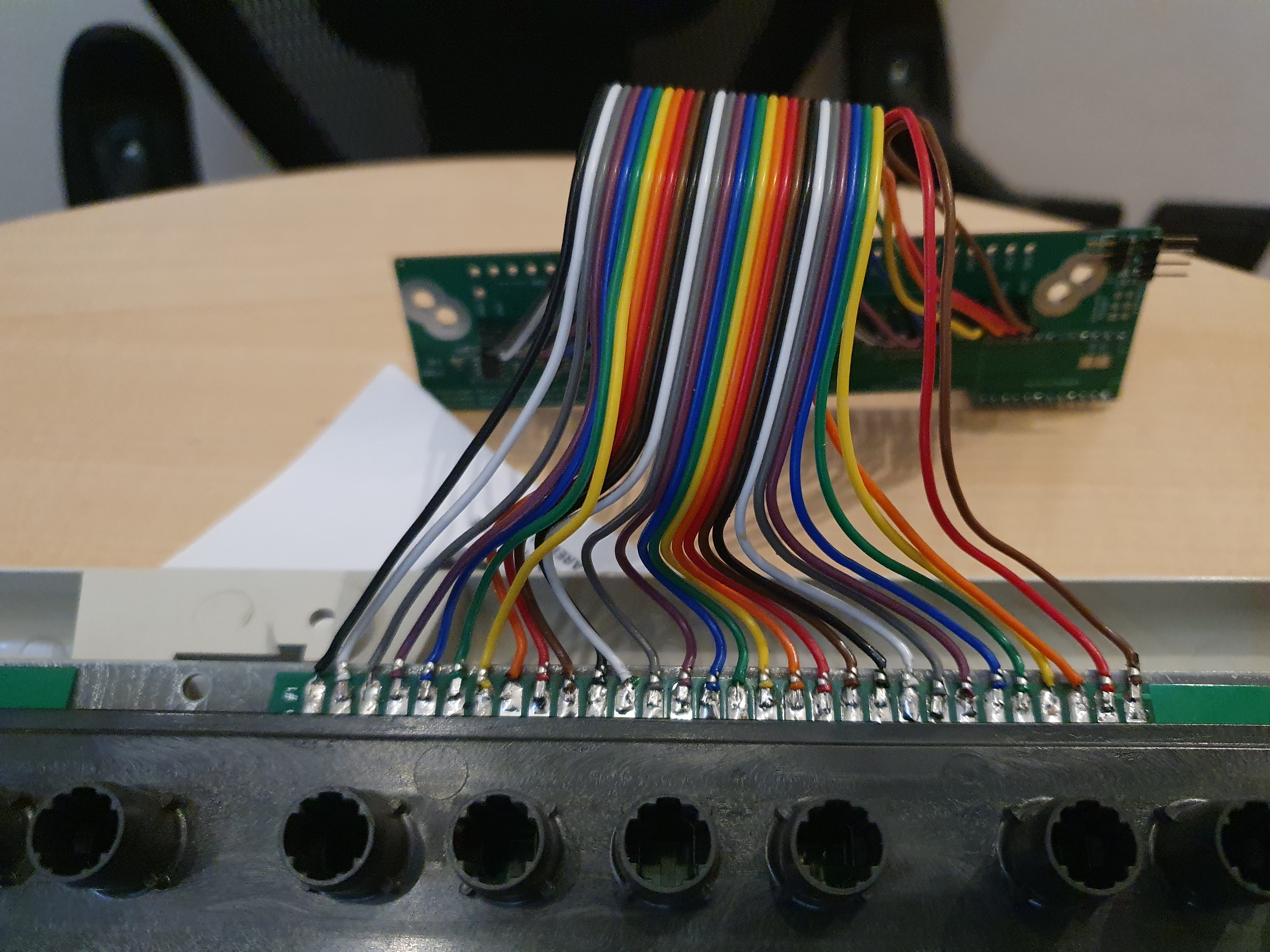

I have a working FEXT prototype without any problem !!!
As it should be, I am typing this post with the first of the FEXT, based on the PCB v1.00b with the XMIT keys (which I have not tested as I do not feel like breaking the case that I have)
I will post this in various threads where the PCB is discussed.

Thank you Halvar, It is very kind of you. This PCB was redesign to accommodate what I call the XMIT Keys. These are between the ALT and the Control Keys. To use them, one has to cut the case and somehow insert a barrel in the middle.
I think I will not do it. My boards are too good to break them
I am typing with it. Still adjusting the threshold. The autocalibration reports 132. I am using 130 without problems.

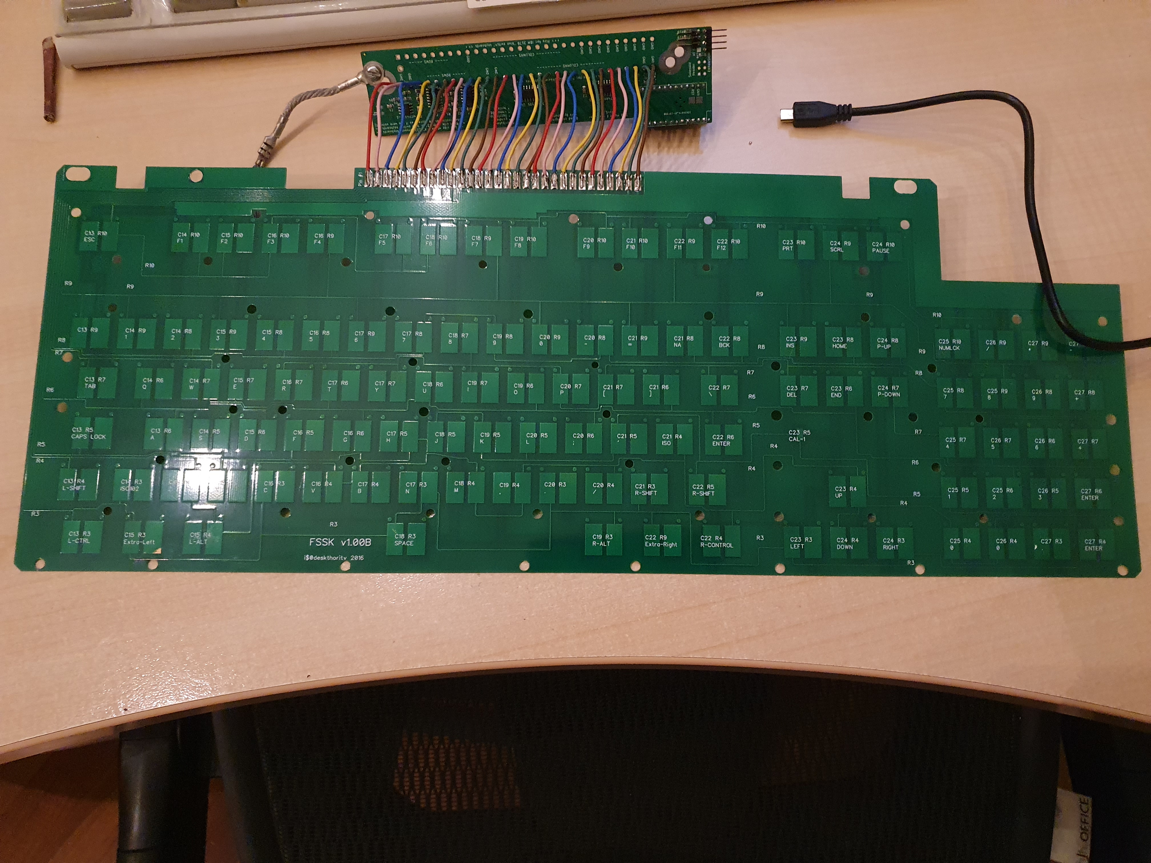

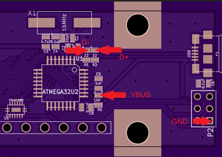

Hello guys,
Long time since I have not come around. I am really busy with little time to hobbies
Today I reordered my desktop resulting in a broken FSSK ! The USB cable was two short so I opened it to replace it with the longer version that I needed. The connector in the xwhatsit controller got lose and … BROKE ! This is the FSSK prototype. Yes, the very first keyboard which demonstrated that we could use F flippers in an M model.
I tried to re-solder it without success. In my desperation, I decided to cut the USB cable, search for the cables and solder them directly in the components. I am posting this in case that you suffer from the same problem one day.
Here is how the cables should be soldered:
I hope that no-one suffers from the same, but if it is the case, you may try my solution
Cheers
i$
Cheers
i$

i$ please double-check polarity.
According to https://oshpark.com/shared_projects/eTR858GJ the square pad (with "GND" arrow) is Vbus, and GND is the one directly opposite (top left pin of P2). That USB socket is super-easy to tear off the PCB.

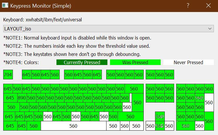

Hello. Finished with my FEXT recently, and I have a peculiar problem with an xwhatsit that I bought from Ellipse. I connected LED panel to the controller and the problem is that when I activate a lock the actual lock light switches off, and when I deactivate the lock the light turns on. I did not test it with the original firmware (v0.9.0), but with v0.9.1 and v0.9.2 the behaviour is the same.
Did someone faced something similar? I guess if it was a physical connection problem it would not be working at all, but it works only in strange manner, so it should be problem with the firmware. On the other hand there is not a word about such a problem on the Internet, and I do not believe no one uses locklights. Ellipse himself says LEDs should work flawlessly, because it historically did. So, I think the problem is in the firmware, but reality just counters my guess.
Please tell me how did it work for you?

Assuming that “Let's create the FSSK/FEXT = DONE !!!!” should never be considered a necro but rather an evergreen common thread, I’d like to share here my pic log presenting my personal FEXT implementation according to i$'s original post to whom I give credit and gratitude, along with all the other thread contributors. I don't know exactly why I embarked on this laborious journey that began about a year ago. Irony of fate, I started just a while after I got rid of a couple of extra Model Ms on eBay I had previously bought just because of their affordable price. Even though I’d already given a glimpse to the original i$’s post Let's create the FSSK/FEXT = DONE !!!!, At first, I didn't take it as really feasible. It must have been the awareness gained over years of accumulation and use of IBM models that finally pushed me to consider the thing in a real way. Among all the reasons that led me to assemble a model M/F I’d put in the foreground the need to ideally try to perk up a product like the Model M that is commonly perceived by click-clack lovers as nearly perfect. A feeling that is truly realized only after trying Model Fs following being a fan of Model Ms. Btw, most likely I started this adventure for having some talking during the long pool playtime with the DT user Man from Mars (thanks mate), or I'd rather tell the truth: I liked the idea of playing to be Ellipse in the middle of the QA process on his model F repros.Yet another model FEXT implementation,
(aka IBM model MotherFucker*)
Ok! now that I've made peace with myself, I can start my pic log, highlighting those moments of the process that I consider by my humble point of view particularly crucial or worthy of a little more attention, just in case some other madman wants to follow me on a similar journey.
Disclaimer: the following pics were taken with my smartphone. So apologise me in advance for the poor quality, bad light exposure, etc.
Furthermore, be aware that I just documented my FEXT implementation, focusing on issues that I encountered on my way and how I troubleshot them, without any further claim.

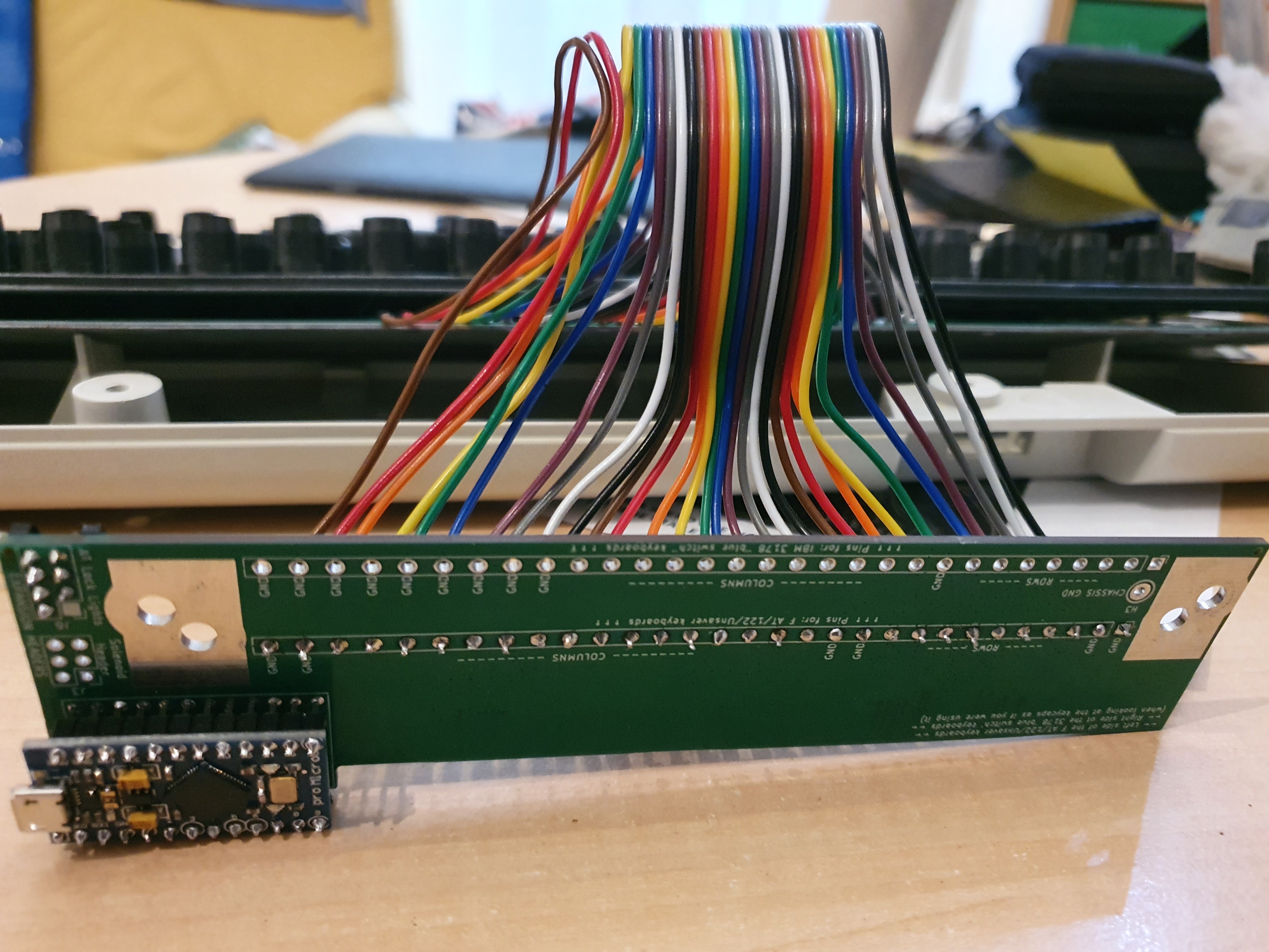

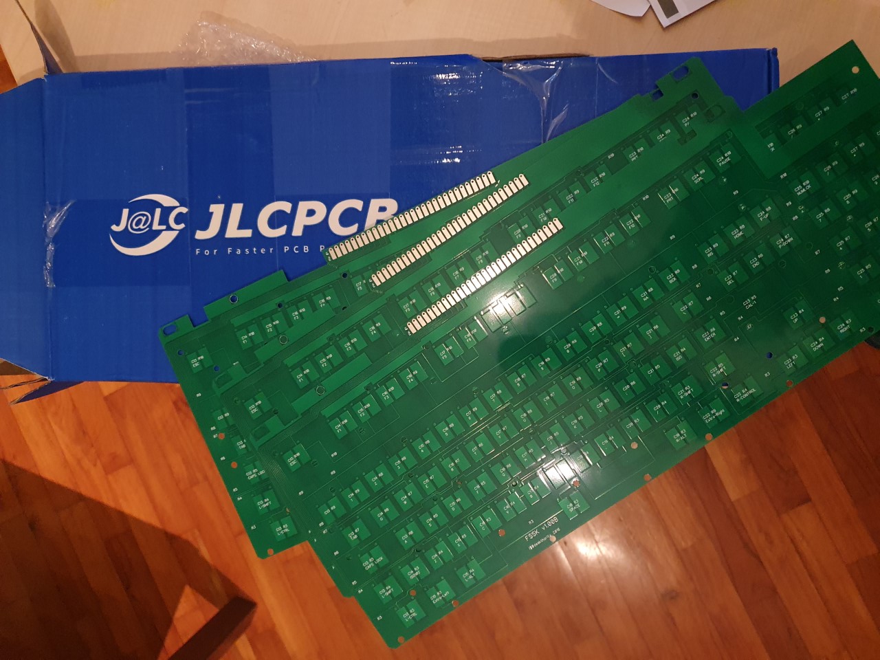

The FEXT 1.0B PCBs
PCBs (0.6mm thick) arrived very quickly from JLCPCB’s China factory, even though with a manufacturing defect. Keep reading for more details about it.

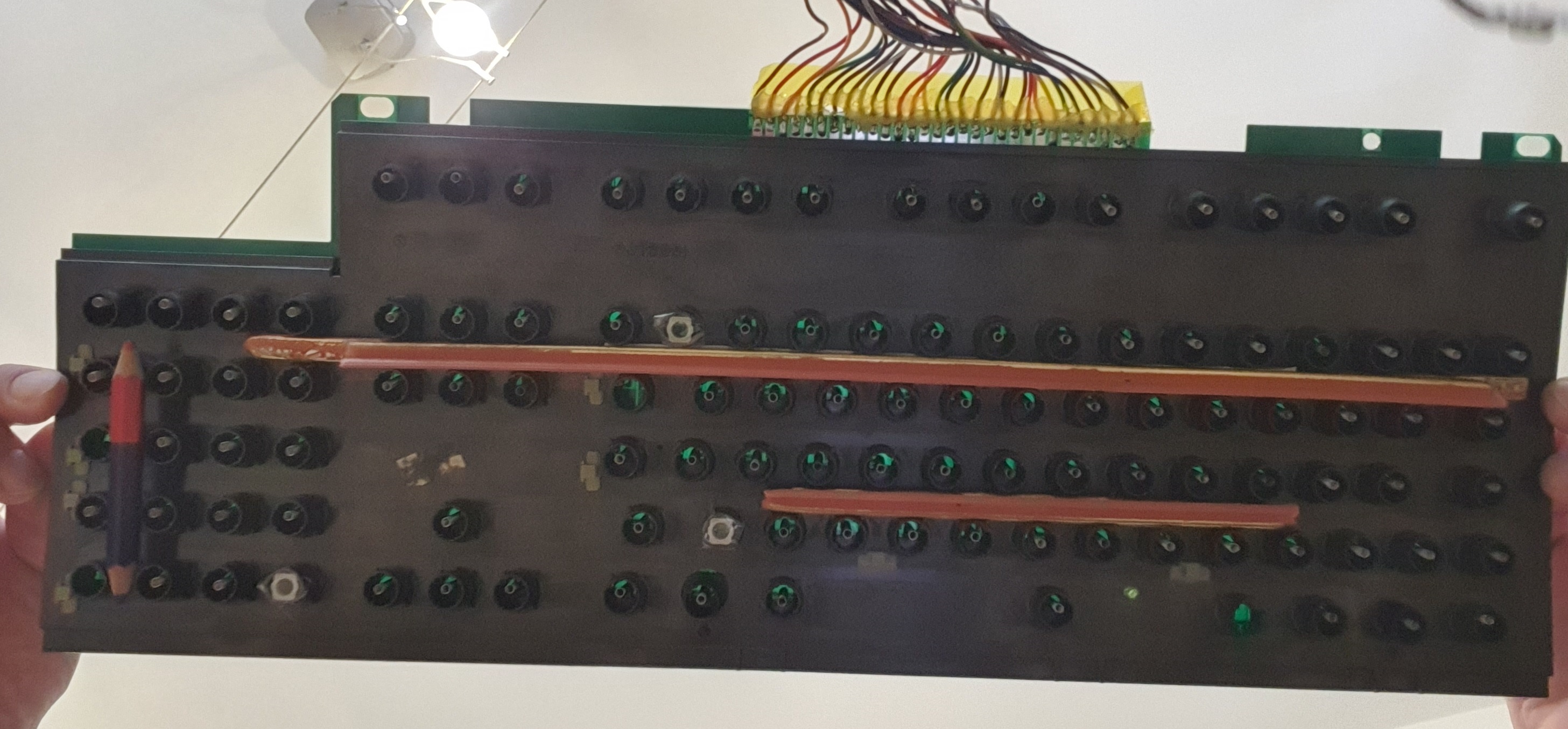

Even if you too have a Greek column at home, you don’t really need to do this for bending the PCB. Being it thick only 0.6 mm, the screw mod will be sufficient to bend it properly without any problem.

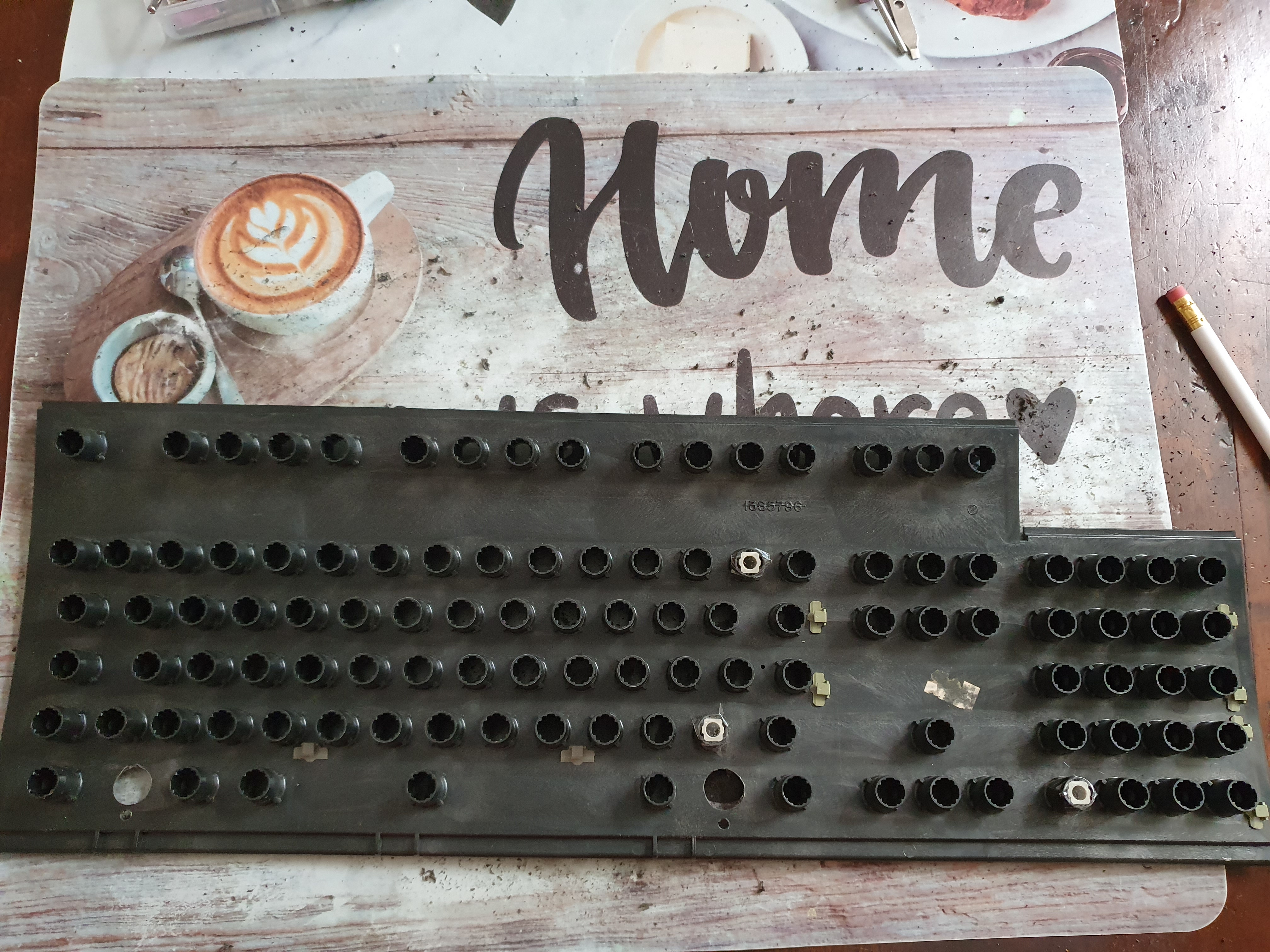

Meanwhile, I had some fun by customising an old and quite yellow dust cover

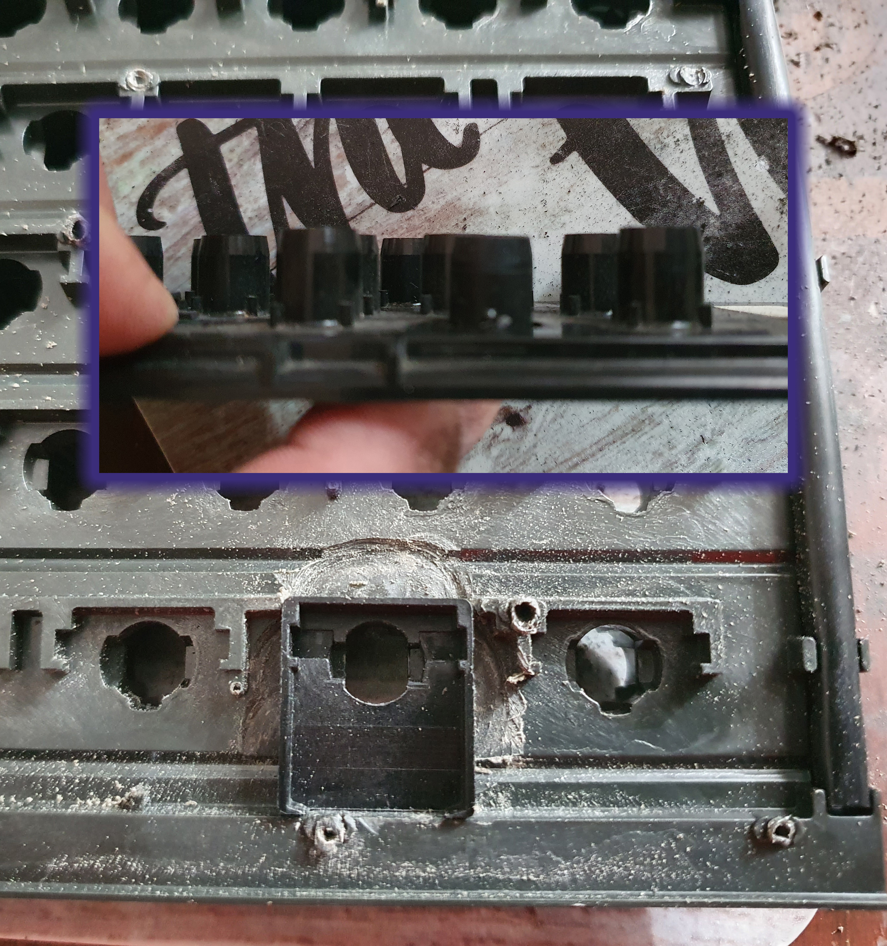

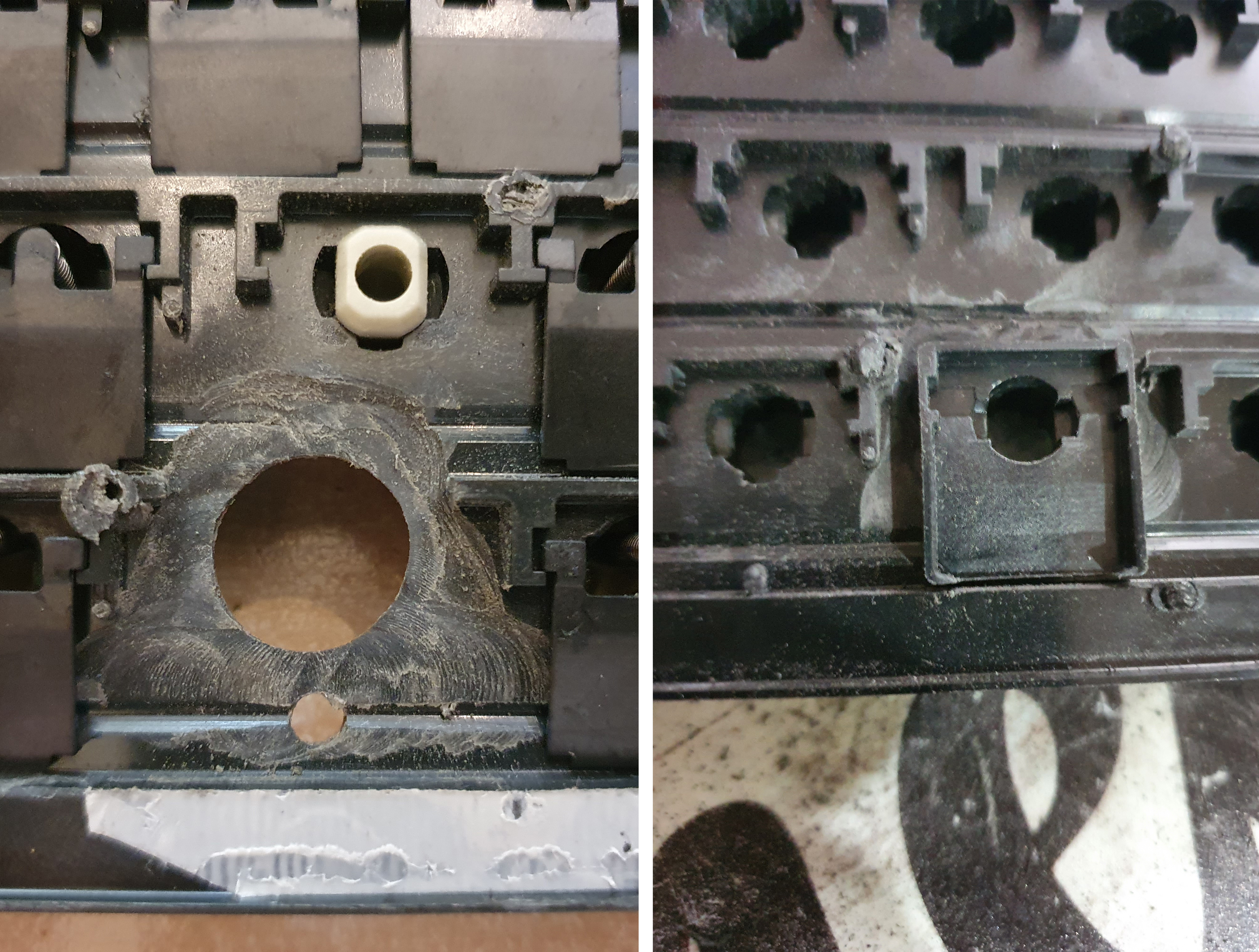

drilling into the Model M's barrel frame to house the Win key and the Fn key on the right

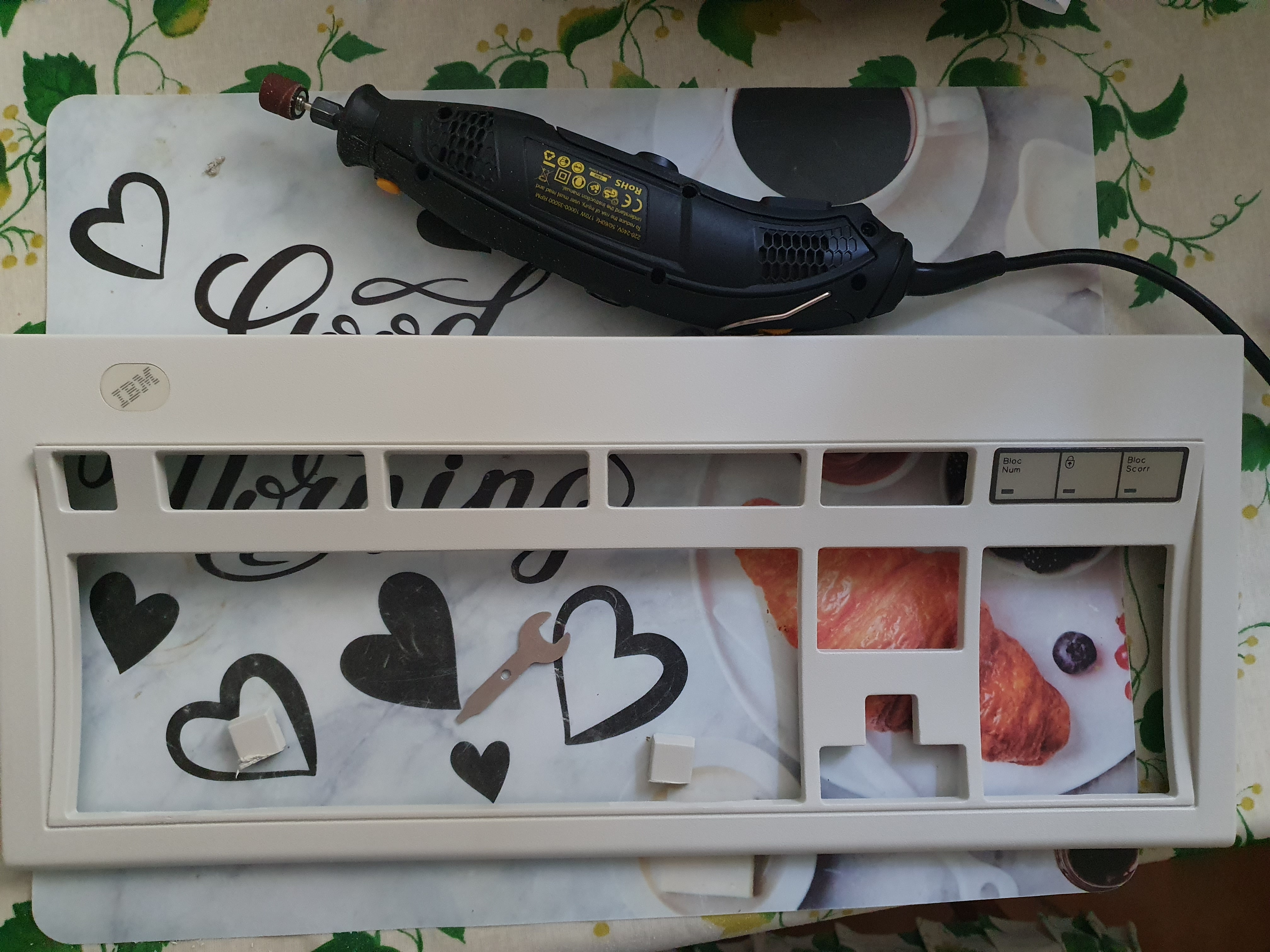

with Dremel I slightly lowered the thickness of the barrel frame in order to better align the two model F barrels to the others
beware of debris while using the Dremel. they are your enemies

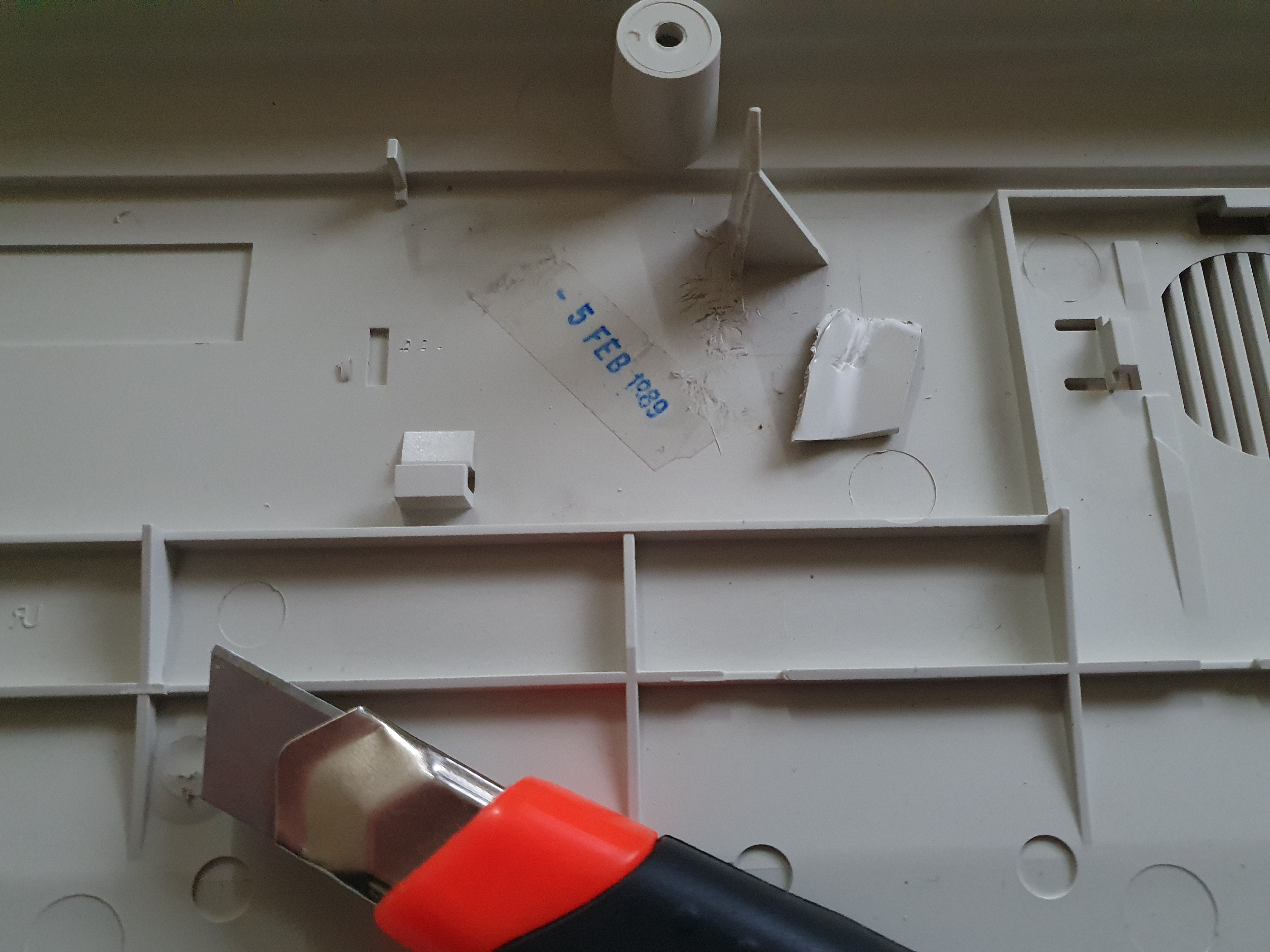

cutting off the extra pieces from the front part of the Model M case
soldering has always been my gripe. I’m not good at all. So I hired someone to do the job for me, but……something went wrong.

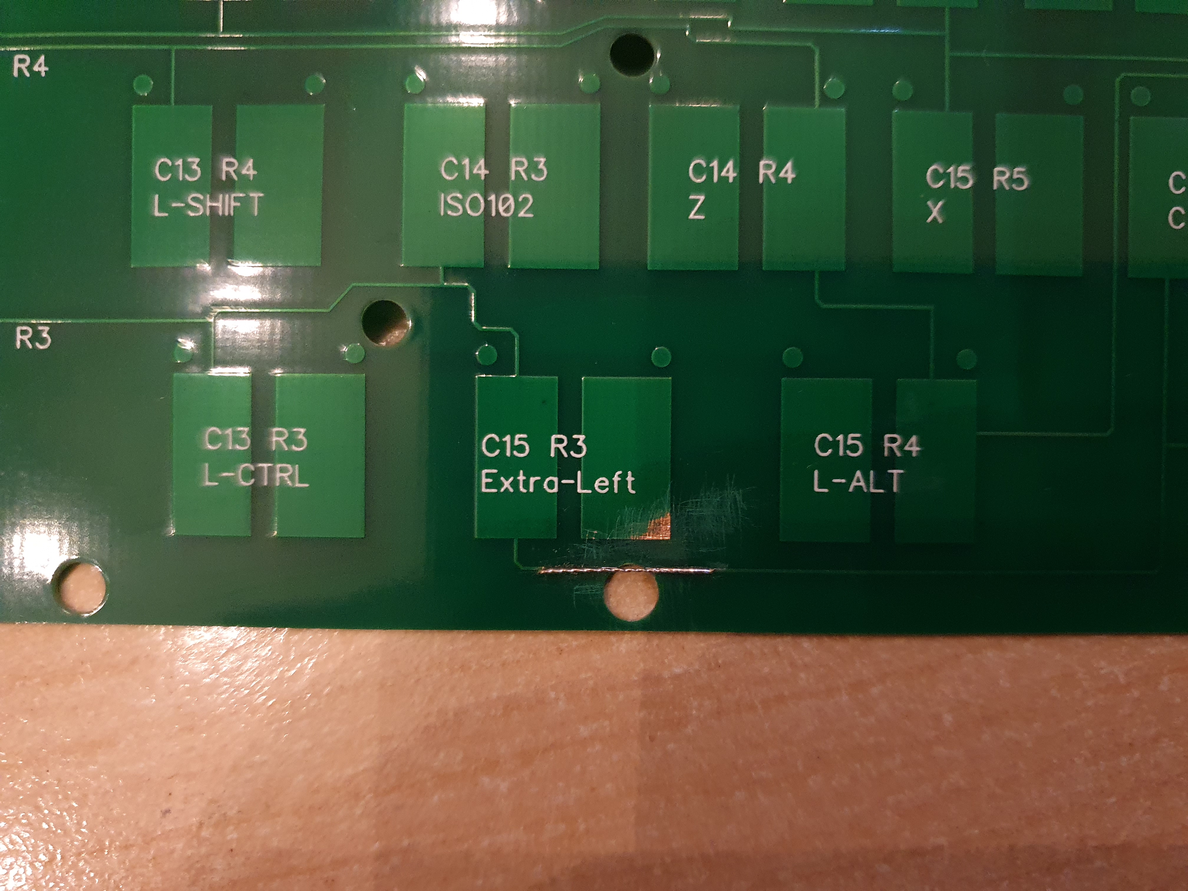

A new fresh start seems to get things better, but the issues were not over…..

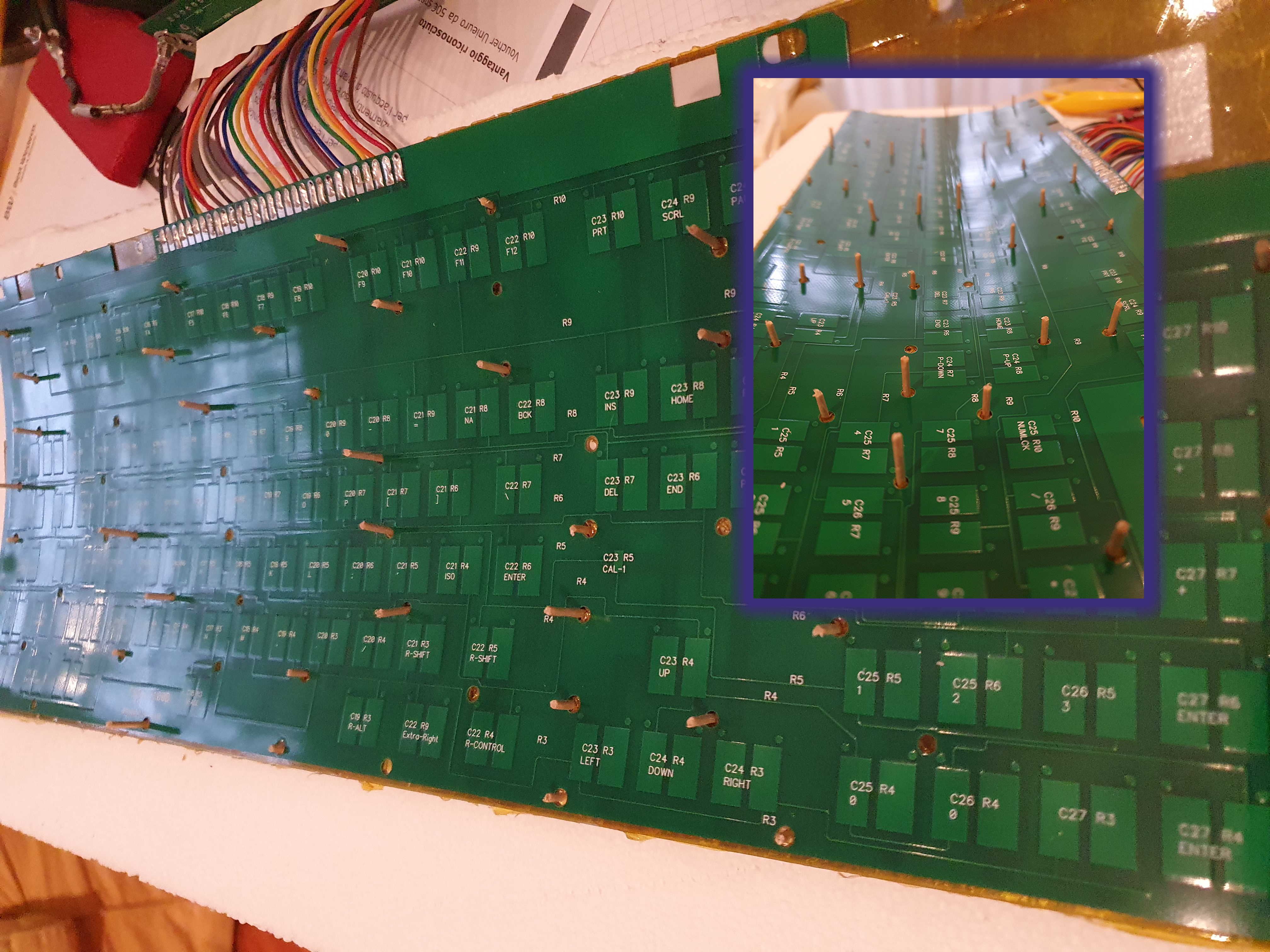

Since the first capacitance test sessions, the PCB had shown a huge electrical signal problem on all the pads belonging to the first row. At first I didn't want to believe my eyes. Thinking about a problem involving aspects related to capacitance, I asked the DT Arkku user for help, and he was very friendly and kind in providing his support, offering me several pre-complied firmwares, derived from
Due to some manufacturing defects, partly due to a borderline project design too, a hole interrupted the first row circuit path of the PCB. In the pic, my saint welder made the trick and the miracle of resuming the circuit integrity.
Having overcome the electrical issues, I dedicated myself to the conception of this system for the assembly of the mechanical parts. A few toothpicks guided the insertion of the perforated pcb onto the metal back plate so that a screw mod can be carried out more easily. Some bi-adhesive strips relieved the initial tension of the screws as they are fastened in.
Springs coming from an old Model XT mixed with some from Ellipse

Fastening and unfastening all layers together or tuning a musical instrument
Making extra room to house the controller into the bottom case. Look at my birth date....
Keep testing and other extra final steps.
all's well that ends well
I had to devise this system, instead of the classic pair of books placed on the sides of the metal plate, in order to get the right tension throughout the surface during the process of inserting the screws. The wood sticks (2/3 horizontal and 1 vertical, the big pencil) protruded just enough to prevent the springs from touching the desk, letting the hammers lose their correct position in the barrel frame.
Finally, the case closes. I had to cut the piece of plastic swown in the pic if I wanted the SMD controller with the attached microUSB cable to properly fit beneath the keyboard bed, avoiding to damage the Micro Pro the usb connector (oops).
Some final tests with Pandrew’s USB utils before closing the case. On the right side LED lights work even though in a weird way, due to some incompatibilities. It seems that the SMD controller supports natively only the IBM AT leds.
