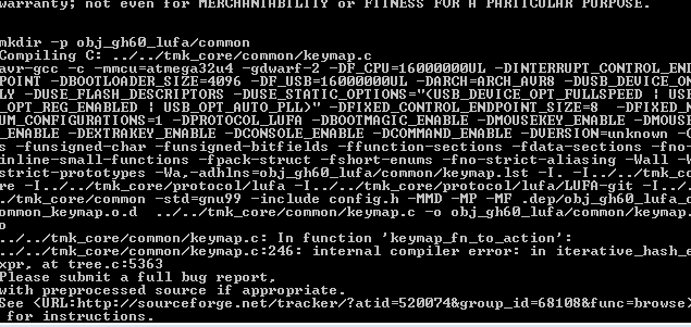

Hey guys, I don't normally post on this site but rather GH hence my low stats here. Recently I've been busy with college so haven't had time to fix my keyboard.
Anyways, this keyboard worked when i made it a long time ago. the only problem was a few keys didn't register. now i have time, i decided to check my code and found problems. after cleaning the code up and trying 'make -f makefile' i get the error:
"Makefile:135: ../../tmk_core/rules.mk: No such file or directory
make: *** No rule to make target '../../tmk_core/rules.mk'. Stop."
this looks like a simple case of going into the makefile and changing the dir but i have checked it and changed it many times and it still gives the same message. I'm 100% sure this is a stupid mistake and somebody will maybe give me a hint as to why.
Also, i don't find it necessary to include my code because it is a directory problem. i will if i need to. if somebody has already had this problem solved, i appologize for wasting time.

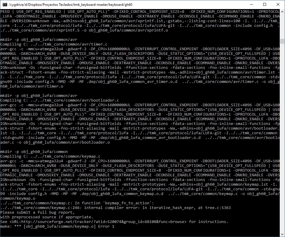

Hi people!, I came here asking for some help, because I'm totally lost with my personalized keyboard based on teensy 2.0.
First of all, I do not speak English, and I'm translating all this into Uncle google
The question is that this is my second keyboard based on Teensy 2.0, and the functional part of keyboard works correctly, but the question is that this second keyboard sends it backlight and I'm very lost with it.

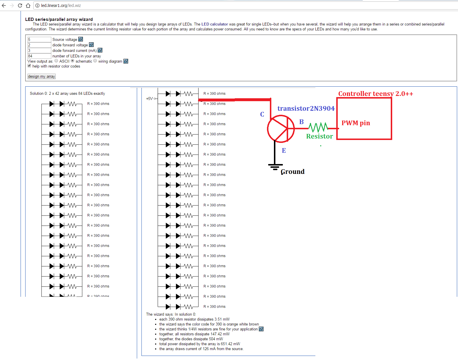

My idea is to have 2 independent leds, backlight and leds case, and I would use pins B6 and B7
I have these parts of code backlight.c that gave me the user breh:
I want to do something like breh does on your numeric keypad, have specific keys (the ones above the arrows) for the regular backlight, power on / off / more brightness / less brightness, and in another layer to control the LEDs of the case.

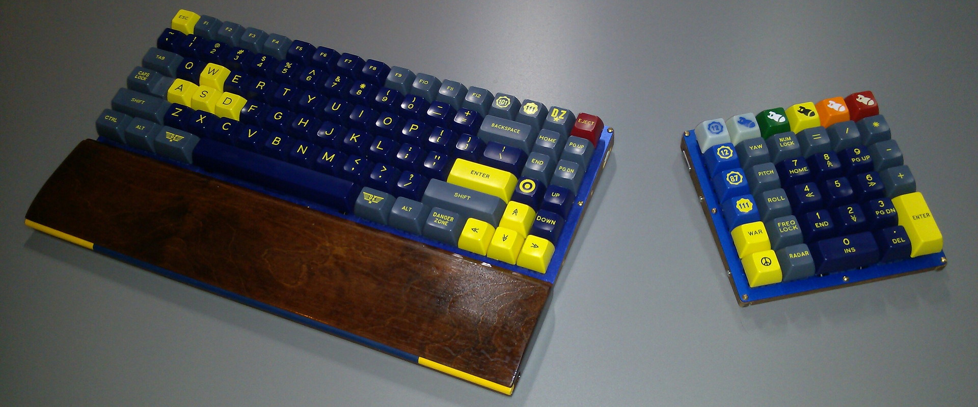

My question is, are the values entered into the table above dependent on position in the list, or just by content. It'd be FAR easier to follow the second layout, but I don't know if it screws with the code to mix and match rows and columns like that, or whether it's all good, as long as the numbers match.
Basically, is the code expecting all the rows and columns to be in a neat and orderly incrementing layout (all the columns, in order, 0 to the maximum, for row one, then repeating for row two, and so on), or is this list arbitrarily defining the intersection values based on the numbers entered (arbitrarily defining what key labels are to be used for each matrix intersection, without regard to were in the list they sit, so long as row and column numbers match up)?
On the bright side, I got my number pad plate manufactured, so I have that! Unfortunately, it still does nothing...
That only means i now have to consider the numberpad as well as the regular keyboard, making my firmware needs even more complex now than when I was just asking about getting the main keyboard up and running... At this point, I think I need a dedicated thread to figuring out how to make a firmware for this. Now, it not only needs to do the regular polling of the main keyboard, but it also now needs to monitor the state of a logic input to determine if the external number pad is present, and ONLY if it is, then poll a port expander over I2C (and to ignore the I2C ports if the logic signal tells the numberpad is detached.
For someone with no C experience, I really feel like I'm in way over my head with this... Hardware is what I know...

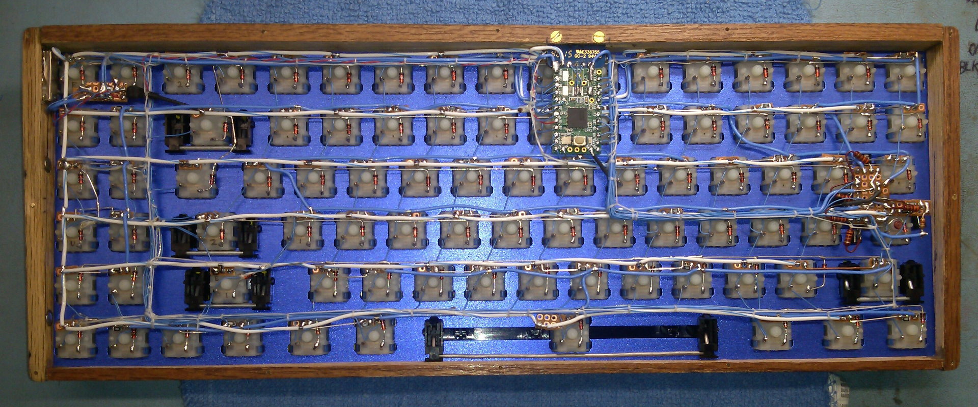

I'm running a Teensy 2.0 in this thing. It's very hand wired... and laced into the keyboard.
I'm potentially open to anything, I suppose, though I'm running a Hackintosh with a rarely used Windows 10 volume as a bootable option. If I ever get another SSD, I thought I'd maybe put Ubuntu on like I had on my old PC and my PS3. My biggest problem, is my C coding skills ultimately amount to looking at existing commented code examples, and modifying them (through many mistaken iterations) to my needs... I don't actually have a grasp of much of any of the fundamentals yet. Worse, what little I did learn, pretty much faded away in the literal year that's passed since I last tried to do this.
Since I still have to hand wire my number pad yet, I figure, if I can just get the basics working for the main keyboard, I'd probably be alright. It was literally just one question that had me hung up on TMK (at least as far as I'd gotten). I would imagine finishing what I started would be the quickest path to a functioning main keyboard, and I can look at other firmware options when it comes time to integrate the numberpad functionality.

What kind of switches do you use?richfiles wrote:I'm running a Teensy 2.0 in this thing. It's very hand wired... and laced into the keyboard.
I'm puzzled, there seem to be way more wires than needed, do you have the schematics for this?
Yeah if you are near to make it work on TMK, maybe the best course of action is to continue on this path.richfiles wrote:Since I still have to hand wire my number pad yet, I figure, if I can just get the basics working for the main keyboard, I'd probably be alright. It was literally just one question that had me hung up on TMK (at least as far as I'd gotten). I would imagine finishing what I started would be the quickest path to a functioning main keyboard, and I can look at other firmware options when it comes time to integrate the numberpad functionality.
- richfiles
- Location: MN, USA
- Main keyboard: Logitech DiNovo Edge
- Main mouse: Microsoft Optical Notebook Mouse
- Favorite switch: Alps SKCM Amber "Taxi Yellow"
I use Gateron Blue, but some have green springs. The top housings have all been dyed blue, to match the anodized aluminum plate.
The reason there are more wires is I have LEDs in every switch. All LEDs are amber, controlled from a PWM pin of the Teensy 2.0. There are actually 4 banks of 22 LEDs, covering the 88 total keys. LEDs are wired in series pairs with a 100 Ohm resistor inline, and those 11 pairs are then wired in parallel and driven by a simple transistor driver. There are 4 transistor drivers, to spread out current load, so no individual driver transistor is more than approximately 50% its max current rating. Keeps the transistors unstressed. The LEDs are set to only generate a mild ambient light. They're not very bright, but that's cause I want them USB powered. I'll start the keyboard at low brightness, when powered on. With the number pad plugged in, I think I might lock out the highest brightness level.
The thicker wires are for power and LEDs. The thin blue wires are rows, columns, and data to the Magsafe port. The layout compresses 88 keys into a 13x7 matrix, to allow one LED PWM line, one Caps Lock line, two I2C wires, and a Sense wire that changes logic level when the numberpad is attached or detached.
I only mention TMK, cause I actually was through a lot of the work to make it work. I just was stumpped at the onequestion, and life happened right when I hit a wall, and it took me a year to come back to this.
I've got a crude row column schematic, and I have the row column connection guide posted. The LEDs were done in my head, so I've never drawn out a schematic for their configuration.

- Location: vietnam
- Main keyboard: Dell Quitekey RT7D5JTW
- Favorite switch: Gateron Blue
Rejerh wrote: For whoever is interested, after quite some difficulties and still wondering how everything works I managed to make my backlight work.
My set up is as follows:
1- All my 69 Leds with some resistors in series (be careful to take strong enough resistors so you don't try to get more than 500mA out of the USB port) are connected in parallel to the VCC and to one of the outside pins of a transistor (not the middle one).
2- The transistor has its middle pin connected to PD7 on a teensy 2.0 and its last pin connected to the GND.
The idea is to control the PWM on the PD7 to make the transistor open and close more or less to control the brightness of the Leds
I have designed schematic to control 84 led of my keyboard. As instruction of Rejerh, but it draw more than 500mA for those leds.
Rejerh, Matt3o or anyone please take a look at my attached pic and advise... thank in advance
