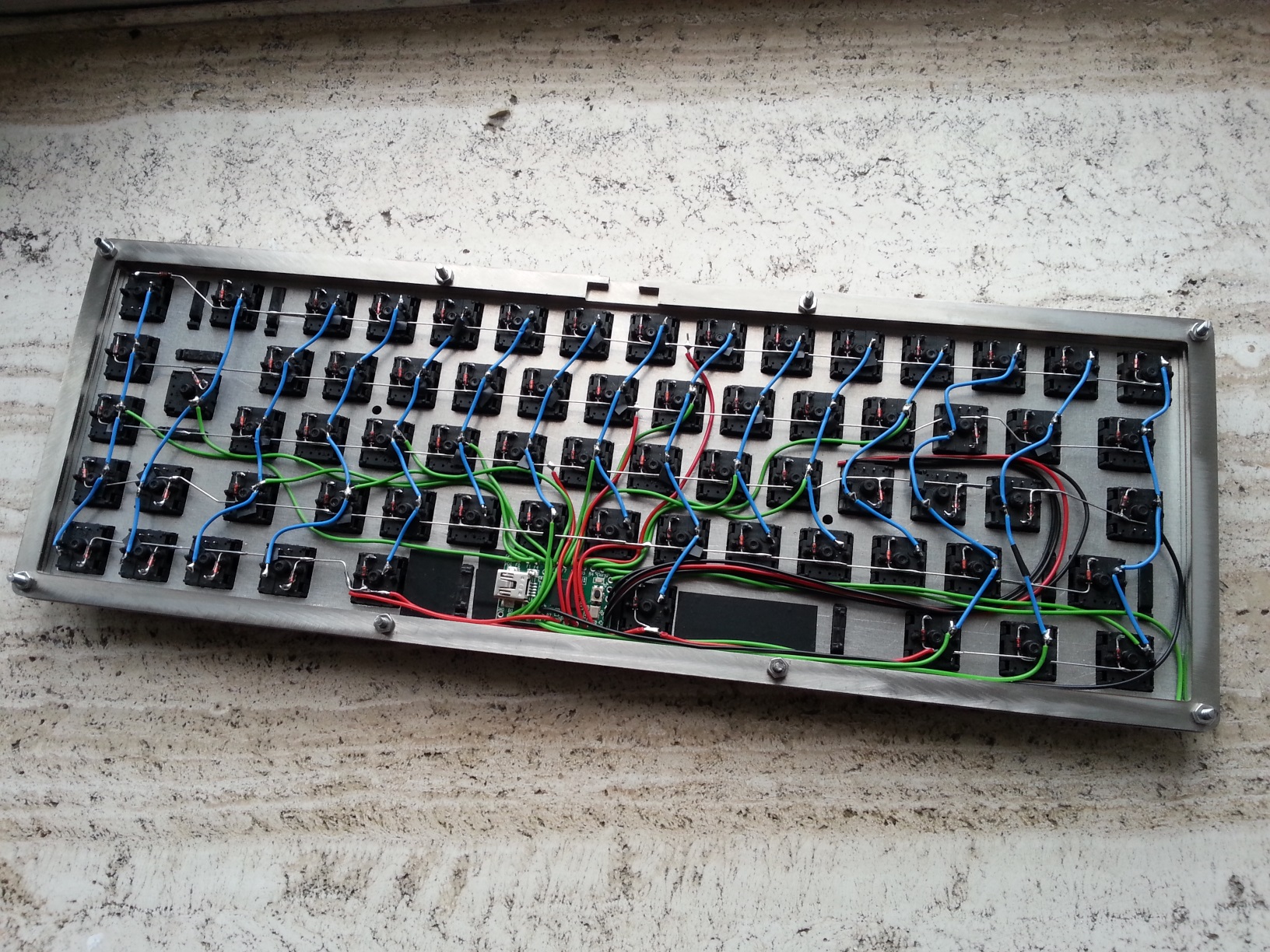

So yeah, I "finished" my board.
Well, actually it has been assembled for 2½ weeks now, and has served as my main keyboard since, but I still have to do something about the stabilizers (it might be I just hate Costar stabilizers), figure out what I should do to the bottom part of the case and add some LEDs (but that can wait).
Posted: 25 Jan 2014, 23:55
by matt3o
ah finally! don't worry about the stabs. Just file them a little where they hit with the stem!
and post your finished work!
Posted: 26 Jan 2014, 00:26
by Broadmonkey
It's mostly just the spacebar stab holes I have to file, the rest I have to figure out how to remove the annoying rattling sound you get from costar stabs. Maybe a dab of glue on the underside of the stabs will reduce it some.
Posted: 26 Jan 2014, 01:44
by mtl
Looks great, Broadmonkey!
I had to file a couple of stabilizer clips as well (space and right shift), because the sliders were rubbing and squeaking. The holes should probably be 0.5-1mm higher (at least for the design I had cut) for better alignment.
Posted: 26 Jan 2014, 11:54
by Muirium
Next round I'm going either Cherry mount (I have some PCB mount stabs already and Kbdfr might even be selling plate mount Cherry stabs soon) or entirely stab-free. I like small keys better anyway, but a purely sub 2.0 unit layout is harder to achieve while staying compatible with cap availability.
The main key I'm likely to want stabilised is of course the space bar. I've ordered 3.0, 4.0, 4.5 and 6.25 unit space bars in Round 5 (because I'm a total loony for the Honeywell colour scheme and SA profile) so I'll have a few tasty options available, once the caps show up. But for purity's sake I'm also exploring smaller keys.

Posted: 26 Jan 2014, 12:12
by matt3o
mtl wrote:Looks great, Broadmonkey!
I agree the holes need to be 0.5mm higher, in fact I already updated my designs. even though admittedly I strictly followed the costar specifications.
