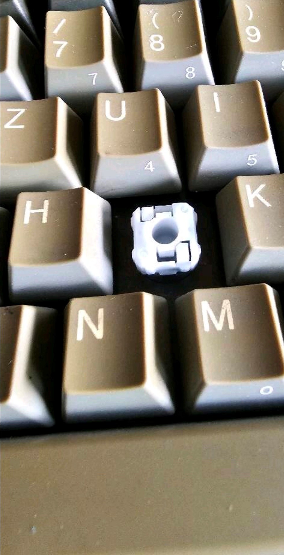

Please what switch is this, and is there a wiki I could read abou tit?
https://i.imgur.com/HNcMqye.jpg
Kinda looks like Fujitsu Peerless but the hole is nearly square, not narrow like the alps cap mount, not round like the other Peerless I've seen
album of the board: https://imgur.com/a/qCCJwC9
It's an Epson PCKB9 that came with a 486HA Epson-branded computer from around 1990

Looks like a typical Fujitsu rubber dome.

That's Fujitsu Dome with Slider.DavidCDN wrote: 21 Jul 2023, 23:15 Please what switch is this, and is there a wiki I could read abou tit?

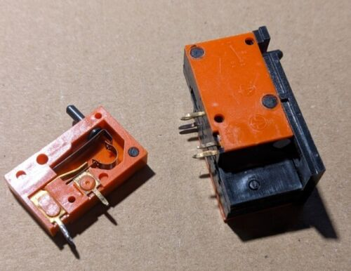

Could you guys identify these linear switches? Some early RAFI like this one? They are from a 1976 Videoton keyboard, part of the VT-340 display terminal. Manufacturing started in 1972 (Hungary). The switches are these big blocky ones, four long pins in a row on the PCB side. Unfortunately I can't get closer to them without desoldering:
More photos: https://imgur.com/a/zeLBbCl (some really nsfw)
- jsheradin
- Location: USA
Four pins per switch usually means contactless. Your board has TKI stickers on the inside which tracks with Rafi of some sort. They're definitely not RS74/76 and don't look like any of the RC72 examples that I've seen. Rafi magnetoresistive should only have 3 pins, 5 if they're an illuminated switch.
I say desolder one and hope there's some writing on the side. Whatever they are, they're not common.

I'll give it a try but first I'll have to manufacture some tools to even disassemble the core part which holds the switches together.

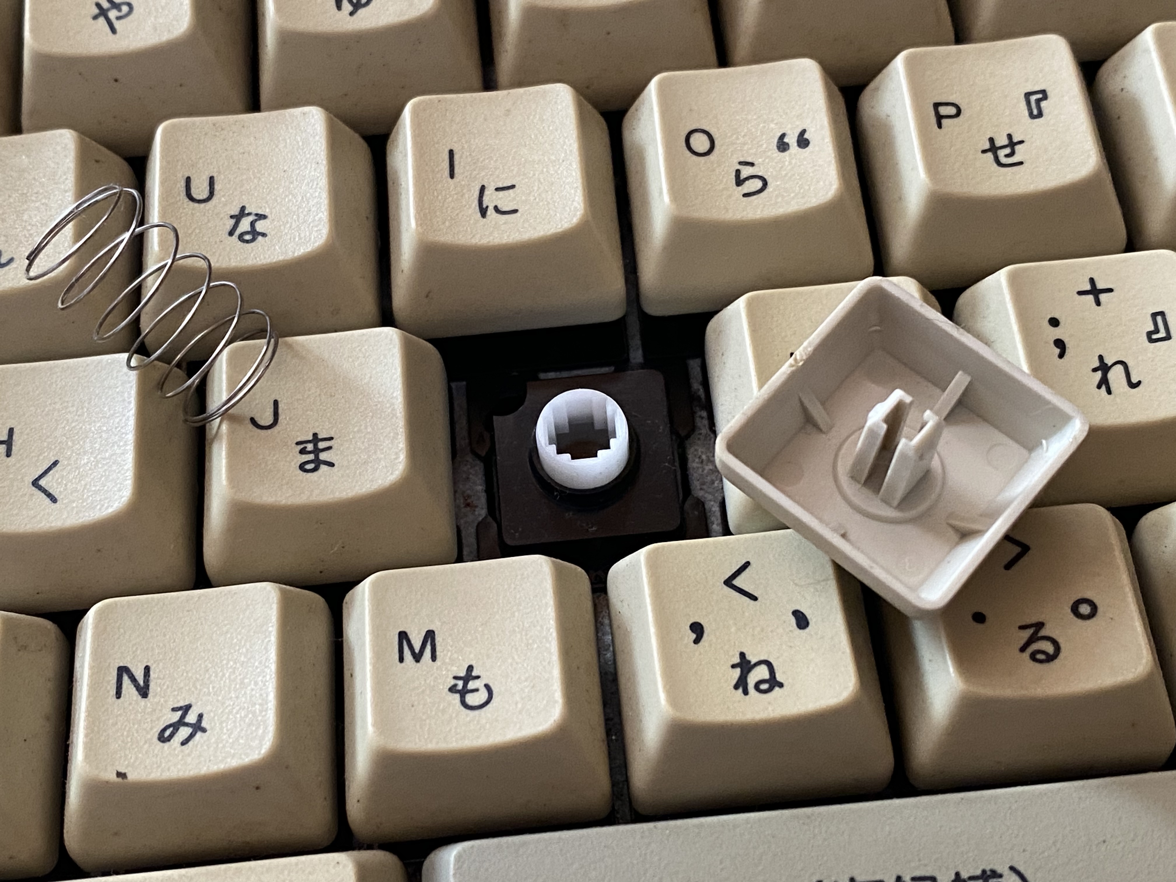

- Location: 中国
- Main keyboard: IBM XT
It was found on a Copam K-455 keyboard, but according to my search, K-455 should have dome and slider switches and not this kind of switch.
I have also looked into the Alps clone list but didn't find anything similar.
Does anyone has any clue what this switch is?

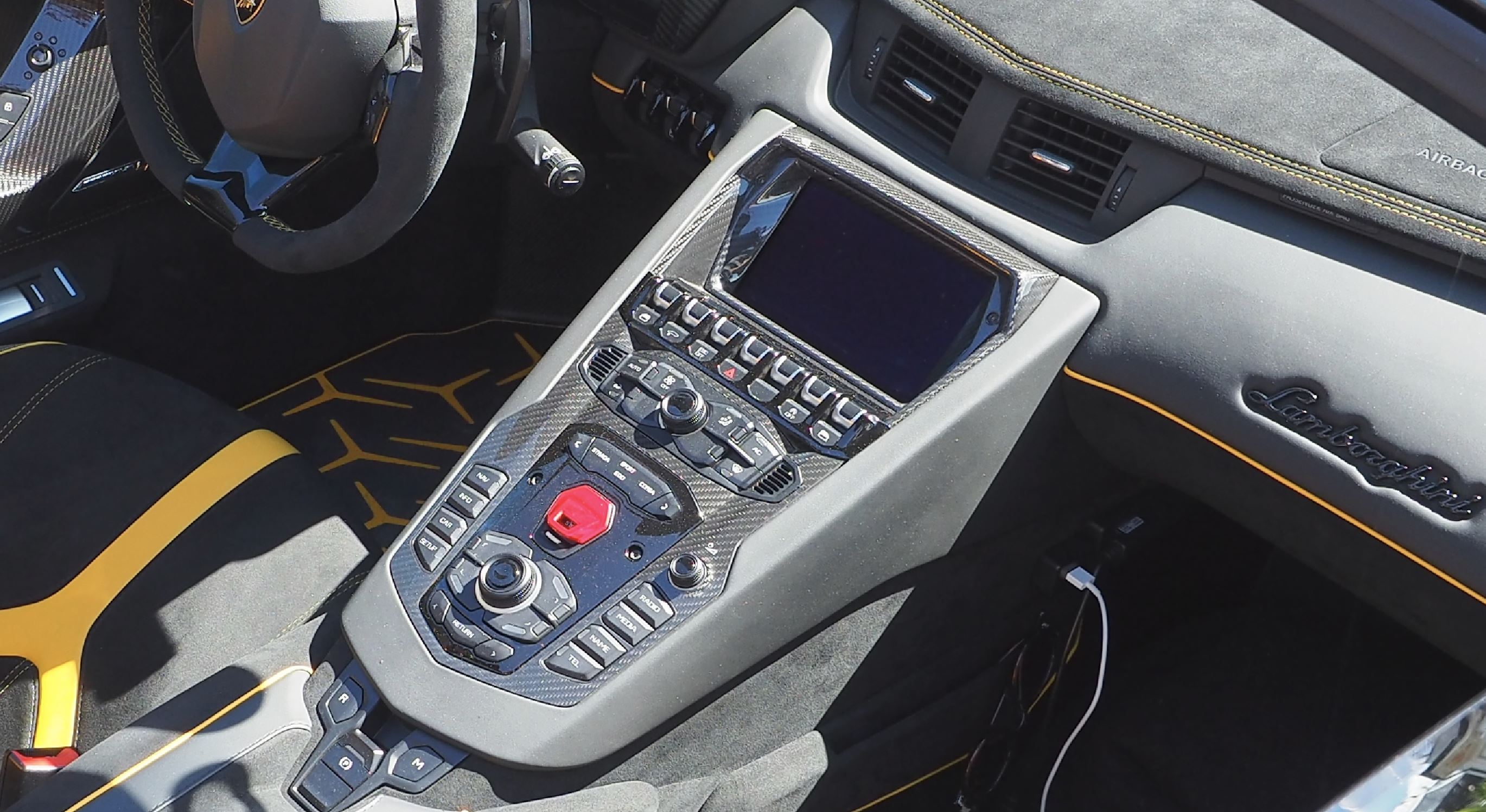

What key switches use Lambos? after all.... even these are keypads, aren't they?

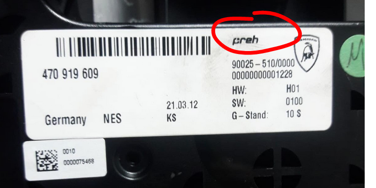

Based on this sticker they're made by Preh which indeed make keyboards. I have an old one kicking around; certainly unique construction.dcopellino wrote: 03 Jun 2024, 19:40 What key switches use Lambos? after all.... even these are keypads, aren't they?
