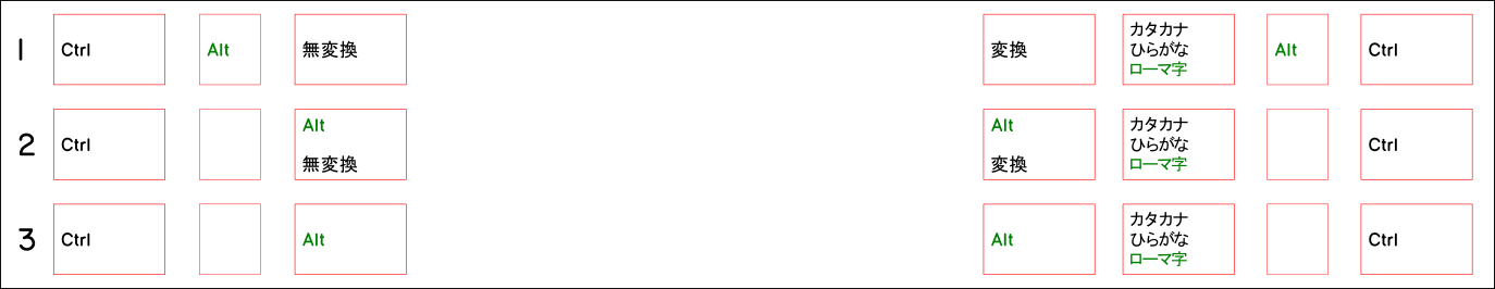

It is my understanding that the Japanese orders will have a 5.5U spacebar (Unicomp style) as I have been showing above. With what you and Dön have been saying about using longer spacebars it seems that option #3 would be a good addition?PRIPARA_PLAYER wrote: 03 May 2021, 13:58 I'd happily second a shorter space key, but unfortunately the previous example already seems to be using the shorter space bar style (the same as the one in JIS Unicomp layout) and I'm not sure it can come any shorter.
Ellipse wanted me to minimize it for the base sets so things would not be delayed while the factory works out the front printing. That is why the more accurate front printed stuff is in an 'Extras' set.PRIPARA_PLAYER wrote: 03 May 2021, 05:39 On a side note, your first three front print extras are also all keys I would plan to pick up. I'm not sure if you can't have front print in the default set, but if you can then my preference would be for the first two to be in there, and the third is to again match historical accuracy over modern keyboards.
As long as the option 1 keys are offered as extras I think option 3 is likely the best bet.
Edit: Actually, it might be better to swap alt and the hiragana key for symmetry and so the key is closer to space.

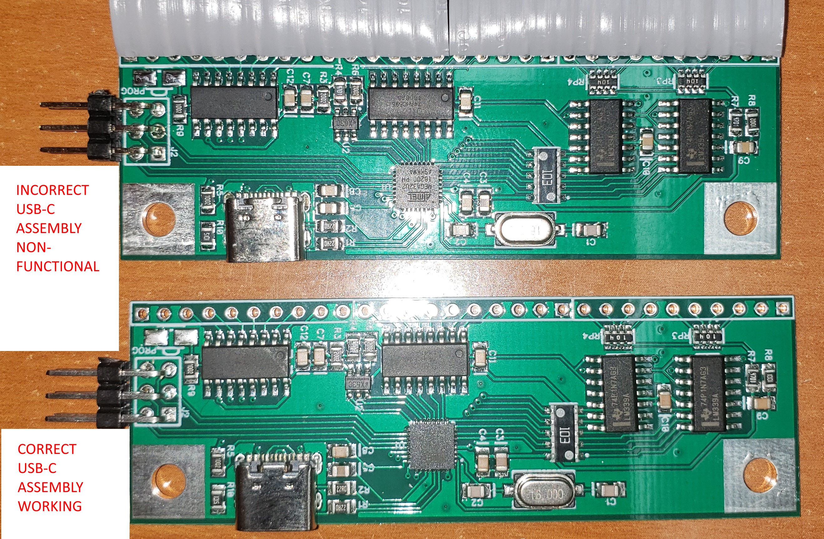

Question to reflow soldering / PCB experts: is anyone interested in a handful of (free) xwhatsit controllers that did not pass quality control standards? Example issues: row or column not detected, entire controller not detected by computer.
The controllers would be free and I would cover the cost of shipping in the US, with the only requirement that you make a good faith attempt to repair them and let me know in detail how to fix them, so I can pass along the info to the factory. Maybe you'd need to remove one working shift register chip over to another PCB and keep one or more of the PCBs as "for parts" units, for example. I'd also request that you fix and mail me back one or two of the many controllers I send over, just to show the factory that they are in fact repairable.
In the attached comparison, my suspicion is that the PCB on the top had its USB-C connector soldered at such an angle that caused the controller to not work. It just shows every gray dot as pressed in the xwhatsit capsense utility program, at any threshold value (xwhatsit's Model F testing PDF notes that a working controller should display no gray dots at the very first startup and should initially auto calibrate to threshold value 681). The one on the bottom is tested and working.

I think option 1 is the best. The proper length space key for Japanese is 2.5U. Maybe you guys say you can't manufacture this...Zed wrote: 03 May 2021, 17:20It is my understanding that the Japanese orders will have a 5.5U spacebar (Unicomp style) as I have been showing above. With what you and Dön have been saying about using longer spacebars it seems that option #3 would be a good addition?PRIPARA_PLAYER wrote: 03 May 2021, 13:58 I'd happily second a shorter space key, but unfortunately the previous example already seems to be using the shorter space bar style (the same as the one in JIS Unicomp layout) and I'm not sure it can come any shorter.

I think we will be able to offer several bottom row options

I imagine the issue isn't just that they don't have a 2.5U mold, but that the barrels and whatnot underneath aren't designed to fit the extra keys. If there's a way to fit them I'd happily manually cut my space bar down to 2.5U.

First time posting but I might be able to judge this. You are right, it does look like the USB-C socket is placed way off. Repairing this is nearly impossible, as the socket most likely uses 2 rows of SMT pads in very close proximity hidden from view. If there is a short you will not be able to see it.Ellipse wrote: 04 May 2021, 02:48 In the attached comparison, my suspicion is that the PCB on the top had its USB-C connector soldered at such an angle that caused the controller to not work. It just shows every gray dot as pressed in the xwhatsit capsense utility program, at any threshold value (xwhatsit's Model F testing PDF notes that a working controller should display no gray dots at the very first startup and should initially auto calibrate to threshold value 681). The one on the bottom is tested and working.
One solution to this problem can be to use a different footprint for the socket, with smaller holes for the THT shielding pins for tighter tolerances and less room for it to be soldered at an angle. Do you know if a two step soldering process is used with this part? Most fabs I know of solder the signal pads first in an oven and solder the shielding pins manually afterwards.
For further analyzation better pictures would be nice, maybe you can get a few macro shots from the side so we can see the solder connections. Can you state which exact model of USB-C socket is used?

I believe you are correct. I was told that you could do it, but it would result in uneven spacing to the left and right, depending on which keycap sizes you chose, one being too tight, the other leaving too much of a gap.PRIPARA_PLAYER wrote: 04 May 2021, 04:51 I imagine the issue isn't just that they don't have a 2.5U mold, but that the barrels and whatnot underneath aren't designed to fit the extra keys. If there's a way to fit them I'd happily manually cut my space bar down to 2.5U.
Incidentally, I suspect it is not coincidental that the space bar on my Unicomp New Model M is off-centre if I swap out the stock one for the longer bar (as is my preference). Both the long and short bars on that board are uncomfortably tight against the left Alt key, and with the long spacebar in place, there is too much of a gap to the right (between Space and right Alt / Alt Gr). When I pointed this out, they didn't really comment other than saying that all the moulds were like that, which I felt was obvious. It's very annoying.
I believe the Unicomp New Model M uses their shorter space bar, the same as their old JIS 106-key and the short space bar Ellipse offers, which allows adding one 1.25/1.5 key. Creating a proper JIS layout would require shortening it further to add another two additional keys.

No, I know that, but what I'm saying is regardless of which size of space bar you use on it, there is not enough space between the left Alt key and the Space bar, and there is too much space between the right Alt (or Alt Gr) key and the Space bar. I brought this up with Unicomp and they just said it was like that on all the boards, that's just how it is on the chassis. What I'm wondering is whether this is a result of them having displaced the position of the Space bar very slightly in order to accommodate the additional keys without it being too tight a squeeze on the right hand side; it seems they've overshot by maybe 1 mm or so, if I'm right about that.PRIPARA_PLAYER wrote: 04 May 2021, 16:38 I believe the Unicomp New Model M uses their shorter space bar, the same as their old JIS 106-key and the short space bar Ellipse offers, which allows adding one 1.25/1.5 key. Creating a proper JIS layout would require shortening it further to add another two additional keys.
Yeah, definitely better to ship it all in one go. And I think that's more or less correct, but apparently there is a slight spacing issue if you do go for the short space bar, which is what made me wonder about Unicomp's new ones. It's either a bit too tight or you go for a smaller key size and there's too much space, one or the other. On the Unicomp New Model M, it's *almost* centred, but not quite.PRIPARA_PLAYER wrote: 04 May 2021, 16:38 I don't have my F77 yet since I didn't want to split keys and pay international shipping multiple times, but from what I see online the foam and whatnot allows for that one extra key but doesn't make room for another two.
an_achronism yes I believe Unicomp's 2013 product update also shows a slight gap for the 1.25 key whereas the older 104 design did not have an extra gap.
I think I designed the F62 and F77 to be more in line with Unicomp's revised design, so that both smaller and larger space bars are compatible. Maybe the older Unicomp design did not allow for both larger and smaller space bars using the same barrel frame, and with the 1.5U / 1U / 1.5U key arrangement on the left and right side of the space bar.

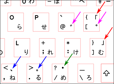

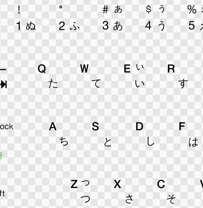

I got the new font from Dön and it looks perfect! Well done! I haven't updated the artwork yet but I had another question about the alignment of the some of the Hiragana punctuation.:Dön: wrote: 04 May 2021, 04:20Oh I see, I just created an account a few days ago so I didn't know about the private message feature.Zed wrote: 04 May 2021, 04:12Now that sounds a bit complicated! If you can work with an Inkscape file, I can send you a file through the Private Message system here.:Dön: wrote: 04 May 2021, 03:42
My font is a Chinese font and Japanese is not displayed. I think you need to know the difference between Chinese and Japanese to handle it. The same kanji will look different in Japanese and Chinese. If you send me the draft data of the print sheet, I may be able to provide it in outline format.
I think it can handle svg files and the like.
Blue : bottom left justified
Green : vertically centered, horizontally centererd?
Purple : top right justified?
Red : vertically centered ?, right justified?

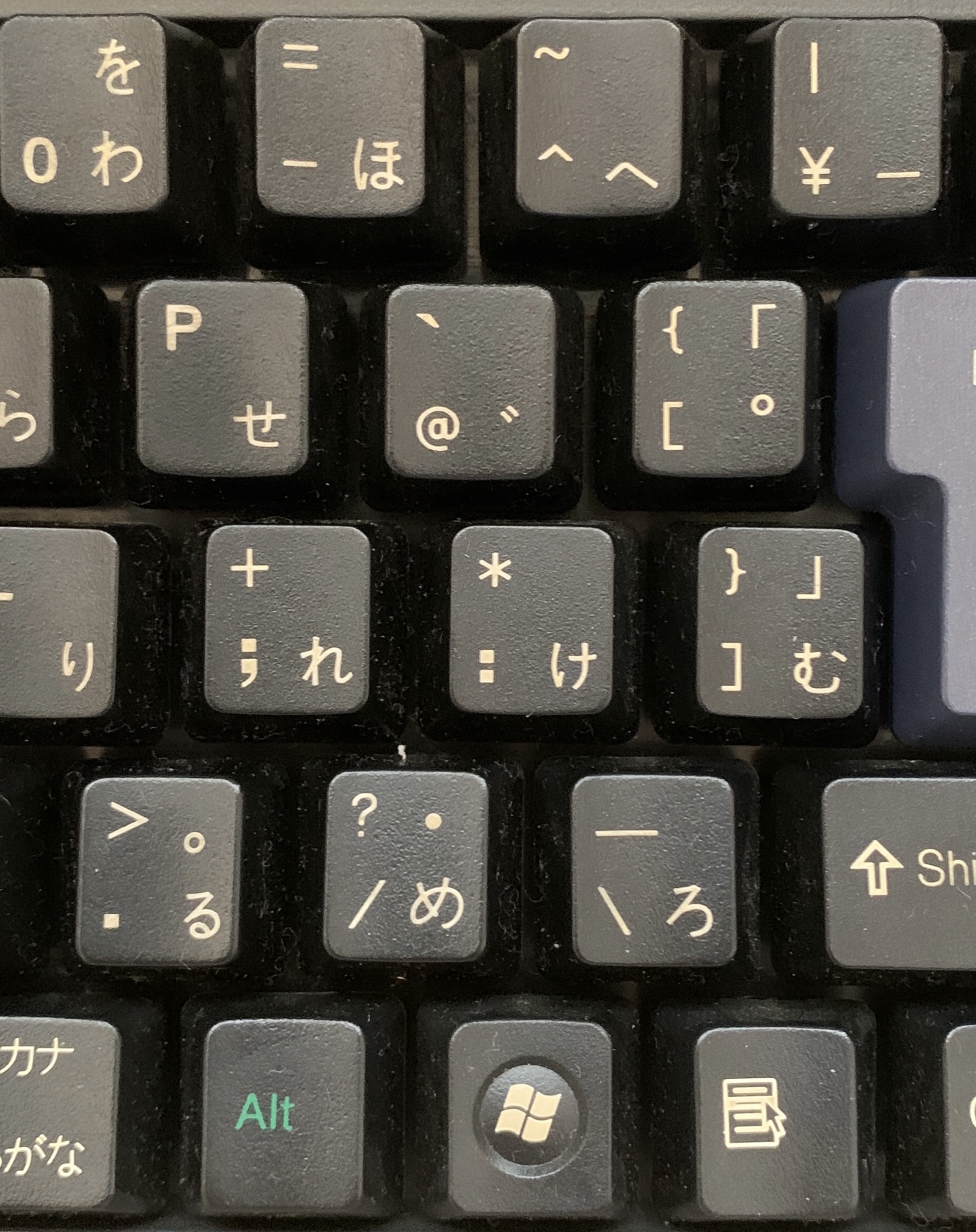

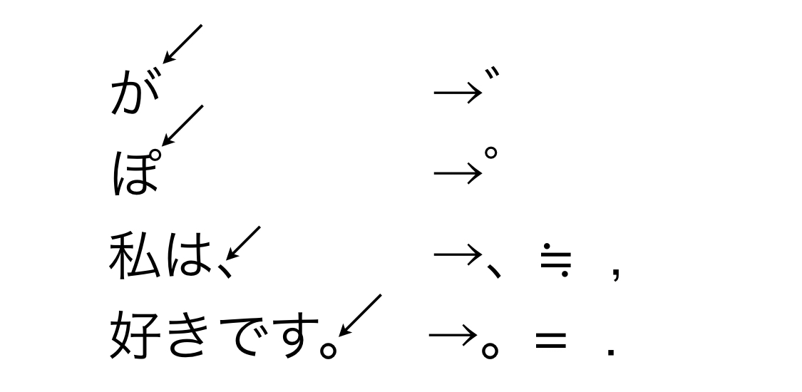

I think I have things correct but IBM does not agree. They seem to put the red and purple symbols left justified.
This is something where modern keyboards aren't entirely in agreement. IBM did left alignment and Lenovo still does, Realforce I believe does middle alignment, and some other companies do right. In this case my preference is definitely for left alignment to match IBM/Lenovo.Zed wrote: 05 May 2021, 00:49JIS punctuation alignment.png

PRIPARA_PLAYER wrote: 05 May 2021, 03:20This is something where modern keyboards aren't entirely in agreement. IBM did left alignment and Lenovo still does, Realforce I believe does middle alignment, and some other companies do right. In this case my preference is definitely for left alignment to match IBM/Lenovo.Zed wrote: 05 May 2021, 00:49JIS punctuation alignment.png
Thanks! I'll move things to the left to match IBM.:Dön: wrote: 05 May 2021, 03:12 I feel that the position of 」 symbol is inappropriate. This is one of the symbols for brackets in Japan. It should be treated like any other parenthesis symbol. It should be aligned to the left.

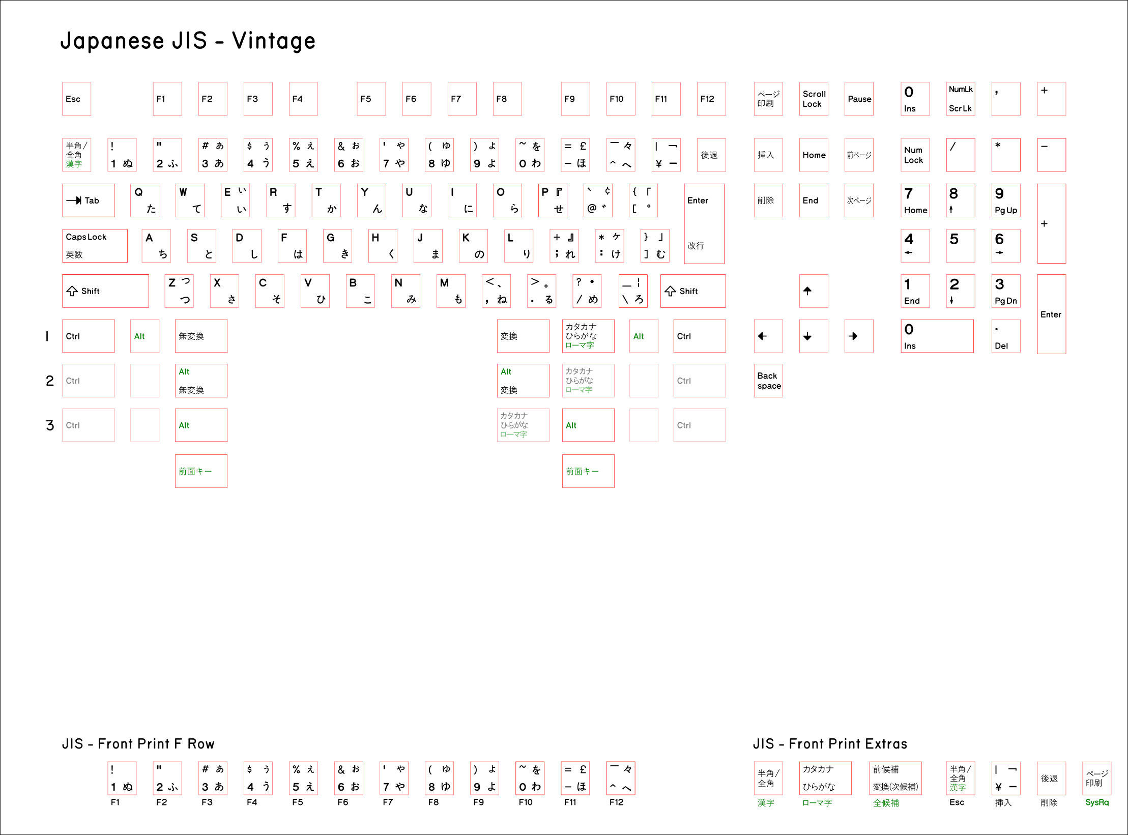

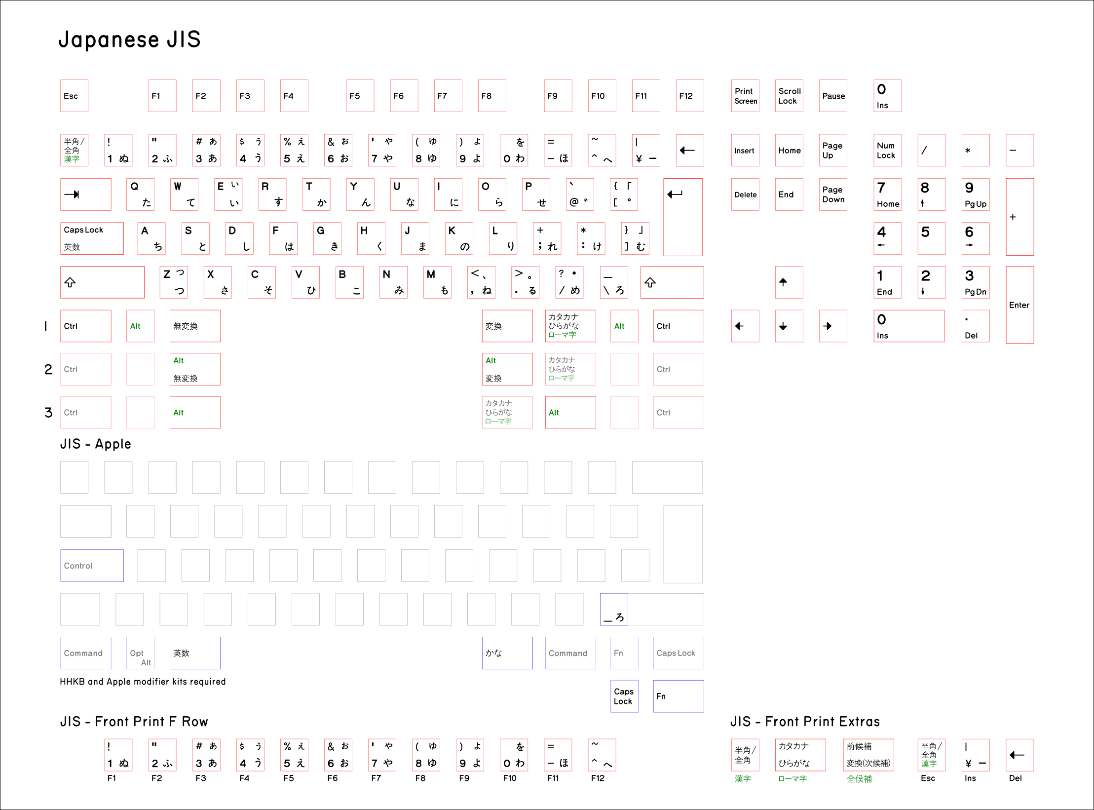

I was thinking that perhaps we should go with a Modern and Vintage style Japanese layout to make everyone happy. What do you think? Vintage Tab key could be made more vintage (double arrow style) but I'm not a fan. All 3 bottom row options included with each set. New font shown.
If you can make both then I'd very happily take a row 1 vintage. Regarding tab, I quite like the 003 tab that has two arrows and no letters on it.Zed wrote: 05 May 2021, 06:09 I was thinking that perhaps we should go with a Modern and Vintage style Japanese layout to make everyone happy. What do you think? Vintage Tab key could be made more vintage (double arrow style) but I'm not a fan. All 3 bottom row options included with each set. New font shown.
The new font and left alignment look great!

I am glad that the Japanese was well placed.
As a Japanese person, I feel that the tab key is the standard style of a letter and two arrows.
By the way, the most common 5576 style is a01, not the c01, 003, etc. that you are referring to. For the Japanese, the a01 is the standard when it comes to IBM keyboards.
