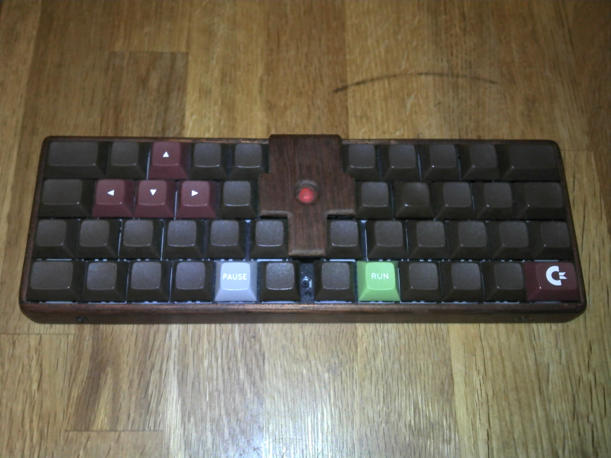

The fastest way would be to get a plate cut or have it 3D-printed and then hand-wiring the switches. Unless of course you can base your design on a pre-existing PCB. But the physical layout for a single plate is much easier to design and most probably more appropriate for a prototype.
Case design can then be done at a latter stage like you can see at my HyperNano with a retrofit mahagony frame :-)
HyperNano with mahagony case
