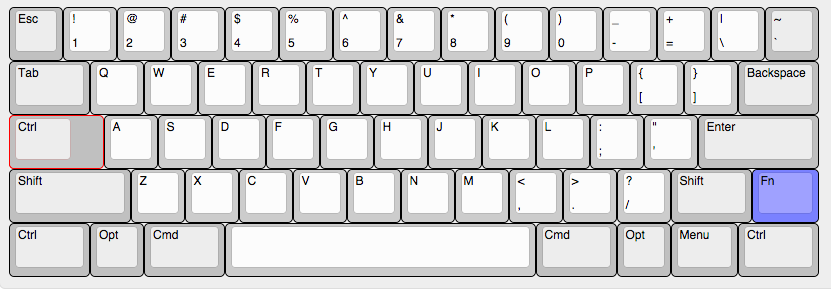

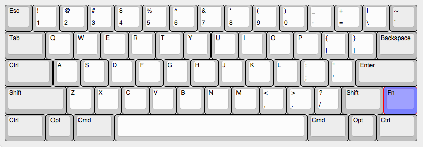

Isn't this sacrilege, at least on the HHKB side? Will you provoke the wrath of Wada? But perhaps this is counterbalanced by upholding the rite of Kish. The result maintains the symmetry of the HHKB but adds two modifiers, so that we end up with:
1.50, 1.00, 1.50, 7,00, 1.50, 1.00, 1.50.
Thus, Revision 3 would look like this:
And here is the link to the layout:
http://www.keyboard-layout-editor.com/# ... c83707baf7
This is not bad at all. It requires only the CapsLock position to have a stepped 1.75x key, and Unicomp has blanks and Ctrl keys available.

Thanks for these insights. I am fine with the 7.00x spacebar, which enables preservation of symmetry on the bottom row. At the same time, I am in favor of having a smaller spacebar. However, I think that the 7.00x spacebars might be more plentiful and also available in black. Regarding Unicomp colors, I prefer Pebble or Black rather than Gray for mods.
Here is HHKB-Rev4 with a 5.75x spacebar:
This revision explicitly shows that the 1.75x key in the customary CapsLock position is stepped. I don't mind having a stepped key in this spot. However, the bottom row is starting to look cluttered. While I like having a shorter spacebar, aesthetically, I prefer HHKB-Rev3 which has a nice symmetry.

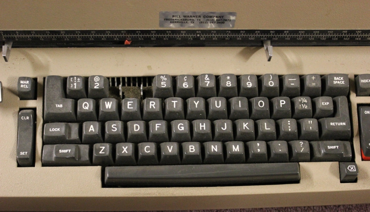

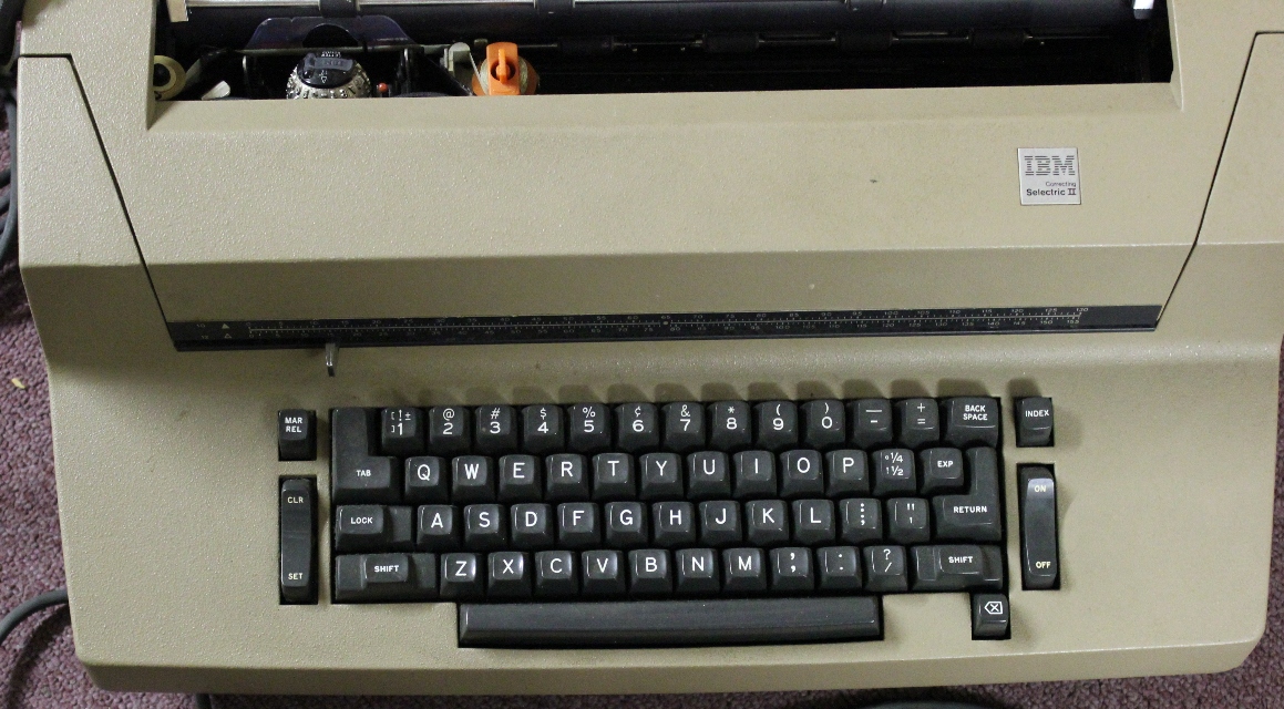

That being said, I am stripping 3 Selectrics, and have 3 full sets of caps for sale. Somebody make me an offer and take them home. Pics tomorrow.

Yes, spherical double shots, pics tomorrow. THe Selectrics are brown, if that helps. Selectric IIs, I think.
Like these, I think http://s694.photobucket.com/user/mycadd ... 2.jpg.html
Posted: 09 Dec 2014, 23:33
by elecplus
IBM Selectric II, there are 3 of these to be scrapped. All the keys are there, I just pulled 2 to show the wire they sit on.
One does not power on, 2 do, but neither one works. So off to the grinder they go.
Shiny scooped caps! Kind of a dark charcoal grey color, white on the bottom side of the caps.
