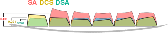

I wanted to finally get my head around this, and dorked with it over lunch. I am not sure we really need, or even want to doing anything special as far as a row by row offset. At least I would be happy with the results. The following images (assuming the original Signature Plastics profile on our site is accurate), would reflect the end result. There would be SLIGHT additional key separation on the Y plane, but it would be neglible
This is the original:
This is the original in relation to the IBM barrel assembly curve (300mm radial bend for the angle):
- cherryCapsWithBackplate.png (35.39 KiB) Viewed 5637 times
And this is the result of the two merged:
- Key rotations in degrees (approximations, but very close) by row starting from left to right: 7.5, 5, 1, -2, -4, -7
- cherryCapsWithBackplateMerged.png (43.53 KiB) Viewed 5637 times

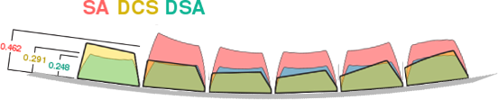

This would be the actual rotation of the backplate as it sits in the case. It is possible that Cherry boards sit on an incline in the case as well. I have no idea... don't own one.
- cherryCapsWithBackplateMergedRotated.png (47.96 KiB) Viewed 5637 times

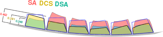

And lastly, with IBM keycap profiles in Blue
- cherryCapsWithBackplateMergedRotatedWithIBM.png (49.76 KiB) Viewed 5588 times
Personally, I like it. At least not bothered by it enough to find a reason to change the adapter to componensate. Any changes to the angles would result in the keys having a "stepped" appearance. We could alter the Z-axis depth, but then we are raising or lower the key in relation to the board
The SA profile would be a bit nuts, but we are in essence turning DCS/DSA into SA hybrids
. Welcome thoughts
EDIT: Per TechnoTrousers request, I added the IBM keycap profile to the last image

The graphics help to visualize that, thanks! Without spending a ton of time, could you put the IBM key shape in there as well, for comparison? I have a feeling that it's close to the SA profile in height, but will be less angled on the top.
Posted: 03 May 2016, 23:25
by lot_lizard
Techno Trousers wrote: The graphics help to visualize that, thanks! Without spending a ton of time, could you put the IBM key shape in there as well, for comparison?
I added the IBM outline in blue to the last image of the previous post.

Cool! Is that angle right, though? I always thought the tops of the IBM caps were close to parallel with the curved plate.
Posted: 04 May 2016, 06:04
by Ratfink
Moving my head to the side of my desk, I can tell you that angle's certainly damned close to right.

Ratfink wrote: Moving my head to the side of my desk, I can tell you that angle's certainly damned close to right.
Hahaha... Thanks. If anything, I might need to roll the tilt of the board forward more (i just have the assembly sitting on my desk and didn't measure as seated in the case, I'll do that tomorrow, but it's within a couple degrees I expect). But am confident of the key pitch in relation to the plate, and that's the important part for this exercise.
