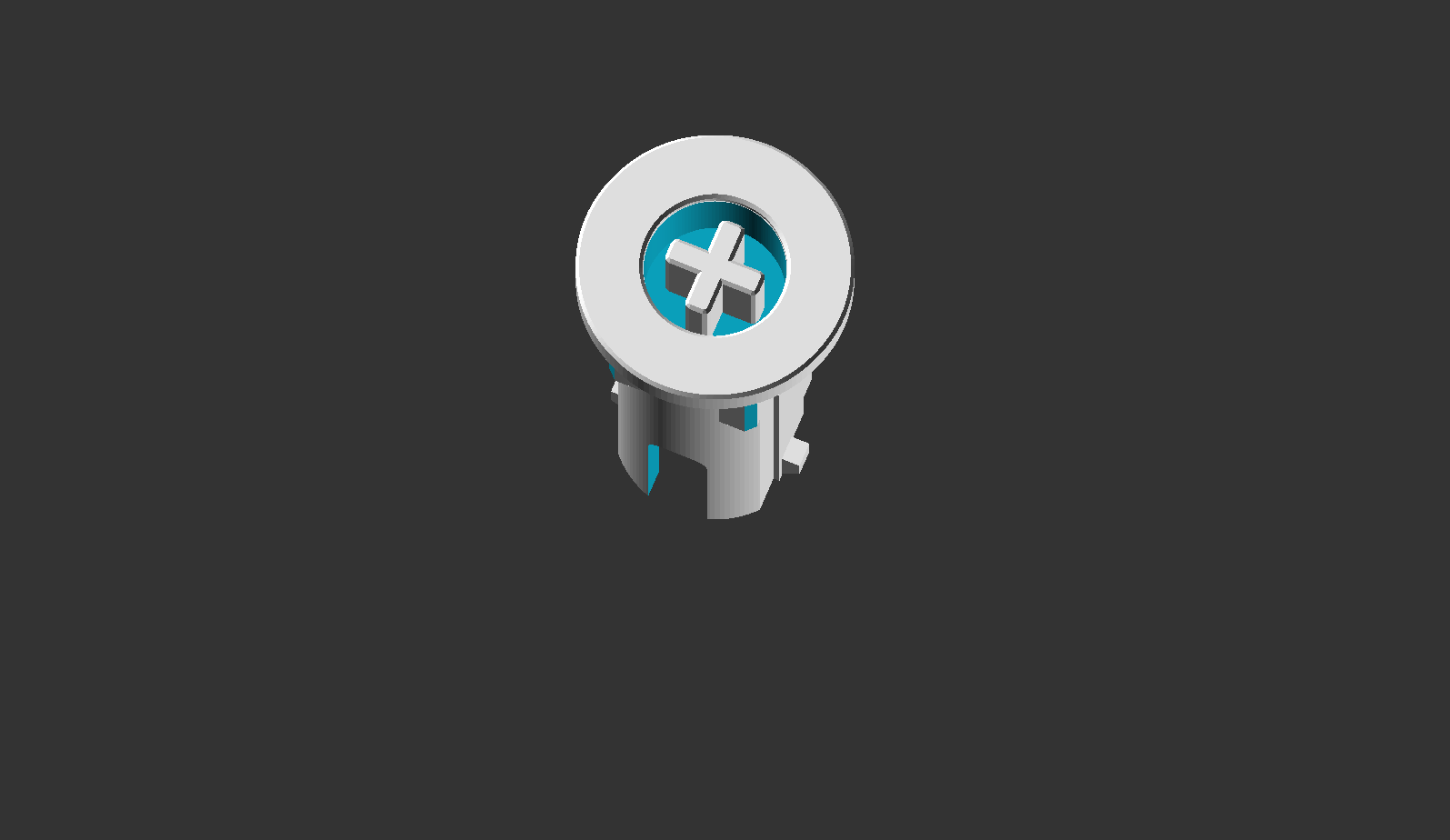

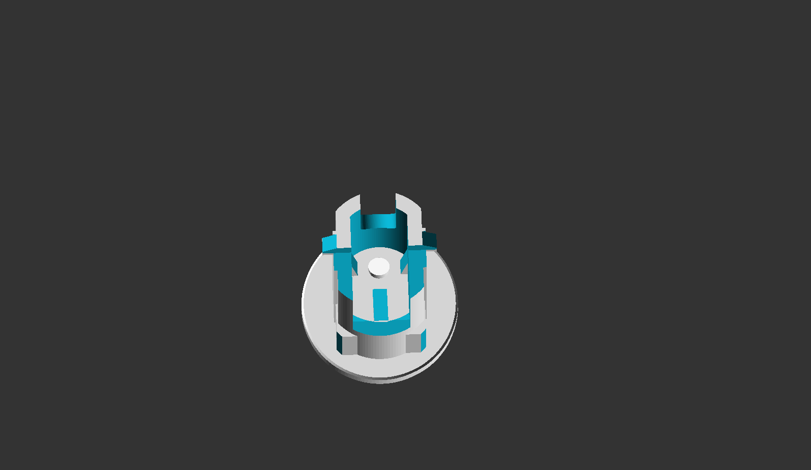

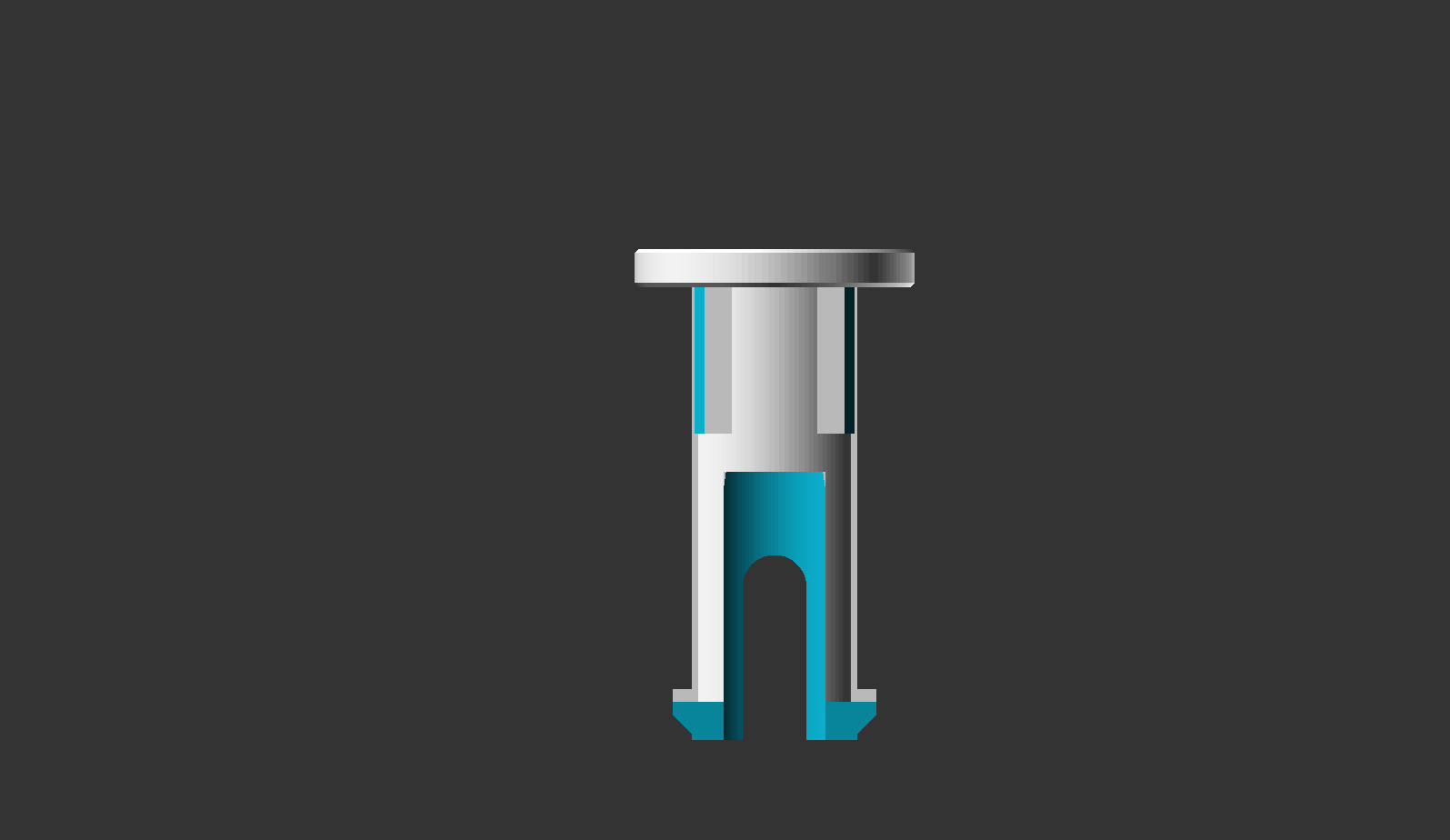

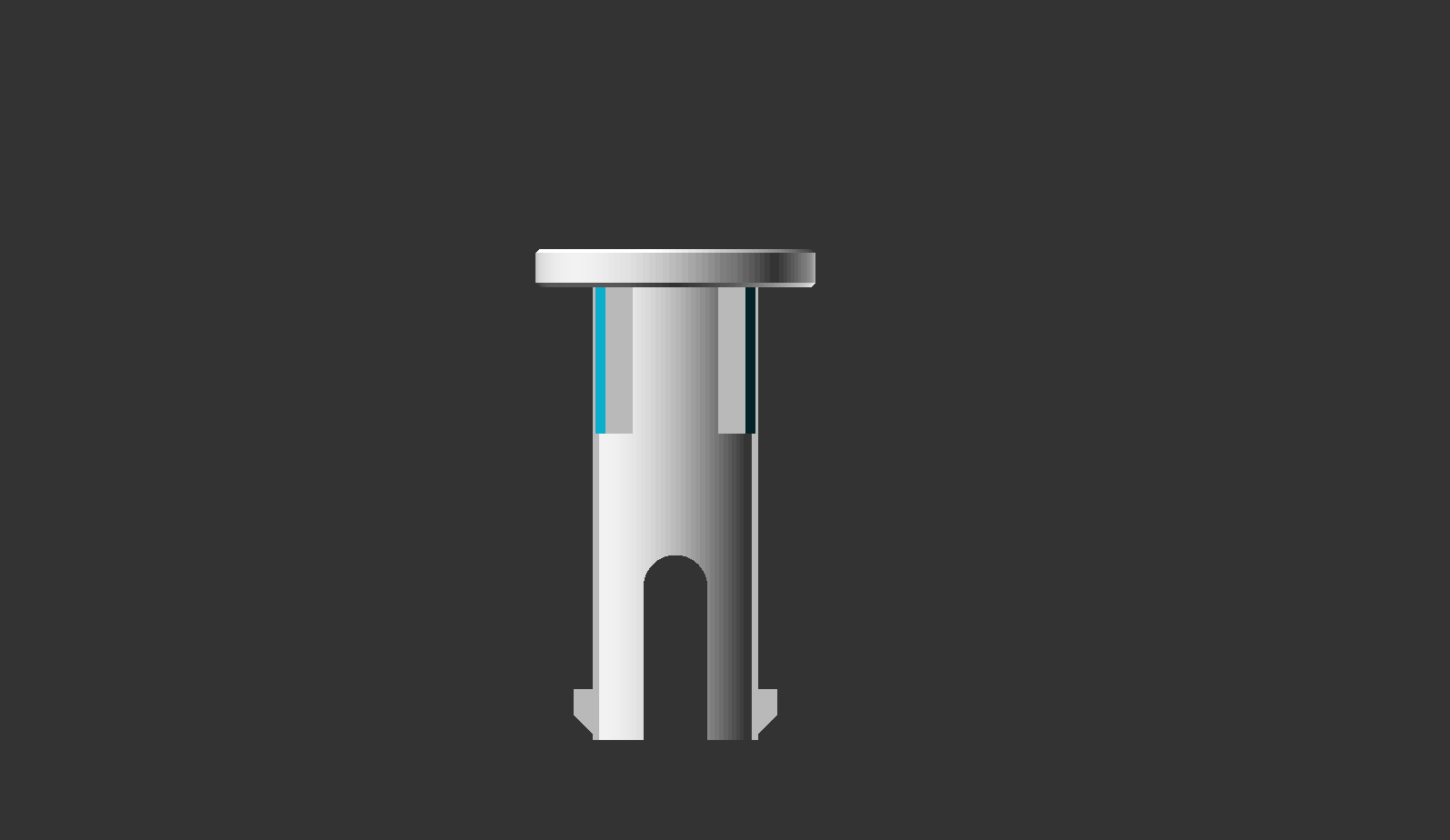

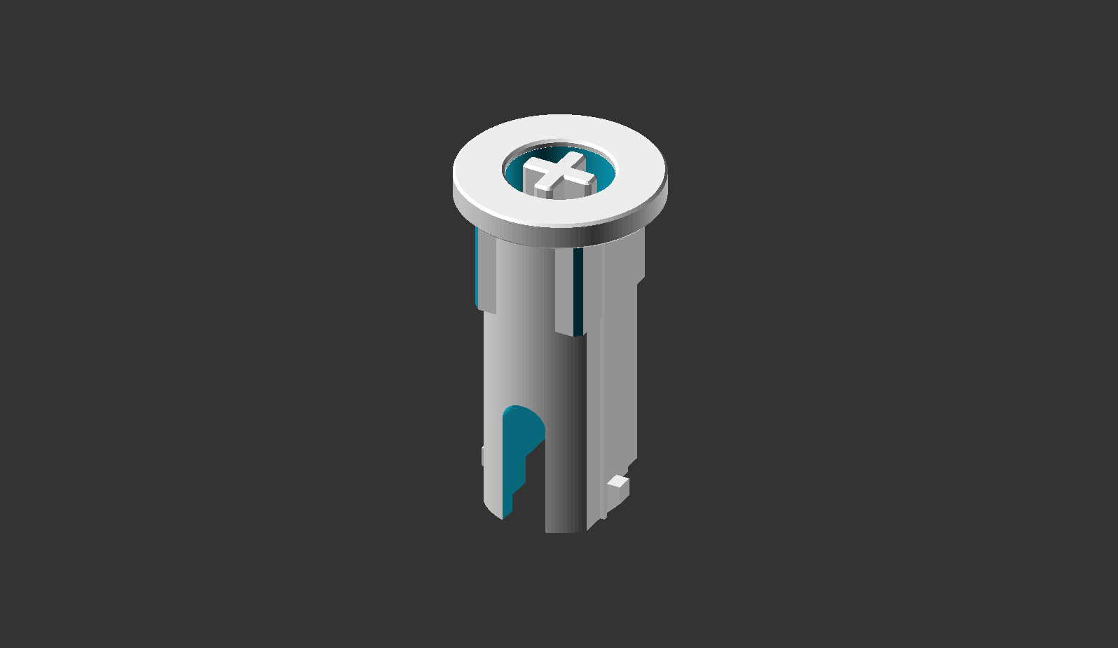

Actually... this is a little bit hysterical. I was about to post this in the FSSK thread because I am doing this work tied to it, and decided to search one last time to see if there was any other threads that I might add a link to. I did this work ~3 years ago, and finally decided to act on it now that I was motivated with this FSSK. Low and behold, I came across this (and here I thought I was being novel... at the time, I guess I was?!?)
Considering the work was done in two vacuums, the similarities are striking!!! Which makes me feel good that it really is the "right way", but to be honest, there aren't too many options. I had a working prototype printed a little over a month ago, and can confirm it works. I am not sure specifically what tolerance issues matt3o ran into (could have just been the ribs from a lower res. printer, or things being slightly shifted. I can't tell you what a difference even .1mm makes on moving parts), but this works quite well.
I did have one slight tweak to the actuation travel, and sent the updated version off for printing with the FSSK inner assembly drop-in case I have been messing with. Should receive one big box of goodies in couple of weeks. I really need to just buy my own printer :)
If someone would do me a favor though, could you confirm that these measurements truly are accurate? The other irony of all of this, I love the cherry double shot movement, but have ZERO cherry boards or keys
http://i.imgur.com/iX8JW.png
Side note (and if it is already mentioned in this thread I apologize... I just skimmed it), we could play with actuation travel quite a bit. I wanted this first pass to be identical, but think buckling spring "short throws", etc. It all has to do with the offset of the side clips and the depth of the spring base plate. There is quite a bit of room there for adjustment.
Also, jaseg deserves huge praise for his/her work with the model M measurements back in 2012. I had to modify a few things that I found to be different with the keystem interior, but jaseg's work is actually what inspired me to mess with this back in '13. I have unfortunately been sitting on my plans ever since :(... Sorry about that. Let me know what you think
Cherry MX Mount
Cherry MX Mount
Inside the buckling spring stem from the bottom
Front
Front
Back
Back

I have quite some slider working, the problem is not much in the tolerance but in the texture of the 3d print material. The slider needs to be very smooth for 100% original feel and at the time the available materials were not so good (at least the ones I tried).
lot_lizard wrote: If someone would do me a favor though, could you confirm that these measurements truly are accurate? The other irony of all of this, I love the cherry double shot movement, but have ZERO cherry boards or keys
please convert to mm :) I'm too lazy right now to do it myself :P
lot_lizard
02 May 2016, 15:05
matt3o wrote: please convert to mm :) I'm too lazy right now to do it myself :P
I had to originally as well :). Not sure why they captured the measurement that way. .217" = 5.5118mm
-[°_°]-
02 May 2016, 15:08
I've always done the cylinder 5.4mm (you have to consider material shrinkage though, that may vary). Of course if that is negative, 5.5 seems about right, probably 5.6 even better
lot_lizard
02 May 2016, 15:25
matt3o wrote: I've always done the cylinder 5.4mm (you have to consider material shrinkage though, that may vary). Of course if that is negative, 5.5 seems about right, probably 5.6 even better
Thanks for checking... I have a 5.6 ID on the outer ring, so hopefully that is good. Technically not needed for the mount, so a little extra clearance should be goodness. There is a real tradeoff there on tolerance for the MX mount, and getting too close to the exterior of the keystem glide with MX mount having to be recessed like it is

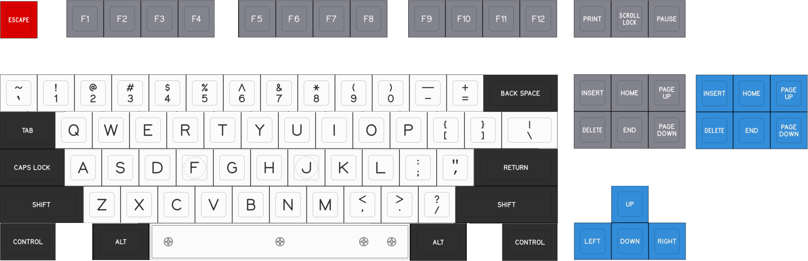

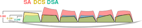

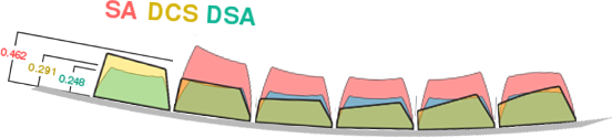

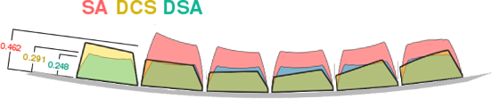

I wanted to finally get my head around this, and dorked with it over lunch. I am not sure we really need, or even want to doing anything special as far as a row by row offset. At least I would be happy with the results. The following images (assuming the original Signature Plastics profile on our site is accurate), would reflect the end result. There would be SLIGHT additional key separation on the Y plane, but it would be neglible
This is the original:
This is the original in relation to the IBM barrel assembly curve (300mm radial bend for the angle):
And this is the result of the two merged:
Key rotations in degrees (approximations, but very close) by row starting from left to right:  7.5, 5, 1, -2, -4, -7
This would be the actual rotation of the backplate as it sits in the case. It is possible that Cherry boards sit on an incline in the case as well. I have no idea... don't own one.
And lastly, with IBM keycap profiles in Blue
Personally, I like it. At least not bothered by it enough to find a reason to change the adapter to componensate. Any changes to the angles would result in the keys having a "stepped" appearance. We could alter the Z-axis depth, but then we are raising or lower the key in relation to the board
The SA profile would be a bit nuts, but we are in essence turning DCS/DSA into SA hybrids :). Welcome thoughts
EDIT: Per TechnoTrousers request, I added the IBM keycap profile to the last image

Techno Trousers
100,000,000 actuations
03 May 2016, 22:33
The graphics help to visualize that, thanks! Without spending a ton of time, could you put the IBM key shape in there as well, for comparison? I have a feeling that it's close to the SA profile in height, but will be less angled on the top.
lot_lizard
03 May 2016, 23:25
Techno Trousers wrote: The graphics help to visualize that, thanks! Without spending a ton of time, could you put the IBM key shape in there as well, for comparison?
I added the IBM outline in blue to the last image of the previous post.
Techno Trousers
04 May 2016, 05:47
Cool! Is that angle right, though? I always thought the tops of the IBM caps were close to parallel with the curved plate.
Ratfink
04 May 2016, 06:04
Moving my head to the side of my desk, I can tell you that angle's certainly damned close to right.
