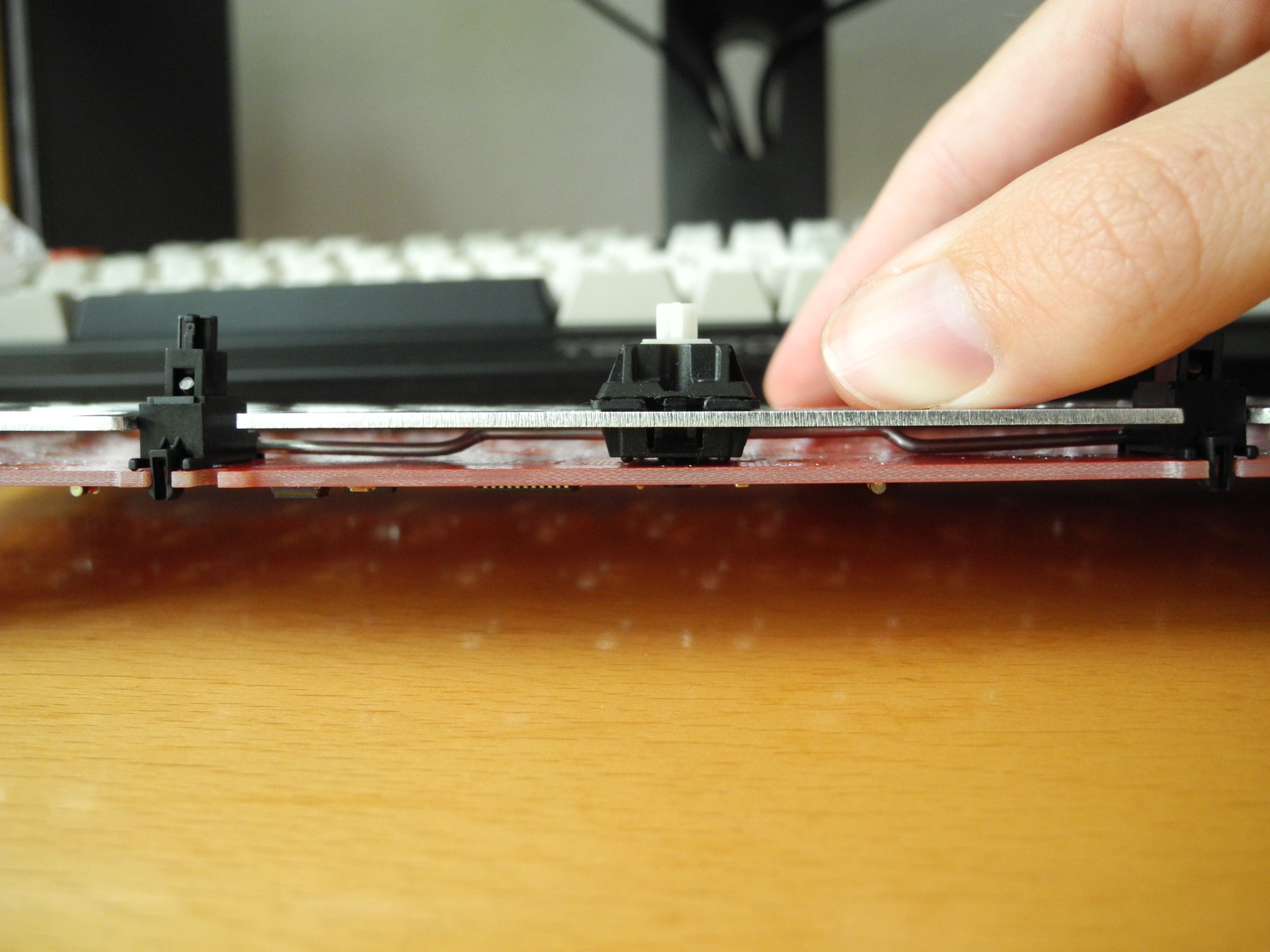

Yeah, that is what i have tried. I can squeeze the wire in between the plate and the PCB but then the stab bends down a little bit and it changes the keyfeel.
DanielT
12 Sep 2014, 15:08
Are you sure the wire is inserted in the stand-off the right way ? Because there should be no squeezing involved, it should fit with no effort. One thing, as far as I know PCB mount stabs must be mounted before the plate.
I find plates a too big commitment, after the plate is on and switches soldered any change is a pain :( The Poker PCB was thin and some felt a flex (I didn't ) but this faceU is thick as hell, I have heavy blacks on it and no flex.
chzel
12 Sep 2014, 15:18
Yes, pcb mout stabs under a plate need a wire with no bend, or the wire hits the plate.
You can easily bend a wire, it needs to be ~1.5mm thick piano wire ( or any stiff steel wire) 100mm wide center to center (for 6.25u), and the legs should be 13mm long on the outside (11.5mm on the inside).
edited for clarity
Nuum
12 Sep 2014, 15:37

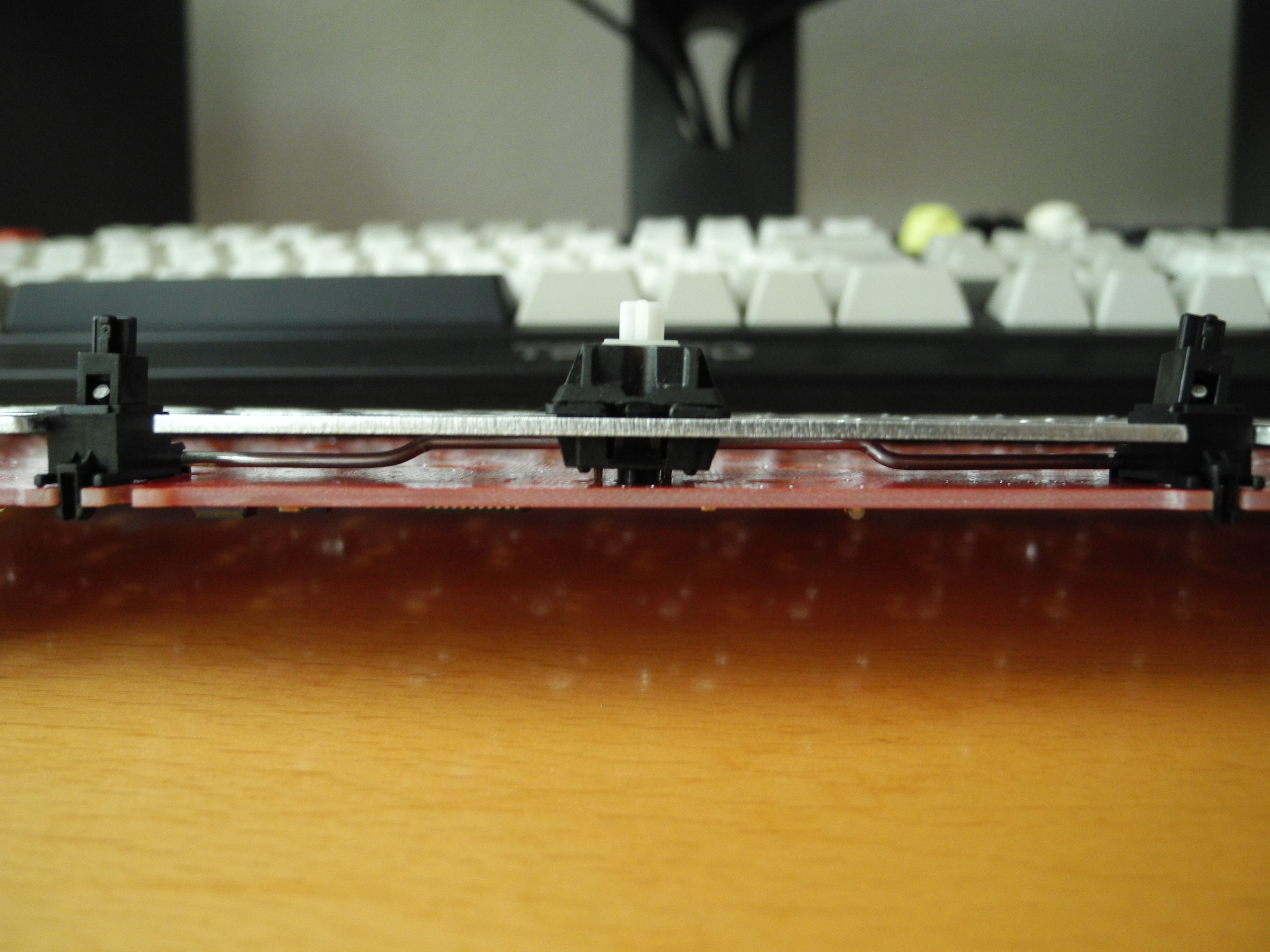

Yes, that's what I thought, but shouldn't there be a straight wire included with a plate mounted stab, that I could use? My plate mounted stabs had a bent wire as well.
Here are two photos to ilustrate the problem with a bent wire:
Edit: Ok, now I just rebent one of the wires to be straight and everything works fine (had to cut about 1mm off of one side). It's not perfect, but it does the job. Thanks for your help guys.
On a side note: Damn those clears are really tight, one more reason to me to use a plate.

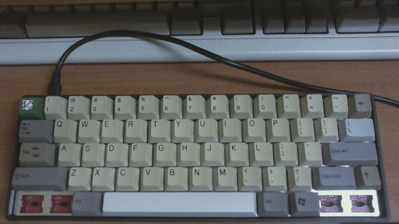

mashby
15 Sep 2014, 03:12
beltet wrote:
Nuum wrote: I think you are right. The switch hole is 0.25u too far on the left as well, I think, but I maybe I'm overlooking something. I just tested it on mine, which is not yet assembled.
On the other hand HzFaq built a ISO FaceU, but perhaps without plate:
HzFaq wrote: Got mine today as well, typing on it as we speak. I'll get some pics up tomorrow, but overall I'm really happy with this.
edit -
yeah it seems like its 0.25. I will have to cut the plate to fit it, so the ISO enter is the only key thats not plate mounted. I'm a little sorry for that...
I'm not sure that the issue is with the plate, or the PCB.
I have an aluminum plate from IMSTO and it has the same issue. Neither the acrylic plate that I bought with this GB, or the IMSTO aluminum plate line up with the ISO enter location. Normally, I'm not an ISO guy, but since the key cap set I'm using and this PCB both support it I thought I'd give it a shot. However, not sure that I want to permanently alter my plate only to find out that it's not for me.
Does anyone have a photo of a completed ISO board -- with or without plate -- so I can make sure I'm building it correctly? A little ISO expertise for an ANSI guy? :lol: found one!

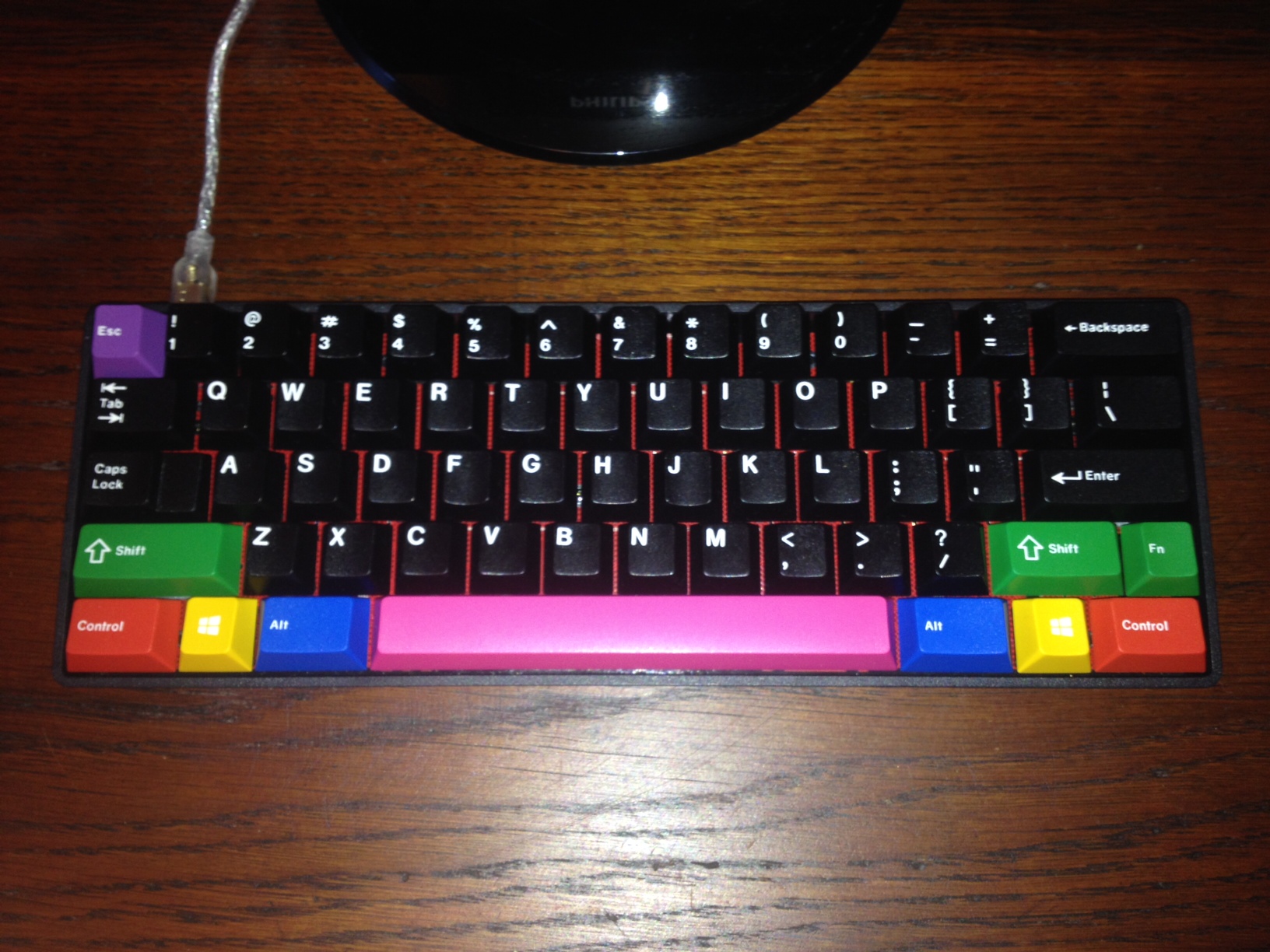

17 Sep 2014, 00:15
Very very potato-ish pic - le mockup layout with temporary keys and of course unfinished cover:
layout mockup.jpg (88.94 KiB) Viewed 6011 times
I think I get the hhkb idea of keeping empty space where the ctrl keys normally were: it practically pushes you to learn the other position! Flashing went very easy - both the upgrade and the remapping (caps -> ctrl, apss -> win)
