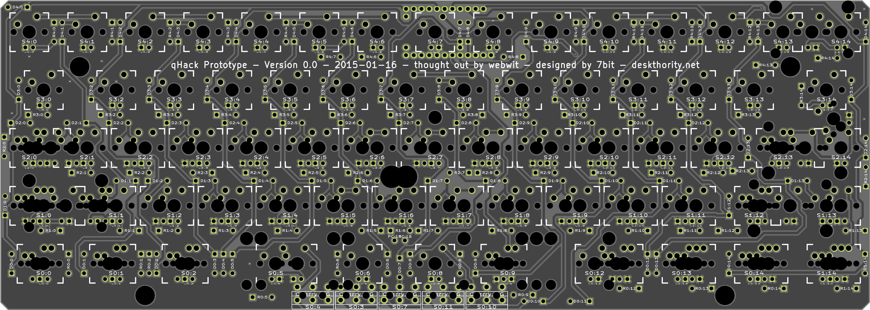

I would like to test a 60% :D Have a teensy have some switches diodes
16 Jan 2015, 04:15
7bit wrote: The latest version:
Yes, yes!
But where's S3:1? :?

I'm also interested in putting together a prototype. It's not going to fit a poker case with those mouse buttons is it?
16 Jan 2015, 10:40
webwit wrote: ...
Shit!
:oops:
I hoped nobody would ever discover the dark secret of this keyboard!
:evilgeek:
matt3o wrote: send me one and I'll compile you the firmware :P
please add poker case compatible screw holes!
tlt wrote: I'm also interested in putting together a prototype. It's not going to fit a poker case with those mouse buttons is it?
What is a Poker case :?
This keyboard indeed is not designed to replace any PCB in any existing case.

7bit wrote: This keyboard indeed is not designed to replace any PCB in any existing case.
completely forgot about the bottom row of switches!

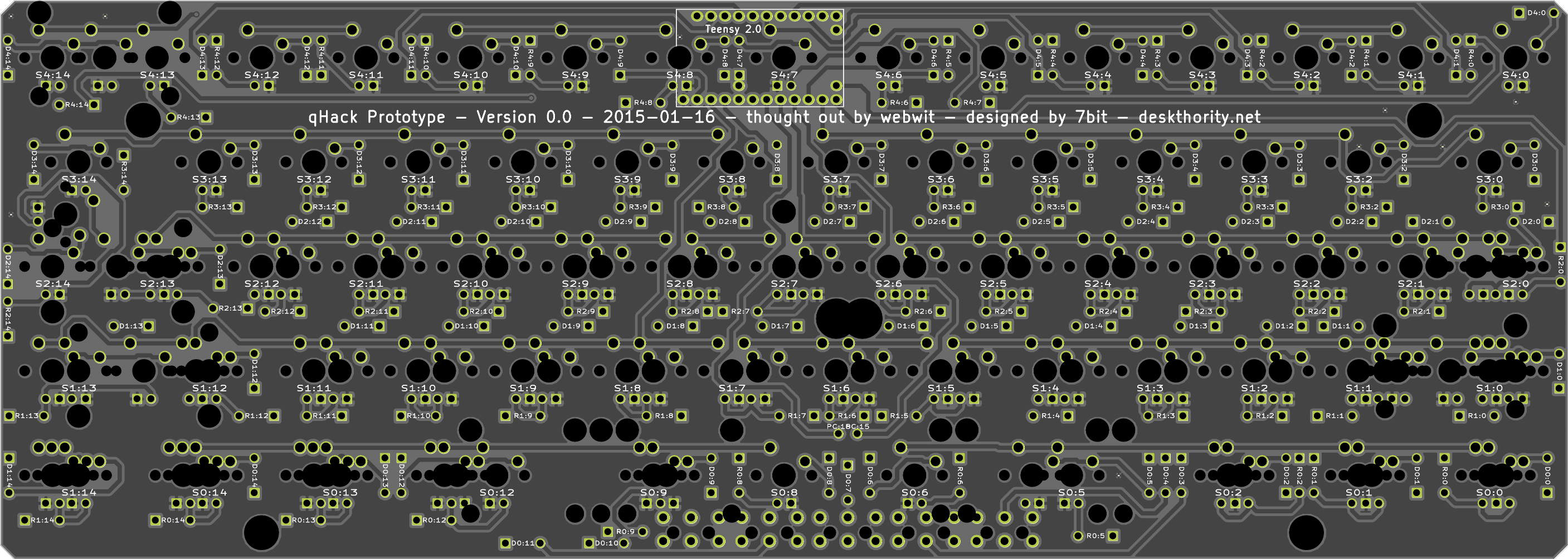

16 Jan 2015, 12:29
Little correction:
The mouse buttons are now as close to the switches as on the HyperMicro.

what is the exact width/height of the board and what switch spacing did you use (19mm)?

16 Jan 2015, 13:43
switch spacing: 1 unit = 0.75" = 19.05mm
dimensions:
5.35 units tall and 15 units wide, shifted by 0.3 units from bottom, ie 0.3 units gap to bottom edge and 0.05 units to top edge, 0 units to left and right edges.
4.0125" x 11.25" = 101.9175mm x 285.75mm
:roll:

So it's like a 61% board? ;-)

7bit wrote: switch spacing: 1 unit = 0.75" = 19.05mm
dimensions:
:roll:
darn imperial system lover!
16 Jan 2015, 14:48
Well, the definition (according to Cherry) of 1 unit is precisely 0.75" and 19.05 mm, so I have no other choice.
-[°_°]-
16 Jan 2015, 16:05
they have 2 specs: EU and US. For the US one they picked the closest value to 19mm which is 0.75". In fact in the EU specs the switch hole is exactly 14mm.
16 Jan 2015, 16:14
Plate cut-outs are indeed 14mm but switches are 19.05mm apart!
There are not 2 specifications!
:mad:
-[°_°]-
16 Jan 2015, 16:17
7bit wrote: Plate cut-outs are indeed 14mm but switches are 19.05mm apart!
:mad:
don't make me search in the backups! :P
16 Jan 2015, 16:26
There is a file Keymodule_MX.pdf that shows all information I needed to make the PCBs, including 1 units == 19.05mm!
-[°_°]-
16 Jan 2015, 16:33
that seems a rather old document. Anyway, it works for me!
I have two documents which are pretty close to that one, one entirely in inches the other in mm.
16 Jan 2015, 16:42
No chance of this fitting in Poker cases, like Pexon's cast metal ones, I assume? The extra PCB area for the buttons doesn't look forgiving.
16 Jan 2015, 16:46
No, because of the mouse buttons.
It is from March 1994.
What do you mean "old"?

Lowpoly's has those nice vertical mousebuttons which take no extra space...

^^^ The reason why the qHack must be a little bit larger is because there are regular switches in the way of these 2 mouse buttons!
:roll:
edit:
Wait!
What about mounting the mouse buttons at the underside?
:evilgeek:

Hint: This is the original qHack design, that webwit asked to be made.
As you can see, there are 3 mouse buttons that are below the bottom row.
