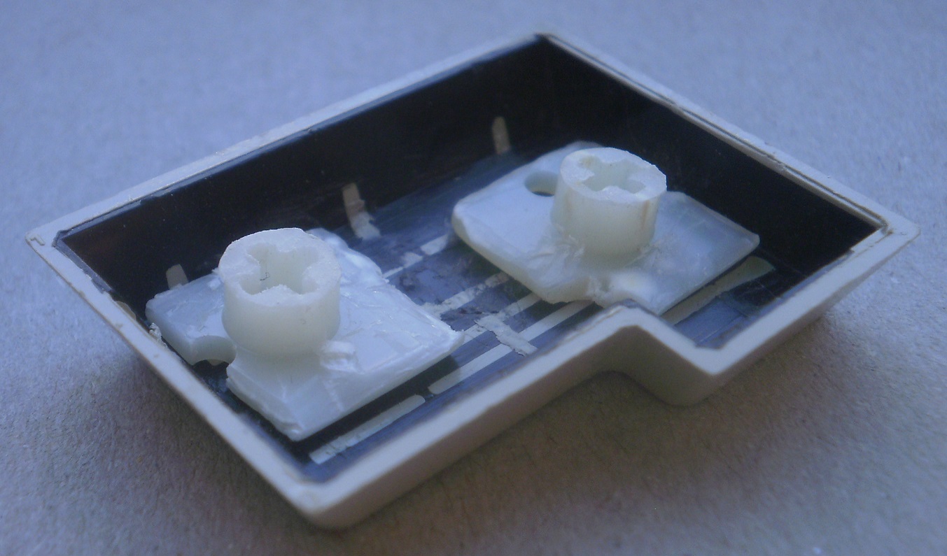

kbdfr wrote: [*]Big enter key: on my keyboard not the keyboard itself has been modified, but the keycap.
Explanation: the original (horizontal, C row) Enter key sits on two switches, only the left one being active (i.e. in fact programmed as the Enter key) and the right one being inactive, having no spring and merely serving as a stabilizer. To make it an ISO Enter key (what you call "big enter key"), the (D row) upper switch is programmed as the Enter key, the right lower (C row) switch is still used as a stabilizer and the left lower (C row) switch is programmed according to the national layout used (e.g. µ* for French layout, '# for German layout).
The stems of the Enter keycap have been modified to fit the location of the switches.[/list]

ok well CeeSa told me this is how kbdfr did it: The mod (enter part) for kbdfr is not only the switch/pcb part. He modifies the enter keycap too. He was able to "move" the counter part of the stem. Like mods for the spacebar.

CeeSA described to you the job he made for me.
At my request he left the switches under the Enter cap untouched, instead I modded the cap to fit them:
Enter key modded.jpg (236.09 KiB) Viewed 5063 times
That's quite an easy job (chop off the original stems, provide an even surface, glue new stems, done),
but of course it has to be made carefully.

Well, of course this is not always possible.
When a switch is in the way, you just have to move it.
In MID Tipro boards (which are basically ANSI) the Enter key extends horizontally over two switches, the right one being "inactive" (i.e. having no spring) and serving as a stabilizer. So now my ISO Enter key also uses this "inactive" switch as a stabilizer, but extends vertically over two switches.

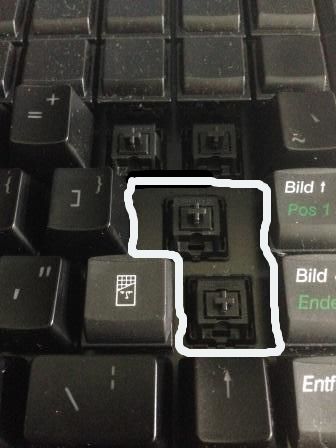

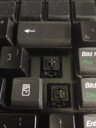

I am completely limited to tipro based keys for the backspace, spacebar, enter button ( covering two stems). I really need some high profile keyys that will fit the staggered layout of tipro ie just two stems over a 2 standard width as opposed to one main stem and two stabalizers either side.
Does anyone know of a high profile key that could fit the backspace, spacebar and enter key for this? I spent the past 4 hours or so debating a purchase of some beautiful pbt double shots to discover that the spacebar wouldn't fit ditto the backspace and enter key.
thanks kbdfr - I will have to desolder then to remove the springs at some point it seems . The current backspace and enter keys are much too hard too press.

Correct me if I'm wrong - kbdfr's enter key is it 1.5ux2ux1.25ux1u
I think I am going to order from signature plastics a 1.25ux2ux1ux1u as I know that would fit on the bottom (third row of my tipro) as there is only room for a 1 unit space there. I am not sure if 0.75 would look good at all. I might order a 1.75ux2ux1ux1u aswell as I might be able to fit a 1.75u across the top but I am unsure (I think it might)

rubberdome = any cheap rubbish keyboard ie dell Microsoft ebay £1 etc that way it doesn't matter to much while "experimenting" and no you don't have to use doulbleshots any will do
if I was going to do this modd I'd get a tipro standard 1u keycap remove the top part (with the symbol on it)
then using a dremel etc grind the stem in the enter key down until its flat inside
sand the tipro stem a bit to take the glue a bit better then glue then to the enter key
hope I've explained it ok easier for me to do than explain !!!!!
28 Jun 2014, 16:39
This is how I do it:
http://deskthority.net/w-a-n-t-t-o-b-u- ... t1956.html
It is not a good idea to use only a stem without at least part of the top of the key it has been taken from,
because the surface to be glued to the keycap would be much too tiny.
Before seriously starting, be sure to always have a try with the exact same components (keycap, glue and stem) you are going to use: not any type of glue will work with every kind of plastic.

I think that maybe signature plastics can move the stem mount to cater for the location of the tipro mounts. I am a little confused so I made this The 1.5u backspace key lines up with the 1u key as shown in the smaller picture. So my thought is to adjust the centre stem on the 1.25u , 0.094units to the right so that when it flips over it also measures up to the right perfectly. noting that sig plastics dont offer the 1.5u top with a 1 unit bottom iso enter.
The picture also shows what I am going to specify in the order code as to my backspace key.
I'm just confused how to specify how I want the stem of the 1.25u as centre 0.625+0.094 = 0.719units as they dont offer it. Also not offered is 1.106units right or 0.144units from right :s Or if I just specify right 0.094units. I also don't know how to order in two dimensions and if they can do this but I will just email them.
For the backspace I know it is option T and option 4
