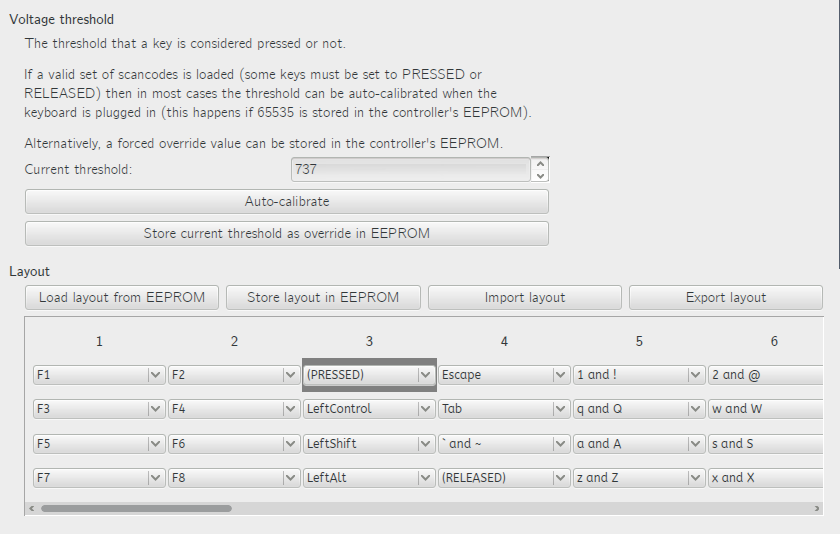

The GUI util to configure the controller is pretty much done. I need to get it compiling under Windows now (yikes here goes another 6 hour session compiling Qt5, why is development so painful under Windows?!?! One day they'll invent package repositories and /usr/lib + /usr/include.... </rant>).
I'll call this version 0.2. Nothing's really changed in the controller code.

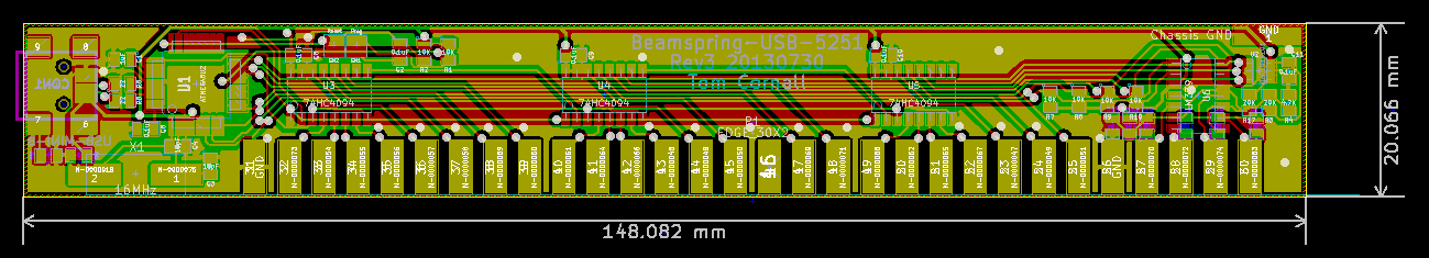

OK I've more or less done Rev3 PCB layout, which has a few changes from Rev1 and 2:
  • Surface-mount-hack mounting of edge connector, allowing board to lie flat and be used with 3278s etc.
  • Move to SPI-protocol DAC for Vref (trigger voltage); this in theory means that Vref can be changed per column or even key if necessary
  • Removal of pushbuttons for Program and Reset. There are test pads instead.
  • Larger HC49-style crystal instead of the special tiny thing that was used before. Saves some cost.
  • Solder-mounted chassis ground connection instead of massive through-hole hole
  • Last but not least---15% reduction in board size. Makes it a bit cheaper.
I really hope this will fit inside a 3278 (remember the edge connector will be soldered at 90 degrees to the board):
The DAC for Vref is interesting. I2C (that was used with the last DAC) is very slow and thus precludes changing Vref on the fly (if there was a dodgy column etc.). SPI is way faster (with 16MHz AVR the multipliers work out so we can communicate at 8MHz, instead of 400KHz max for I2C, although it was probably about 100-200KHz as we were bit-banging).
Unfortunately SPI DACs are more expensive, so instead of using a 12-bit DAC I went with a 10-bit. In theory this means we have a quarter of the resolution with Vref, but I'm using a three-resistor window divider to output between 0.8V and 1.6V (with 1024 possible values, so that's 0.78mV resolution) instead of before where it was outputting the full range between 0V and 5V (with 4096 possible values, so 1.22mV resolution).
The pushbuttons have gone as they are relatively expensive, take up a lot of board space (and we only really have one side now that the board is mounting `on-flat'), and are mostly useless as the controller can be reset into the bootloader for updating the firmware using the GUI util. I've left test pads on there so it can be manually reset by shorting out the pads with a screwdriver or whatever.
After I order this and make a few the next project is a Displaywriter converter---those are quite different from the other beamsprings, having 8 rows. They seem similar to a Model F controller in some respects.

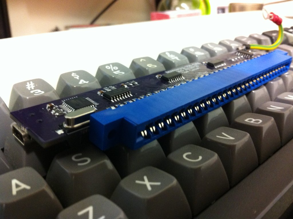

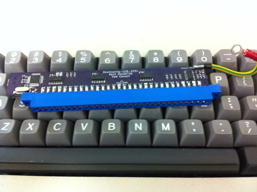

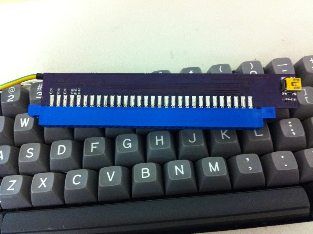

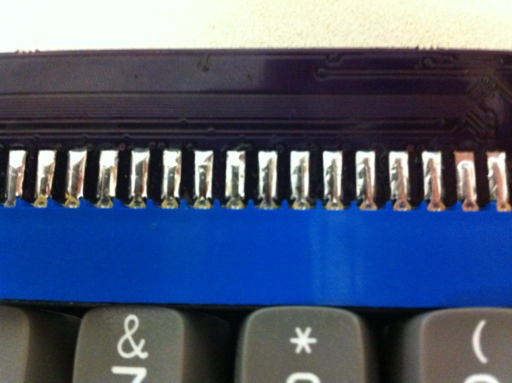

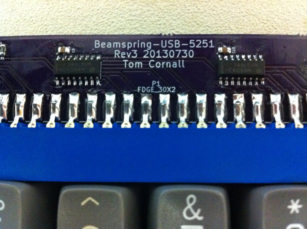

Have assembled and tested a Rev3 board with the flat mounting. Seems to work, yay! Had to write some ugly #ifdefs in the code to handle the fact there's different DACs on different board revisions and different pin assignments for the rows.
Not too bad to assemble. The connector was attached flush to the bottom, leaving a gap to the top-side pins. I tried bending these down with pliers but they need to be overformed so sprung back up while the solder was still molten. In the end I just pushed them down with a big hoof tip on the soldering iron and lots of solder. Ugly but effective.
So we now have support for 3278s. Next step is Displaywriters.
