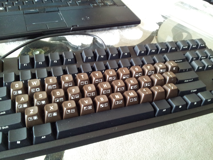

Yes sure you can do that. In
this picture you can get an idea of how it would turn out, board in the back is a Qpad with some C64 caps.

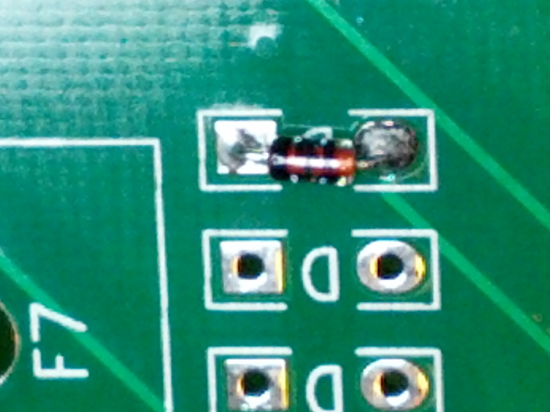

- Solder all diodes, direct the side of the diode with the strip towards the square soldering pad
- solder.jpg (205.56 KiB) Viewed 12656 times

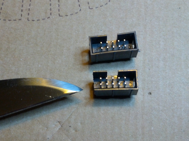

- Solder Contacts, one of the joystick sockets needs to be modified (PCB design mistake)
- solder-2.jpg (242.61 KiB) Viewed 12656 times

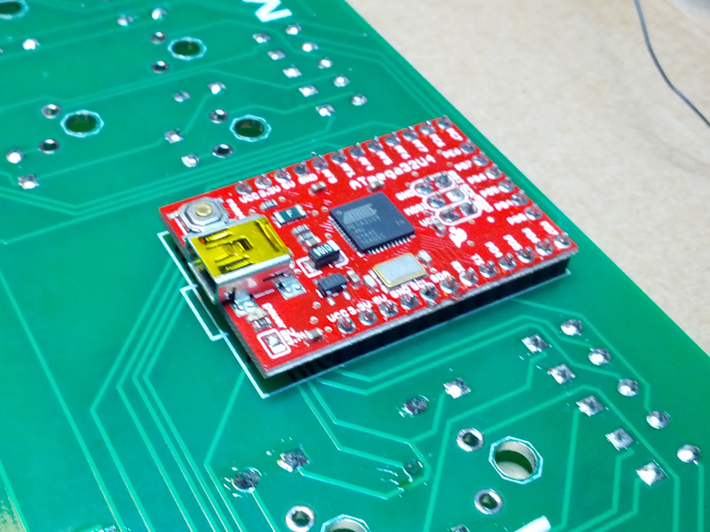

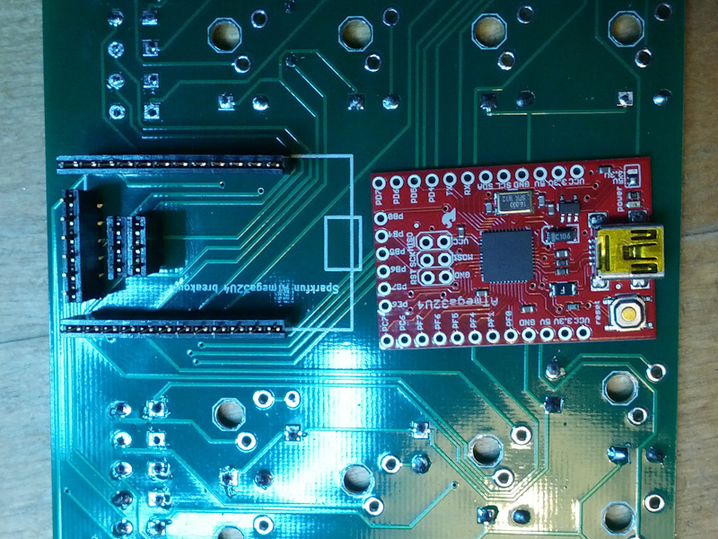

-Solder controller board or headers for it depending on if it should be removable.
not removable:
- solder-3.jpg (311.54 KiB) Viewed 12656 times
Put controller board and headers on PCB before you start to solder to get everything aligned.

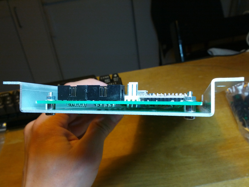

removable:
- solder-5.jpg (415.81 KiB) Viewed 12656 times
-Bolt the PCB to the mounting plate
- solder-4.jpg (209.37 KiB) Viewed 12656 times

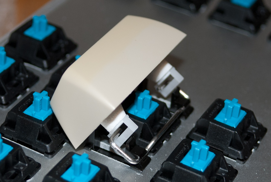

-Pull off all the key caps with a Filco style key puller, space bar has got stabilizers so be careful not to break it , take it of last so you have more space.
-Put on new stabilizers for space and return on the MeC64 if it's not already there.

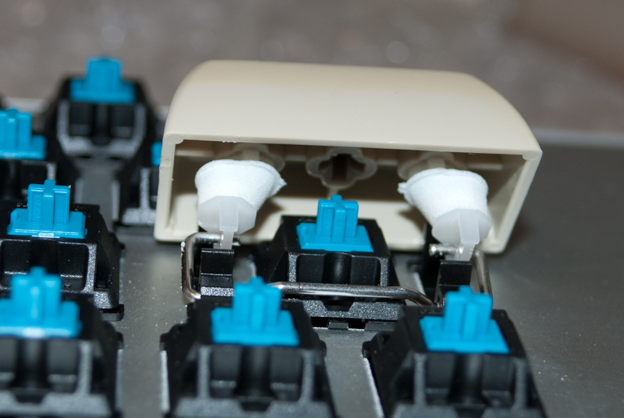

- Put the adapter in the switch and the key cap on the adapter and use the cap to push the adapter all the way down over the switch. If you can't get it all the way down you need to take it off again and clean out some more plastic dust. Put on the space and return pretty early as they are the most fiddly to get on and need space around them to do it. There are support legs for the 1,5u keys(shift, control...), just put them in the unused hole of the key cap.
Pictures of how the adapters for the return (and space) should be positioned. (the stabilizer thingy should stick out towards the back of the keybaord)
- return_key.jpg (225.46 KiB) Viewed 12656 times
- return_key-2.jpg (238.22 KiB) Viewed 12656 times

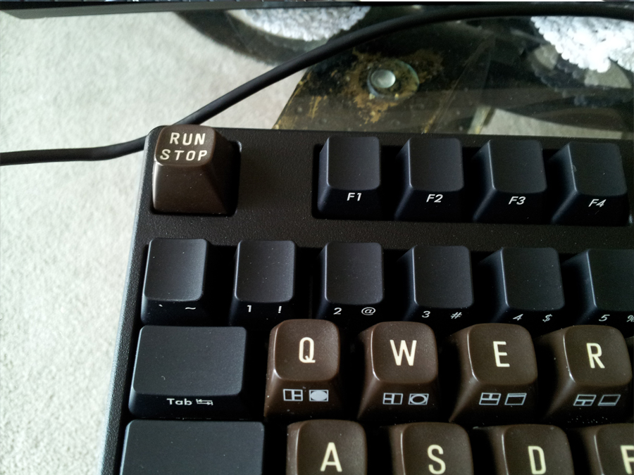

Got my keycap adapters from Shapeways. I decided it would look best if I just fill out the QWERTY area and leave the modifiers alone; I might add the numbers later.
- 20130315_125811.jpg (449.8 KiB) Viewed 12587 times
I wanted to use the Commodore logo key as my ESC, but its profile makes it look too weird; so I used the RUN/STOP key, which I think has a great vintage computer appeal.
- 20130315_125818.jpg (381.48 KiB) Viewed 12587 times

Turned out OK I think, doesn't look to crazy and the escape looks good. How is it to type on?

Not bad, I've been using it for about a day now. My fingers can definitely tell that the profile is off, but I love the feel of the C64 keys. It's weird for shortcuts, like CTRL+C etc, but I'm thinking of adding some modifiers, just not sure how yet.
