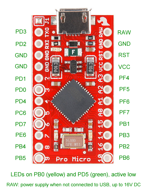

Are you planning on using a board per hand, or one board for both?
If you're planning on using two boards, the Pro Micro should be enough.
I would not recommend the Nano, as it does not use an AtMega32u4 chipset. The Pro Micro does, which means that software that is designed to run on the Teensy 2.0 board can run on it. You will have to look up the Arduino Leonardo / Micro / Pro Micro pin out to map the pin names between what the teensy uses and the Arduino uses, but that is it.
The Pro Micro does indeed not have a reset button, however this is not required.
1) With the default bootloader, it will stay in programming mode for 10 seconds (I think) when it is plugged in before booting the firmware that has been loaded.
2) You can wire your own switch on to it, all you have to do is connect the RESET pin to ground.
An added benefit of the Teensy and it's HalfKay bootloader is that it doesn't spend 10 seconds once it is plugged in to allow for programming. You have to explicitly either press the reset button, or short the reset pin to ground to allow you to program it. This could potentially save you a lot of frustration when trying to use your keyboard in your bios - Imagine being unable to hit the setup key due to your keyboard still booting!
Soarer
25 Jan 2014, 15:55
Pro Micro pinout with non-Arduino-weeny names...
