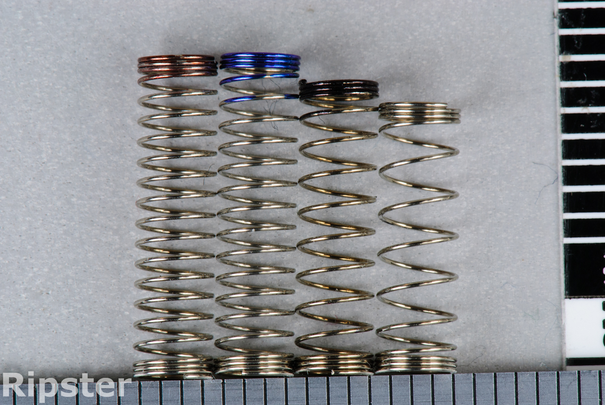

Springs COULD be different.
But what A Cherry Corp Industrial Engineering fuckup if it was. 3x the inventory headaches for NO change in feel.
The Internet hobby forums are FILLED with unsubstantiated rumours.
I call this the McRip Effect.

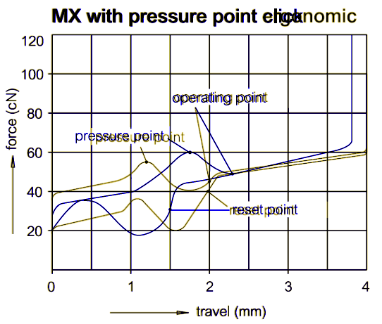

That is interesting.
But then the Cherry Corp graphs aren't all that accurate.
I'll dig up Silenciums sometime.
This seems to dispute it.

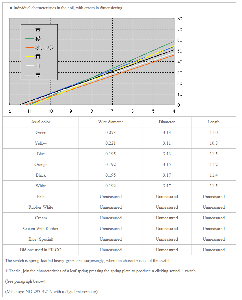

Those tests and my tests both found blue springs to have a slightly greater slope / spring rate, which actually supports what I'm saying.
True, not enough to give a 10cN difference at the top of the travel, even allowing for some error in manufacturing and measurement.
Yet the difference in the switches is noticable, so the graph isn't totally wrong.

Typical ripster. Realizes that the springs in his pic are NOT the same, and do NOT prove his point, so makes a different argument.
Why don't you put your energy into finding some other reason why blues are lighter than browns at the top of the travel?
itlnstln
- Location: San Antonio, TX
- Main keyboard: Noppoo Choc Mini
- Favorite switch: Cherry Brown
The easiest way to solve this is to get a handful of springs from blue and brown switches to see how they nominally compare, thus ruling out things like manufacturing variances. Seeing as the variance listed by Cherry is +/-15g.(right?), 1/2 to a full coil might not be out of tolerance.
