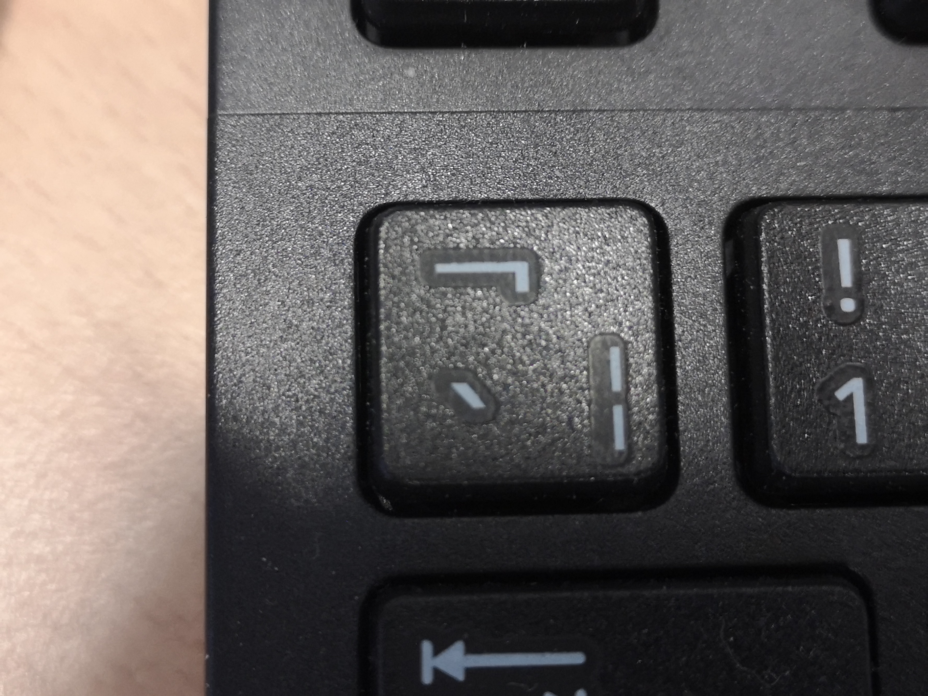

Also how do I make this key look like that in the layout creator website? The key in question is the one on the left side of Backspace.
Thanks.
Re: Key Communications keyboard Matrix Mapped need help with controller programming.
Posted: 27 Sep 2019, 12:49
by Anakey
I guess you would put the | key in the bottom right, though it will not matter for generating the keymap as that key itself is just seen as KC_GRAVE where the `~ key would be if on a US board. Windows would then translate that key into the regional graph.
