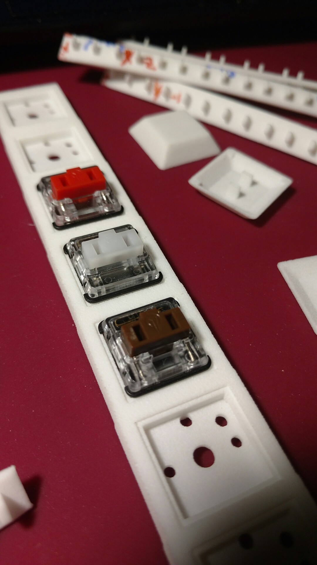

by suka
Got some samples in the mail today, thanks Matt3o!
They fit!
They fit!
First impressions are really good, as others aready mentioned especially the clicky white one provides a very crisp audible feedback. But the tactile brown one also feels quite nice, whereas the red one seems rather dull in comparison (but not at all by itself). When mounted in identical frames I'd put the regular Cherry ML somewhere between brown and red with regard to tactile feedback and perceived activation point.
But even though I haven't had complains of stuck ML switches during regular use in my boards it seems virtually impossible to get these new incarnations to produce any significant unwanted rubbing of the stems, even when hit at the outsidemost edge of the cap corners! The clear case top is also a very interesting detail...
Two observations I made: The clicky white switch has an additional wire protuding next to the led cutout which looks to be the end of the clicky wire? Also, this is the only one of the three that is absolutely silent when shaken, the others sound like some small piece of metal is moving around freely inside. I haven't investigated this yet by opening the switches, but this metal "ringing" can also be observed when hitting the switch in fast succession: Not very noticable, but gives it a very "cheap" sound when you're aware of it.
EDIT: After opening the switches it is apparent that the rattling does indeed come from the little u-shaped wires in both red and brown switches at the led side - after removal they're absolutely silent in this regard. It is not apparent to me what function the wire is supposed to fulfill as there is no obvious mechanism to it. The only thing I can imagine is additional support when pulling off tightly fitting keycaps, so the tiny ridges on the stem do not have to bear the full force...
Otherwise the design of the switch is very well documented in the datasheet: The four little hooks attach nicely into cutouts within a frame, making the switches ideal candidates for usage in 3D-printed frames compared to the original ML switches where press-fitting was always a thin line between loose fit and non-operation due to a compressed case.

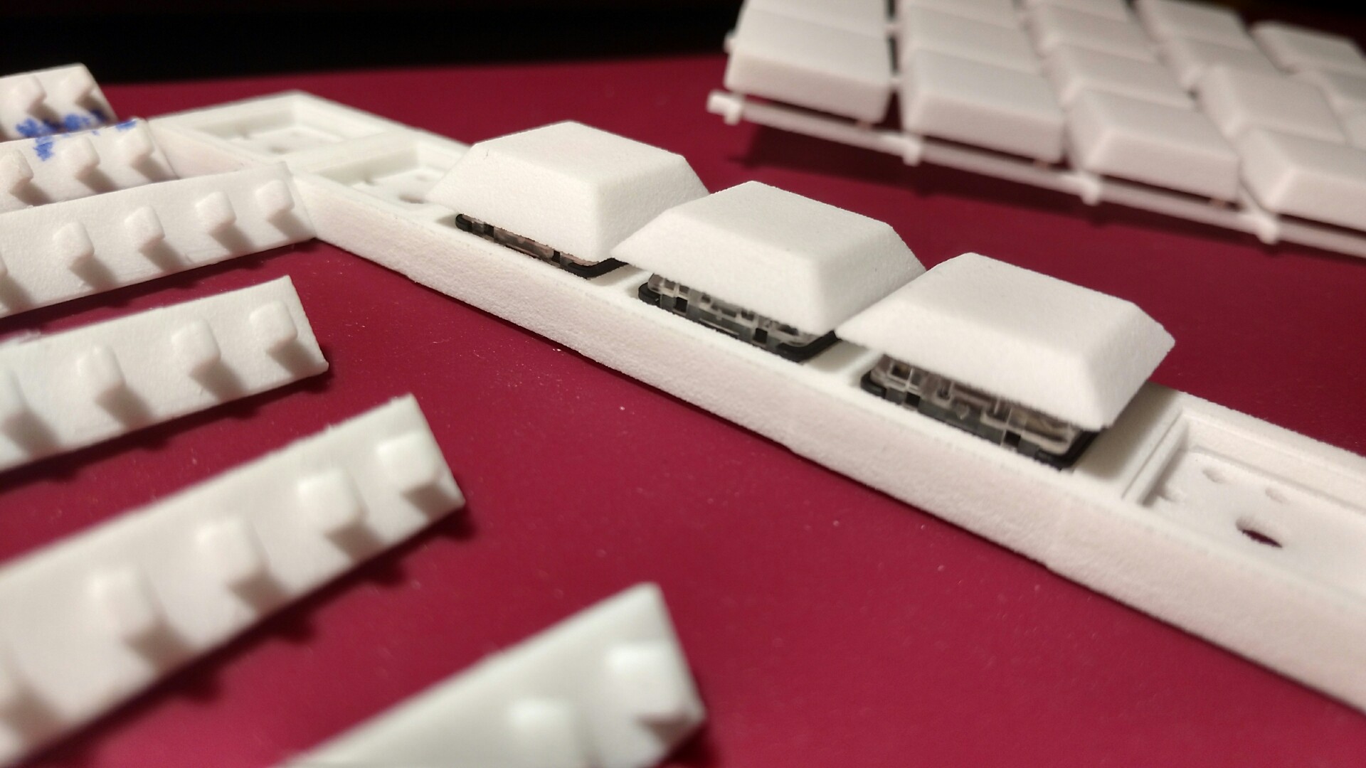

I'm looking forward to see these switches hit the market, hopefully not just in full boards but also individually. Finally an extremely low profile flat custom board looks feasible with usable switches :D
... and the caps too!

Oh wow, those little keycaps and holders are adorable suka! Do the switches feel much different mounted on them with keycaps?
Posted: 05 Dec 2016, 20:57
by suka
I find it much easier to compare them when the surface area at your fingertip is larger and the stem edges don't distract. But I'd say the individual differences are about as noticable as without. As I mentioned it is the very uniform feeling even when hit off-center that is much more apparent now compared to the original MLs (the brown can indeed feel a tiny bit scratchy when hit at a corner it seems, but nothing very noticable)
The rebound on the way back up with these very light caps is quite interesting, by the way: it is a little like a second tactile feedback, maybe due to the very limited travel to actuation.

suka wrote: It is not apparent to me what function the wire is supposed to fulfill
I believe it's there to prevent wobbling (especially when hitting the keycap not exactly in the center)
