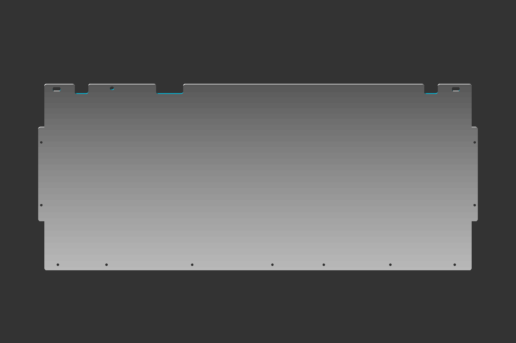

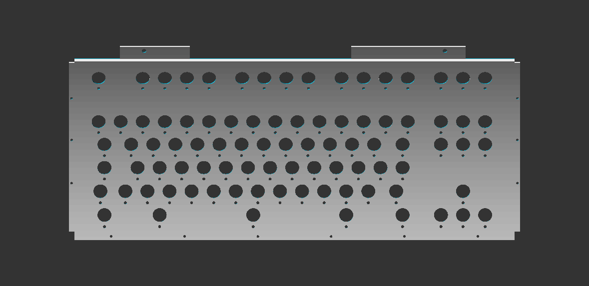

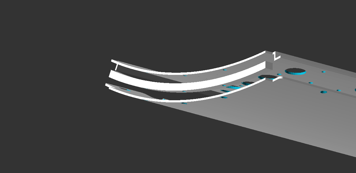

The backplate... The existing PCB presents an issue in regards to hole locations. We didn't want to use any of the holes in the middle of the PCB anyway, but I did want to use the top and bottom rows to secure the top and bottom plates together. The bottom row works well, but the top row will eat into the base of the barrels. We could notch barrels, but want to avoid that extra cost in production. I had planned on taking advantage of the 5.5mm space between the assembly and outer shell to add tabs that would EVENTUALLY secure the bottom plate of the INNER assembly to the top of the OUTER case (like the 4704 models) if/when we decide to construct a new outer shell. We are going to utilize those tabs to secure the top and bottom plate together (with a spacer sandwiched). This has the added benefit of keeping debris out, and can avoid foam decay as quickly like the previous F. Along with these new side tabs, we will leverage the ground plate screw location along the top of the PCB. This should be an elegant compromise, and leaves the PCB as it exists today.
If someone else could validate that the radius axis for the arc of the plate is ~300mm, I would appreciate since this part is the only "hard" math, and is critical
Front at an angle
Front at an angle
Front directly above
Back
Back
Side Profile
Side Profile

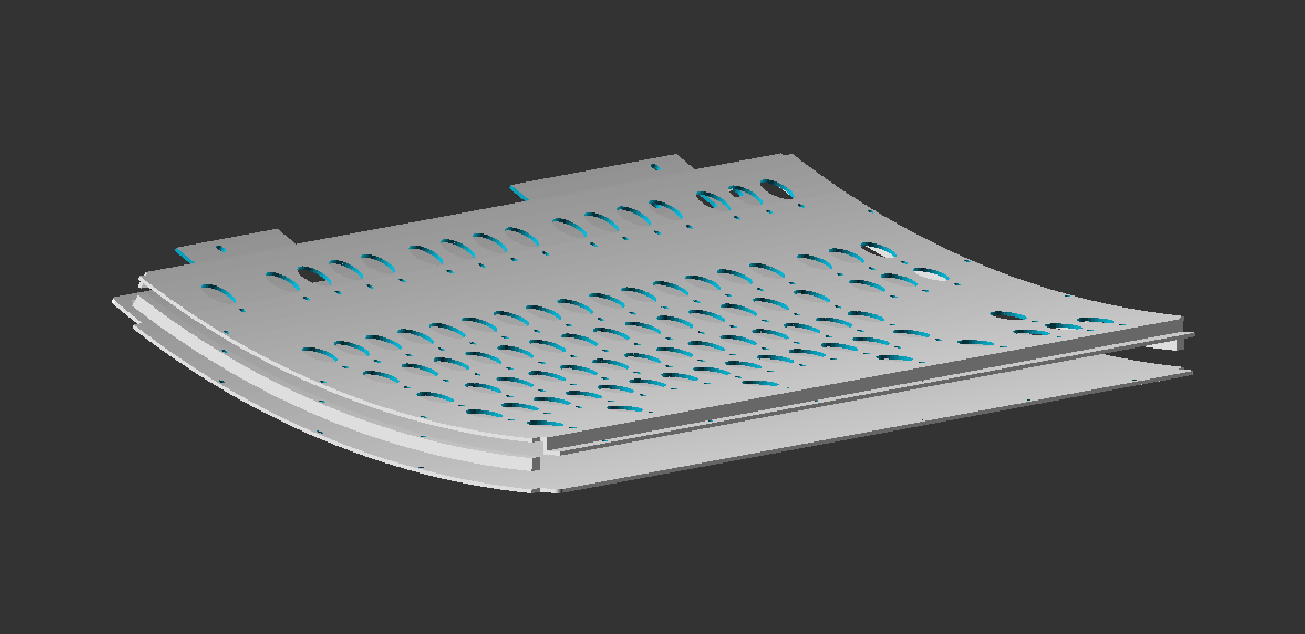

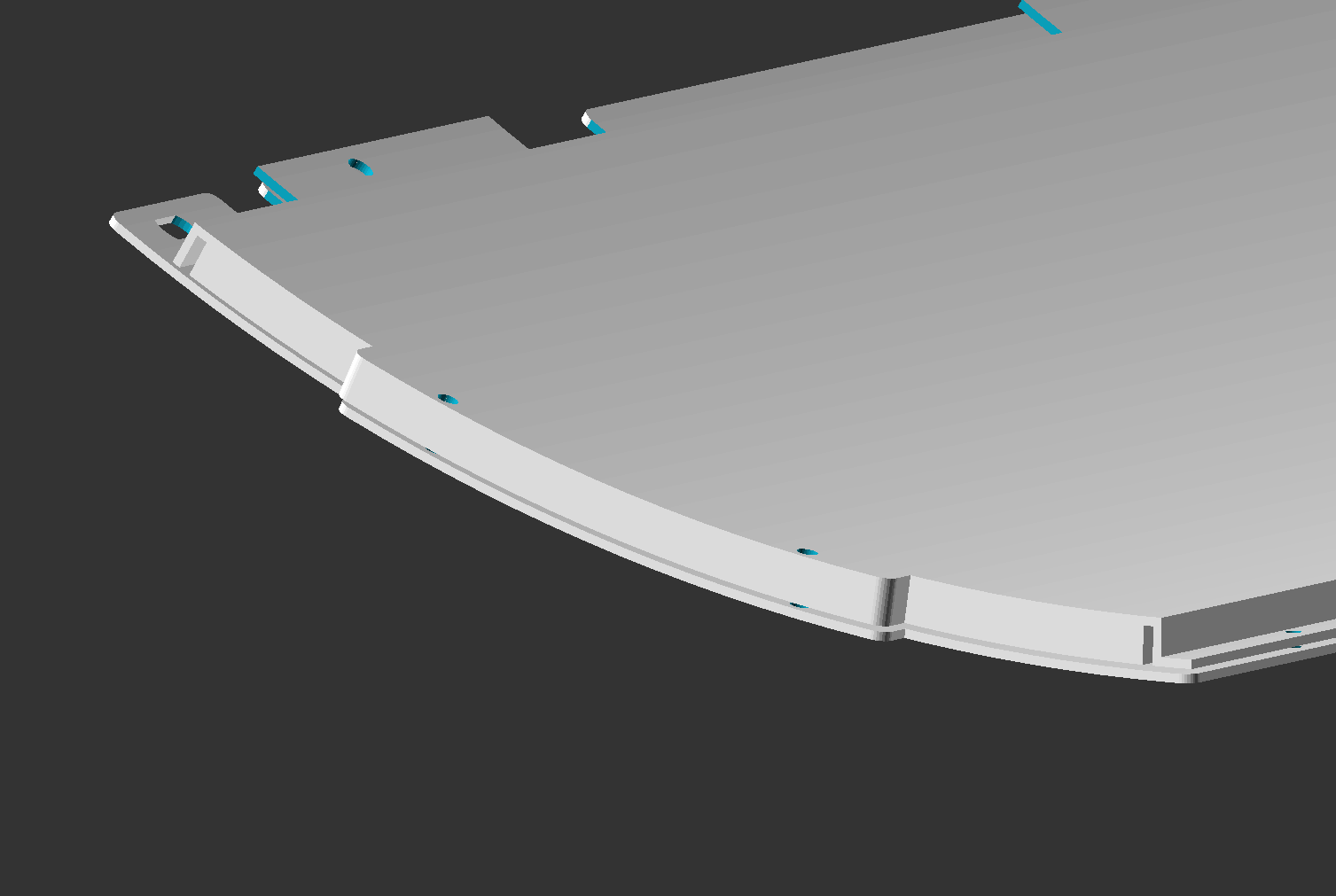

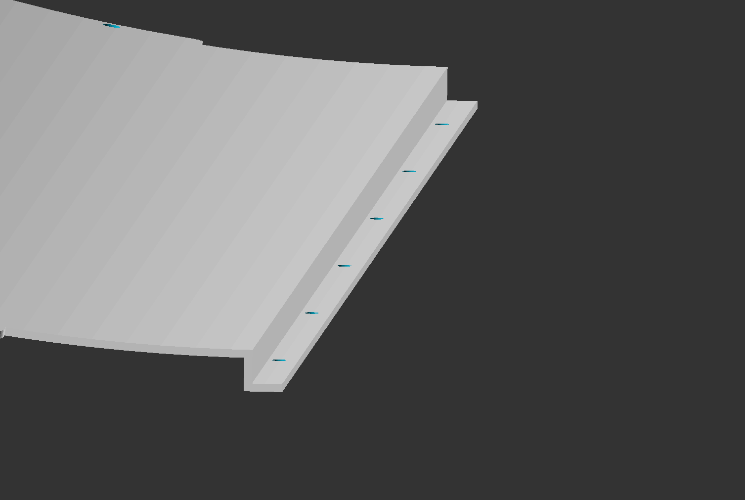

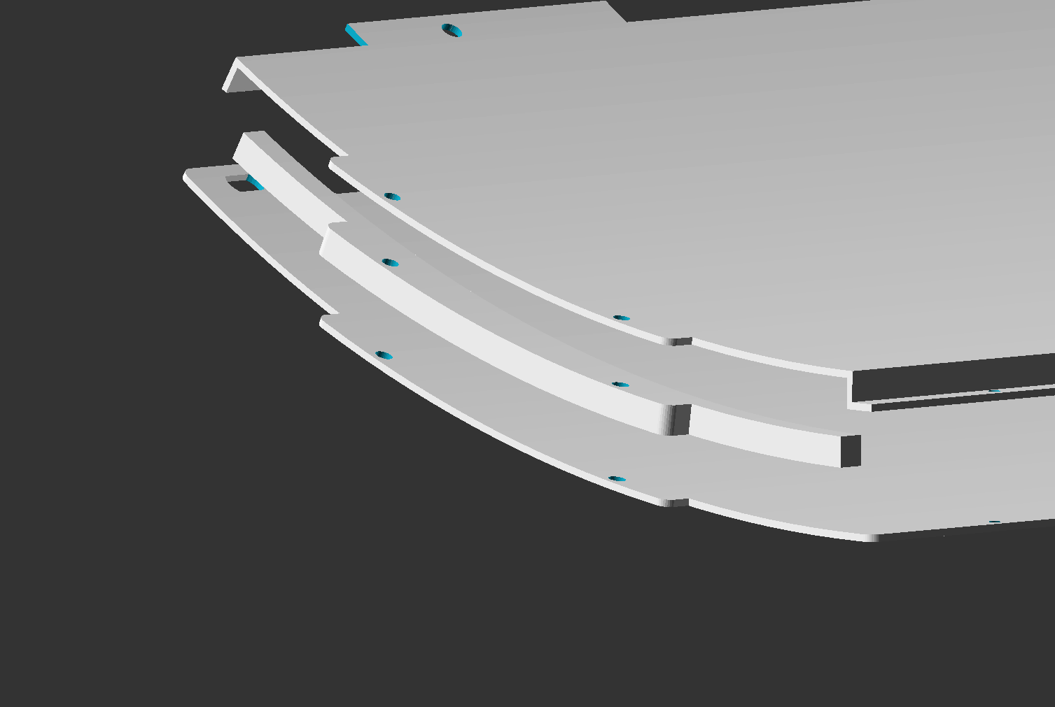

lot_lizard
28 Apr 2016, 23:30

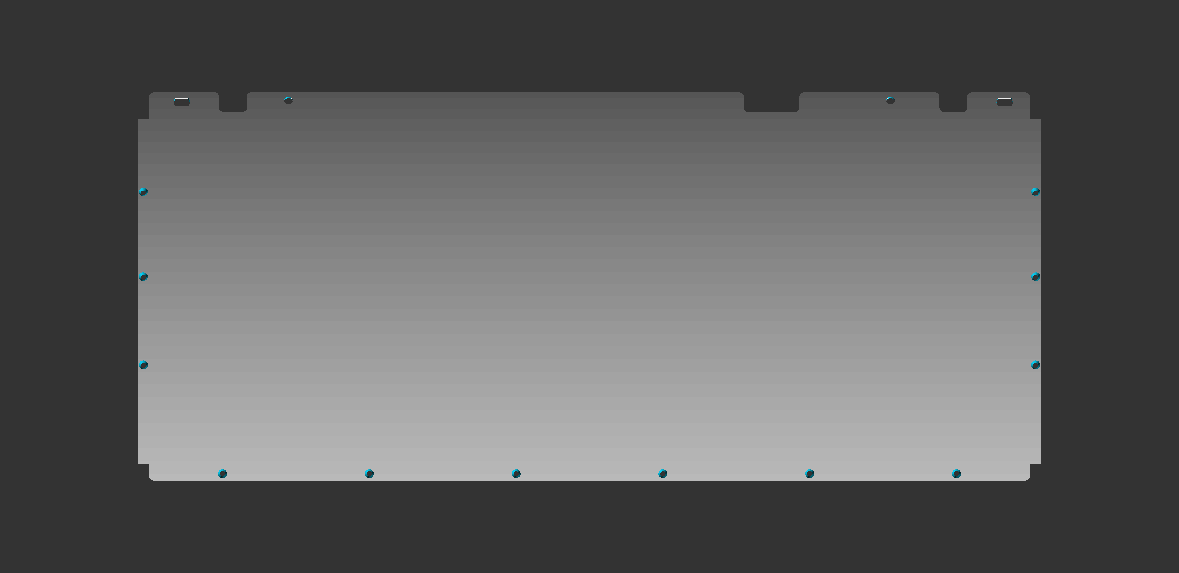

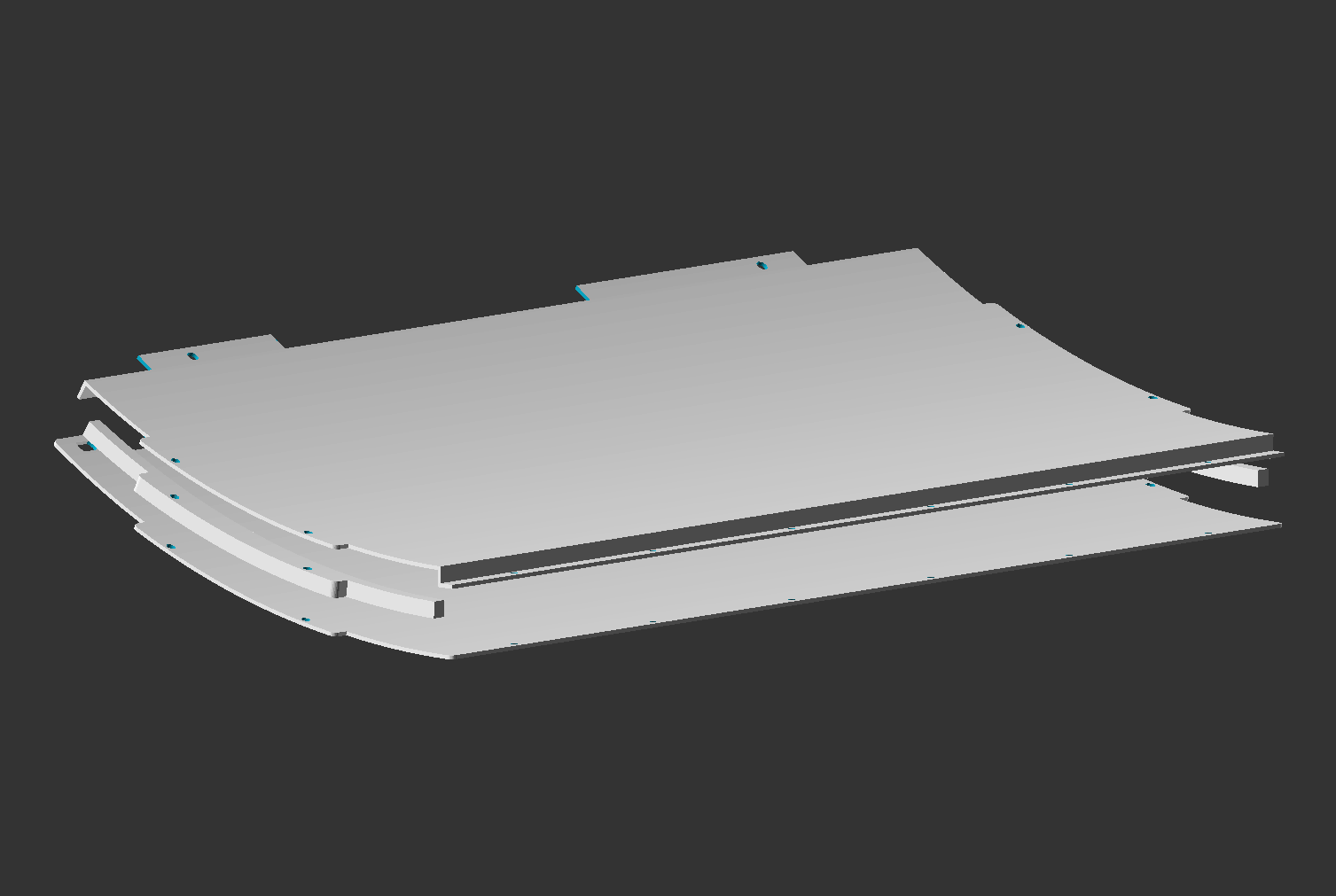

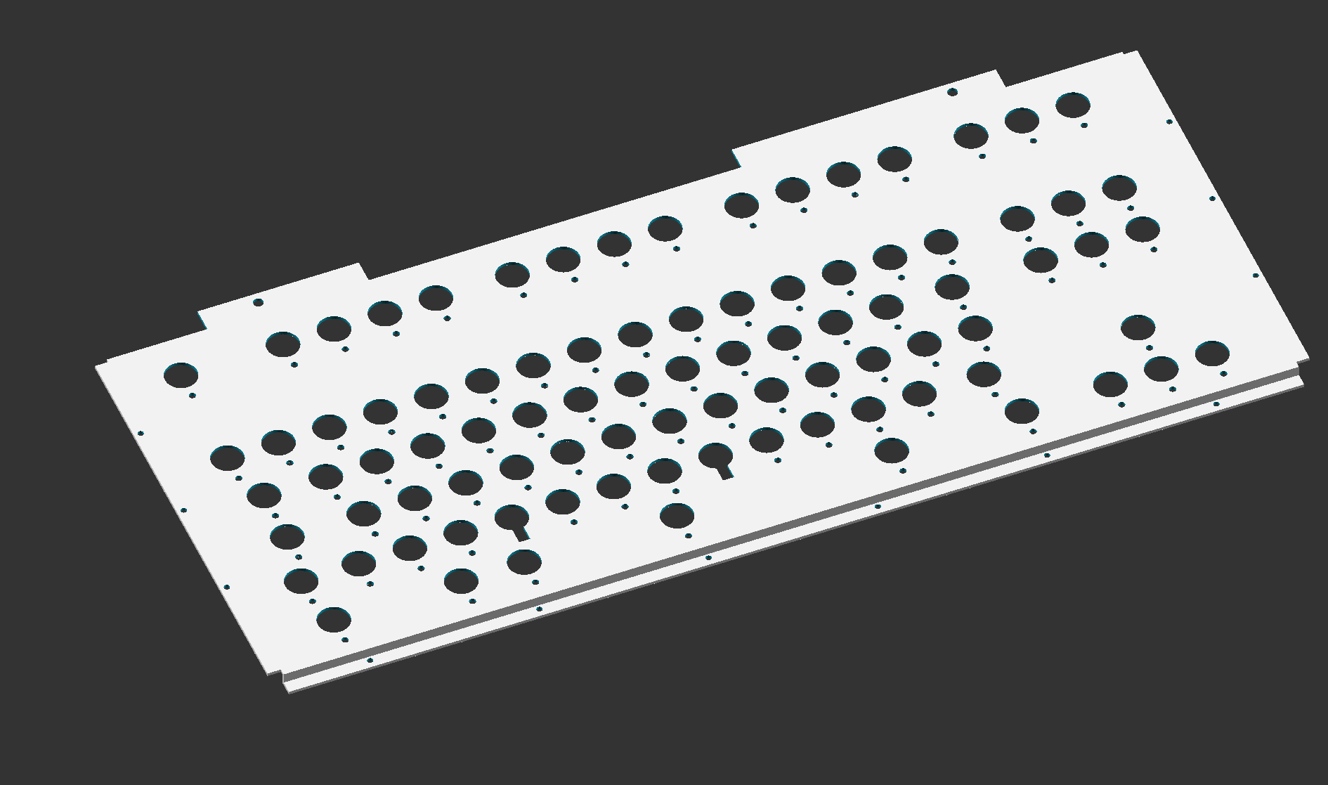

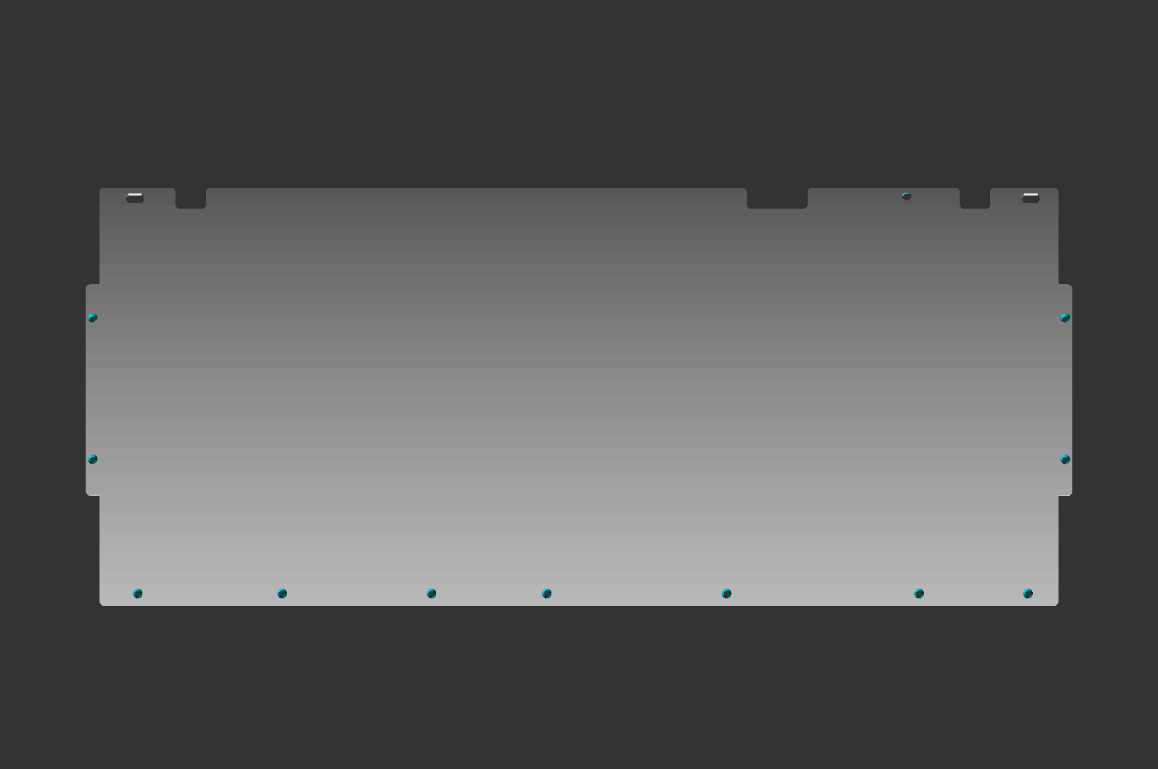

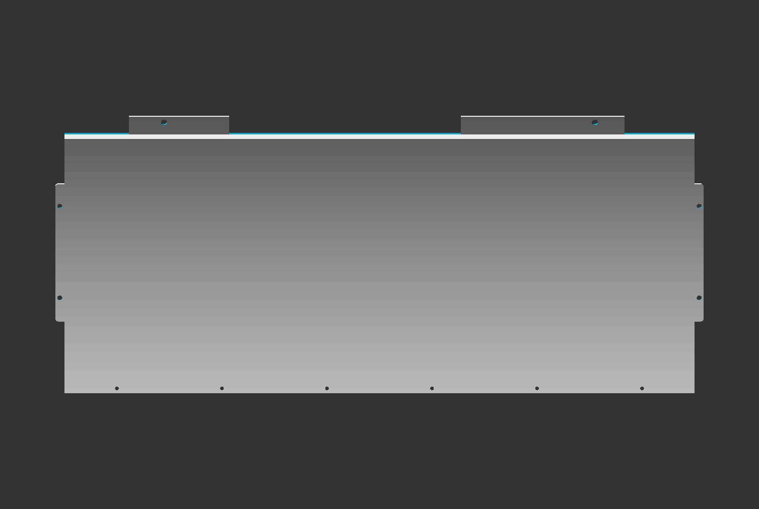

The start of the top plate with revised back plate. I ran into issues attempting to use the new PCB holes when trying to merge the top and the bottom. Essentially, the tolerances for the underlying barrels left no ideal options. So instead, I am floating the PC with an exception of two pass through points at the top. The model F only uses two rivets to hold the PCB in place (middle), and now that has been shifted that to the top. This allowed me to provide some barrel tolerances under either end (top/bottom) of the top plate that just weren't there before, and am very pleased about.
Also, I added the tabs to the bottom plate previously (see last post) for attaching the bottom plate to the top of the outer shell if/when we decided to make a case. I was able to take advantage of those tabs in holding the inner assembly together. We will have spacers on each side to allow tight torsion of the bolts, and also act as a better debris shield than the previous model F (just foam). It can be another plastic part we injection mold along with the barrels and flippers.
I still need to clean up the rounded corners of the top plate, and add the barrel cutouts themselves, but I am very confident of the fit as this point as a drop-in replacement
Top at an angle with spacing of parts for clarity
Top from directly above
Parts merged with the only spacing to simulate the PCB
New spacer/debris shield
New front end
New front end

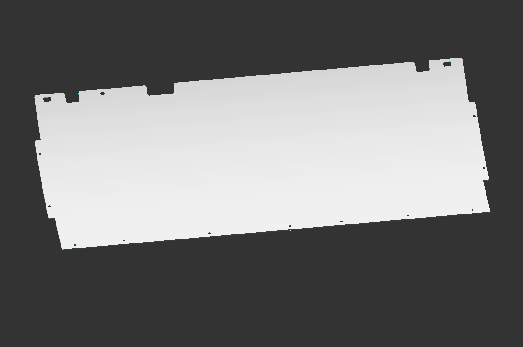

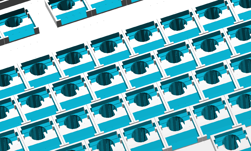

lot_lizard
29 Apr 2016, 19:06

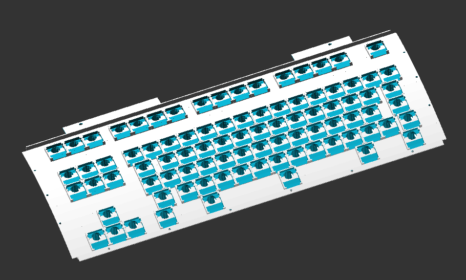

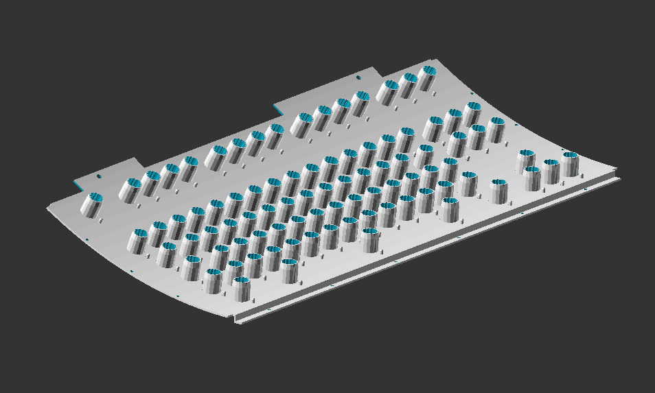

My last post for a while since I am taking over this thread, and that is not my intention. I have everything wrapped up. The barrels have been cut out of the top plate and "test fitted", the PCB was tested for fit, and I ended up modifying the tabs on the sides to account for everything. For this design, a hole will need to be drilled in the PCB at the top right corner (opposite of the ground screw). The only remaining pieces would be the foam, the spring for the flipper, and will likely have a blanket made to separate the PCB from the backplate even though it looks unnecessary from i$'s posts.
I will clean up the sharp corners, double check everything, and start checking on fabrication costs. At minimum, I will have a prototype made for myself :P
Top plate from above
With barrels
With barrels
Back of top plate with barrels
Same shot as above but zoomed to show barrel spacing
Bottom plate from below with countersunk screws
Spacer
Spacer
Duplicate of previous post, but to save someone from having to search
shreebles
Finally 60%
29 Apr 2016, 19:07
Holy shit. I don't have time to write a long reply, but you have my respect for coming up with all this.
Your posts definitely deserve more feedback.
Basically, you have created the files to make a drop-in replacement for an SSK case, correct? Without making any modifications to the original SSK?
lot_lizard
29 Apr 2016, 19:13
shreebles wrote: Basically, you have created the files to make a drop-in replacement for an SSK case, correct? Without making any modifications to the original SSK?
Correct... Also, the new side spacers will let us have different mounting options on new cases later (think longer screws coming up from the bottom that screw into the top of the case from below... like the 4704). We have options now :)
Khers
29 Apr 2016, 19:27
I'm liking this development a lot. One question though; wouldn't it be good to have some screws in the middle of the plate? From my own experience I know this is perhaps the most difficult area to get right when rebuilding an F. IIRC Fohat always screw mods his F keyboards for this reason.
Or perhaps I'm too ignorant about manufacturing and it's possible to make everything fit perfect when making this from scratch?
lot_lizard
29 Apr 2016, 19:44
Khers wrote: wouldn't it be good to have some screws in the middle of the plate?
It's very possible to strategically add some holes in the middle (and not hard to line them up), but not in actual middle of the board without modifying a few of the barrel bases. This was the real reason I added the spacers on the sides to attach the plates, even though the original F didn't have. I didn't show it, but the top plate will have a SLIGHTLY shorter arc radius (think more bend) than the spacer or the bottom plate. This will put more down pressure on the middle than anywhere else in the bend UNTIL THE BEND IS CONSISTENTLY FLATTENED TO THE DESIRED ARC.
We are actually substantially more secure than the original F's with this new approach because of the extra rigidity that bonding the plates with a spacer will provide
Khers
29 Apr 2016, 20:03
But wouldn't different pressures yield different key feel across the rows which would be unfortunate. I'm not sure whether anyone has actually measured the forces involved in keeping an F together, but my bet would be on trying to achieve a homogenous (or at least as homogenous as possible) pressure across the board. On the Model F, I think I'm right in saying that IBM went for something similar to what you are proposing, with different radii on the two plates, but I think it needs to be tuned to the foam and barrels.
I do agree however on that the screws represent a significant improvement on the original which was probably never intended to be taken apart by the end user, and it shows. :ugeek:

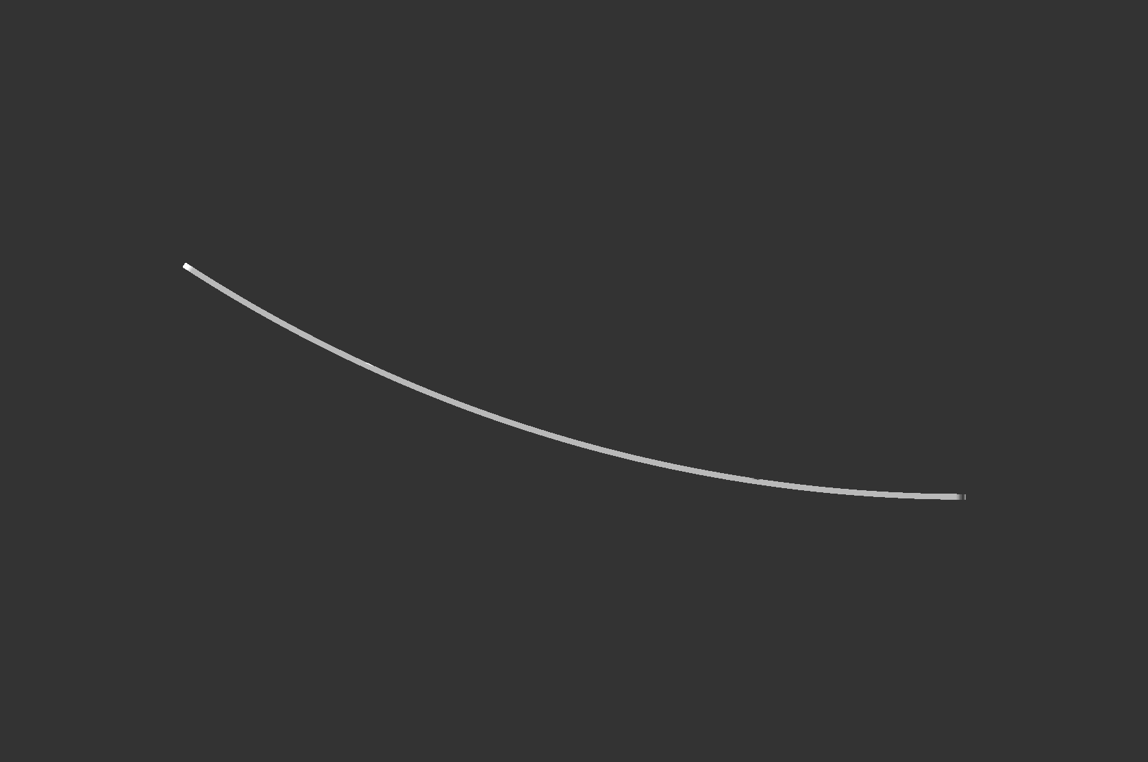

lot_lizard
29 Apr 2016, 20:50
I'm about to sound like a massive nerd... So I apologize in advance:)
Anytime you have a CONSISTENT arc of a uniform material, and it is bent against the arc (flattened) against a consistent opposing arc, the load becomes uniform. So the middle and edges of the arc would have the same pressures. In our case, the spacer (significantly rigid) and steel back plate would have the desired radial bend, and top plate (more elastic due to the addition of the spacer) would uniformly bend to desired arc. I'm actually in a meeting at the moment, but can Google some examples later. It has to do with elasticity and ellipticals/arcs.... It is actually important that they aren't the same arc radius to assure the pressures are consistent.
I edited my previous post with BOLD CAPS about the additional pressure part. I should have been more specific

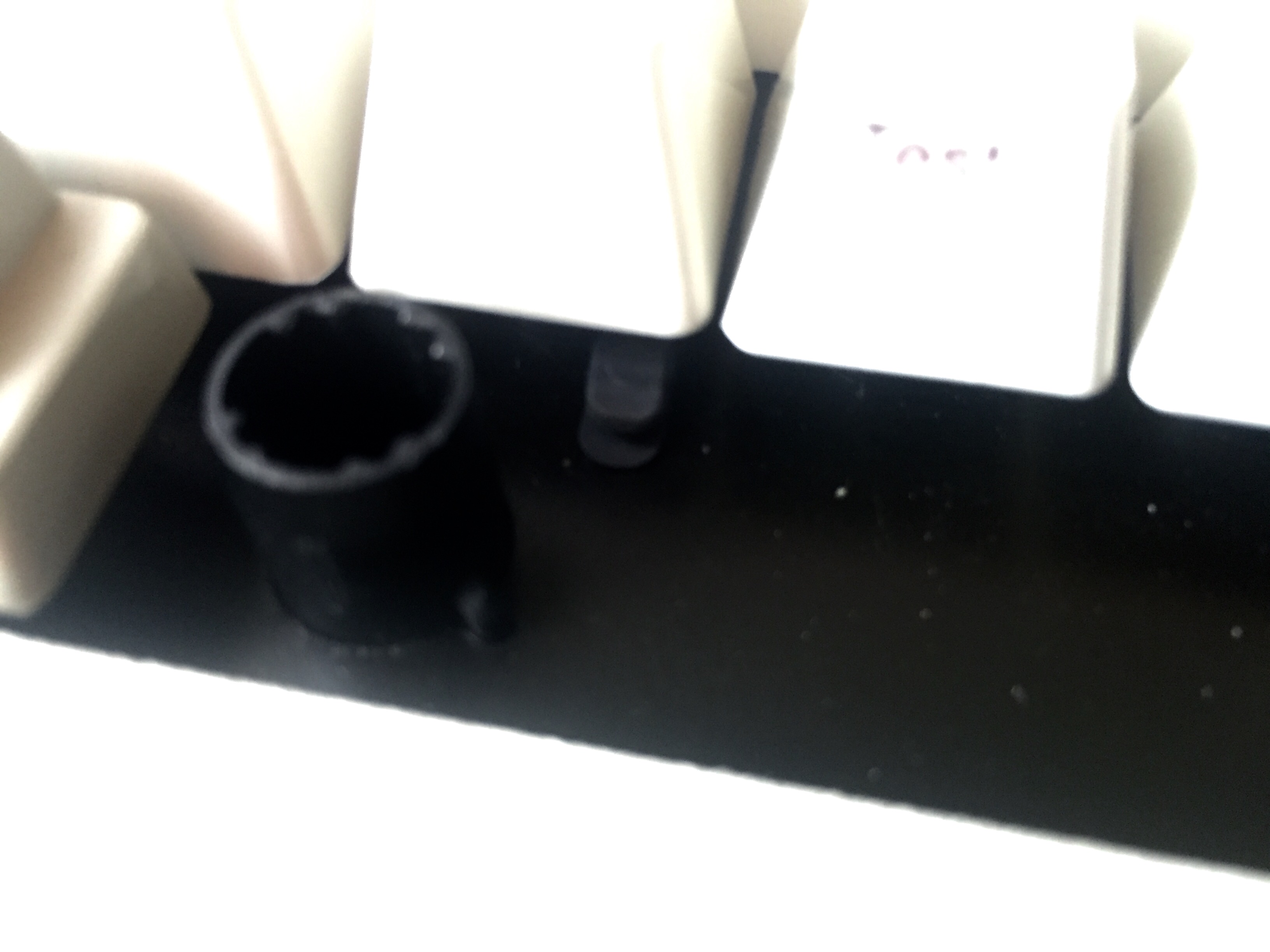

Ellipse metal clip: https://www.modelfkeyboards.com/wp-cont ... 2/tabs.jpg
I am assuming they are spot welding these into the front of the top plate. The only downsides to that approach are metal on metal (so it will need lithium grease or the like), and that the clip base is raised higher using the gauge metal he is. I'm not sure it really has any impact, but you are changing the profile height of the stabilizer bar somewhat. It will be a while before I see the F77 that I ordered in the first run to really understand what they did there. If the clip base was somehow slipped under the top plate through some cut, then it would impact the barrel base from the row above (doubtful they did that). The following is a horrible image shot from my phone of the Kishsaver clip (pressed plastic)
Kishsaver
Kishsaver
FullSizeRender (5).jpg (573.23 KiB) Viewed 6370 times
EDIT: Stay tuned... I have an idea I think I like better

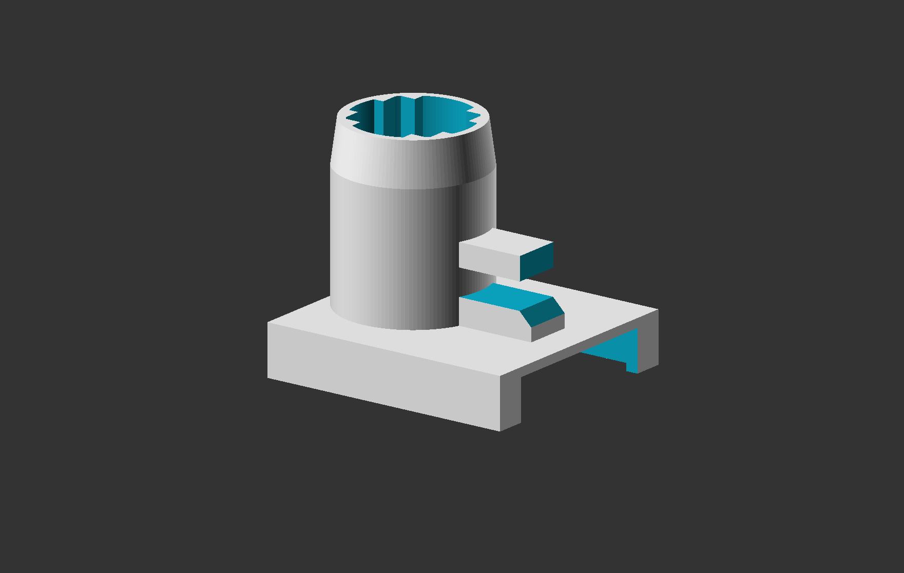

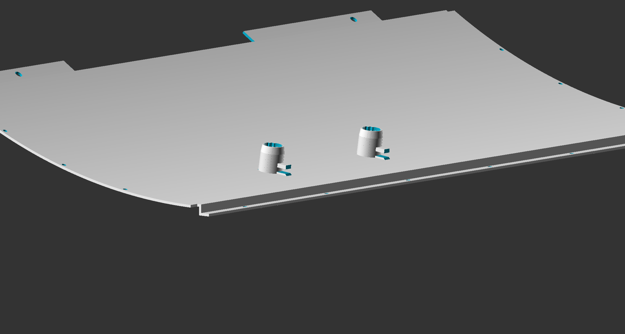

lot_lizard
30 Apr 2016, 05:01

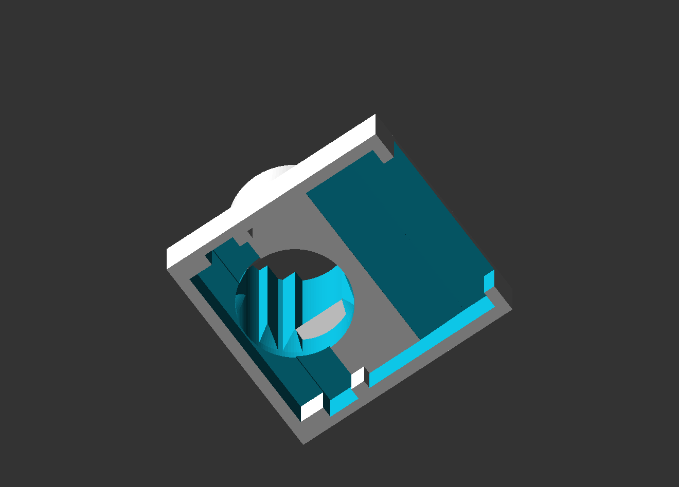

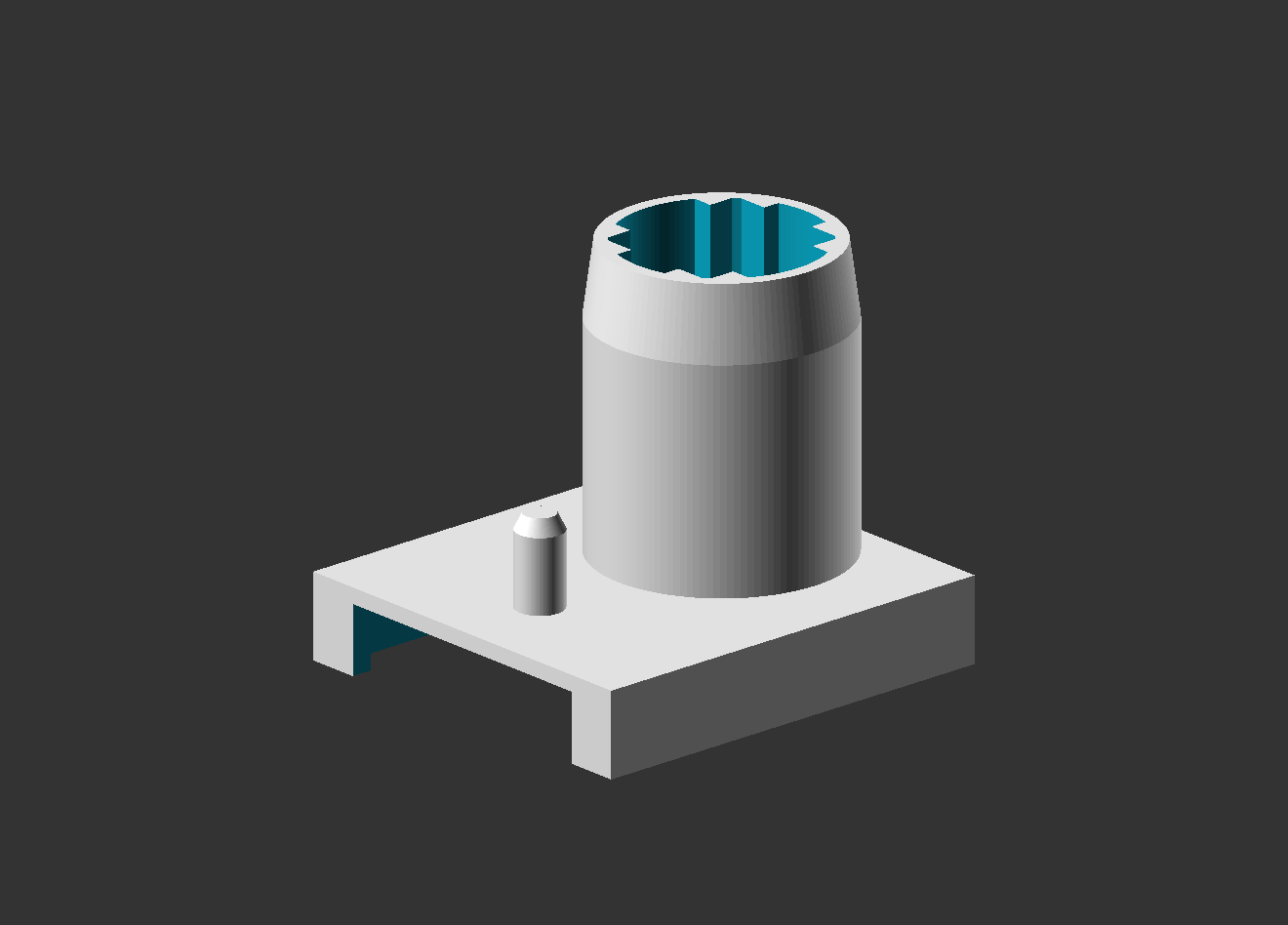

So I think this is the most elegant solution. It will require an additional mold for a barrel (which adds some cost), but eliminates manual effort to attach a stabilizer clip for the spacerbar spring... which would be a MUCH larger cost since we don't currently require welding of any sort. It eliminates all metal on metal contact, which is never good unless lubricated on some frequency (there is a reason IBM avoided it in the first place). It also makes the replacement cost and effort minimal should "events" ever arise since we will have PLENTY of extras produced on a group buy, and barrel replacement is easy.
The spacebar stabilzer stops (full travel) at the next row of barrels. The improvement requires a unique barrel used as both of the stabilizers (2 times total per board). It is substantially more stable than the original pressed plastic inserts in girth by approx 4x on the part that typically breaks, handling stresses much better.
The one downside (which I completely feel is mitigated)... it reduces the spacebar stabilizer width by one half barrel on each side. The previous approach would have been in-between the barrels in either direction. This should have MINIMAL impact on the stability of the bar.
Let me know your thoughts... NO seriously... I want feedback :)
Barrel with the unique clip
New barrel "inserted" into the top plate
Cutouts with the spacebar barrel and extra space bar (faux) barrel added as the stabilizer
Techno Trousers
100,000,000 actuations
30 Apr 2016, 06:56
I really like that idea for the space-bar stabilizer. But if it turns out to be too costly to produce a second mold for those barrels, I've heard good things about the use of neoprene washers over two barrels to act as the stabilizer.
