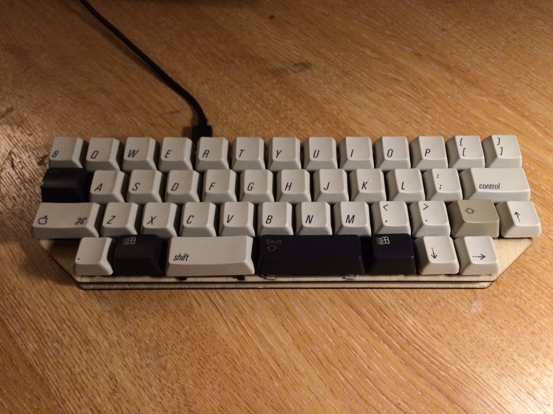

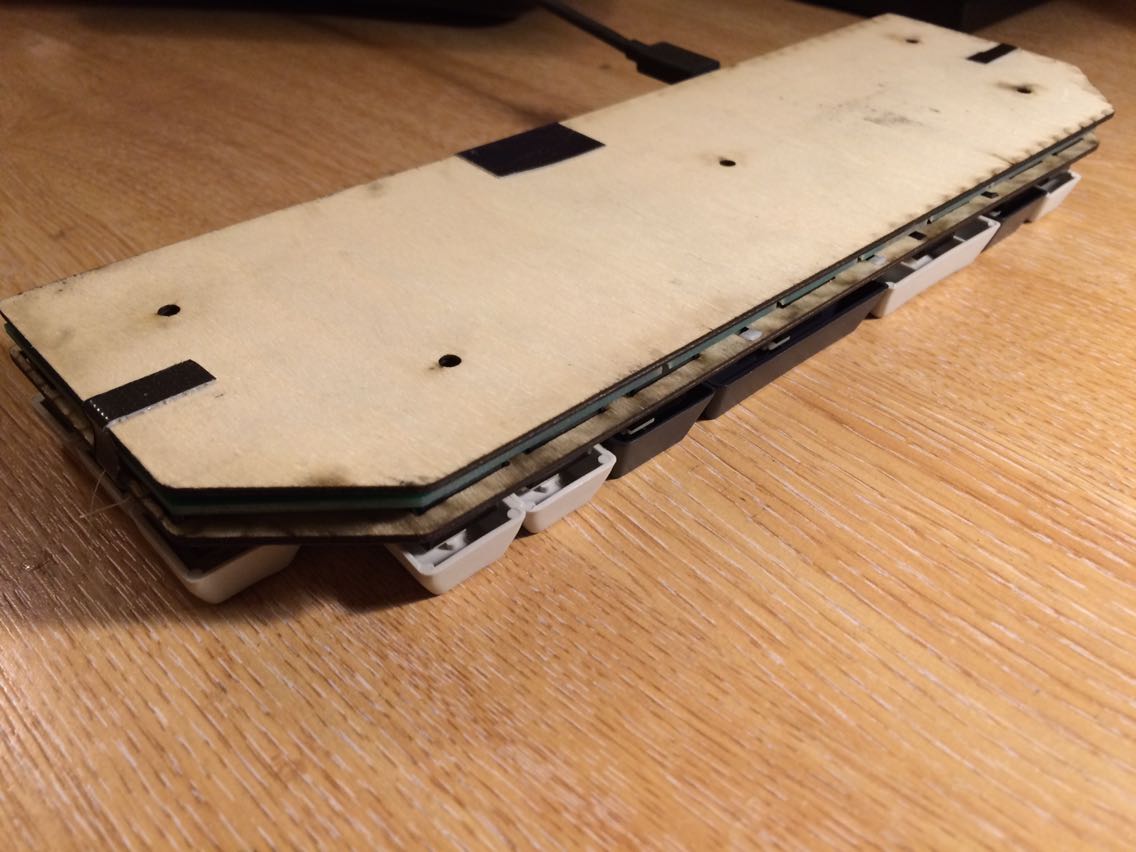

14 May 2016, 23:14
Mine with plywood plates:
I'm planning to play with the keymap later, but for now can I please know how to check the stock layout?

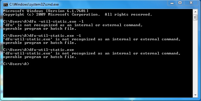

Second step: dfu-util. You can get a binary from here: dfu-util-static.exe. You can use this from the command line (get into one with <Win+R>cmd.exe<Enter>). Running 'dfu-util-static.exe -l' should list the STM32 DFU device (actually 2 of them).
I'm trying to flash the new keymap on win7, and I got winusb installed.
However for the second step, I got this error:
(dfu-til-static.exe is on my Desktop)
chuckdee
15 May 2016, 04:23
If it's on your desktop, it's not in that directory. Your desktop directory is c:\users\<username>\desktop
need
15 May 2016, 13:46
Thanks, the command works now.
However I didn't complete the whole process yesterday, which the keyboard still in bootloader mode. I connected it again today, it says Unknown Device, and it has no response at all when I hold the flashing button on the board in a hardware way. I tried uninstalling and disable the device, but it's the same result.
