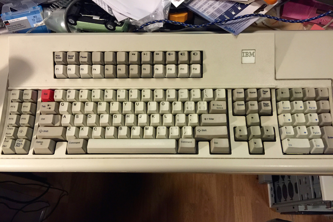

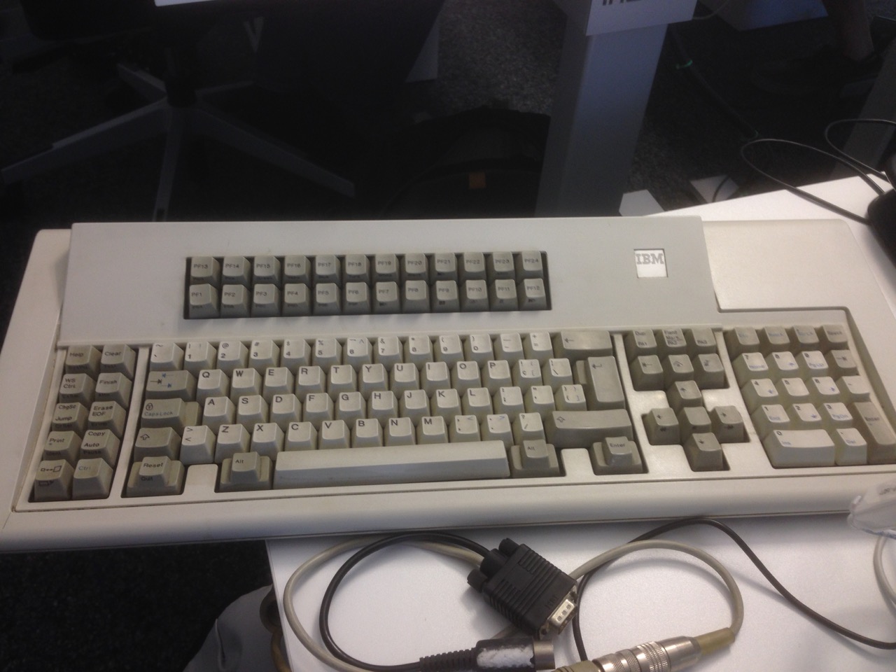

If you don't mind the size, the F122 is very close to modern keyboard layouts. The alpha area is pretty much winkeyless ISO and can be converted to ANSI without much pain.
This is how mine looked like when I got it:
And this is how it looks now:

Wow Jou thats a nice 122 you got there! How did you remap those keys like that? And is it difficult to do? I really like how the shift and control are back to normal and your f keys are up there.

Its depends on what conversion method you use. If you use a replacement controller there is a nice GUI to change it.
The reason for replacing the foam is that i can degrade over time and lead to a less tactile feel. I have never bothered myself all my foam has been ok.
Most of the time the existing foam is fine , but if you are in there anyway then you may as well change it if needs it.
The layout is very easy to change , its just a case of switching the springs and flippers and putting new caps on it.

I recognize those key caps jou! Very nice!
You can also do this to an M122 but it will require a bolt mod. Much easier to reconfigure an F122.

Mine has a Arduino Pro Micro clone stuffed inside with Soarer's converter flashed. Remapping the keys wasn't very difficult once you get a hang of it (I do deal with code and configuration files on a daily basis, so take "not very difficult" with a grain of salt ;) ). If you get stuck, you can ask for help here.
Physically rearranging the keys was a bit tricky but not unsurmountable, even with my mediocre mechanical skills. fohat has a detailed guide on how to do it.
I haven't replaced the foam mat, but I probably should do that soon. Exposed foam parts disintegrates when I touch it and the page down key gets stuck sometimes. Plus the barrel plate has a bit of rust, so I'll also need to repaint it while I'm at it.
