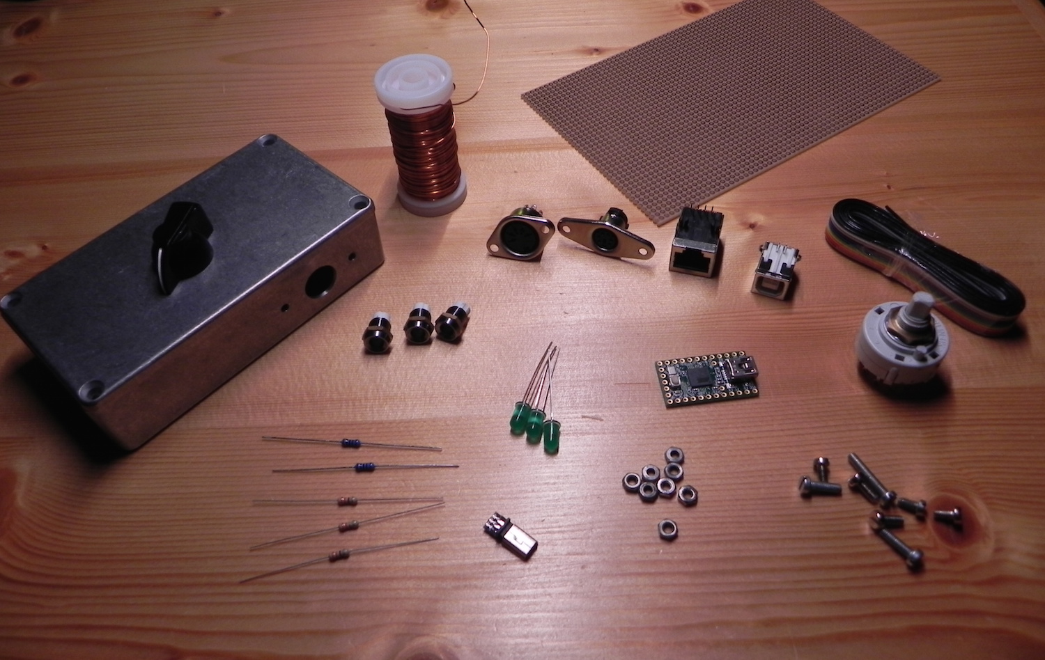

Sneak Peek:

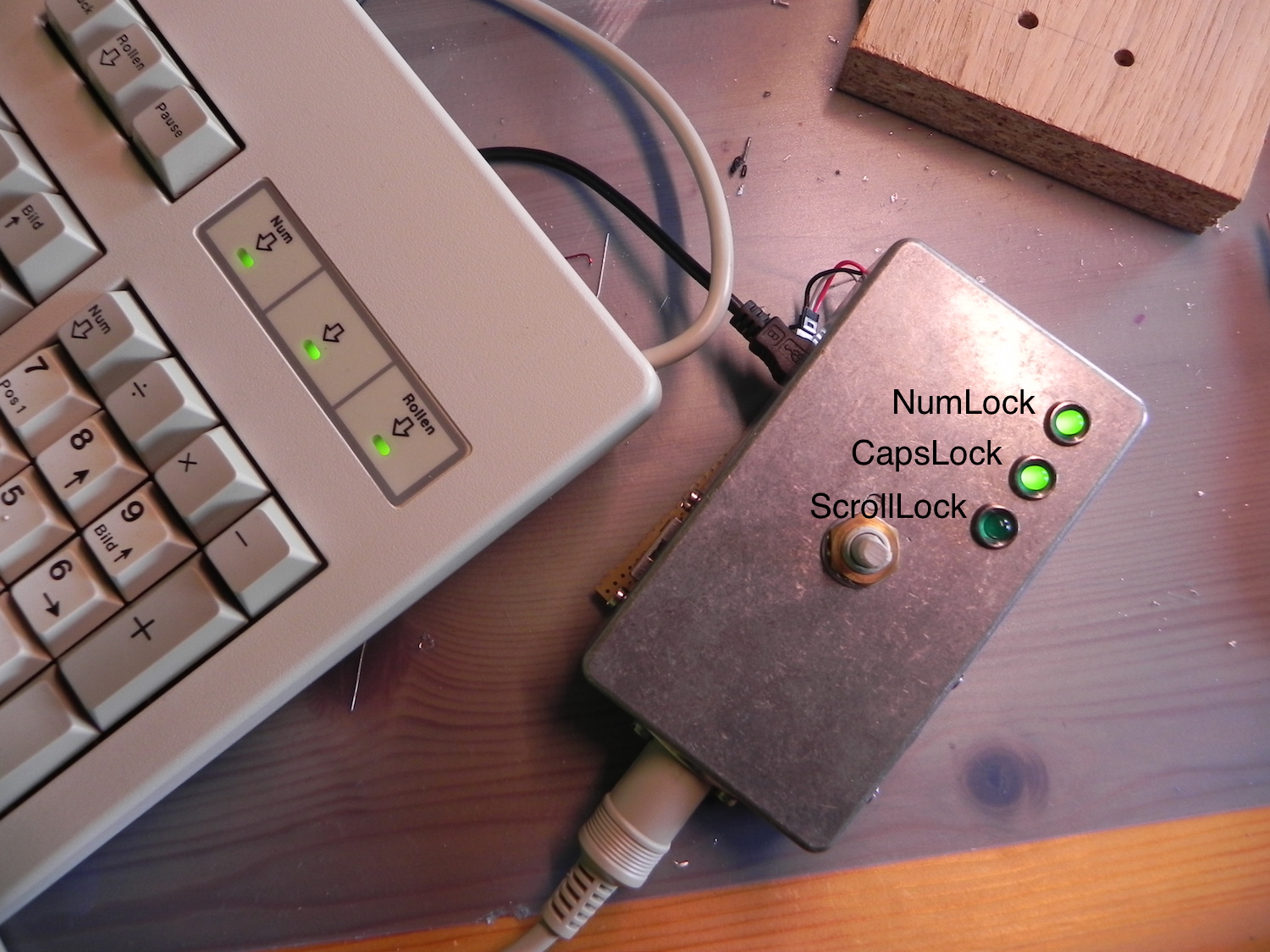

Here's were I'm currently at:
Keyboard shows NumLock LED, converter not so much.

How exactly did you hook them up? Do they work with an external 5V source and the resistors you used? No you don't have to activate them in the software config.

Thank you for the help Halvar! I checked the wiring again and noticed that I had the LEDs connected to RST instead of GND.
The LEDs light up now!
Except for ScrollLock
I have to investigate further...
EDIT: Got ScrolLock working.

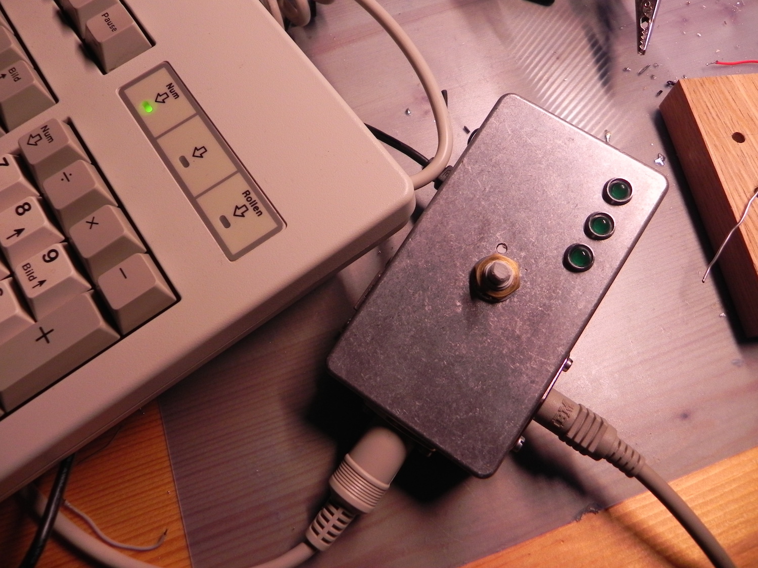

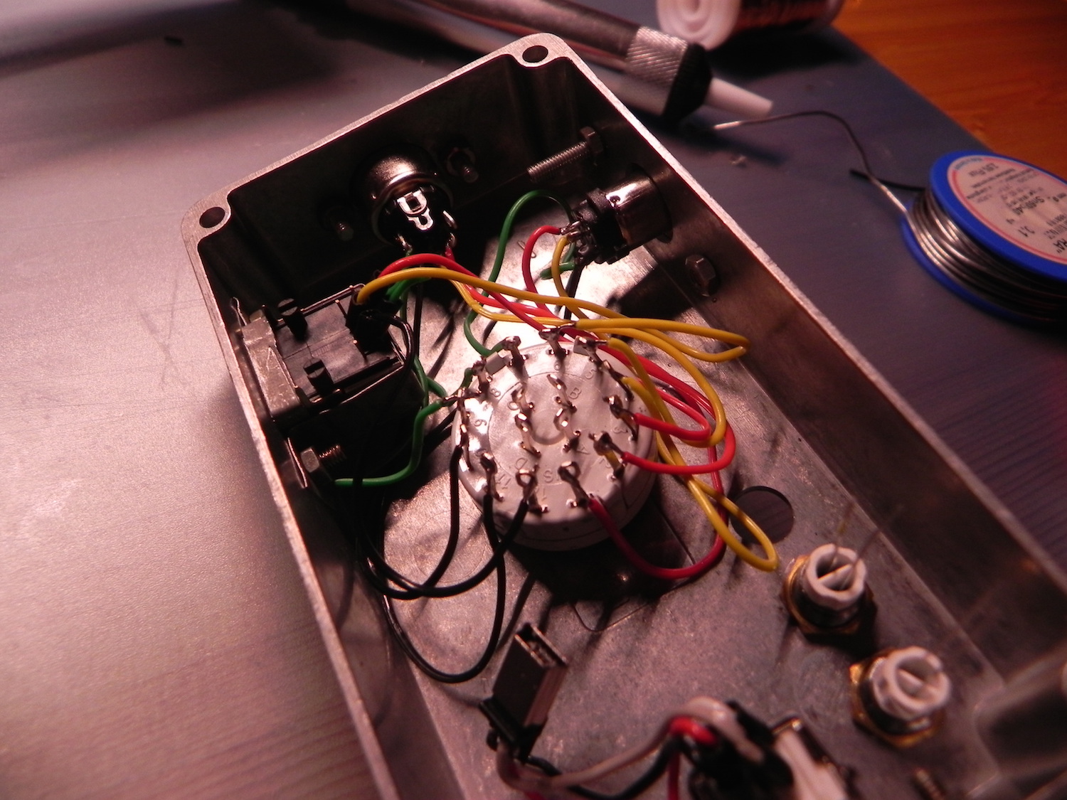

I'm still working on the automatic part. I haven't yet closed the metal box (you can see the circuit board lurking in the picture above).
At first, I thought about replacing one of the Lock lights (ScrollLock came to mind as one of the less often used indicators) with the internal LED pin of the Teensy, which the firmware uses for debugging purposes, but then I remembered that I can use the Lock LEDs for many useful purposes, at least on Linux. For example, I'm using two layouts (US QWERTY and QWERTZ) and ScrollLock shows me which one is currently selected.
At the moment, I'm working on a Macbook and was a bit surprised when trying to test the Lock indicators. I had to pull out an old Windows laptop from my parents in order to do proper testing.
