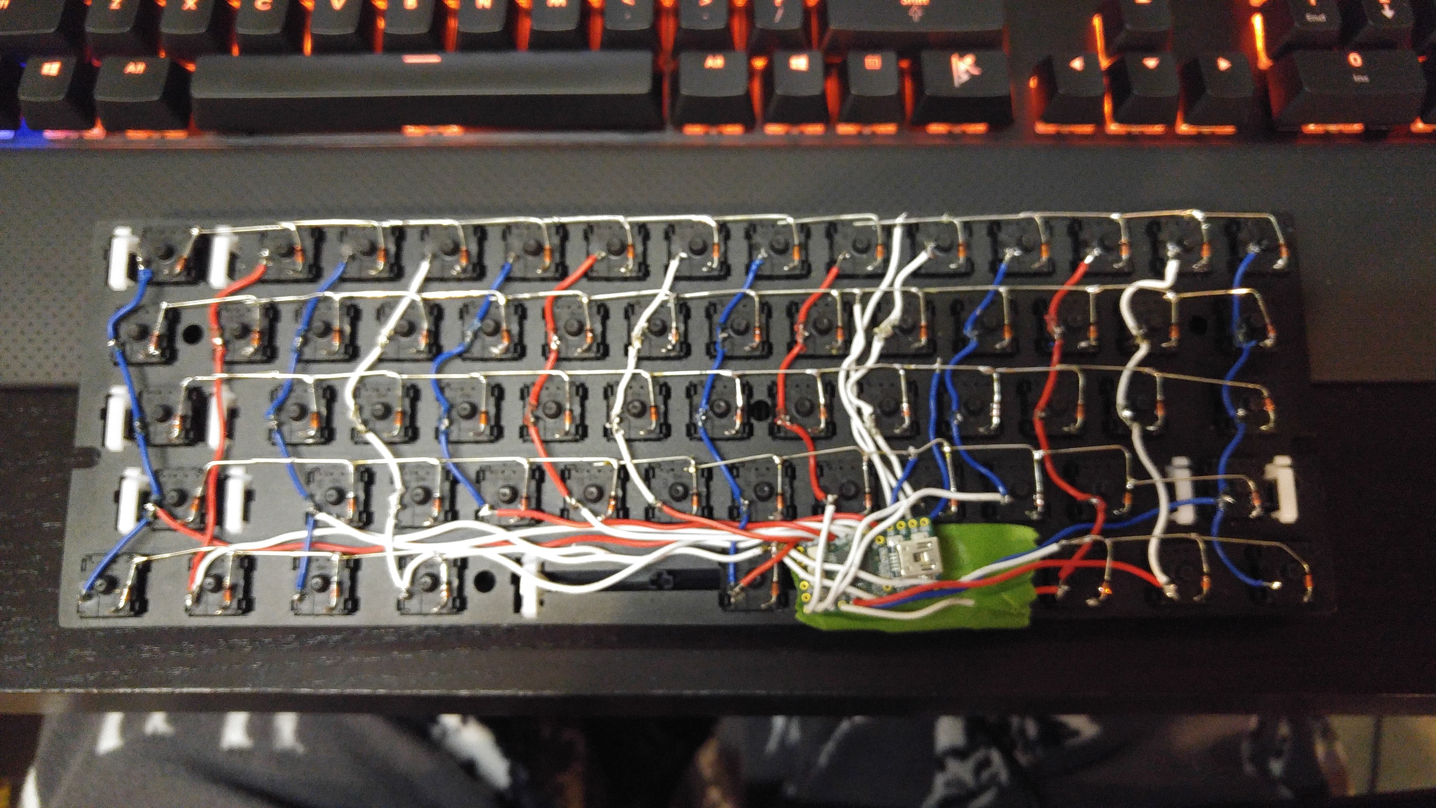

campo123456789 wrote: and when a key is pressed it is inputing all the keys in that column rather then just the one.
Can you show your wiring? Is outer part of diodes black when you solder it?
campo123456789
20 Jun 2016, 13:47
i don't think so i have checked over them again but here is what they look like (please excuse the large blobs ) do you think that code it ok? i don't have an led either for the caps if that changes anything?
https://lh3.googleusercontent.com/5Lmz1 ... 53-h927-no
redesigndavid
20 Jun 2016, 13:51
I think I had this problem once. In my case, what was supposed to be columns were my rows and vice versa.

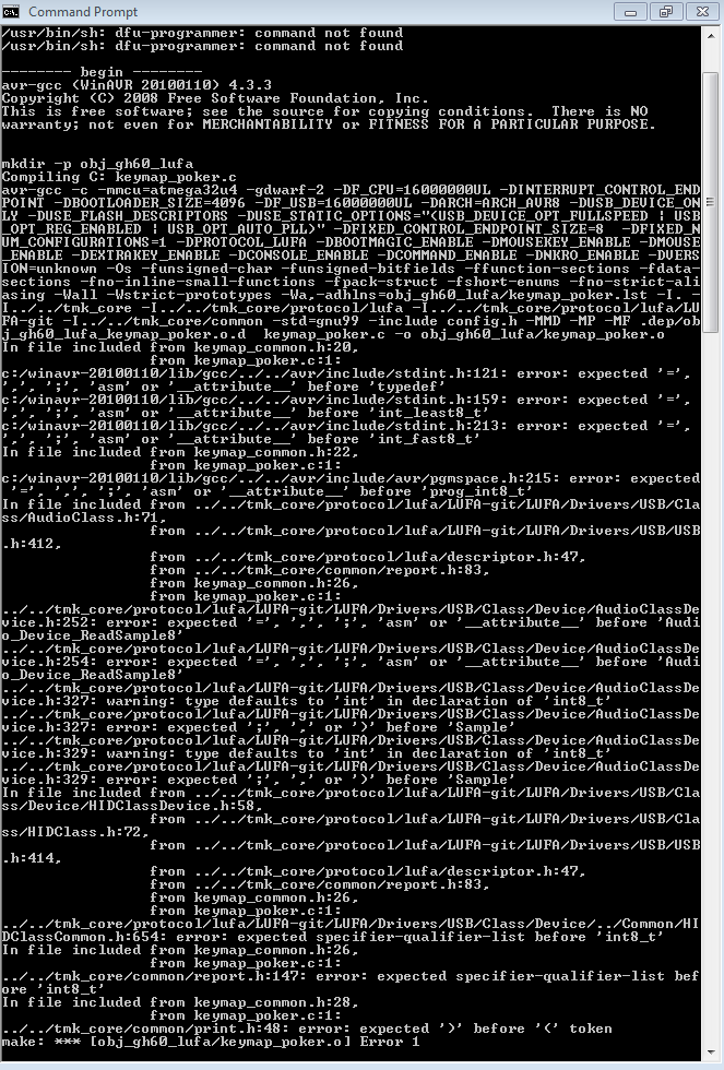

Amazing guide. I'm nearly at the end but I am having massive issues.
I'm getting a plethora of error messages... this one is the current one (I'm a noob at code so If it is a simple mistake, I am sorry)
Compiling C: keymap_poker.c
avr-gcc -c -mmcu=atmega32u4 -gdwarf-2 -DF_CPU=16000000UL -DINTERRUPT_CONTROL_ENDPOINT -DBOOTLOADER_SIZE=4096 -DF_USB=16000000UL -DARCH=ARCH_AVR8 -DUSB_DEVICE_ONLY -DUSE_FLASH_DESCRIPTORS -DUSE_STATIC_OPTIONS="(USB_DEVICE_OPT_FULLSPEED | USB_OPT_REG_ENABLED | USB_OPT_AUTO_PLL)" -DFIXED_CONTROL_ENDPOINT_SIZE=8  -DFIXED_NUM_CONFIGURATIONS=1 -DPROTOCOL_LUFA -DBOOTMAGIC_ENABLE -DMOUSEKEY_ENABLE -DMOUSE_ENABLE -DEXTRAKEY_ENABLE -DCONSOLE_ENABLE -DCOMMAND_ENABLE -DNKRO_ENABLE -DVERSION=unknown -Os -funsigned-char -funsigned-bitfields -ffunction-sections -fdata-sections -fno-inline-small-functions -fpack-struct -fshort-enums -fno-strict-aliasing -Wall -Wstrict-prototypes -Wa,-adhlns=obj_gh60_lufa/keymap_poker.lst -I. -I../../tmk_core -I../../tmk_core/protocol/lufa -I../../tmk_core/protocol/lufa/LUFA-git -I../../tmk_core/common -std=gnu99 -include config.h -MMD -MP -MF .dep/obj_gh60_lufa_keymap_poker.o.d  keymap_poker.c -o obj_gh60_lufa/keymap_poker.o
keymap_poker.c:9:85: error: macro "KEYMAP" requires 62 arguments, but only 61 given
keymap_poker.c:5: error: 'KEYMAP' undeclared here (not in a function)
keymap_poker.c:16:76: error: macro "KEYMAP" requires 62 arguments, but only 60 given
keymap_poker.c:18: error: conflicting types for 'fn_actions'
keymap_common.h:34: error: previous declaration of 'fn_actions' was here
keymap_poker.c:19: error: 'layer' undeclared here (not in a function)
keymap_poker.c:19: error: invalid operands to binary / (have 'const uint8_t (*)[5][14]' and 'int')
keymap_poker.c:19: error: invalid operands to binary << (have 'const uint8_t (*)[5][14]' and 'int')
keymap_poker.c:19: error: invalid operands to binary | (have 'int' and 'const uint8_t (*)[5][14]')
keymap_poker.c:19: error: invalid operands to binary % (have 'const uint8_t (*)[5][14]' and 'int')
keymap_poker.c:19: error: invalid operands to binary << (have 'int' and 'const uint8_t (*)[5][14]')
keymap_poker.c:19: error: invalid operands to binary & (have 'const uint8_t (*)[5][14]' and 'int')
keymap_poker.c:19: error: invalid operands to binary | (have 'const uint8_t (*)[5][14]' and 'const uint8_t (*)[5][14]')
keymap_poker.c:20: error: initializer element is not constant
keymap_poker.c:20: error: (near initialization for 'fn_actions[1]')
make: *** [obj_gh60_lufa/keymap_poker.o] Error 1

Here are some photos of the underside and topside...
http://imgur.com/a/Ulcbh
And the code...
Keymap_poker.c
http://pastebin.com/T4kLEcM4
Keymap_common.h
http://pastebin.com/dfBZZMjW
matrix.c
http://pastebin.com/P7Z0dmc4
UPDATE
tinkered with the code and it "works" It doesn't comply with my desktop pc running windows, but I plugged it into my macbook and "most" of the keys work. Some feel a bit funny but i assume the contacts need to be cleaned as these were salvaged keys. The ones that dont work have poor connections from where ive broken the contact from the column wire (I ran out of flux for a decent solder)
That aside, what could be causing it to play up on my pc but not my mac?
Andster29
12 Jul 2016, 04:12
hasu wrote: Hmm, infomation given is not enough, in particular when you don't know the cuase.
1) Post pics of your keyboard; all over appearance, upside and downside of internal(PCB or hand wiring) at least.(we never can see your *custom* keyboard without pics)
2) Show your schematic of circuit if possible(handwriting is no problem). Or your key matrix table at least.
3) Show all of your code used to build your firmware; set up your repository in github.com(preferable) or other service you like.
4) Describe your problem more deail. Can you describe procedure to get undesired '8'? Can you reporduce the problem? Or it seems to be completely "random" without rules?
EDIT: Your English is no problem if you can read my Engrish :D
I have been trying to build a 60% keyboard before I return to school in 2 days. I finally got the programming stage and I am stuck. I'm a hardware guy. Code and I don't go together well. I tried the programming myself and got the matrix file adjusted. When I try to compile I get the error below.
Error
Error
I have also added a picture of the back of my keyboard. Sorry for the mess. If anybody has wired their keyboard the same, the .hex file would be greatly appreciated.
Keyboard
Keyboard
Back of Keyboard.jpg (4.57 MiB) Viewed 8281 times
To make it easier, here is my row and column set up.
* col: 0 1 2 3 4 5 6 7 8 9 10 11 12 13
* pin: F7 B6 B5 B4 D7 D6 C7 C6 D3 D2 D1 D0 B7 B3
* row: 0 1 2 3 4
* pin: F0 F1 F4 F5 F6
Thank you for the help guys. I will be eternally grateful to anyone who has a solution for me.
redesigndavid
12 Jul 2016, 08:18
I'm not very good in debugging c code, but those look like typo errors. It keeps on saying it expects this or that character. If no body else could help, try starting from a fresh working version and make changes bit by bit, and always compiling the code after every change. That way you could spot where it went wrong. Hope that helps!
Andster29
12 Jul 2016, 14:18
redesigndavid wrote: I'm not very good in debugging c code, but those look like typo errors. It keeps on saying it expects this or that character. If no body else could help, try starting from a fresh working version and make changes bit by bit, and always compiling the code after every change. That way you could spot where it went wrong. Hope that helps!
I have tried every version of the tmk firmware. I have also tried compiling a fresh version with nothing changed. Both gave the same error.
Laser
emacs -nw
12 Jul 2016, 16:47
Is that a recent version of avr-gcc? (it looks rather old to me - 2010). Maybe that's the problem.
Andster29
12 Jul 2016, 17:22
Laser wrote: Is that a recent version of avr-gcc? (it looks rather old to me - 2010). Maybe that's the problem.
I used the version that came with the tmk firmware from github that is linked on the first page.
redesigndavid
13 Jul 2016, 01:32
Andster29 wrote: I used the version that came with the tmk firmware from github that is linked on the first page.
Are you using a teensy? There's a winavr link in this page that the makers of teensy say would have everything you'd need. https://www.pjrc.com/teensy/gcc.html
Andster29
13 Jul 2016, 14:10
Yes, I am using a Teensy 2.0
Andster29
14 Jul 2016, 03:52
Is there anything that is newer? Can you link me to an install that works on Windows 10 or should I move to Linux?

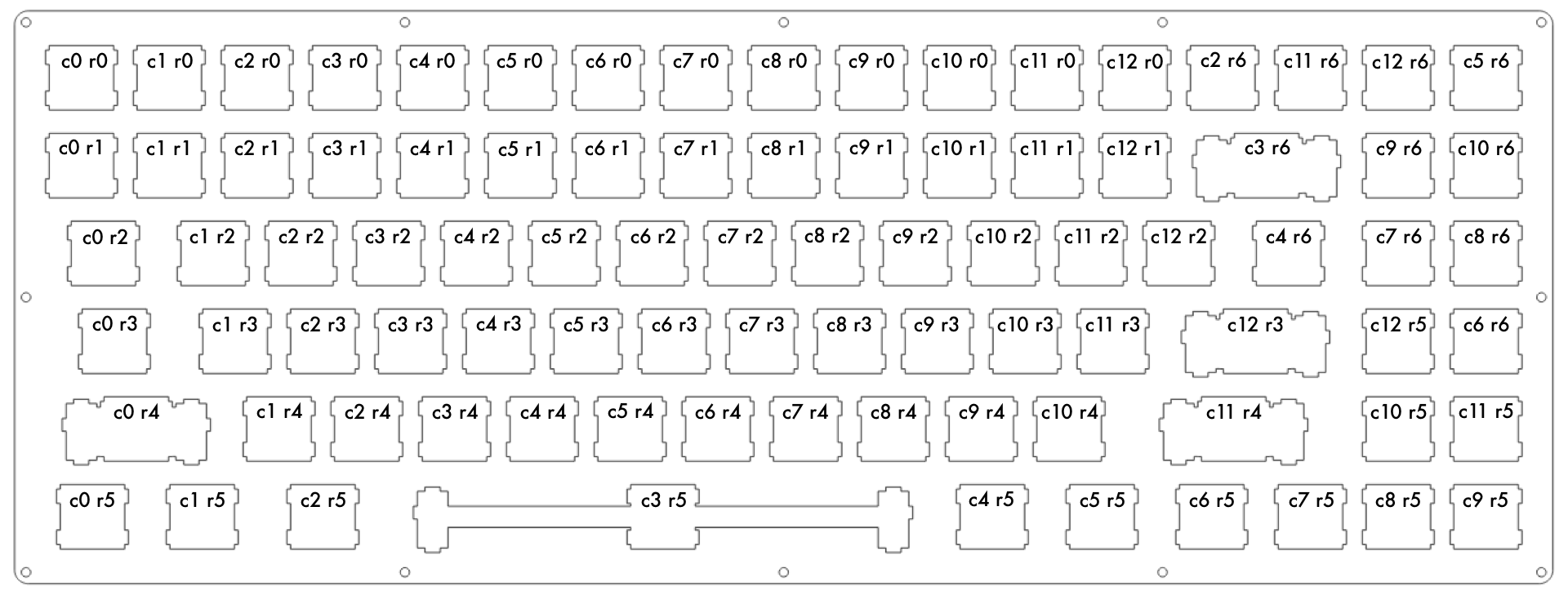

richfiles
19 Jul 2016, 22:28
So, I'm pretty new to C programming. The last time I touched programming was TI-BASIC in the 90s, and TRS-80/Commodore BASIC in the 80s. C is not proving to flow all that intuitively through my tangled jumble of neurons. :roll: No, my profession and life long hobby has always been hardware. I've built walking robots with no CPUs, no software at all. Just hardware. It's what I do, so it comes as no surprise that I'd go all out on the hardware aspect of my keyboard... and run into a brick wall at the software side of things. :?:
So, belive I've successfully defined the rows and columns (first section). I'm now on to the second section, where I need to define the matrix and the key map. I have a question regarding this stage. The following image is my matrix layout, as viewed from above the keyboard.
/* Column pin configuration
 * pin: F0  F1  F4  F5  F6  D4  D5  D2  B7  B3  B2  B1  B0
/* Row pin configuration
 * row: 0   1   2   3   4   5   6
 * pin: F7  B6  B5  B4  C7  C6  D3
I have a VERY dense matrix of 13x7. It was necessary to keep enough I/O pins open for the Caps Lock LED, Backlight LED, pair of I2C pins, and a sense pin. The sense pin and I2C is so it can detect if a yet to be built, magnetically attachable number pad is attached, and whether or not it should poll a port expander over I2C. I figure, software is changeable, so i can re-do code later, once I actually have the number pad built, and have half a clue what the heck I'm actually doing.
Anyway, in order to keep the matrix small, I have a super dense layout with almost no gaps, and row 6 is actually a tight cluster of keys in the top right corner. Only three intersections in the entire matrix go unused (c0-r6, c1-r6, and c12-r4). This means my matrix does not directly conform to the physical key layout in some areas (all of Row 6 is in the top right corner, and the bottom row is "electrically" compressed to one side, and then includes the bottom right corner keys as well).
What I want to know, is where the matrix definitions need to be ordered by electrical sequence, or if the values are arbitrary, and allow for physical sequence (as long as the values are correctly defined). The obviously functional way is to lay the matrix out electrically. This seems to be what's assumed.
My question then is which (if either, or both, or neither, or 42 :mrgreen: ) would be correct?
Electrically based layout:
#define KEYMAP( \
    K00, K01, K02, K03, K04, K05, K06, K07, K08, K09, K0A, K0B, K0C, \
    K10, K11, K12, K13, K14, K15, K16, K17, K18, K19, K1A, K1B, K1C, \
    K20, K21, K22, K23, K24, K25, K26, K27, K28, K29, K2A, K2B, K2C, \
    K30, K31, K32, K33, K34, K35, K36, K37, K38, K39, K3A, K3B, K3C, \
    K40, K41, K42, K43, K44, K45, K46, K47, K48, K49, K4A, K4B,     \
    K50, K51, K52, K53, K54, K55, K56, K57, K58, K59, K5A, K5B, K5C, \
              K62, K63, K64, K65, K66, K67, K68, K69, K6A, K6B, K6C  \
    { KC_##K00, KC_##K01, KC_##K02, KC_##K03, KC_##K04, KC_##K05, KC_##K06, KC_##K07, KC_##K08, KC_##K09, KC_##K0A, KC_##K0B, KC_##K0C }, \
    { KC_##K10, KC_##K11, KC_##K12, KC_##K13, KC_##K14, KC_##K15, KC_##K16, KC_##K17, KC_##K18, KC_##K19, KC_##K1A, KC_##K1B, KC_##K1C }, \
    { KC_##K20, KC_##K21, KC_##K22, KC_##K23, KC_##K24, KC_##K25, KC_##K26, KC_##K27, KC_##K28, KC_##K29, KC_##K2A, KC_##K2B, KC_##K2C }, \
    { KC_##K30, KC_##K31, KC_##K32, KC_##K33, KC_##K34, KC_##K35, KC_##K36, KC_##K37, KC_##K38, KC_##K39, KC_##K3A, KC_##K3B, KC_##K3C }, \
    { KC_##K40, KC_##K41, KC_##K42, KC_##K43, KC_##K44, KC_##K45, KC_##K46, KC_##K47, KC_##K48, KC_##K49, KC_##K4A, KC_##K4B, KC_NO    }, \
    { KC_##K50, KC_##K51, KC_##K52, KC_##K53, KC_##K54, KC_##K55, KC_##K56, KC_##K57, KC_##K58, KC_##K59, KC_##K5A, KC_##K5B, KC_##K5C }, \
    { KC_NO,    KC_NO,    KC_##K62, KC_##K63, KC_##K64, KC_##K65, KC_##K66, KC_##K67, KC_##K68, KC_##K69, KC_##K6A, KC_##K6B, KC_##K6C }  \
or...
Physically based layout
#define KEYMAP( \
    K00, K01, K02, K03, K04, K05, K06, K07, K08, K09, K0A, K0B, K0C, K62, K6B, K6C, K65, \
    K10, K11, K12, K13, K14, K15, K16, K17, K18, K19, K1A, K1B, K1C, K63,      K69, K6A, \
    K20, K21, K22, K23, K24, K25, K26, K27, K28, K29, K2A, K2B, K2C, K64,      K67, K68, \
    K30, K31, K32, K33, K34, K35, K36, K37, K38, K39, K3A, K3B, K3C,           K5C, K66, \
    K40,      K41, K42, K43, K44, K45, K46, K47, K48, K49, K4A, K4B,           K5A, K5B, \
    K50, K51, K52,                K53,                K54, K55, K56,      K57, K58, K59  \
    { KC_##K00, KC_##K01, KC_##K02, KC_##K03, KC_##K04, KC_##K05, KC_##K06, KC_##K07, KC_##K08, KC_##K09, KC_##K0A, KC_##K0B, KC_##K0C, KC_##K62, KC_##K6B, KC_##K6C, KC_##K65 }, \
    { KC_##K10, KC_##K11, KC_##K12, KC_##K13, KC_##K14, KC_##K15, KC_##K16, KC_##K17, KC_##K18, KC_##K19, KC_##K1A, KC_##K1B, KC_##K1C, KC_##K63, KC_NO,    KC_##K69, KC_##K6A }, \
    { KC_##K20, KC_##K21, KC_##K22, KC_##K23, KC_##K24, KC_##K25, KC_##K26, KC_##K27, KC_##K28, KC_##K29, KC_##K2A, KC_##K2B, KC_##K2C, KC_##K64, KC_NO,    KC_##K67, KC_##K68 }, \
    { KC_##K30, KC_##K31, KC_##K32, KC_##K33, KC_##K34, KC_##K35, KC_##K36, KC_##K37, KC_##K38, KC_##K39, KC_##K3A, KC_##K3B, KC_##K3C, KC_NO,    KC_NO,    KC_##K5C, KC_##K66 }, \
    { KC_##K40, KC_NO,    KC_##K41, KC_##K42, KC_##K43, KC_##K44, KC_##K45, KC_##K46, KC_##K47, KC_##K48, KC_##K49, KC_##K4A, KC_##K4B, KC_NO,    KC_NO,    KC_##K5A, KC_##K5B}, \
    { KC_##K50, KC_##K51, KC_##K52, KC_NO,    KC_NO,    KC_NO,    KC_##K53, KC_NO,    KC_NO,    KC_NO,    KC_##K54, KC_##K55, KC_##K56, KC_NO,    KC_##K57, KC_##K58, KC_##K59 }  \
My question is, are the values entered into the table above dependent on position in the list, or just by content. It'd be FAR easier to follow the second layout, but I don't know if it screws with the code to mix and match rows and columns like that, or whether it's all good, as long as the numbers match.
Basically, is the code expecting all the rows and columns to be in a neat and orderly incrementing layout (all the columns, in order, 0 to the maximum, for row one, then repeating for row two, and so on), or is this list arbitrarily defining the intersection values based not he numbers entered (arbitrarily defining what key labels are to be used for each matrix intersection, without regard to were in the list the sit, so long as row and column numbers match up)?
Does that make sense? :?:
I suppose I should add, I know software is flexible, and I can always integrate new features later on. For now, i just wanna get my keyboard up and running. Int he long term though, I want to have the code check whether a pin (E6) changes states. Depending on whether it is high or low, I want to have it scan a 6x6 matrix on a port expander connected over I2C, or to skip the I2C part of the code and ignore that part of the matrix. I don't yet know how I would go about doing this in the code, and I don't even know if this firmware can be modded to support it at all. Of course, that's the nice thing about software... There's always room for change.
I also have transistor driven LEDs in each switch housing, to under-light the keys (the keys are opaque, so no backlighting, sadly). It's just a single channel for the entire keyboard. I haven't gotten far enough through the tutorial to get to backlight controls, but I skimmed the posts and saw people controlling backlights, so I suppose that should be simple. I just want to have a default max brightness setting at power up, and the option to change the brightness with the keyboard.

Hi guys, first time here. I've been working on my own custom CAD-usage keyboard, and so far i've been able to get everything working except for the 15th Column. The layout of the keyboard is near fullsize (101keys), and so i've had to do a lot of weird wiring of traces in order to meet the I/O pin count of the teensy, thus confusing myself.. haha..
Pics for a general idea of layout first:
Those are the columns of the PCB, flipped. it is a custom PCB, and the numpad is on the left for easy CAD value inputs.
Previously, Column 16 as a whole would not work, and would only be activated by keypressing column 15, and so I added the 1UL<<16 to my matrix.c, fixing column 16, but the issue with column 15 did not go away.
heres my config.h

I have used a multimeter to check all connections, and there seems to be no short between col 15 and 16 so please tell me if you see anything wrong with the code. I can post more pics if needed, I don't have a schematic, but basically the schematic is: rows connected so that each row contains 17 keys (with exception of bottom row having 16), and 17 columns, making sure that each column touches each row only once. Thanks!
