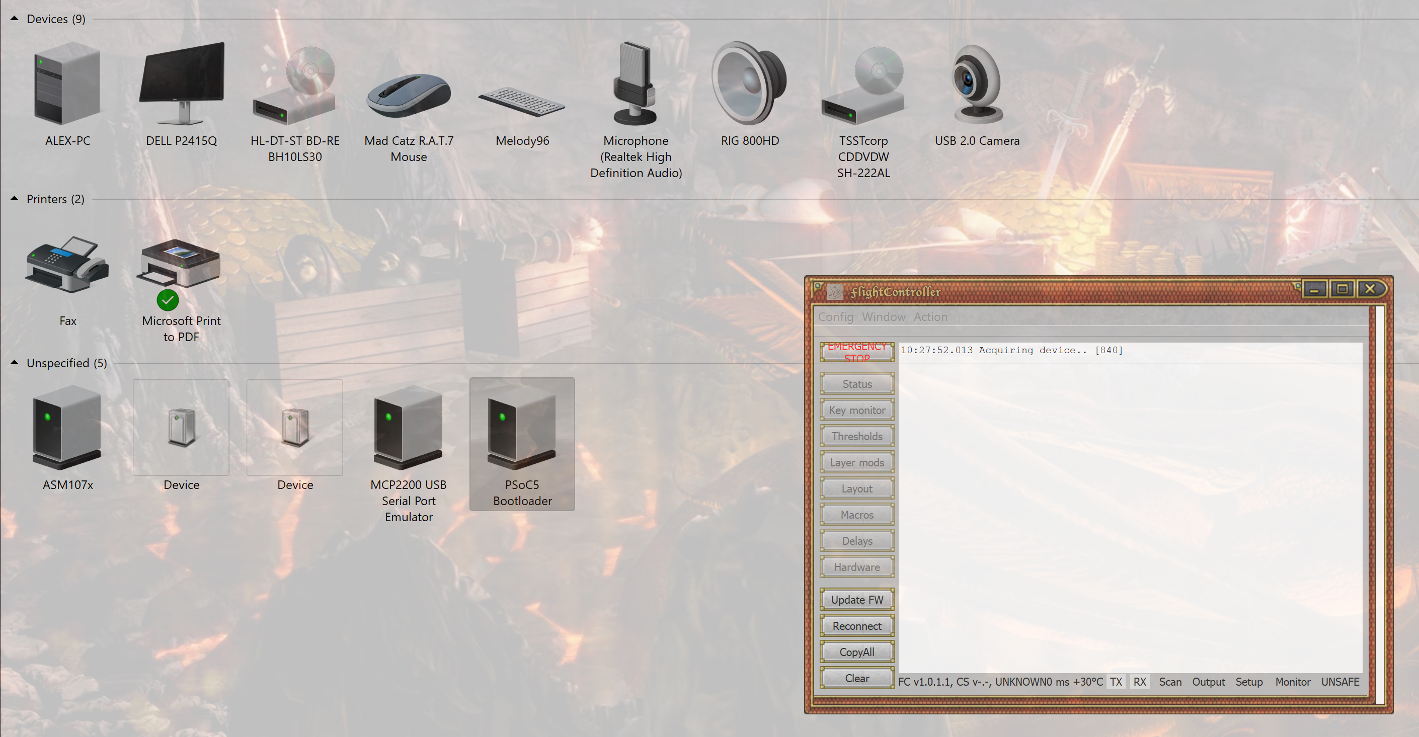

ok I am getting this error from the PSoC when trying to aquire ports
There was an error running port acquire: PSoC device is not acquired! Check connection of the chip to the programmer
This same error i get with 2 controllers when they are soldered with rows/colums. The 1st board after desoldered would program fine, as would the 2nd before soldering to the keyboard.

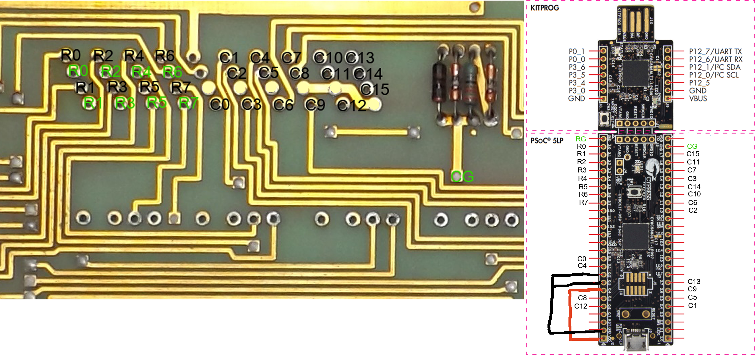

Below is the layout of connections on keyboard and also pins on the contrioller, please could someone tell me where i am going wrong, thanks.
- pinout.png (2.76 MiB) Viewed 12886 times
RG = Row Ground each row is connected together CG = Column Ground

Wiring looks good, I believe. Are you by any chance using a USB hub? I had trouble with USB hub (even a powered one) when trying to connect/write to the board. Only plugging it into a dedicated port on my PC did the trick.
Also did you try aquire port at all before you did your wiring? Just to make sure it wasn't faulty. If not, I know it doesn't help now but that's what I first started checking the second time I did a commonsense project.
Re: [Done] CommonSense: matrix LCR meter with a HID interface
Posted: 16 Mar 2020, 23:16
by Anakey
Hi Snack, i was able to flash the bootloader perfectly fine before soldering the rows/columns first thing i did with the new controller to check it was not a software issue
tried different cables and ports on the motherboard still same issue

I should have checked better. Didn't realize you had the full thing pinned out.
I know that 3.2 is skipped. Try disconnecting that maybe? I'm not sure what the pin is used for but it's skipped in the documentation.

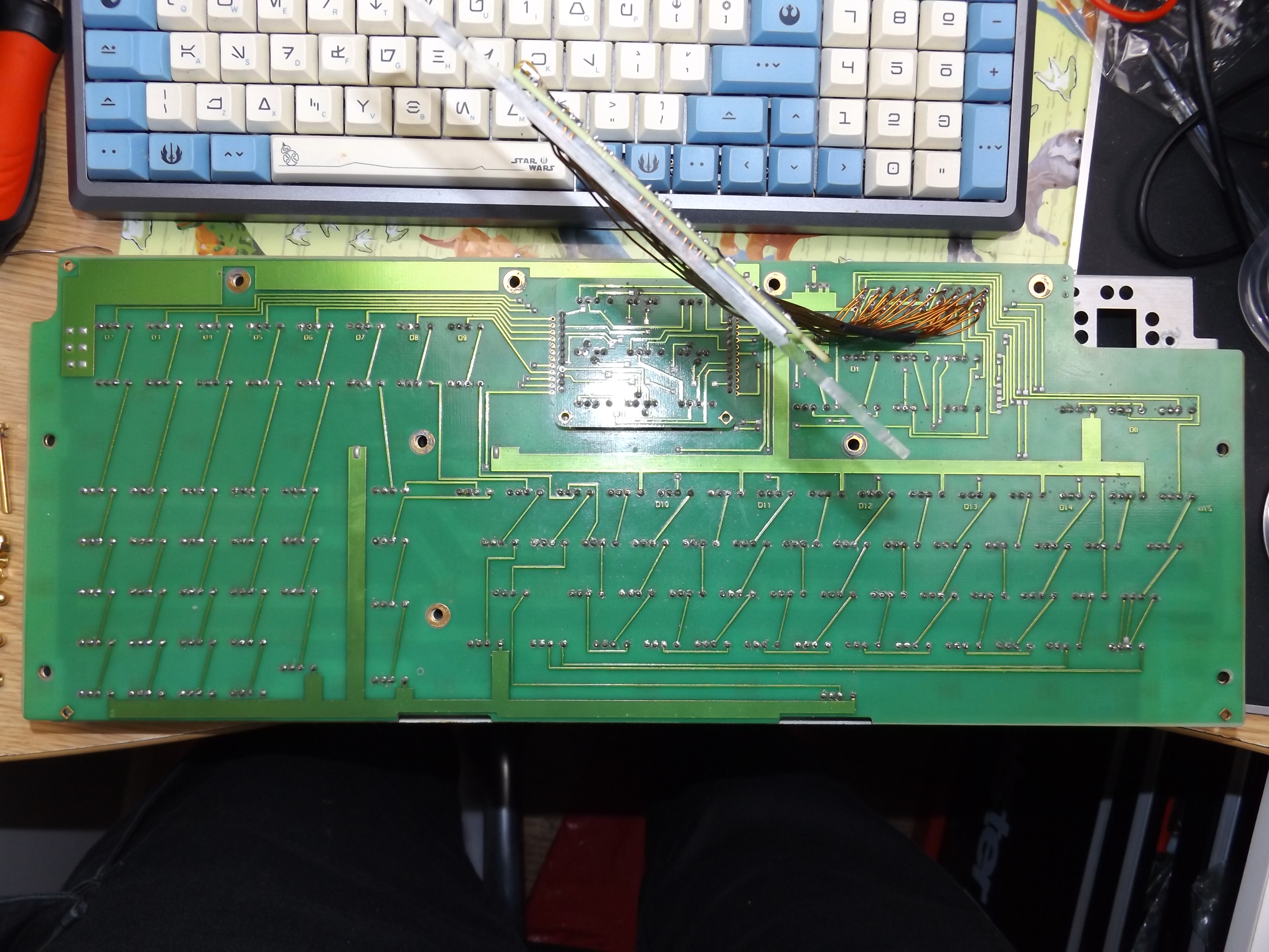

Hi DMA, i made a thread on this perticular board here
viewtopic.php?f=7&t=22722 where there is a shot of the full pcb bfrom the front side
here is from the back
- DSCF1612.JPG (3.98 MiB) Viewed 12716 times

Interesting - matrix PCB completely devoid of active components.
You have BIG cojones or an access to a good desoldering tool or both, Sir.
Do not do that at home, kids, especially with intermediates. Those ferrite rings are brittle as hell and, in intermediate magvalve, the leads are hanging off the ring with virtually nothing to support them. One unlucky pull is all it takes to break that ring.
It's hard to trace the PCB without colored pens - but it looks like you're driving by the long trace (the one that gets from entry point to the far end of the row.
I did it the other way - primarily because that long trace was shared by 2 (sometimes more) rows and they are shorted together at the driver. Might be important - but then again, might be not.
I guess you have access to a scope. Go
here, look at *_clk_pulse_*.png and compare with your favorite row and column at PCB edge. I would recommend starting with one that doesn't go via the daughterboard.
If you don't - well, good luck, I guess.
If your problem is acquiring the port tho - you are not expected to program more than once, as everything is configurable via FC. But even if you want to remap pins or change code - FlightController has "Update FW" button. If you change the code enough to crash firmware - the button on the kit resets it to bootloader, which you can program with either FC or "Bootloader Host" utility (in creator's menu somewhere)
PS: Oh, and another thing. Columns usually have diodes between column traces and common point. Are you sure the CG is directly connected to the far end of the column switch chain?

Platform, screenshot of main window?
Posted: 20 Mar 2020, 11:45
by Anakey
Windows 64
- Screenshot_1.png (4.3 MiB) Viewed 12467 times
Posted: 20 Mar 2020, 14:50
by DMA
OK. Looks like it's in bootloader for some reason. update fw - navigate to project dir/Compiled, find .cyacd there. It should program the device and after that it will likely boot up.
Do you by chance have the button on the kit pressed by something?
Posted: 20 Mar 2020, 23:06
by Anakey
Thank you for that, managed to flash the board and get it into safe mode

I succeeded! Did a messy soldering job but it worked just fine.
Currently typyng on my Beamspring, can't be happier about this. I ran over some issues with some keys actuating multiple times, in particular the "M" key. Without even full pressing the key it triggered 20 M's, atm everything works perfect.
My 3276 data entry has a 20x4 matrix, I want to share the thresholds because i think they are really low numbers. All of them between 1 and 3.
Thanks to everyone involved in this project!!

shine wrote: 09 Apr 2020, 20:11
Hardware -> ADC resolution, bit -> 12
That should pull you into 40-ish-at-rest territory, so you can set thresholds to like 15 and forget about key spam.
Wiring is fine but kek try to get xwhatsit working with that
