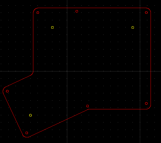

litster
12 Oct 2012, 01:36
Dox, I am also drawing an acrylic case at the moment, and I hope to do a test cut tonight. It will have an acrylic plate. Due to the thumb cluster area, I am not sure where I can place the feet to still make it stable.
Where are you putting the feet?
dox
12 Oct 2012, 01:48
Great!
For the feet, it depends on how you want to have it sloped or flat. To get a slope, I would place the 3 corners first and try to mark the position of the thumb foot before sticking it. Or with the dimensions of the feet I could determine the exact position from my 3D model.
litster
12 Oct 2012, 02:02
I am thinking potentially use the same aluminum feet I have from my KMAC and MX Mini, 3 on each side at (top left, top right, and lower left - for the right hand). These feet are about 2cm tall with rubber feet. And then I would use a small rubber feet for the lower right corner. So the 3 yellow circles would be the high points and slope down to the lower right corner.

dox
12 Oct 2012, 02:12
One of the 3 feet (upper left) from the KMAC need to be taller then the other 2 to have the slope that you want. This is the slope I'm using at work with my 2nd shapeways case (I need to post pics of that) and it's very comfortable.
12 Oct 2012, 02:17
Kmac height options, for reference:
Well it's actually not very clear from the picture. And those black titties are rubbers are for under the feet.
litster
12 Oct 2012, 02:18
You are right. I can make that one taller by adding a thick aluminum disc to it.

dox
12 Oct 2012, 02:44
With alu plates, you can drill/tap some holes in the bottom plate and get any slope by fitting different screws in those holes.
I tried a lot of different configurations and the best for me is a slope from the inner top to the outer bottom.

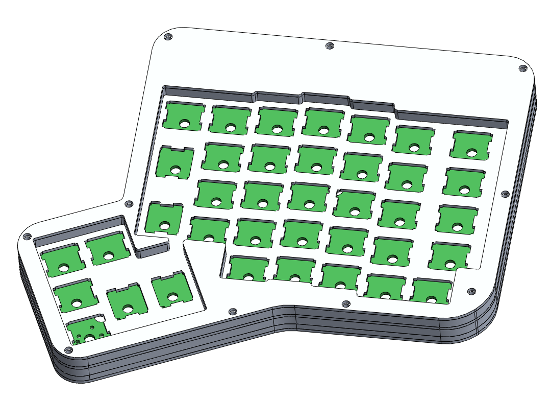

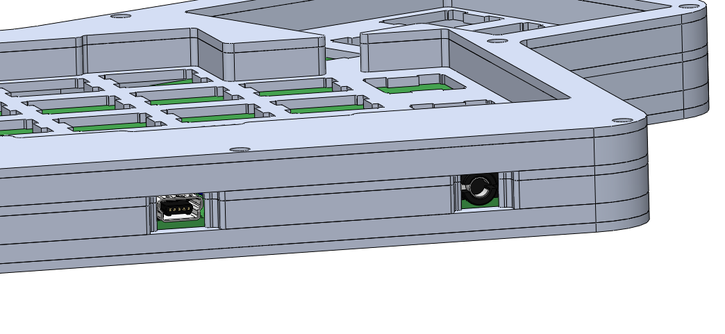

litster
12 Oct 2012, 05:22
Here it is. A couple of mistakes like the 3.5mm opening is too narrow, forgot the make room for the USB connector on the layers that sandwich the acrylic plate. I want to have a built-in wrist rest to the case as well. I will have to make all those changes for the next prototype.
Top view:
BTW, to use this case, you will need to solder SMD diodes or through-hole diodes on the bottom of the PCB. SMD diodes on the bottom is better as you would not need to worry about the diode legs sticking up from the bottom.

litster
16 Oct 2012, 05:05
I have added a built-in wrist rest. Also now I have a proper top layer thanks to DOX.
click the picture to see the larger version that is not weird :-)
