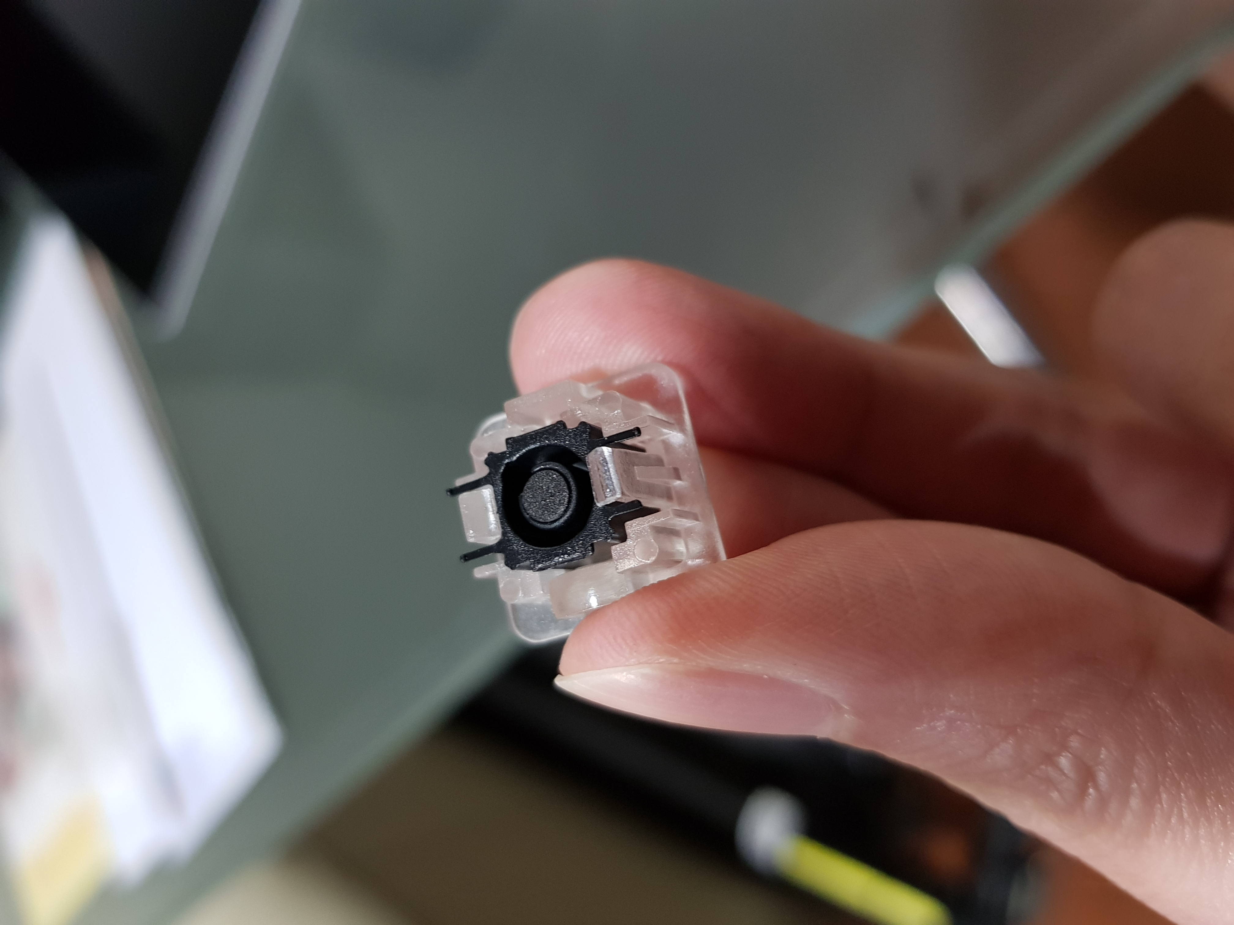

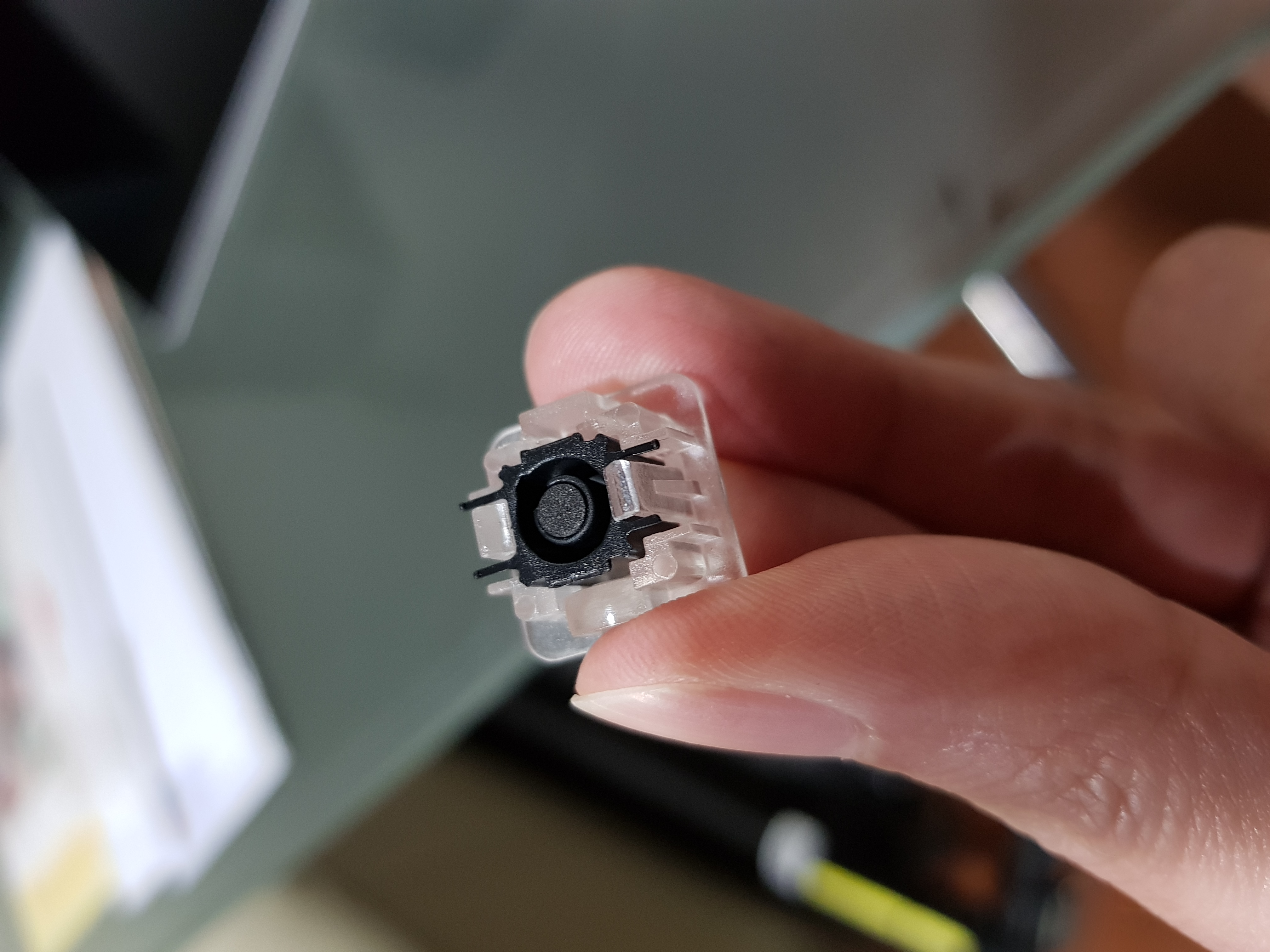

Very cool- I have a TKL from the first batch (linear, acrylic), and love it but am hoping for a v3 tactile some time. Could you post a photo of the foam cushion arrangement? I've been debating trying something for a little bottom damping...
Posted: 28 Mar 2018, 07:16
by mustcode
It's a piece of cylindrical foam, same diameter as the magnet, about 1mm thick. It goes right over the magnet. The magnet is recessed further in a bit to make room for the foam. The foam is stuck to the magnet with a double sided tape. I'll post a picture when I get back to the keyboard again tonight or tomorrow.

dwolvin wrote: Very cool- I have a TKL from the first batch (linear, acrylic), and love it but am hoping for a v3 tactile some time. Could you post a photo of the foam cushion arrangement? I've been debating trying something for a little bottom damping...
Here's the foam I was talking about.

by dwolvin
Ah, not sure if that will work on mine, I keep meaning to pick up a bigger size hole punch and just punch a bunch of slightly under a centimeter circles and put them at the bottom of the well (on the HE sensors). But it's not at the front of the list by any means... :)
Whoops- new phone- didn't think about the camera change!
Excuse the dust.
