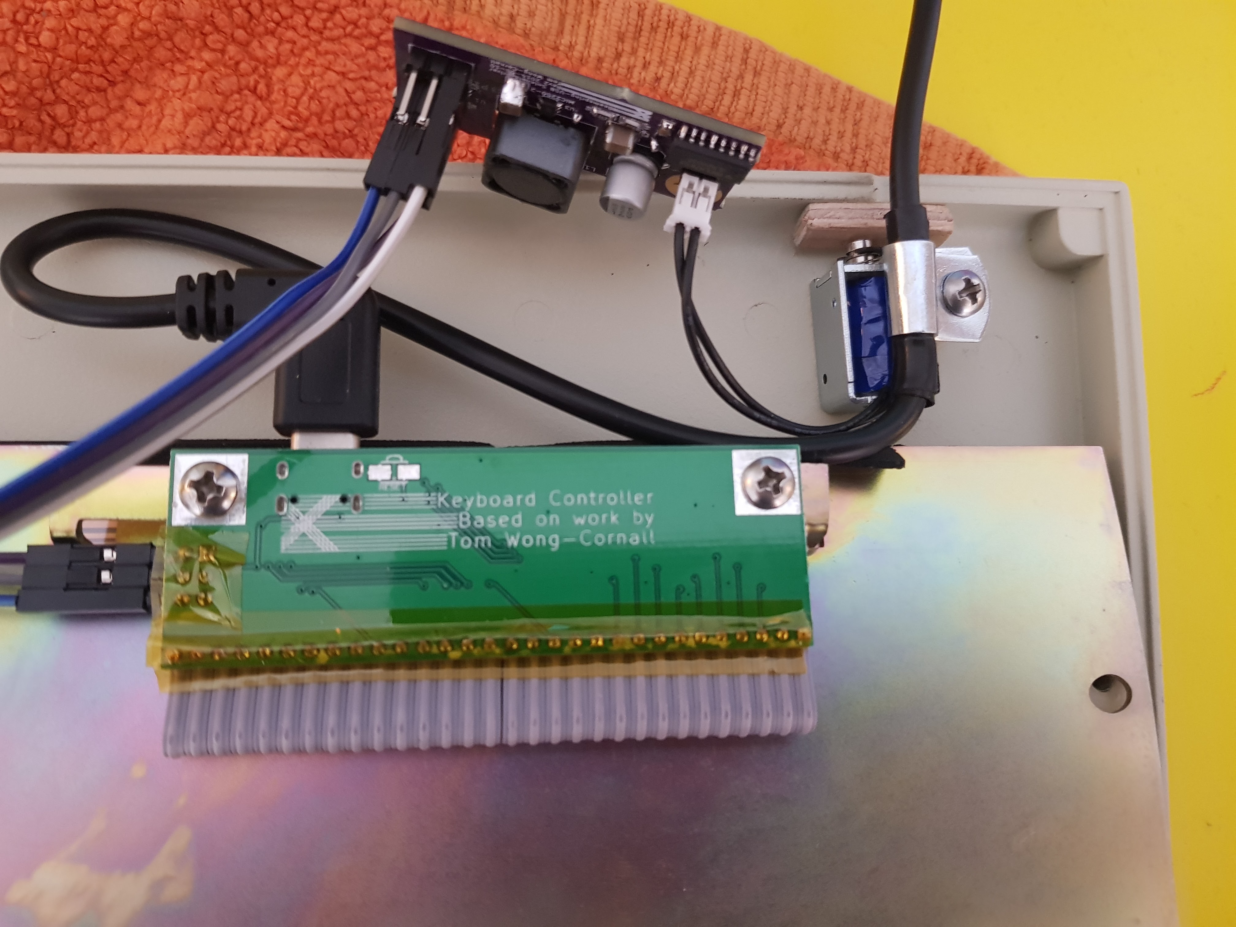

Twst what is the throw distance of your solenoid if I may ask? Is there an order link? I read that the throw should be under 1mm.

The solenoid I am using is rated at 5mm. But the chassis is adjustable and you can fine tune the lenght of the throw that way and mounting it closer to the hack object. At full lenght it is a little sluggish, but keeping it on a shorter throw speeds things up. Speed is tweakable in the capsense util too, so it's not that bad to dail it in as you like.Ellipse wrote: 13 Jun 2020, 23:07 Twst what is the throw distance of your solenoid if I may ask? Is there an order link? I read that the throw should be under 1mm.
Since I ordered some xwhatsit solenoid drivers (now available to order on the project web site; will be delivered in a few weeks) I am also looking to order some recommended solenoids.
Here is the ebay link;
https://www.ebay.co.uk/itm/0837L-06K-6V ... 1967978003
Works great off the USB 5V and works just as good off the 9V from the xwhatsit solenoid board (built a few and tested that too).
Keep in mind the physical size, these just barely fit inside the boards.
Another great solenoid that works both on 5V and the xwhstsit solenoid board is this little fellow:
https://www.digikey.com/product-detail/ ... 1585840895
The size on the sparkfun one is more manageable inside the chassis, I think it could even be mounted vertically firing downwards. And it hacks away quite hard giving its size. But I have not fully tested it mounted inside. It does not scream business like the other one, but I am sure it's big enough for a keyboard.
Have some around and could post pictures/video and comparison if there is any interest.

Yep! The solenoid switch is found as "Exp Toggle" in the keymap dropdown in Capsense software. I placed it on a layer so I could turn in on and off as I see fit

Sorry for posing all this annoying solenoid stuff..
Anyways, I just wanted to share my findings and for anyone that want a little more tactility and click here is a super fast and non invasive mounting option of the smaller 5v solenoid from sparkfun. It will securely clamp under the cable fastener inside the board.
This solenoid will obviously not hit like the bigger one, but I think it works well without overwhelming the ping of the F.
Here in my F62;
Here in my F62;

Got the solenoid to fire with the solenoid driver board too
