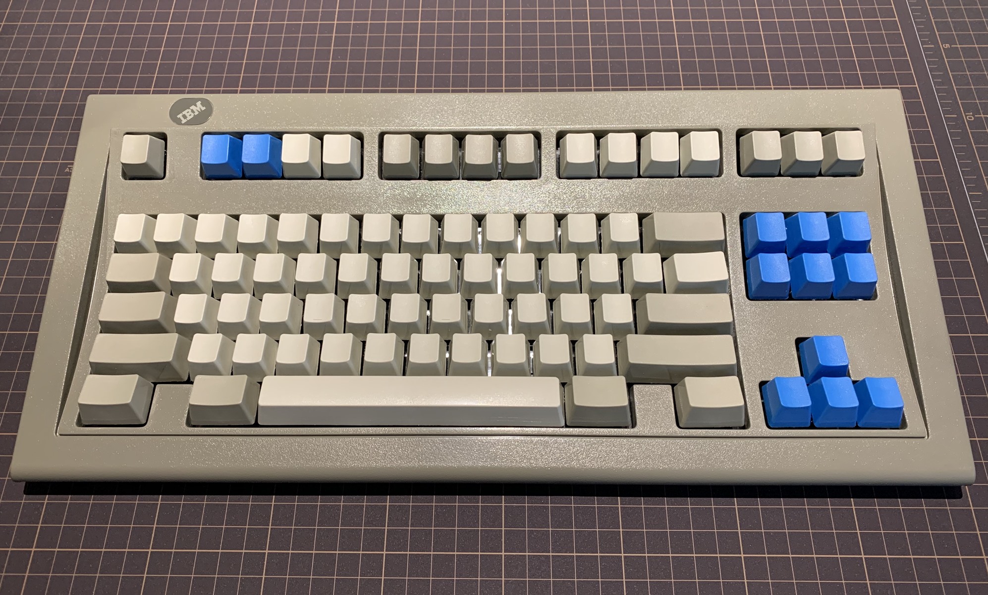

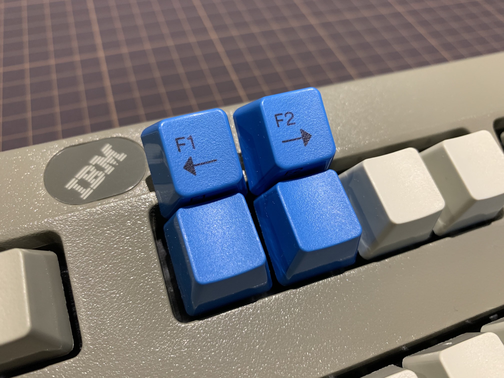

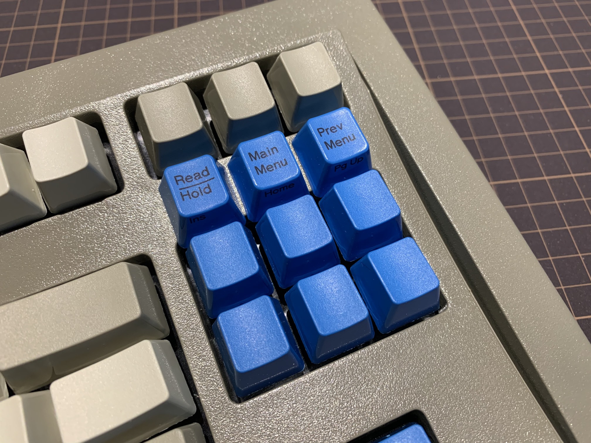

Here are some excellent quality photos sent to me of the Brand New Model F keys installed on an IBM Industrial SSK, including a comparison of the original two piece keys to the new one piece keys.
The keys look great on the original IBM keyboard!
